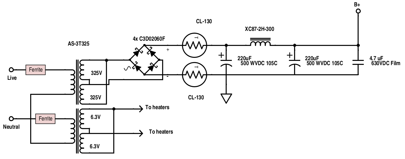

I believe that Hungary is a "240" V. zone. Therefore, you wire the primaries in series. Put ferrite beads on the "free" primary wires. Toroids are wide bandwidth and you want to suppress garbage riding on the AC mains.
Phase up the 2X 325 V. secondaries and connect them in parallel. The "raw" B+ is obtained by bridge rectification. 4X 600 PIV Cree C3D02060F Schottkys are switching noise free. 🙂 Pass the "raw" B+ through a CL-130 inrush current limiting thermistor and on to a CLC filter. Use 500 WVDC 105o C. 'lytics in the CLC filter. 220 μF. parts will be quite sufficient. A film part bypass of the reservoir (2nd) cap. is a nice touch.

Only 1 CL-130 is needed. Put it on the "hot" side.
Do not connect the 6.3 VAC secondaries in parallel. One energizes the signal tube heaters. The 2nd 6.3 VAC winding will be used to feed the negative supplies voltage multiplier.
Make certain that you get the phasing correct, when windings are connected in series or parallel. The traditional way of indicating winding phasing in schematics is to put a dot at 1 end of the coil symbol.

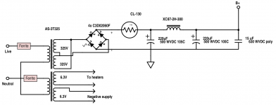

That schematic looks better.

I will use this PSU then. I will also ask AnTek for that color code.

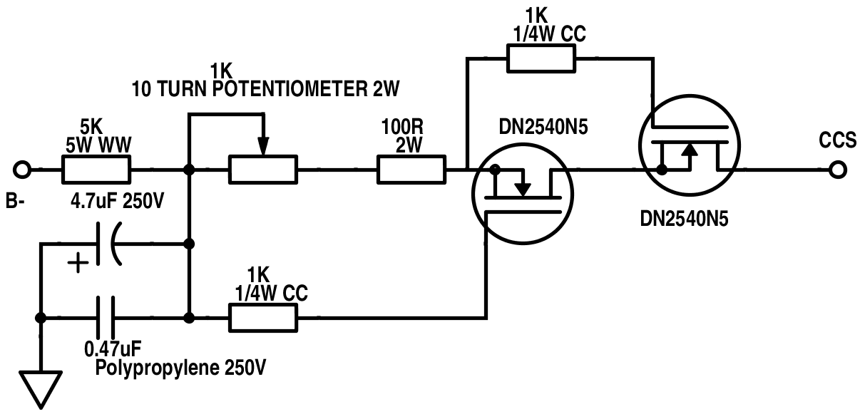

Use the schematic for the CCS that is in the El Cheapo schematic. It works well. I added a 15V Zener from source to gate in the "upper" MOSFET to solve a problem I had with static discharge killing that MOSFET in our dry winters.

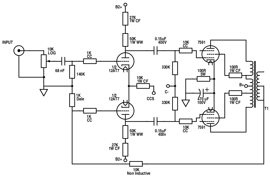

Just wanted to ask, if one channel of B2+ needs to connect the 1 and 6 pin of the 12AT7? and the second one connects the other channels 1 and 6?
I understand that the CCS is good, but I don't know what voltage to drive that with. 15V?

Yes, pin 1 and 6 are the plates (anodes). The CCS will connect through the single 10K heat isolation resistor and then to the cathodes, pins 3 and 8.
The voltage for the CCS is from the B- supply that Eli is working with you on. I think he wrote you that it will be derived along with C- (for the output tube grids) from the HT (high voltage) windings of the Antek transformer. It will be more than -15V, I think, where it enters the CCS at the bottom.

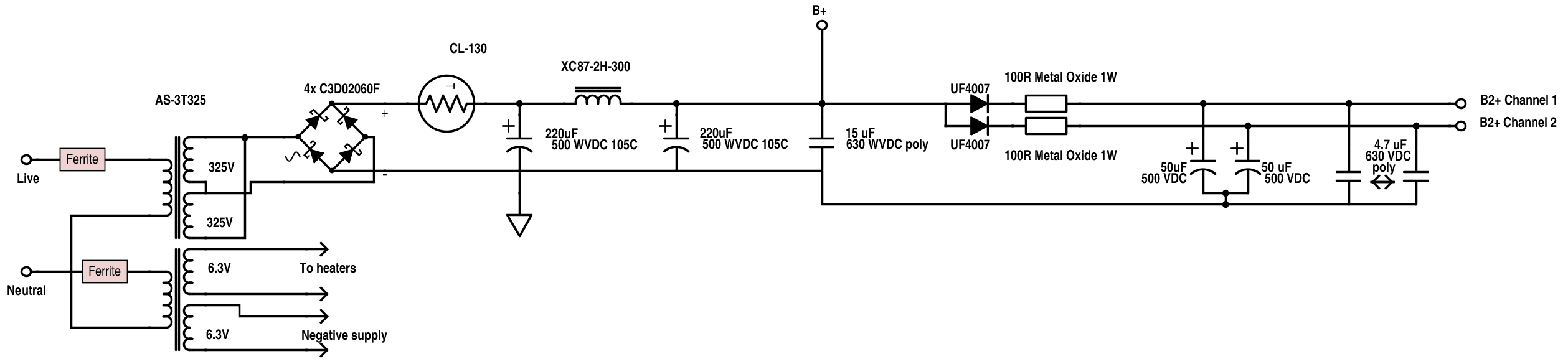

Okay, corrected the PSU, here it is, with B2+ outs also 🙂
Is this correct like this Eli?

I also uploaded where I am now, every schematic, if you find aproblem, please tell me 🙂

7591 "El Cheapo Grande" or "12" W. O/P tube "El Cheapo", the needs of the 12AT7/ECC81 splitter driver must be accommodated. Repeat, the the 'T7 triode sounds good with 3.0 to 3.5 mA. of plate current and 200 to 220 V. on the plate. In a "Grande", the total plate load resistance is 77 Kohms. For an IB of 3 mA., 231 V. are dropped in the total load resistance. Therefore, B2+ needs to be in 431 to 451 V. range. 325 VRMS is 459.6 V. peak. However, the inevitable losses will bring the real world value of B+ down. We could get lucky and not have to change any parts' values associated with B+, but, until PSU "breadboarding" is done, don't count on it. If necessary, the carbon film part currently specified as 27 Kohms will have its value reduced.

FWIW, I whipped up an LTspice sim (just to approximate voltages), with a B+ of 450V. With 3.22mA per 12AT7 with the 50k + 27k plate load resistors, it showed 195V on the plates, 3V on the cathodes.
I've found that real life tubes often draw a little less current than their spice models, so it could be possible that you'd have to reduce the value of those 27k resistors in the end. But you wouldn't know until you built it and fired it up with the actual tubes you're going to use, right?
Remember that you can always put a 220k resistor in parallel with the 27k resistor if you need 24k in the end. Or put 120k in parallel with 27k if you need 22k, and so on.
(Those parallel resistors won't need to be expensive, high-wattage types, since they won't be seeing all the current going through the tube. I think 1/2 watt would do for those, while the 27k resistor would need to be rated 1W.)
