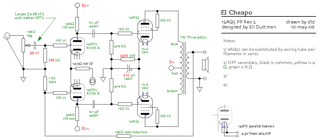

Look at the triode wired "El Cheapo" schematic. While it's only 6 WPC, it provides us with a point of departure. We will exploit a fact that Fisher, Scott, and Sherwood exploited, which is that "12" W. O/P tube driver circuitry also drives 7591s. 😀 As I stated previously, you will build an "El Cheapo Grande".
Edcor's CXPP60-MS-6.6K O/P transformer has the correct primary impedance and the requisite magnetic headroom.

The schematic I uploaded is for a 6 WPC amp, based on "12" W. O/P tubes. You will build a 30 WPC amp, using the same topology style. 😉 Remember what I said about the 7591 being easy to drive. The 12AT7/ECC81 long tailed pair (LTP) has the "stones" needed to drive PP 7591s. 🙂
Definitely Edcor O/P transformers, with an agent in Germany. Maybe some money can be saved by ordering power "iron" from AnTek. While shipping from the USA is expensive, New Jersey is east coast and over 3000 KM. closer to Europe than New Mexico. It does matter.
AnTek's $38.50 AS-2T300 looks like it will do quite nicely. You might only have to buy a filter choke, in addition to what's already been mentioned. The AS-2T300 has a pair of 4 A. filament windings and the draw of 2X 12AT7/ECC81s and 4X 7591s is 3.8 A. So, the 2nd 4 A./6.3 VAC winding could be voltage multiplied to obtain the low current negative voltages (B- & C-) an "El Cheapo Grande" requires.

Of course, Rongon can post what he simulated. The object of this exercise is a solidly performing amp, not aggrandizing my ego. The participation of other members can only assist in getting the job done.
You, naturally with some help, are going to draw the schematic that gets used. 😀 The signal portion of the "El Cheapo" schematic I previously uploaded will undergo only a few changes. The power supplies for this amp will be discussed in later posts.
Other than an increase in value of the 'T7 load resistors, which take advantage of the higher B+ rail voltage. The LTP splitter/driver stays "the same".
Current production EH 7591s are intolerant of violations of the published grid to ground to ground resistance limit and a reasonably large resistance in that position is needed, lest LTP gain become too small. That problem is solved by employing combination biased O/P tubes. 😉 "Stand" each pair of 7591s on a shared 100 Ω/470 μF. network (1 network in each channel). By making part of the total bias voltage self generated, we stabilize the operating conditions and acquire a convenient "idle" current set/test point. Additional benefits of the scheme are only a single bias trim pot. is needed in each channel and 7591 matching requirements are somewhat eased. Close matching of gm is always needed in a PP pair. However, as the shared RC bias network provides some protection against imbalance, minor variations in cathode current, between the 2 tubes of this PP pair, are OK.
Let's look at the circuitry's I/P. A 10 Kohm volume control is followed by a RC high pass filter. What the "corner" frequency of that filter is set to is governed by the capabilities of the O/P "iron". The Edcor stuff under consideration has plenty of magnetic headroom. Therefore, the "corner" freq. can safely be set below the audio band. Use a 0.068 μF. cap. to couple the pot. to the 'T7 grid circuitry. Use a 1% tolerance 140 Kohm metal film resistor in the grid to ground position. The caps. used in the 2 channels should be matched within 2%.

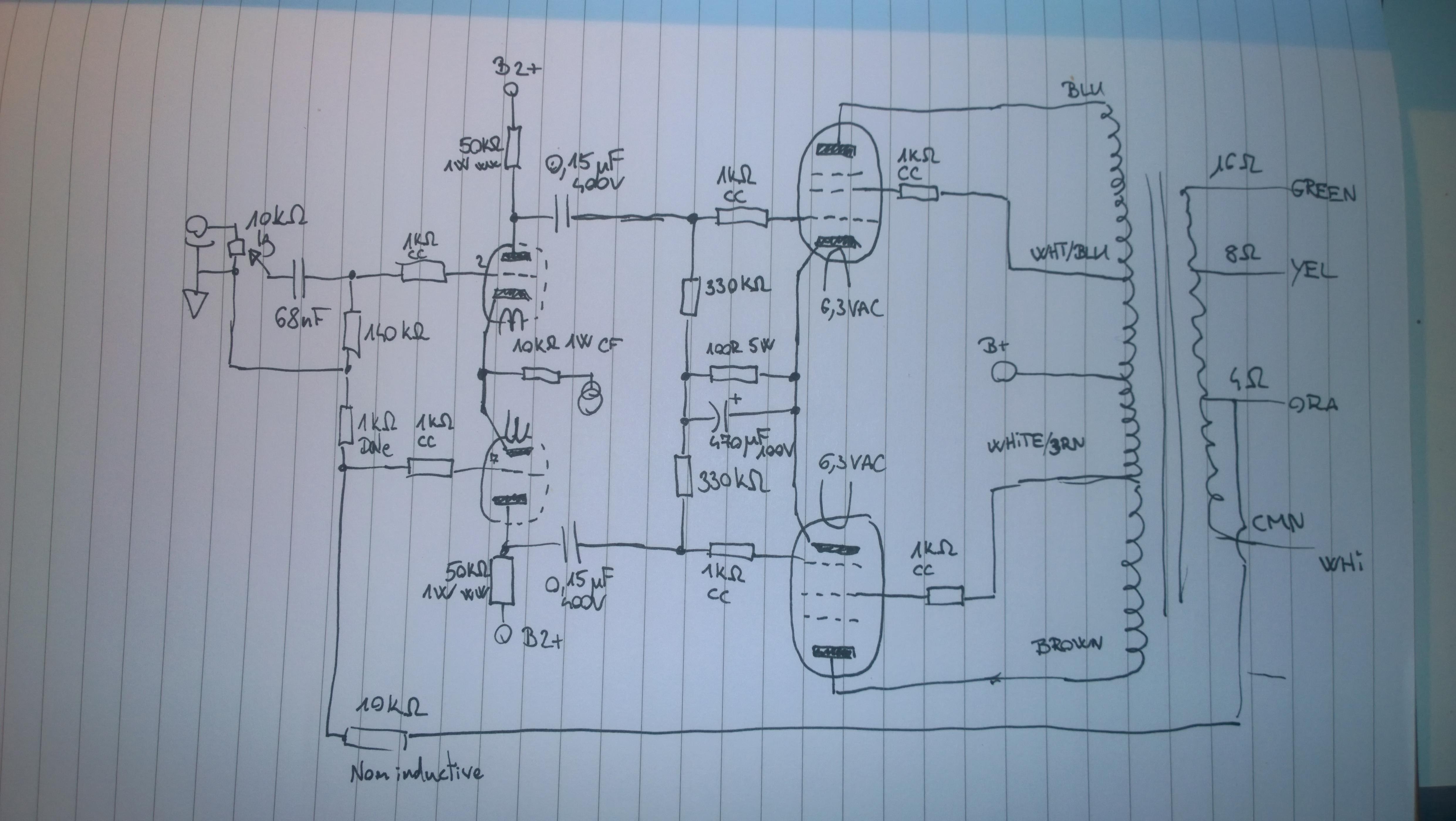

As my understanding what you just said after a day of learning, I edited your schematic What you told what has to be done. Is this correct?
Of course 6.3V would be filament and Tube type is 7591, but looking forward to understand more! 😀

The 1 K part that connects the non-inverting triode's grid to ground carries very little current. A 1/2 W., 1%, metal film part is in order. My preference is for Vishay/Dale RN65 milspec stuff, but any decent metal film part is OK.
As this amp is going use UL mode "finals", the screen grid resistors of the O/P tubes connect to the O/P transformer's UL taps, not the tube anodes. 7591 screen grids are much tougher than 'AQ5 screen grids. So, reduce the value of the screen grid resistors to 100 Ω. Let's avoid a potential accident and use 1 W. carbon film parts here.
Remember, I said combination bias. The 470 K resistors become 330 K and, while they do tie together, they don't go directly to ground. Instead, they tie to the wiper of the "idle" current trim potentiometer.
High pass poles are ALWAYS a consideration. As the total grid to ground resistance is going down, the value of the interstage coupling caps. must go up. Use 0.15 μF. interstage coupling capacitors.

Okay, understood all you said, except the Bias part. which trim potentiometer should it connect to? 😕
I'm drawing the schematic right now, and will post it as an update, Thank you for helping me Eli! 🙂
Also: where the double circle connect to In the LTP Cathode section? That is the circuit on the right side of the PSU, Using the B-?
Edit: Here it is! As I understood, this has to happen. Am I right? I could not make the bias part, as I did not understood the trim potentiometer part, so bare with me.
