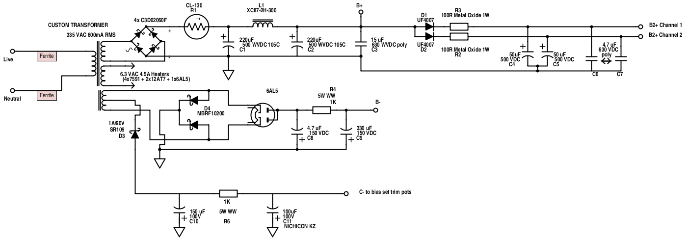

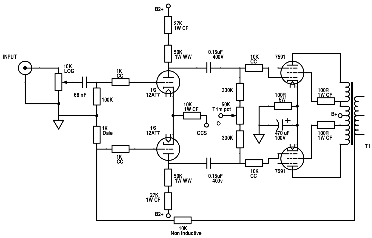

I'm interested in possibly reviving this thread. I've cobbled together a schematic of the various versions that are spread through this thread and have attached it below.
The main difference is that I'm looking to build a pair of monoblocks. I have a set of Bogen CHB-35a chassis that are going to act as donors, which means I've got a number of 7868s to use.

Do you have an o'scope? If so, you can tweak NFB phase compensation "perfectly". OTOH, a brute force method is available for someone with minimal instrumentation. Connect the speaker side of R26 to ground via a 150 pF. mica or NP0 (C0G) ceramic capacitor. The cap. shorts the NFB loop out above 80 KHz. and the natural roll off of the "iron" will set in.

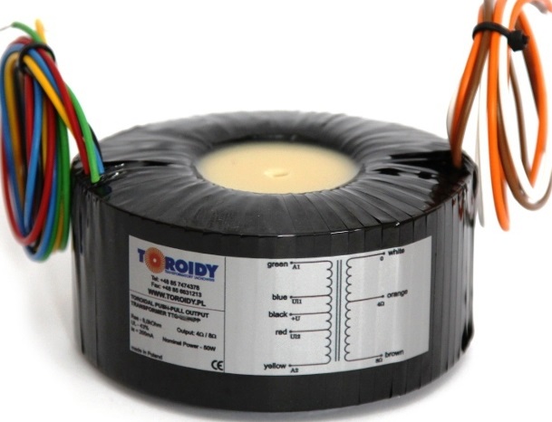

Toroidy 6K6 EL34PP
These will perform better & pricing is good.

Hm. Interesting. The only thing I would be worried about is space on the chassis and fitting it into the existing shells. I'm OK with moving things around and drilling new holes, but I would like to keep the form-factor the same. I will have to measure the chassis when I get home.
These photos aren't mine, but it's representative of the amount of space I have to work with:

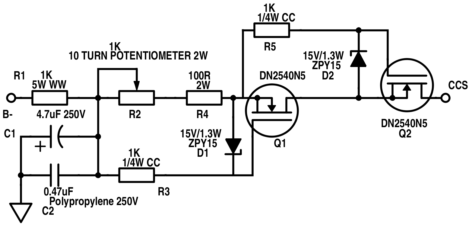

ahankinson, according to your last PDF, your schematic is incorrect. On the 12AT7 grid to ground resistor, it shouldn't be 140k but 100k. I am getting money to slowwwwwwly restart building the amplifier 🙂
Also, I gathered everything together to have a place where are the latest schematics together.

Well, after several years, and changes in houses, jobs, and countries, I'm finally ready to get back to this. I still have my old Bogen PAs that I intend to make into monoblocks with this circuit.
I have read and re-read this thread, and have assembled a schematic that has annotated voltage expectations, etc. I can share that later. I'm now working on specific parts so I can put together an order for the transformers, and I have a few questions.

This is a 325-50-0-325 on the HT winding. My intention is to use the 50v tap for the bias voltages. I have two questions about this:
1. The 50V bias tap is not a CT winding. Will the Millett "two taps" trick work with this? Or will it need to find something else? I'm also not entirely sure how it will work with the 6AL5.
2. I get an estimated 125ma current draw for two 7868/7591s and the 12AT7. The HT winding on the Hammond is 173ma. I know this will technically work, but is there enough overhead so that the PT is not stressed? (I would be more comfortable with a 200-250ma rating).

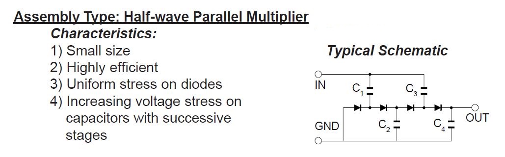

The 2 rails from 1 CT winding method will not work for obtaining multiple negative voltages from a 50 VAC bias tap. Instead, use multiple taps on a 1/2 wave parallel voltage multiplier. SS rectify the B+ and use the 2 A./5 VAC winding to feed the voltage multiplier. Tie the bias tap off.
The schematic provided is for positive polarity. So, turn the diodes around, to obtain negative voltages. Use Schottky diodes in the multiplier for lowest noise and smallest forward drop.
BTW, use the smallest valued 1st B+ filter cap. that keeps the rail voltage up. That method allows for squeezing a few extra mA. of B+ out. When cap. I/P filtration is employed, the full V/A capability of a rectifier winding can't be accessed. Charging pulse I2R heating is why. A smallish 1st filter cap. holds the heating down.
