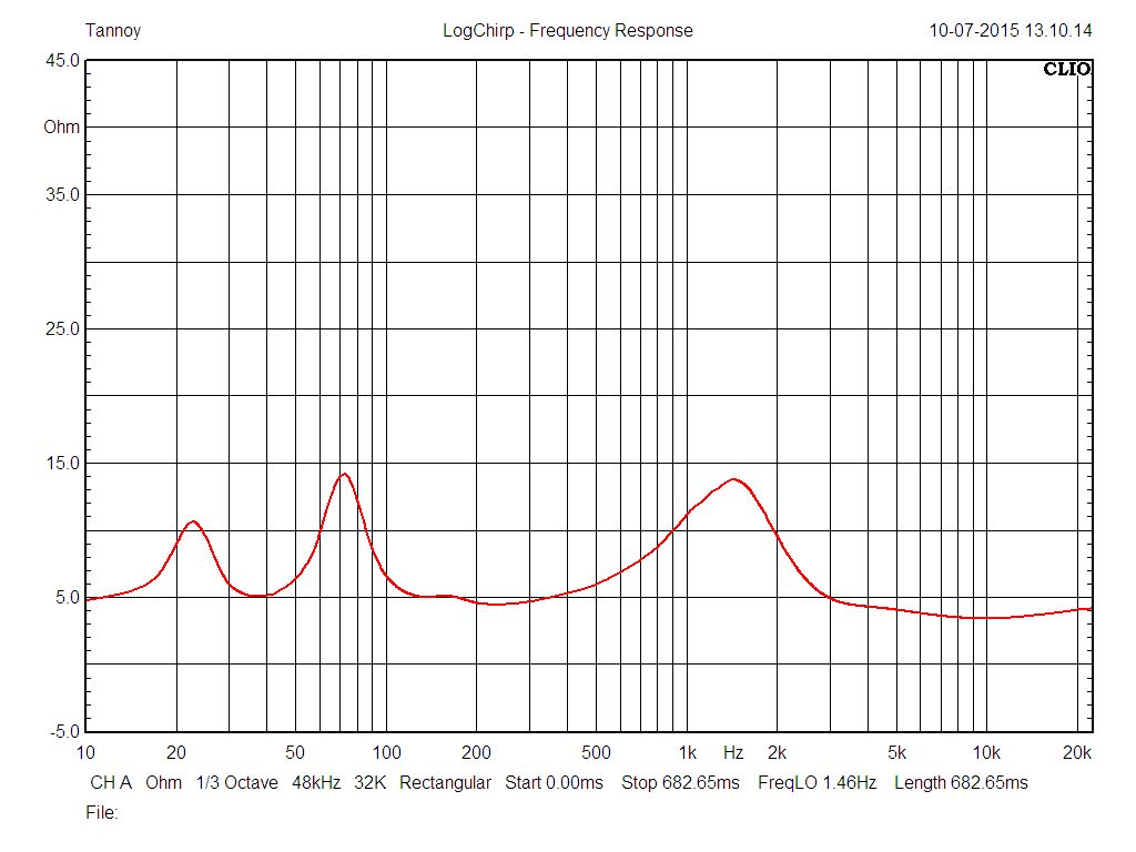

Aside from the nominal 8 Ω impedance, knowing what the impedance curve looks like is important. Substantial dips in the impedance curve, particularly in the deep bass, will require the speakers to be treated as 4 Ω, when mating them to tube/valve power amplification. If that is necessary, then the sensitivity must be derated to 88 dB., as 2.83 V. into 4 Ω is 2 W.
Let's assume that all is well and the spec. sheet is correct. Paul Joppa has provided us with a useful rule in estimating power requirements. Joppa's Rule states that in "average" sized listening spaces an amp/speaker combo should be capable of producing 102 dB. SPL peaks at a 1 M. distance. Applying the rule to 91 dB. yields upwards of 30 WPC. If derating is necessary, upwards of 60 WPC is in order.

Unluckily I could not find anything about the mercury's impedance curve

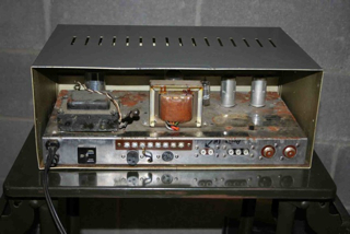

- Dynaco ST35, or ST70 for higher power as suggested by Eli.. or rebuild one to save budget and less headache. Get one from Ebay and rebuild, just make sure transformers are intact

The nominal impedance of 8 ohms specified by Tannoy is (IMO) rubbish. A specified nominal impedance of 6 ohms could not be challenged.
Let's treat the speakers as being 4 ohm and derate the claimed sensitivity to 88 dB. JMO, better to be conservative with damping factor and power needs than have a project that doesn't quite get the job done.
