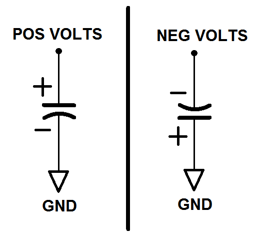

Are the capacitors on the B- and C- are in good orientation? Seems so weird for me, if anyone can explain why I need to connect it the other way that'd be great!
The positive side of electrolytic caps. get grounded, when the rail is negative.
We'd better make sure this is clear to you, or else big, messy bangs can happen. I've attached a picture. I hope it helps.
