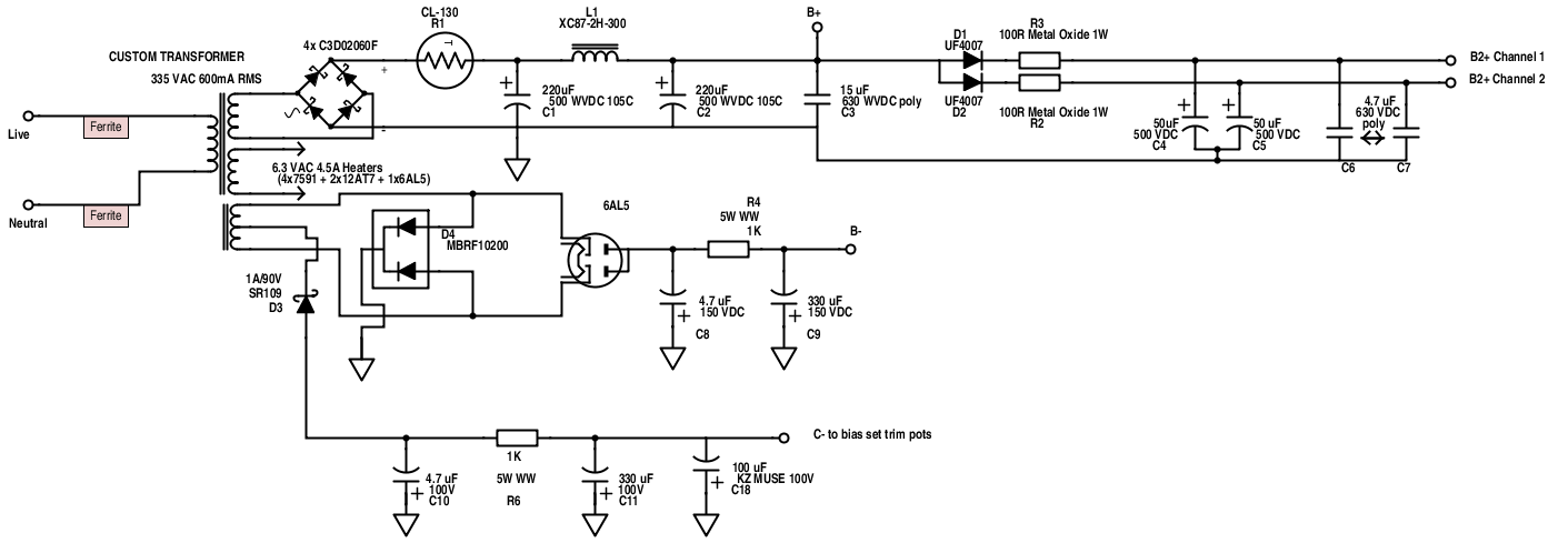

In the schematic in post 174, what is the purpose of D1 and D2?
D3 in the center tap of the 70VCT winding looks like it floats the center tap below ground. But then the anodes of D4 and the reservoir and the positive ends of filter caps C8 and C9 are grounded to 0 volts. Problem? Should those be 'grounded' to the anode end of diode D3? (I've never seen this done before, and I'm not understanding exactly how it would work...)
The schematic doesn't show it, but you'll want to create a center tap out of 47R 1W resistors for the 6.3V AC winding (for the heaters). You may also want to bypass that winding to ground with two 0.01uF polypropylene film caps (to bypass RF). Maybe cheap ceramic disc caps of the same value would do just as well?
Ron,
D1 and D2 are "check valves" that are part of the decoupling networks. Volts are at a premium here and the necessary small value resistors alone will not do an adequate job. The diodes ensure energy enters the decoupling caps., but does not leave.
The 2 rails from a single CT winding idea was publicized by Pete Millett. Twin Schottky D4 forms the connection to ground for both rails. The "tall" rail is a full wave bridge across the entire CT winding. The "short" rail is FWCT rectified. While Schottky D3 theoretically could be omitted, its presence is insurance against several problems.

I've been putting off reviewing the latest PSU schematic. Some minor changes are forthcoming.

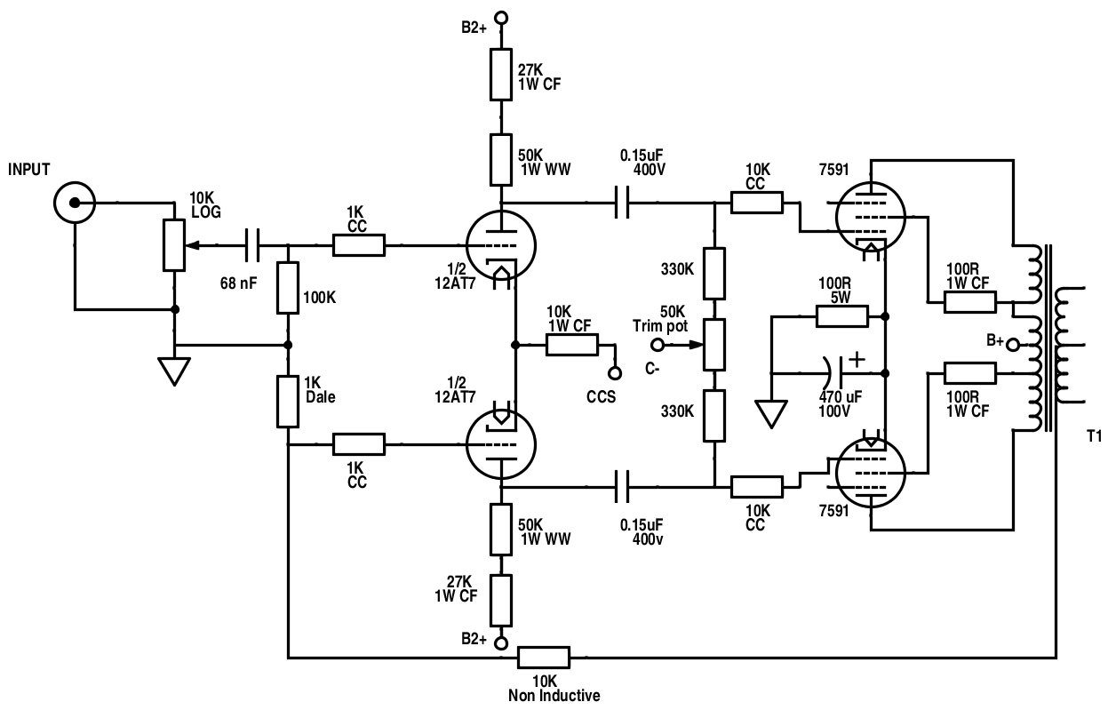

Please look carefully at Hammond's wiring diagram. Notice the dots on the blue (primary) and black (secondary) leads. Those dots are phasing indicators. The transformer must not invert phase. Therefore, the leg associated with the LTP's inverting leg, connects to the brown and brown/yellow primary leads.

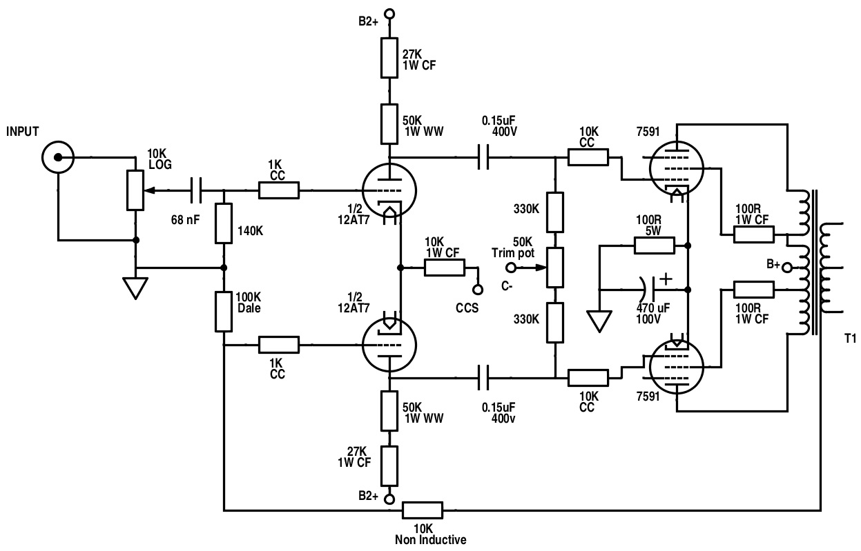

"Money talks and bull$hit walks." Use the Hammond O/P "iron". We'll make sure nothing bad happens by moving the "corner" frequency of the I/P high pass pole upwards. Change value of the grid to ground resistor associated with the inverting triode of the LTP to 100 Kohms. That value combines with the 0.068 μF. cap. to yield a F3 of 23.4 Hz.
Very, very, little musical info. can be found in human hearing's 1st octave. The lowest note a "normal" double bass makes is 41 Hz. 😉
I am not impatient, but I really have to orer the Irons Eli! If you would mind telling me if I can order the choke/O/P Irons, that'd be great! 🙂 I am really excited about that review of the PSU!
Okay, recalculated 🙂 🙂 🙂

I hope you meant it like so! 🙂
