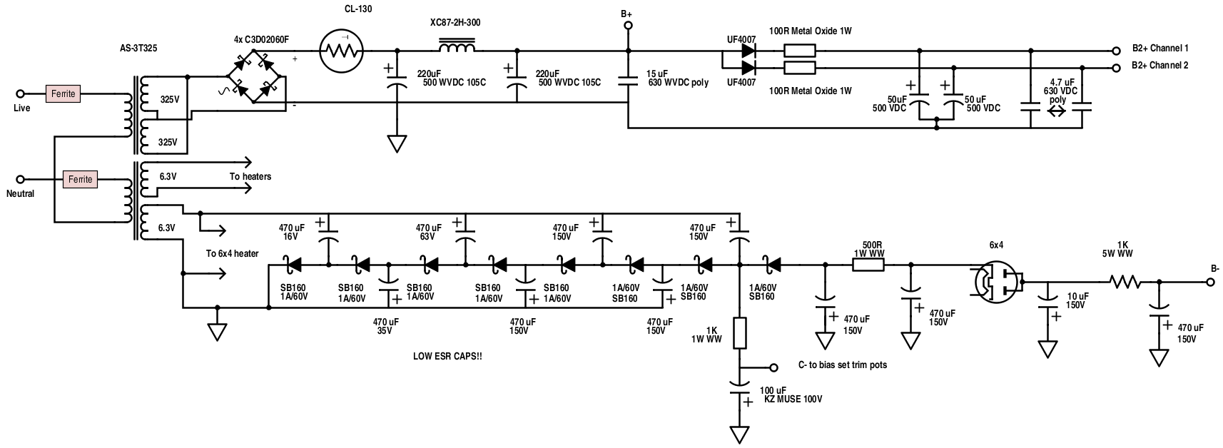

I would take this to mean that you need a final decoupling RC network after your last 470 muF capacitor, before the 6X4. I'm not sure what the best values would be off the top of my head, but you would drop six volts with a 500 Ohm resistor (500 Ohms x .012 Amp). A 1KOhm would seem to drop more than I would be comfortable with, but Eli and others may be fine with that. You could combine that with another of your 470 muF caps if you have several. A 100 muF cap might be okay, but I haven't figured the math.
If, after adding this additional decoupling network, the voltages are all too low to run the bias and/or the CCS, then add more stages to the multiplier.
--Jeff

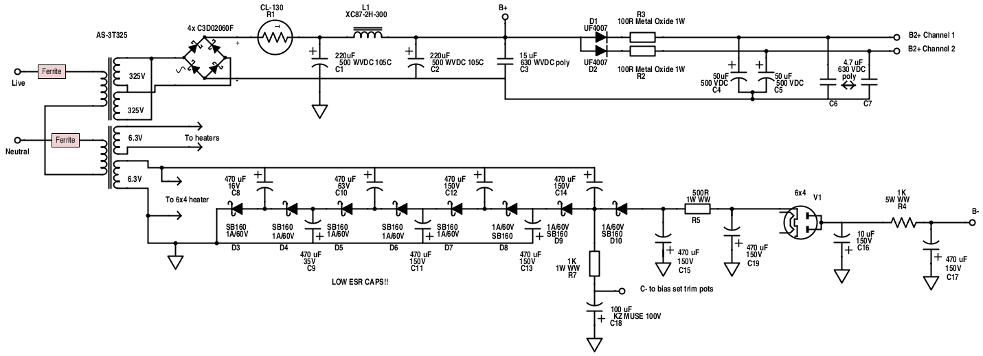

Okay, made it, I hope this is what you tought about Eli! 🙂 Thanks Jeff for the explanation, but I still don't understand the second part Eli wrote. 😕
Here is the fixed PSU with decoupling RC Network!
The second part of what Eli said is rather complex to answer clearly but in short, there is a certain negative voltage that has to be applied to the junction of the 330k grid leak resistors. Let's assume this is -10volts. What Eli is saying is that -10v should not be obtained where the trimpot is at the ends of the adjustment. Ideally it should around the middle. To allow this adjustment, C- should be around -20v. Subsequently where you tap the voltage multiplier should produce around -20v. This is not necessarily where it is shown on your schematic.

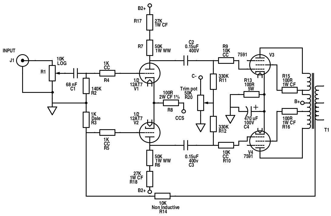

First, the way the 7591's screen grid is connected to taps on the output transformer is called ultra-linear operation.
If i have to guess, Eli is going for the operation design on the spec sheet like below:
425volts plate supply voltage looks in line with your 325v transformer secondary. (325VAC * 1.414 = 460VDC, taking account some voltage drop on the CL-130 and choke, perhaps we should arrive at something close to 425VDC).
Now, your design is a mix between fixed bias (because you have C- as bias voltage on the grid) and cathode bias (because you have the 100R cathode resistor, this should be 185R if your amp is following the cathode bias design above).
Now, here comes the fun part.. MATH. Cathode bias means the grid is at zero volts and the tube is biased by elevating the cathode voltage by applying cathode resistor. How high is the cathode voltage? Notice that plate current at idle is 88mA. This is for one tube. There is a pair of 7591 tube having one common cathode resistor. This means at the top of the 185R resistor, there should be (88mA x 2) * 185R = 32.6V. Again, per spec sheet design above, this assumes cathode bias operation.
Since your cathode bias is only 100R, the voltage developed is only (88mA x 2) * 100R = 17.6V. This means there is difference of 17.6V-32.6V = -15VDC. This is what should be on the junction of the 330k grid resistors. Per Eli's suggestion, C- should then be around -30 VDC.
There are many ways to get this -30VDC from 6.3V heater winding. Your (and Eli's) way is to have a voltage multiplier. 6.3VAC rectified to DC is approx 8.9VDC (ignoring voltage drop on the diodes). 30VDC is about four times of 8.9VDC. This means you need voltage quadrupler. Google this and there you have designs for how much diode+cap combination you need on the multiplier.
How i would do it is perhaps lazier. I would rectify the 6.3VAC to DC with fullwave rectifier and add perhaps 100uF filter capacitor. From there, i will feed it to some boost converter to increase the 8.9VDC to 30VDC. Here is one example:
