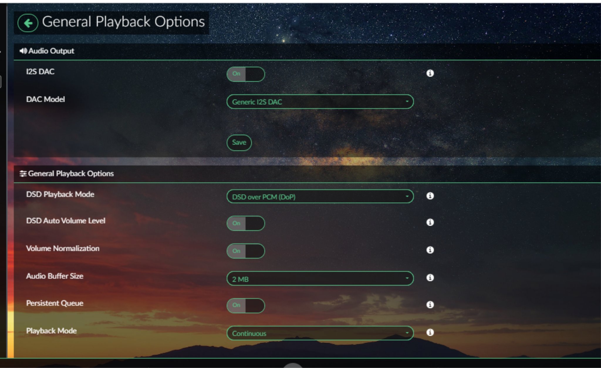

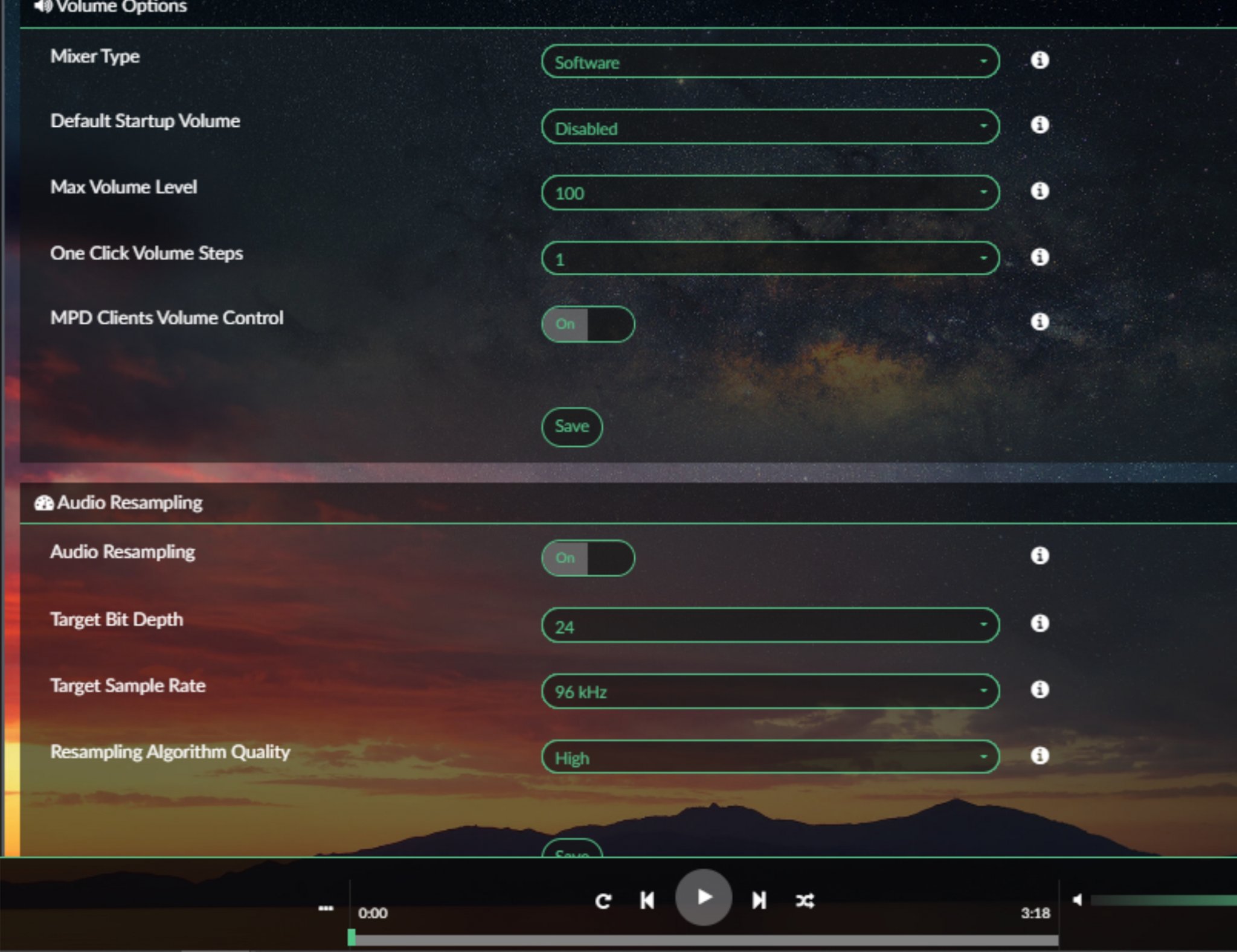

Dakle, zvuk je samo izobličen? Jeste li postavili 96k ponovno uzorkovanje chipdip DAC-a?
So there is sound just distorted? Did you set 96k resampling a chipdip DAC?
Thank you @ppp000
I think I set it up well
I'll wait for it to arrive

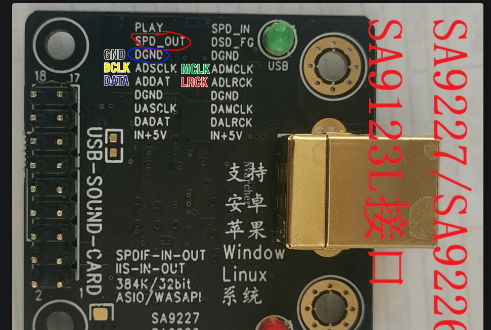

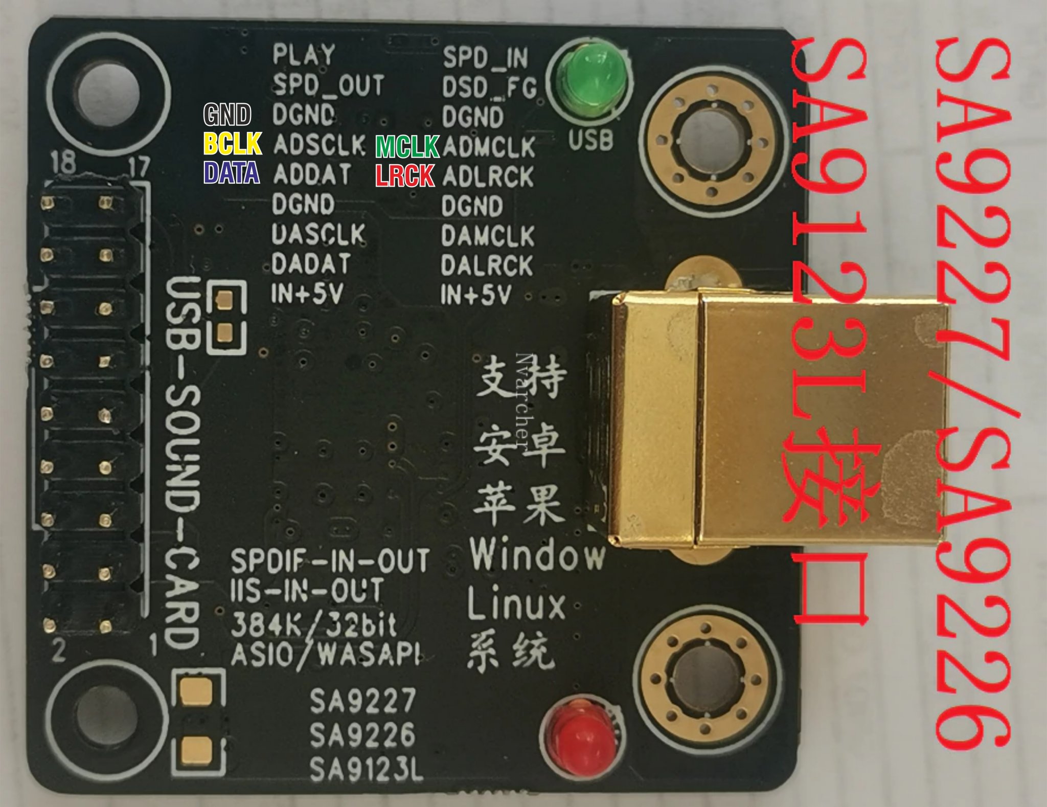

Hello ppp000
I bought
Nvarcher USB sound card playback recording two-way I2S IIS SPDIF
I can't get a signal on the ADSP-21489
I connected it with a USB sound card
(picture BRAVO SA9227-ADSP-21489)
I tried the way I connected it with AKM4495, I don't get a signal.
The USB sound card is correct
I connected it with DAC AKM4495 and it works
(picture BRAVO SA9227-AKM4495)
How should I connect USB sound card BRAVO SA9227 with ADSP-21489

Same way as you connected akm4495, first photo is for input
I tried the same connection method as with the AKM4495, but I don't get a signal.
Is Nvarcher USB sound card playback recording two-way I2S IIS set in slave mode.

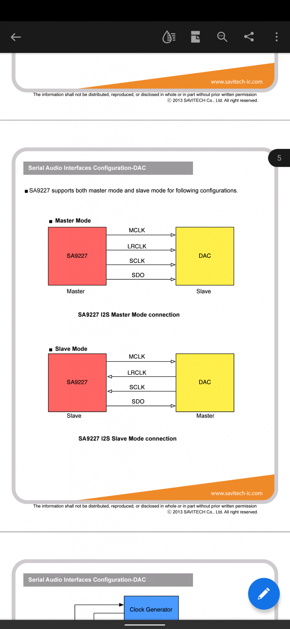

So output(master) of USB to input(master) of sharc. If what vendor say is true it won't work. You need slave output on USB to connect to sharc board.

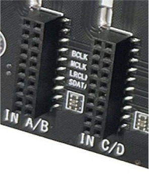

Now I also noticed that you have pin description on your board? Bclk mclk lrck data?

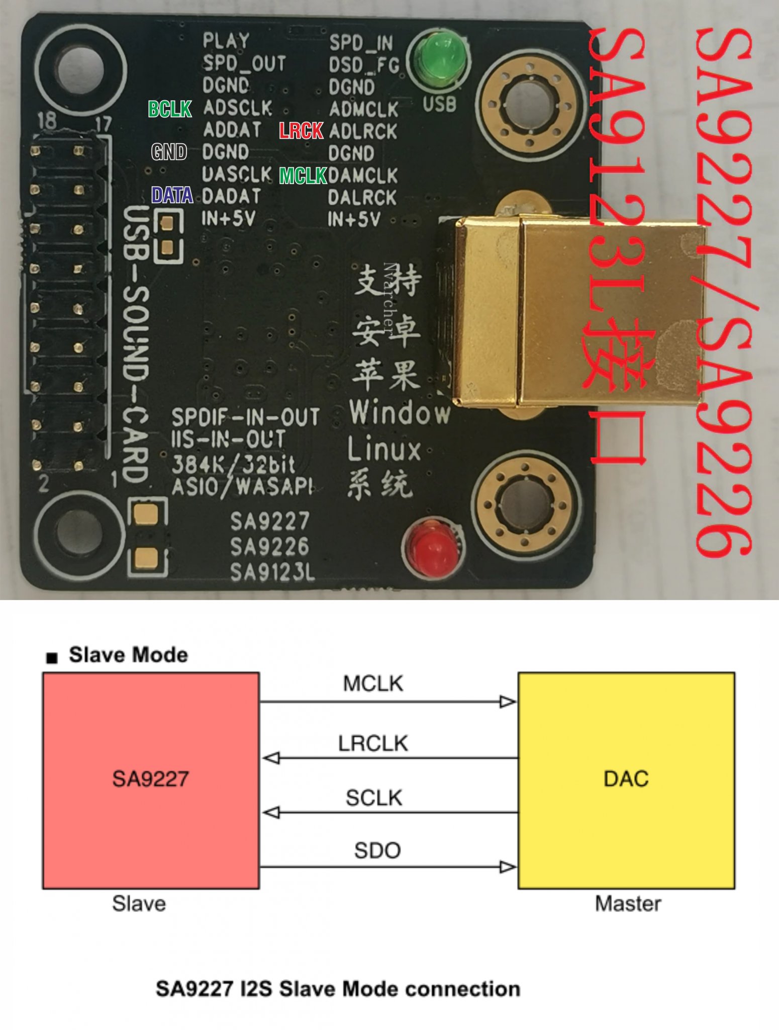

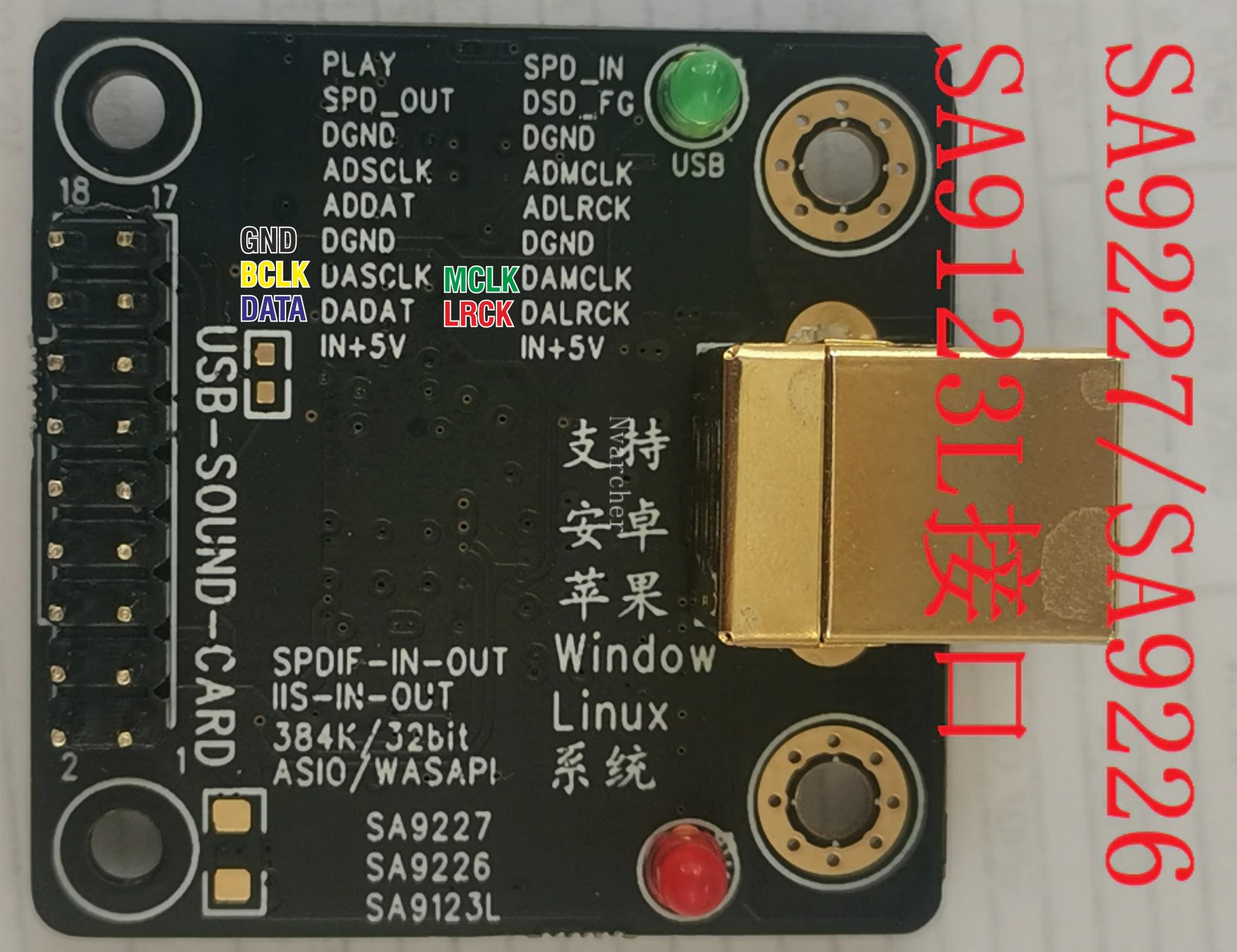

Labels on board IN - AB are not correct BLCK, LRCK, MLCK, DATA
I tried to connect slave mode image slave01
I'm getting noise
They didn't understand me from Allexpress regarding the USB interface.
I repeat that I do not understand electronics and programming.
So I need a recommendation for the choice of USB interface slave mode that I can connect (I2S) with ADSP 21489.

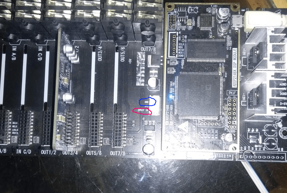

I saw on diyaudio.com that Revber posted a picture of how he connected the SA9227 to the ADSP 21489

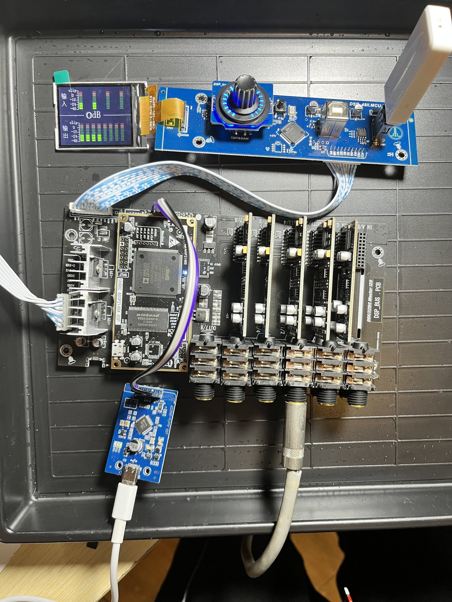

What revber posted is new revision of dsp board. DSP there is in I2S slave mode with ASRC. You seem to have older version like me, cause i see STM chip on your board.
Description of SA9227 board seems same as yours. Slave input, Master output. Sent screenshot of SA9227 datasheet previously, should be possible to run i2s output in slave mode.. try do research or make topic here on diyaudio regarding that.
