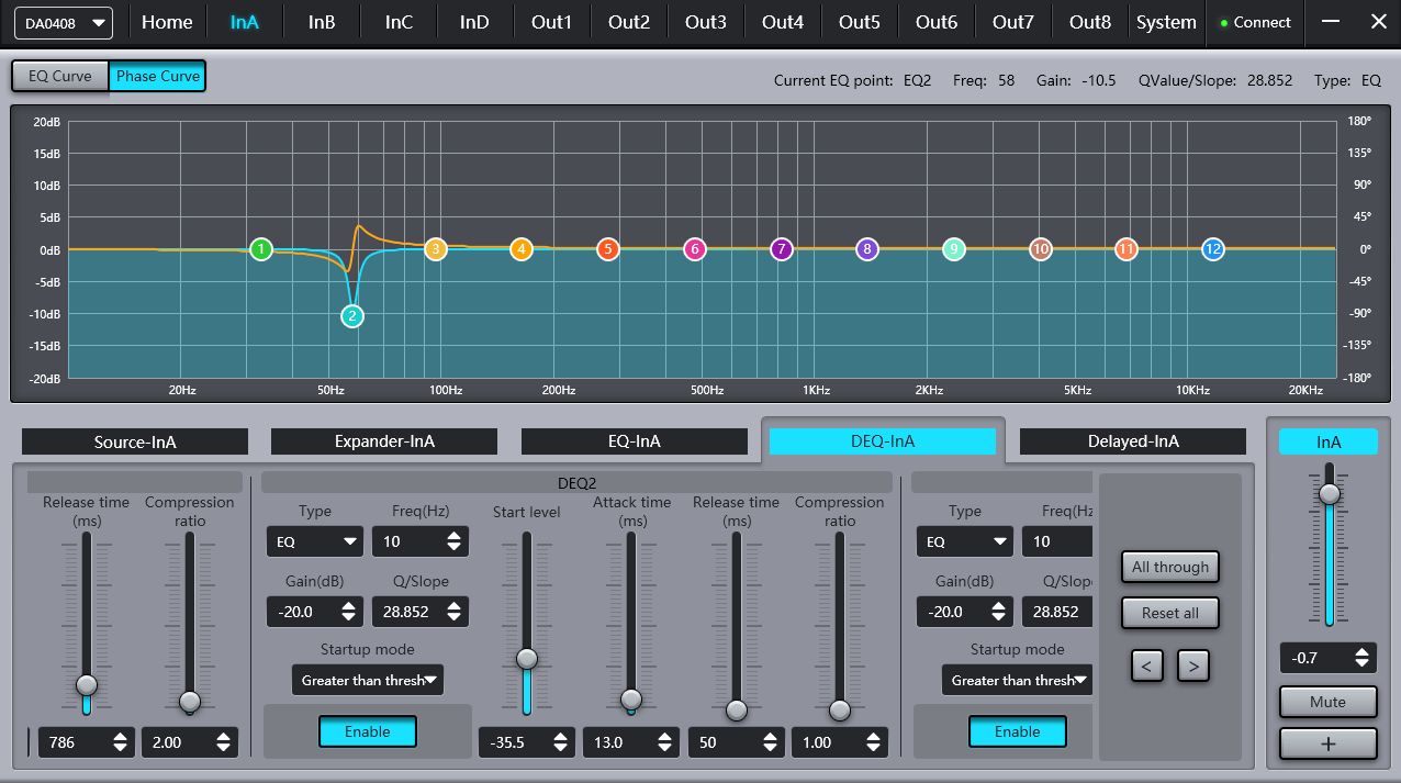

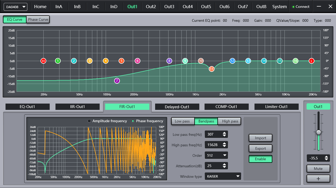

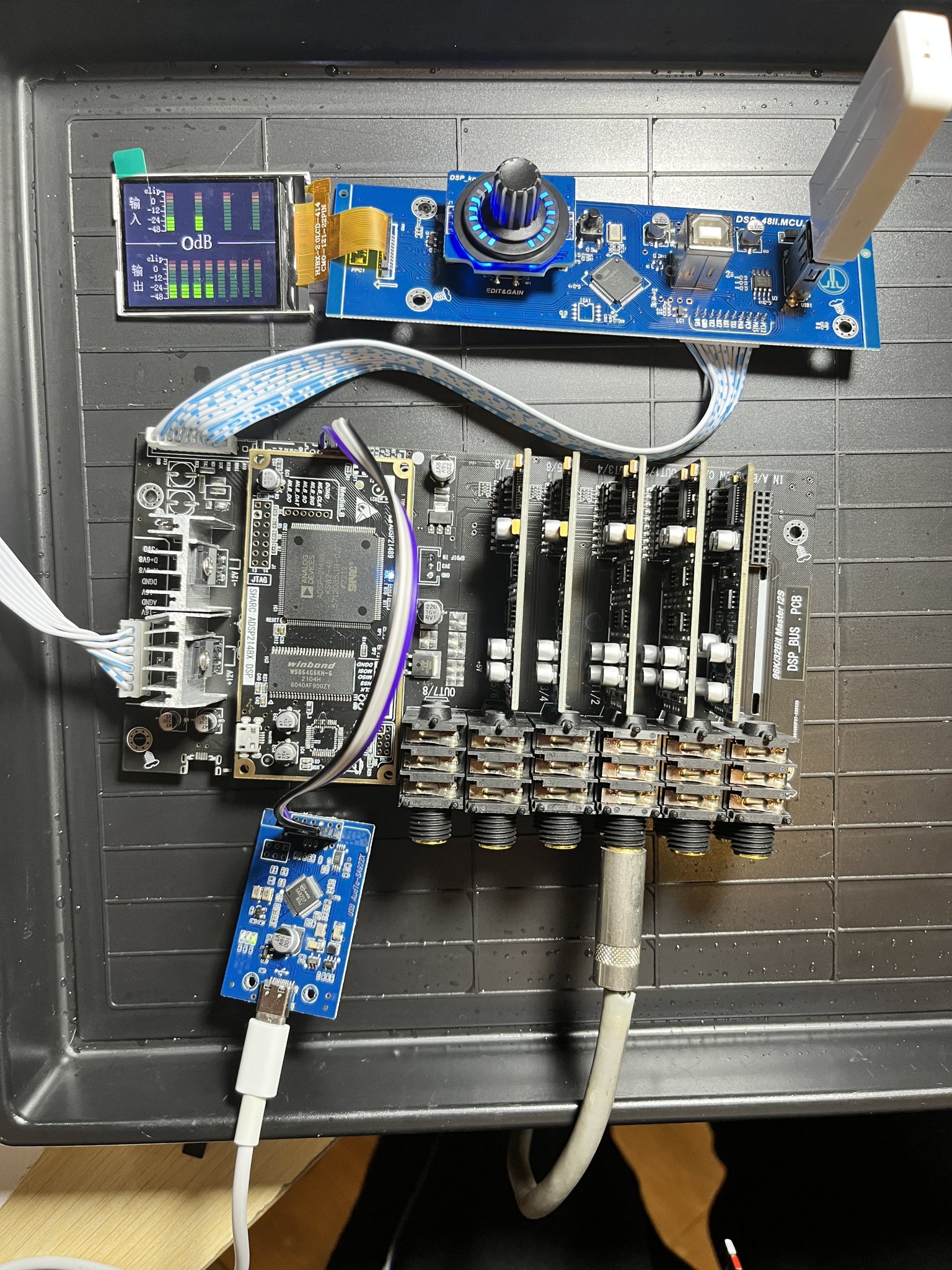

新的adsp21489板可以支持512tap FIR;添加了 DEQ。有一个LCD用于调整和显示。采样率可以在 96KHz 或 192Khz 之间切换。提供一个 I2S 主模式输入接口和四个 I2S 从模式输入接口。主模式接口可以连接蓝牙或usbaudio的主模式模式。采样率支持8khz-768khz。但是,我没有 768khz 的声源。384khz可以完美播放。
感谢您的信息...您已经尝试过使用此遥控器吗?

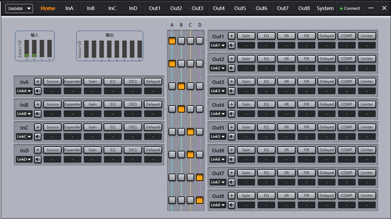

I like the UI. Do you have the updated files for this? The ram is newer than mine, but market equivalent because the JH is obsolete. But that should not be an issue.
Do you know if any other changes have been made?
Unfortunately, the firmware cannot be directly updated. This is a brand-new design. It needs to be sent back to the supplier to modify the program and hardware, because it needs to purchase a separate control panel to use.

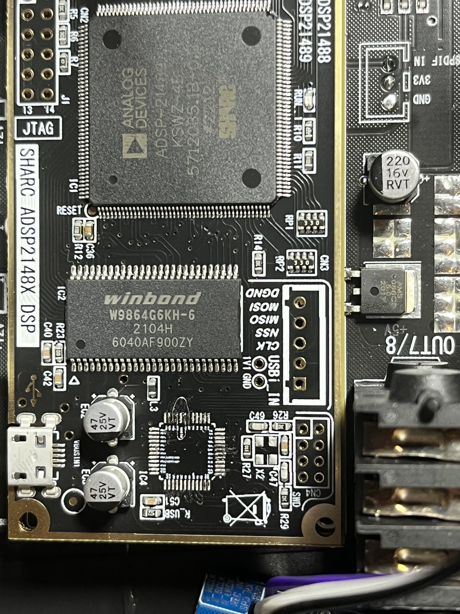

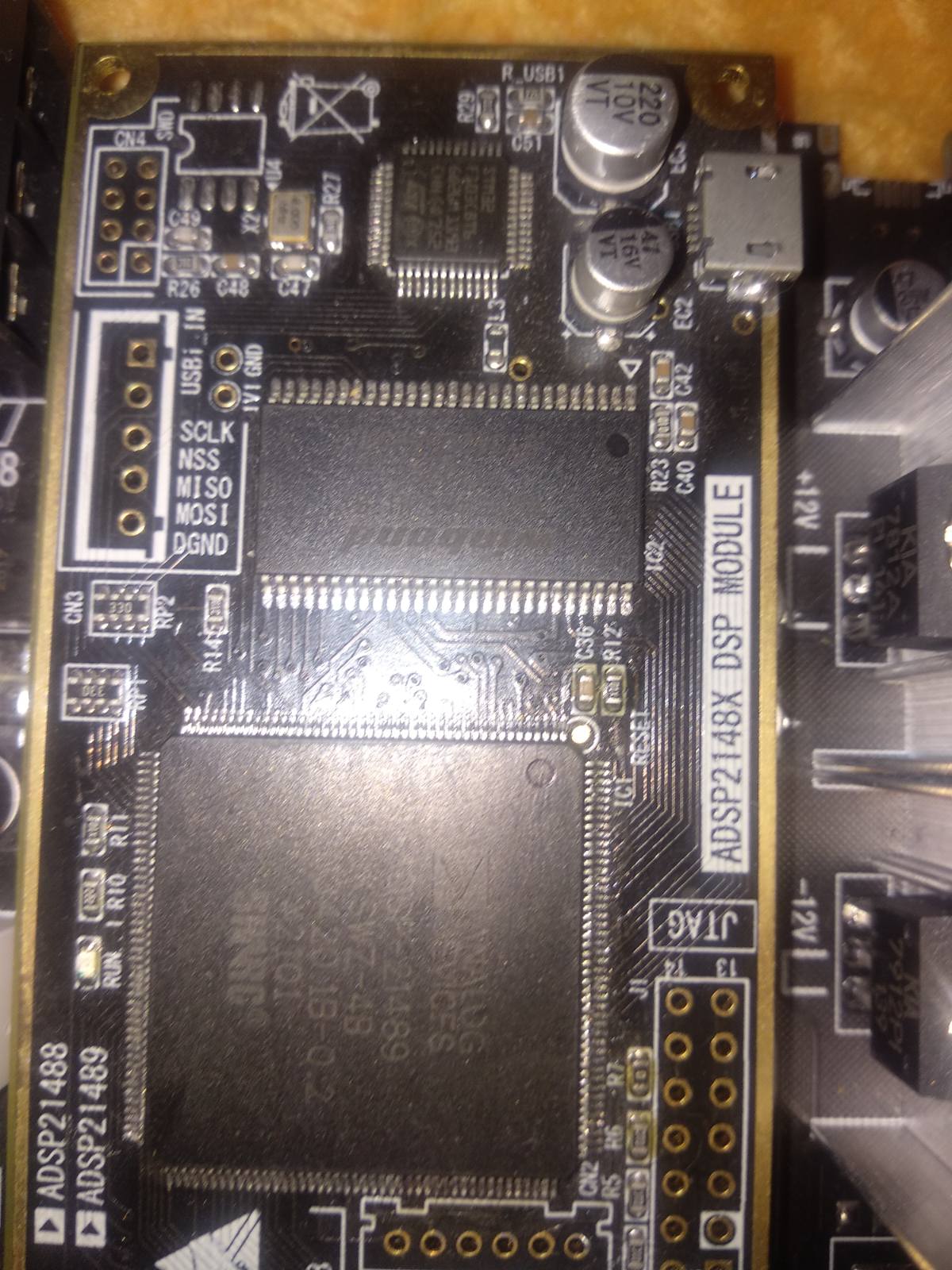

OK, so the board is different. The chip is missing on there that is present on mine and the corner near the CN4 part has been reworked. My bad.
Now, is that essential related to getting the UI to work with the older boards? Also, can the mfr. start marking the boards with revision numbers to help?
Also, as to the USB card and the control panel, that would be simple soldering on my board to implement. Why would they not make it where there would be backwards compatibility with the new older design with the TRS 6.3mm plugs?
The MCU on the old board is stm32f103c8t6, and the ram is not enough. Therefore, a larger capacity MCU is required to support the new DSP program. Therefore, the firmware cannot be updated, and can only be changed by the manufacturer, or a new DSP and front control panel can be purchased.

You said the ram is not enough. The ram on the new board has the same specs as the ram on my old board.

My board has the W9864JH-6 winbond 8MB memory on it. The new board you showed has the W9863G6KH-6 winbond 8MB sdram on it. There wasn't an increase in memory.
Let's assume I own an Atten ST-862D. Let's assume I can do my own hot air rework. What STM chip is needed? Also, what is needed to upgrade the memory to say either of these two 64MB chips?

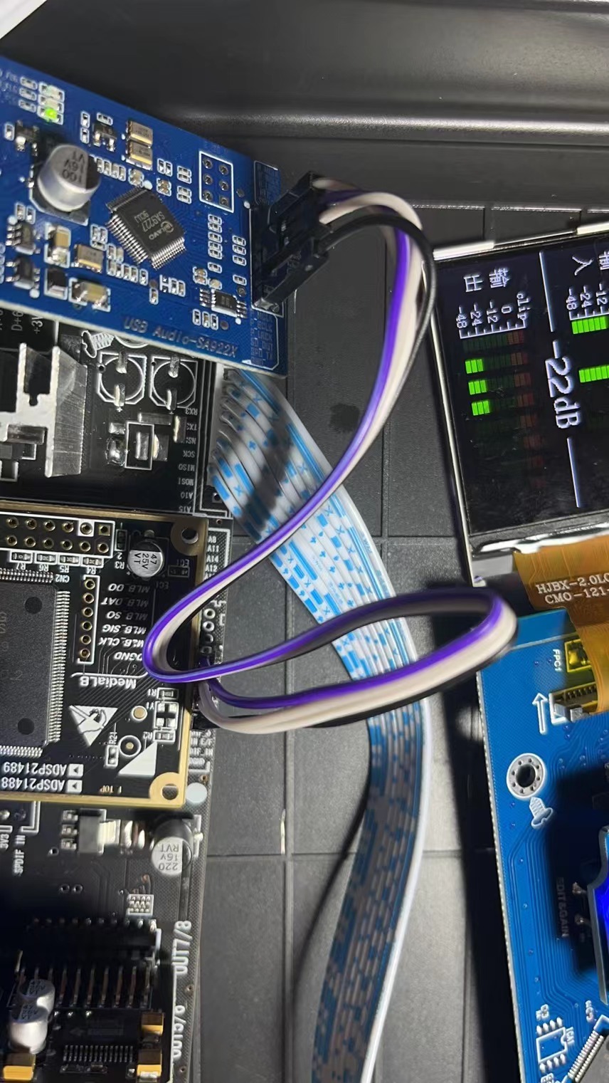

I have tried using I2S to connect Lusya XU208 Xmos USB Digital Audio Interface U8
https://www.aliexpress.com/item/32882578851.html?spm=a2g0o.store_pc_groupList.8148356.4.74c7235bxc48A8&pdp_npi=2@dis!EUR!€ 57,21!€ 37,75!!!!!@210318bb16681685415292374e47ea!65628381598!sh
with ADSP-21489 Audio Processor 4 In 8 Out
(I have tried two ways, the photo shows how I connected)
But I only got noise at the output.
Can you help me get sound using I2S XU208 Xmos USB? Can you show me a picture of how you connected your devices?

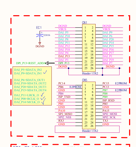

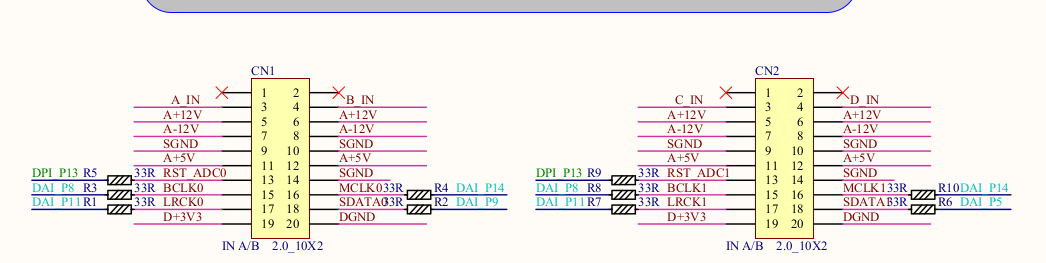

I use IN1 or IN2 so DAI_P5 or DAI_P9 rest looks the same
More important.. is your XMOS configured as I2S slave?

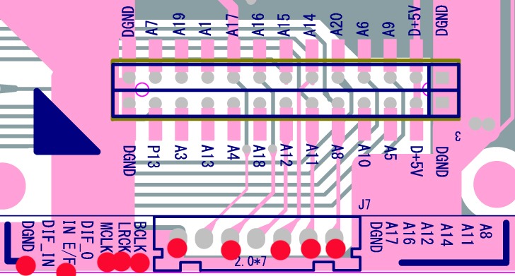

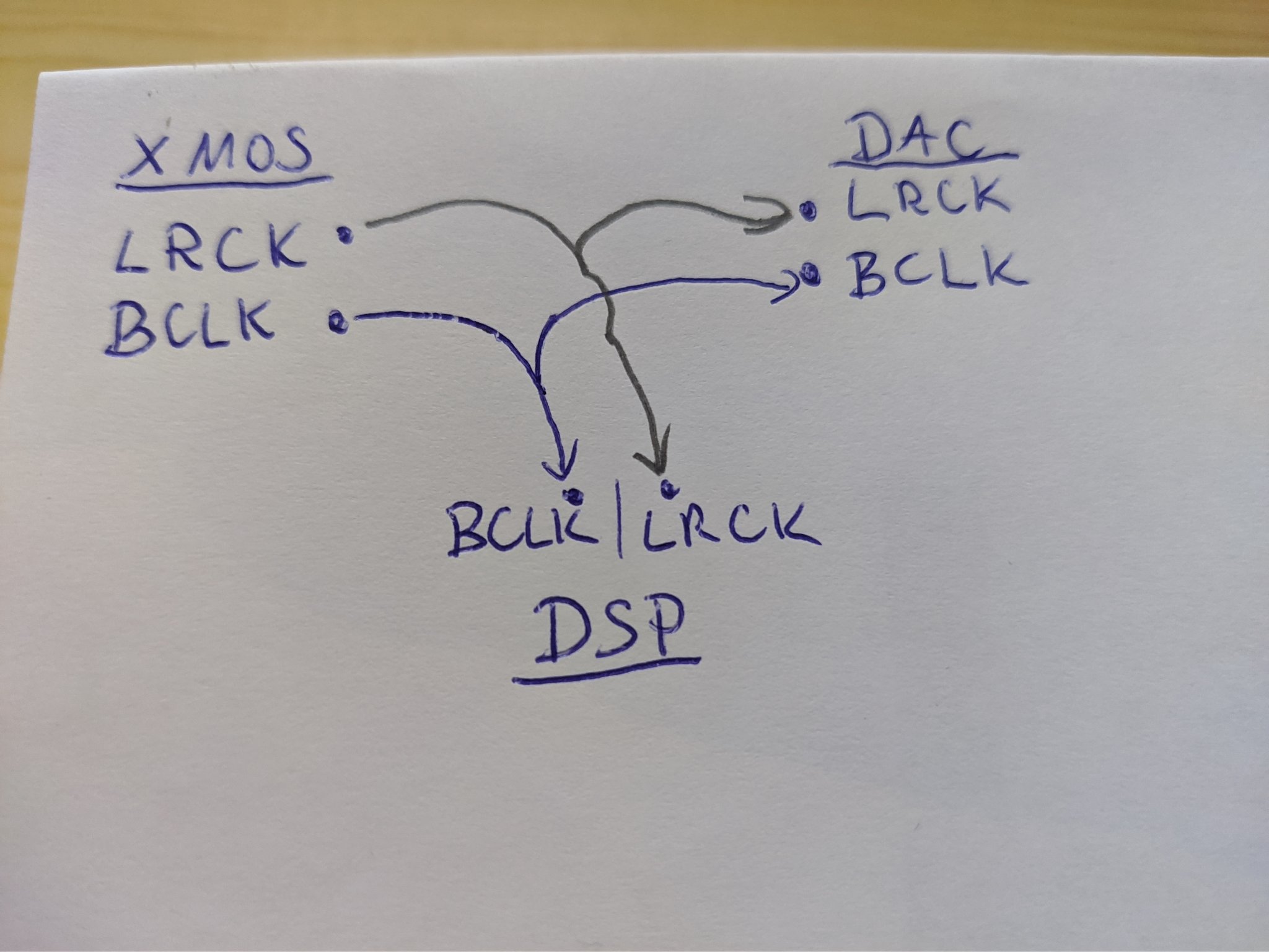

MCLK, BCLK, LRCK - use same pins for both XMOS and DAC ie. like 2 cables go to 1 pin, end of first cable go dac, other end of cable go to XMOS.
I could make photo but it wont help you.. i use just board with dsp + custom pcb i made and you seem to use their mainboard also.
Will be easier if you make photos🙂
And you give very little information
Which version of dsp board you have? -with or without stm chip? (see photo)
Do you use dsp with provided firmware or you have USBi and use sigmastudio? (custom firmware)
You told that there is noise when you connect xmos.. in my case when xmos was in master mode there was just silence - is your XMOS out set to 96khz?
Not sure how you can select Lusya XU208 in slave or master mode, tried to look quickly but didnt find any info.. can be easy as desoldering oscillator.. or other way.. you need to look on your own.
On CM6632A there is config tool available, my board was attached with 2 firmware files - slave and master mode, flashed via usb

Im guessing you dont have ADC for this board? Then use CN1 or CN2 (thats in A/B or in C/D) to connect USB
First I would check xmos you already have, connect it properly, make sure output is 96khz and try with MCLK connected and disconnected. I read somewhere that if 2 devices are in master mode or both in slave mode it can work also (for me this didnt work.. but maybe for you will)
