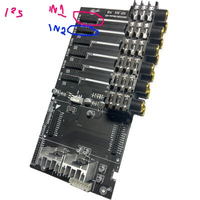

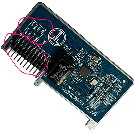

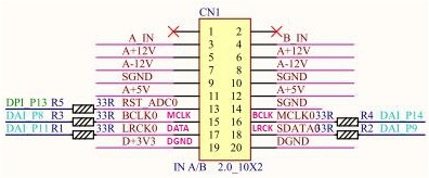

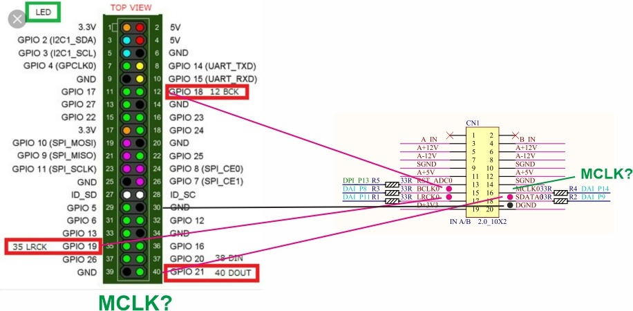

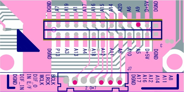

No worries. There are six i2s connectors on main board 4 for outputs and 2 for input. They are used for expansion 'cards' like DAC, ADC and spdif I linked. See photo with pinout.
Thats how I would try to connect RPi on this board. Of course I cannot guarantee it will work.. It should but you never know.

See your point here ! If i will buy its safest to buy a separat converter box spdif to usb or somthing like that….?

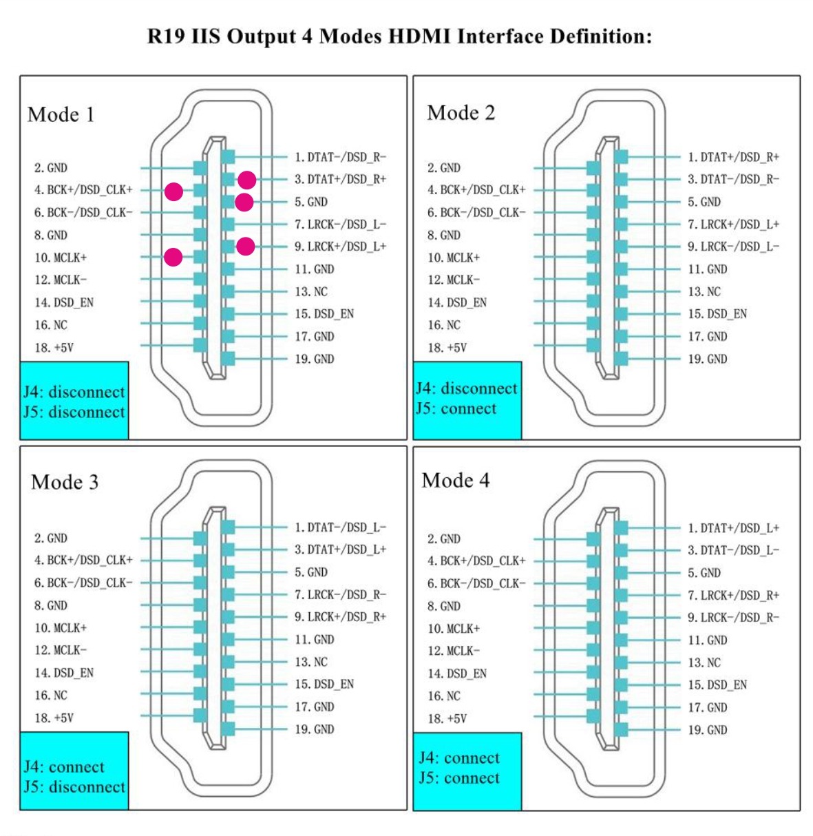

R19 Raspberry Pi Pi4 3B 4B HIFI digital broadcast webcast optical fiber coaxial I2S 384K DSD512
use in I2S slave mode with ADSP-21489 Audio Processor 4 In 8 Out

So how you want it all connected? And what you gonna do with i2s over hdmi?

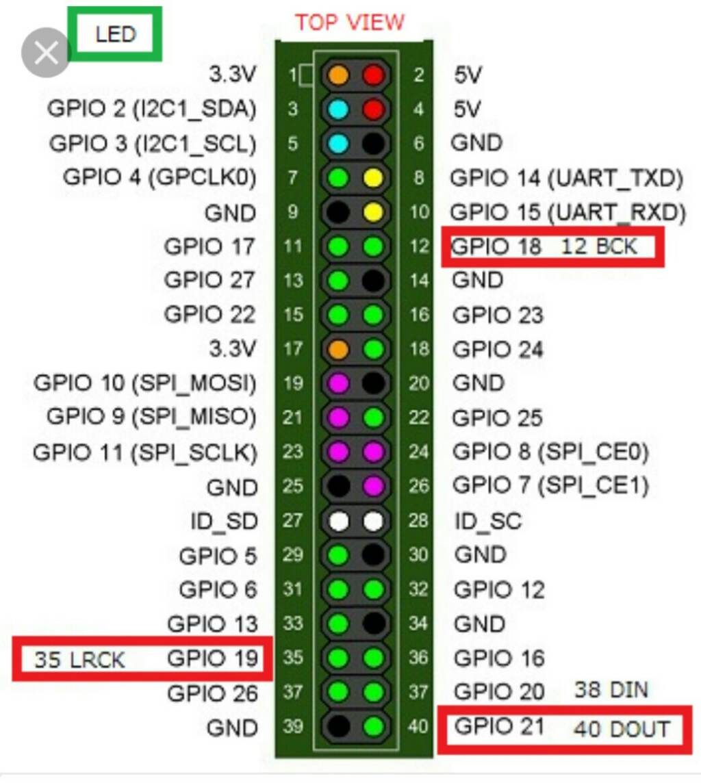

RPi have one i2s connection. Look at pinout. And you connect Rpi to one of inputs on dsp board - IN A/B or IN C/D look for pinout on schematics for those.

Then in Moode Audio or volumio or whatever you choose chipdip-dac(99% sure it was this one) as output, and set resampling to 96khz.
Its tested and working

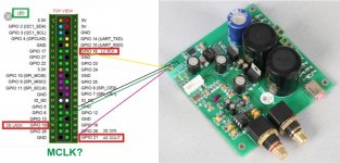

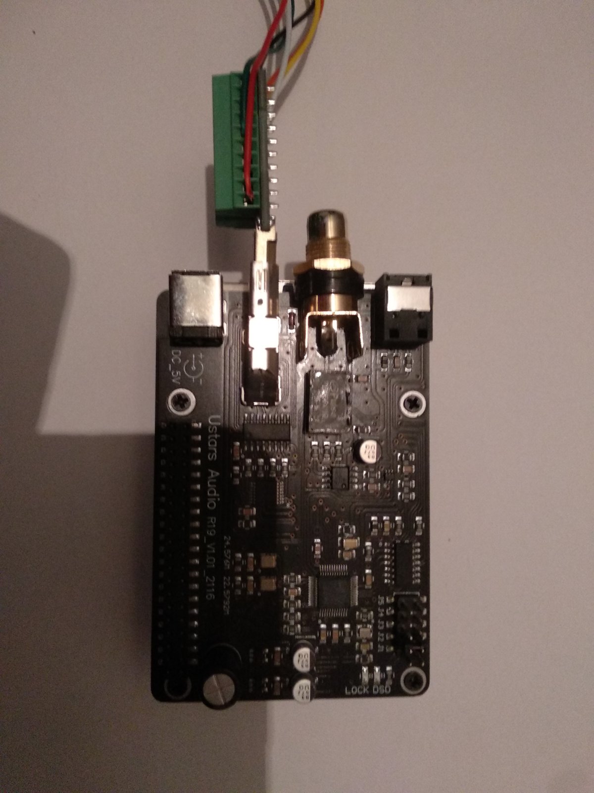

Is it OK?
So you connecd RPI to DAC same way. If I remember good mck was not needed. Yeah double check orientation if you connect right pins on DSP board.

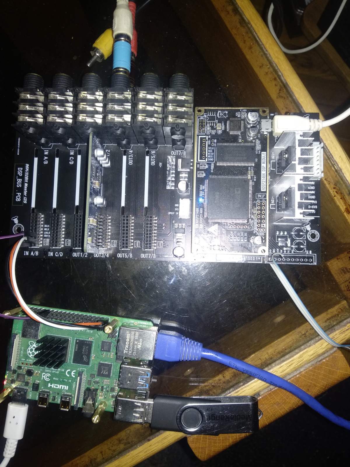

I get nothing on CN1 AB IN
I connected the mirror
As before, I get intermittent noise that mixes with the music
