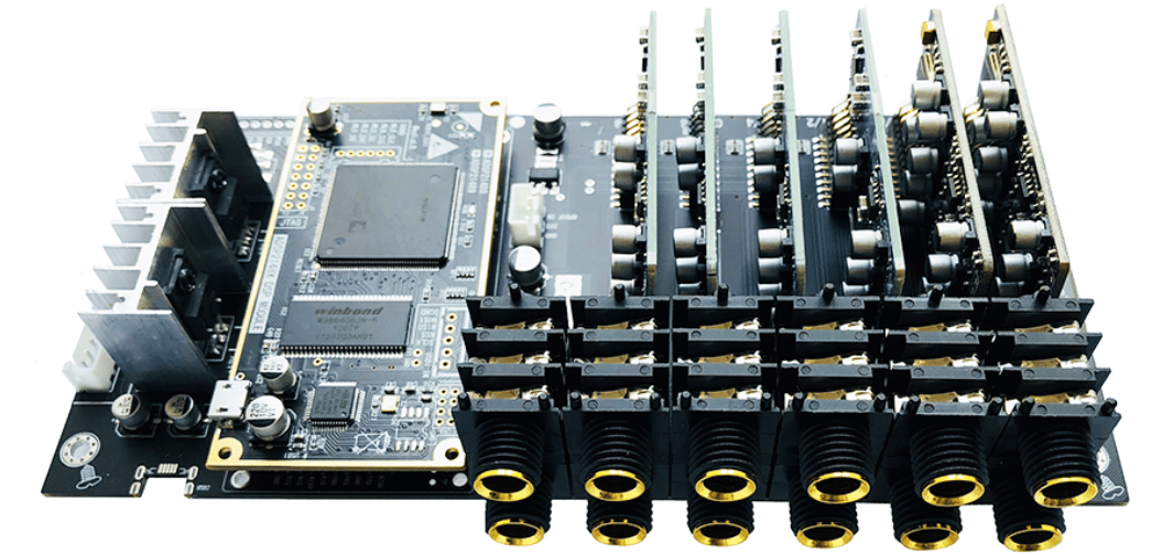

Cheap ADSP21489 + 4in / 6out PCM1798 board
This is a very interesting solution. Have a few questions hoping to find some answers.
Thanks a million!
1, Has anyone made some measurements of general performance? THD+N etc..
2, Has anyone purchased the more expensive, ESS9028+OPA1612 version yet?
3, Can I assume that the included software just work?
4,. Is there Toslink interface card for it by anychance? Perhaps an XMOS USB audio interface that plugs right into the motherboard?

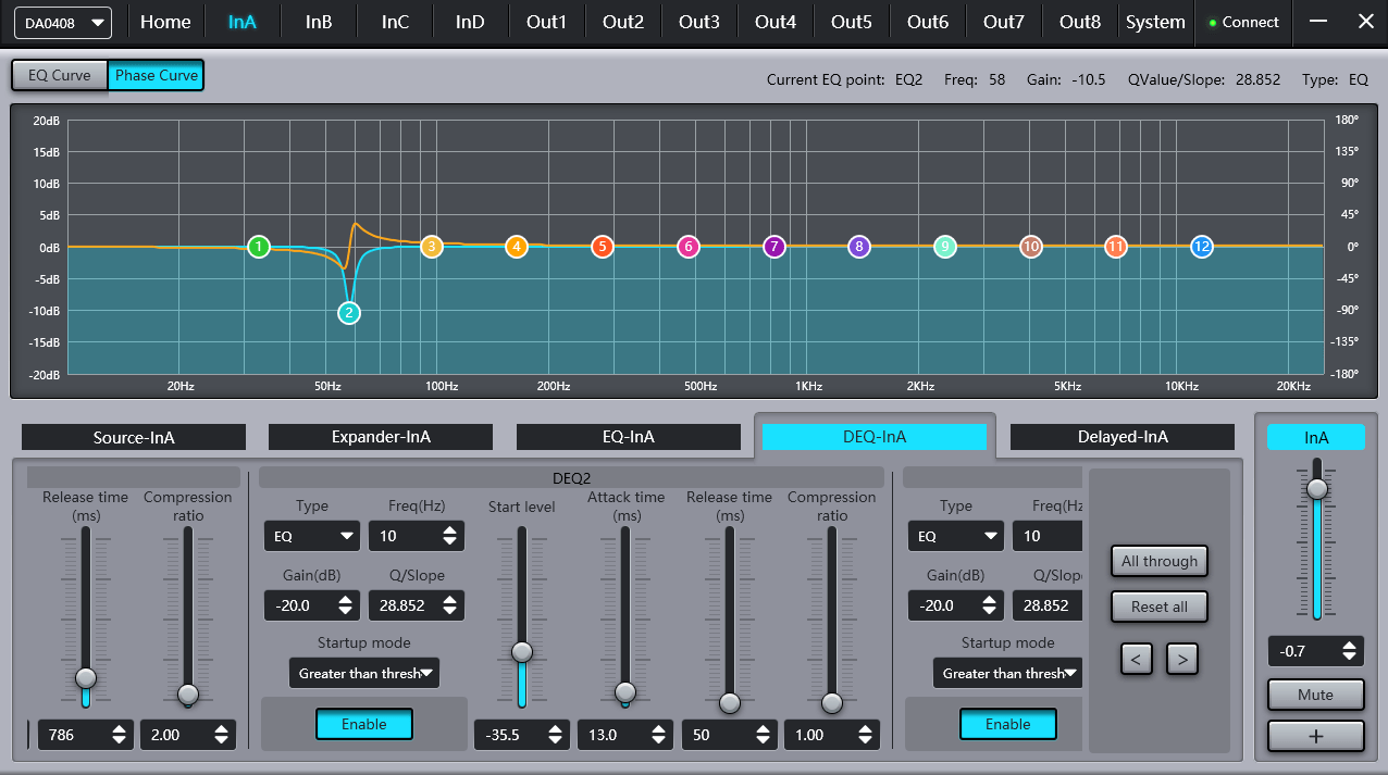

Dear friend, you have been testing with a new main board that does not support Sigmastudio.
I have an ADCP-21489, 4/8 with a main board supporting Sigmastudio.
Question:
1 Is it possible to replace the main board with Sigmastudio support with a main board without Sigmastudio support?
2. In what frequency range do FIR filters work effectively for this armor?
3. Do I need to develop a matching program to support the SA9227 card? What is the connection scheme of the card?
4. Is it necessary to purchase a front control panel.
1. The old DSP needs to be returned to the supplier for modification or replacement.
2. Frequency resolution=FS/N 96khz/512=187.5Hz or 192khz/512=375Hz
3. The new DSP can directly support the I2S interface of SA9227
4. Need to purchase control panel
