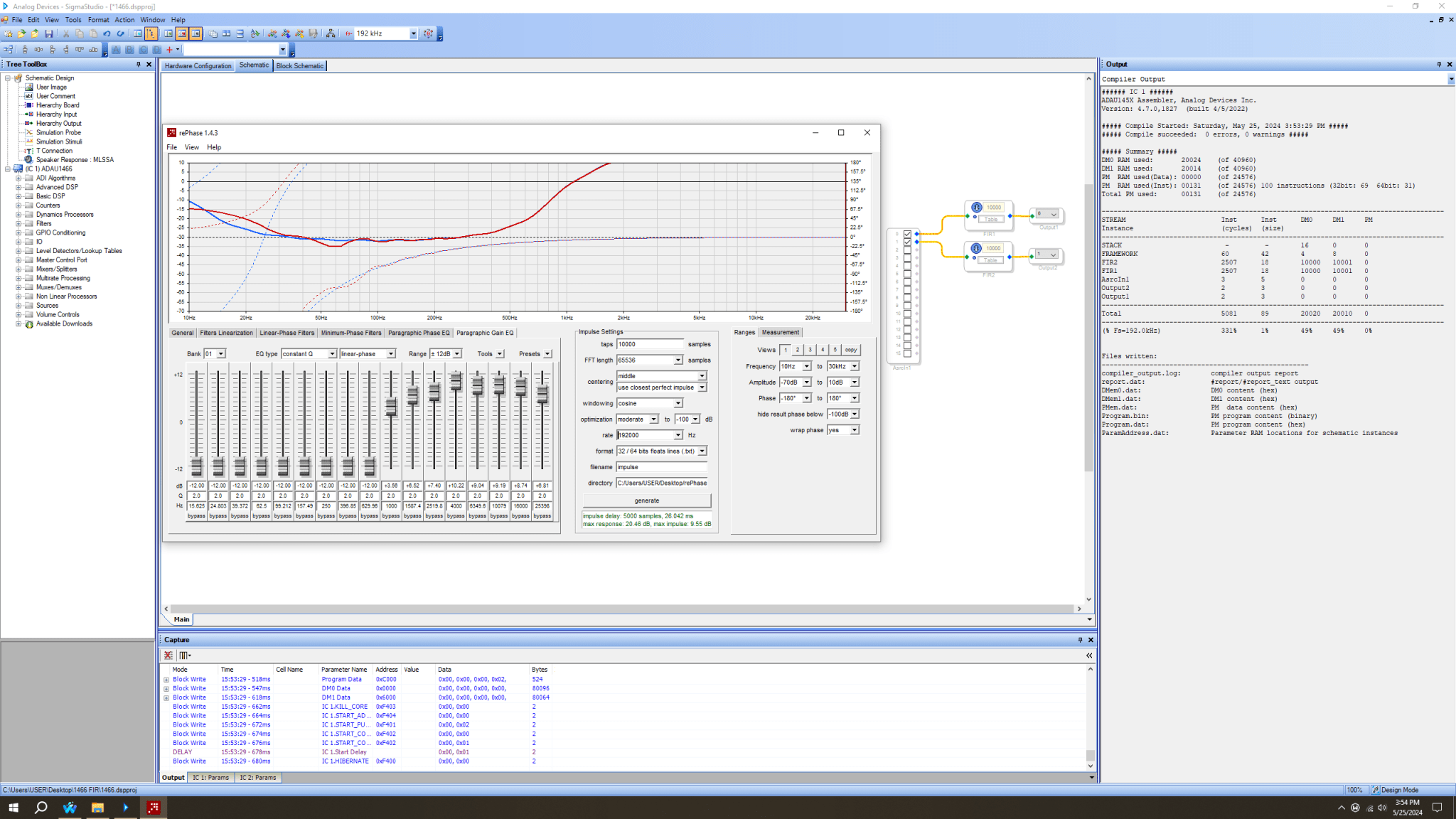

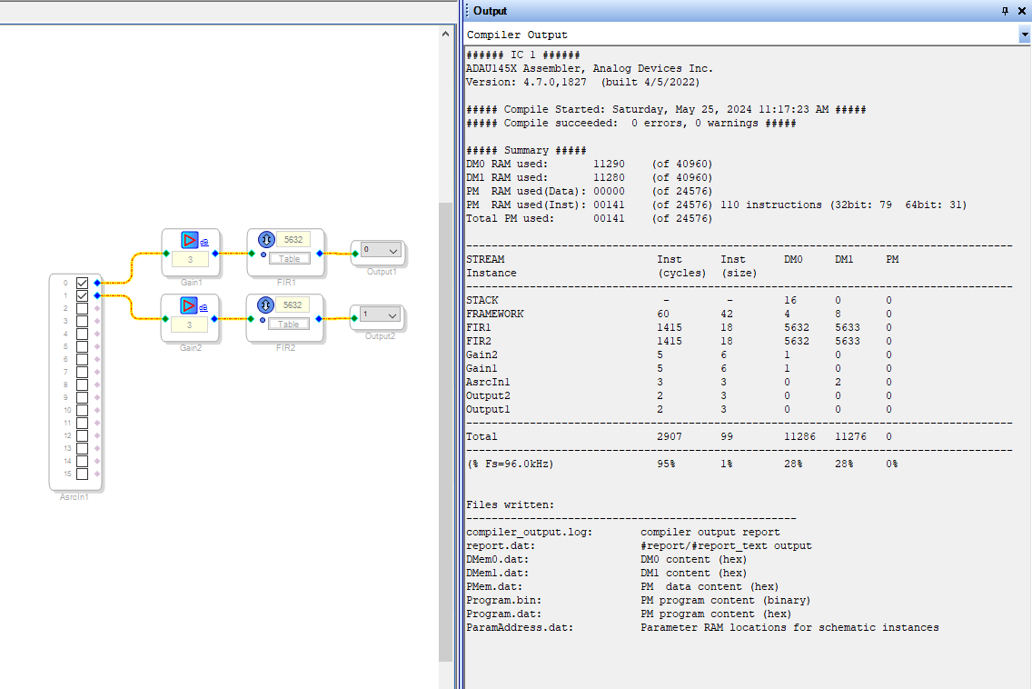

I figured out a way around the FIR limitations that I think I can live with. I bought an ADAU1466 months ago that I haven't done anything with. I successfully connected it between my BT module and the ASRC input of the 21489.
Still need to do more testing, but looks like I'll be able to use it for phase correction with 5632 taps per channel @96kHz, which put's it at 95% load. I tried 5888 taps at 99% load and it wasn't happy. 5632 taps seems to be enough to do a decent job of linearizing the sub/mid IIR x-over and subsonic filter. I might do a FIR mid/high x-over on the 21489. I still have a lot to learn and it's a bit overwhelming honestly.
Another benefit is I'll have multiple ASRC inputs now. I think another mod I'll try to do is use one of the PCM4202 boards it came with as an analog input for the SA9227 so I can use the unit directly for speaker measurements.
Ok, now I'm (extra) confused. I thought a static sound I was getting earlier was from trying too many taps. It was a clock problem.
Right now, as far as I can tell, it's somehow managing to run two 10000 tap filters at 5081 instructions per sample @96kHz. I thought that wasn't possible? I made a ridiculous EQ so I could tell if it's working, and it is.
EDIT: It even works at 192kHz. What am I overlooking?
EDIT2: Seems that going over 100% just adds delay? If that's the only downside, I'm fine with that to get 10000 taps per channel.
I have played a little with the adau1452 and the asrc can be used for internal resampling also. So for sub correction you could reample quite a bit. Lets say 8 kHz. Then the number of taps gives more than a tenfold in frequency resolution.5632 taps per channel @96kHz, which put's it at 95% load. I tried 5888 taps at 99% load and it wasn't happy. 5632 taps seems to be enough to do a decent job of linearizing the sub/mid IIR x-over and subsonic filter.
That is the beauty uf the ascrs, they dont steal clock cycles from the fir prosessing.
Ok, so no need to go way down in samplerate then.

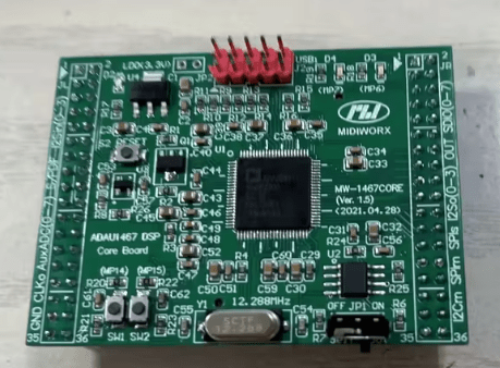

How does it compare to the Midiworx ADAU1463 Board?
https://www.aliexpress.com/item/1005002162173435.html
I'm referring to the DSP and I2S in/out capabilities, not that the former has an on-board USB and SPDIF interfaces and a lower price.

Sorry, I'm not familiar with that board and don't really have time to research its features. At first glance it has a lot of things I personally don't need.
I'm a minimalist and purchased my Midiworx 1466 board specifically for it's simplicity so I could dip my toes in the world of DSP. My needs are fairly basic compared to most people I think.
I also have midiworx and it do its job, if you buy it just for i2s then no need to spend more on first board. If you want complete solution, DAC, ADC, spdif.. I would look for freedsp

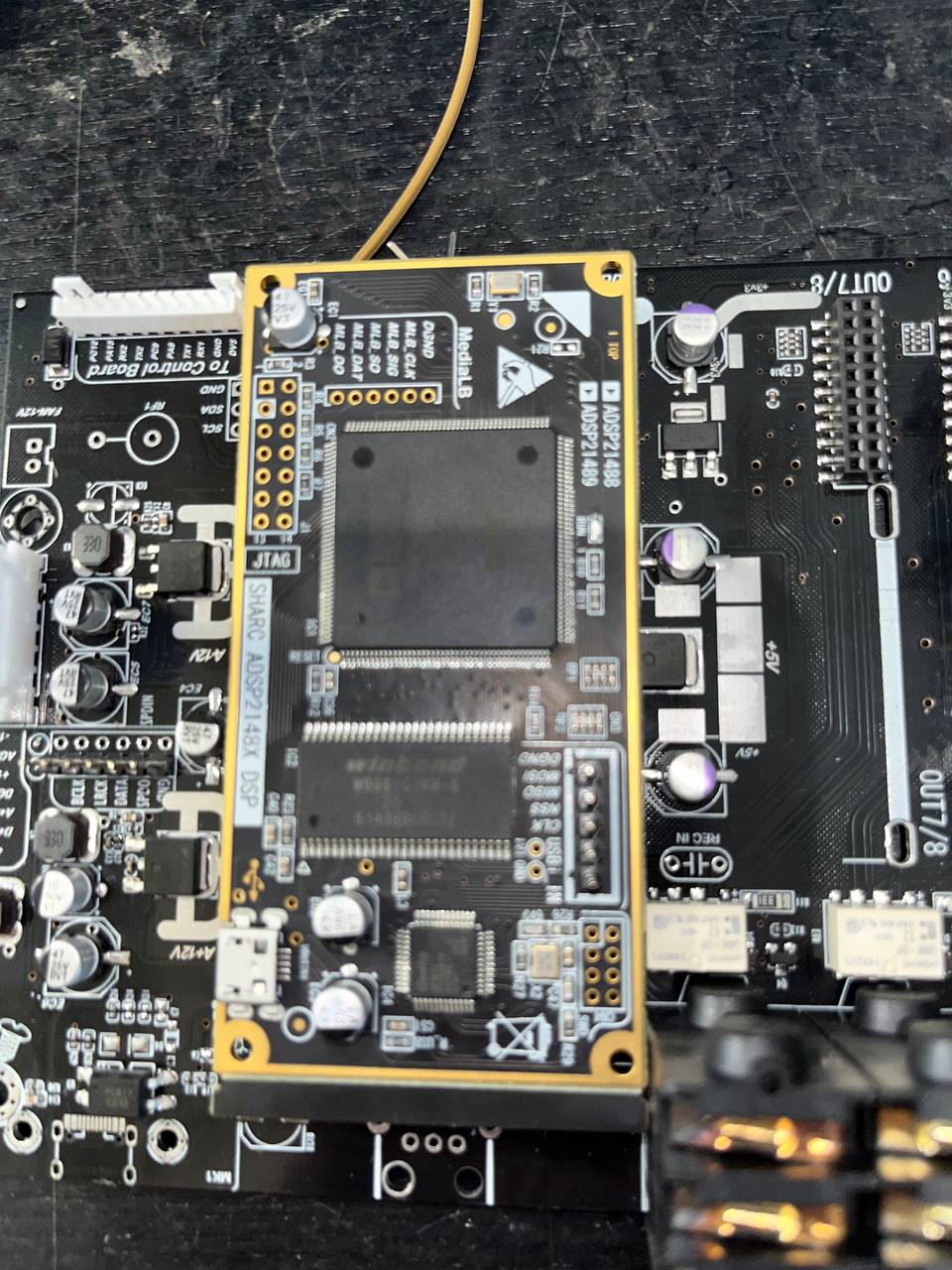

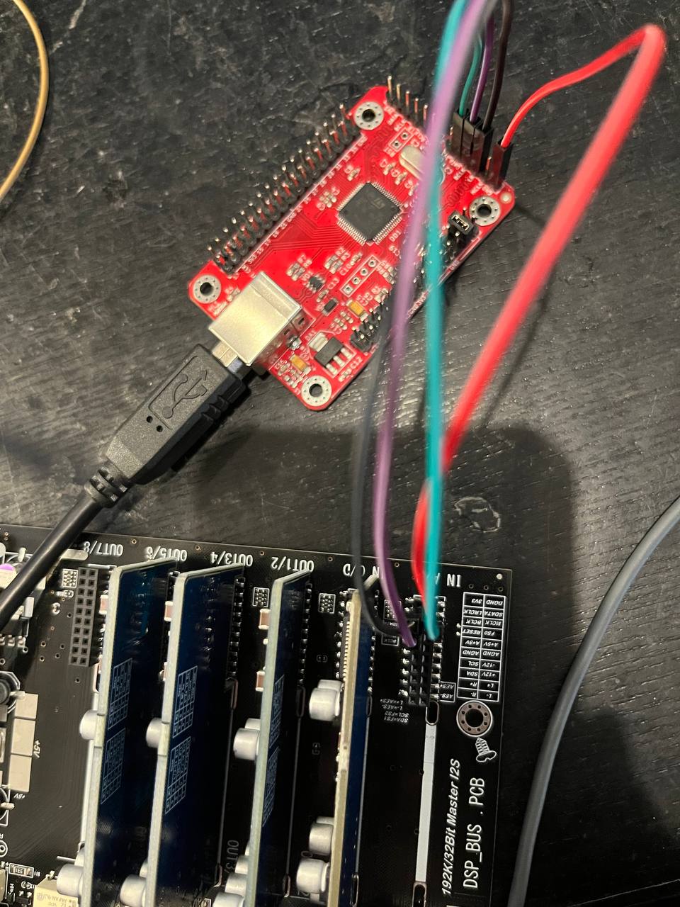

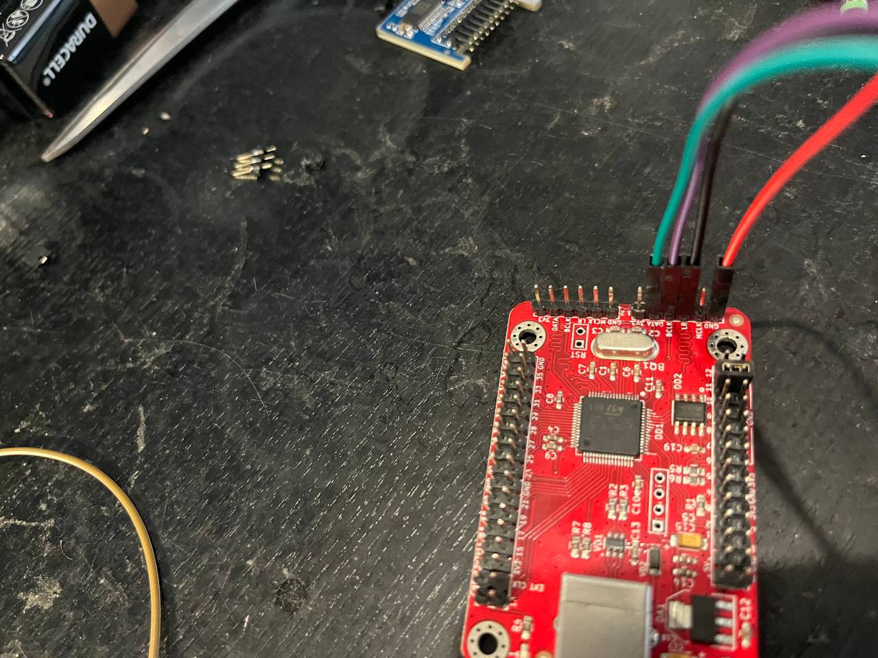

Greetings to the respected forum participants!
An unsolved issue forced me to come to you.
ADSP-21489 and USB board from Chip I Dip Reflex, configured in slave mode. When connected via i2c to the first input slot of the board, the sound is overloaded. I experimented with different settings - the sound disappears altogether. With the Streamer pcm 5102 board from ChiD, Reflex works correctly.
