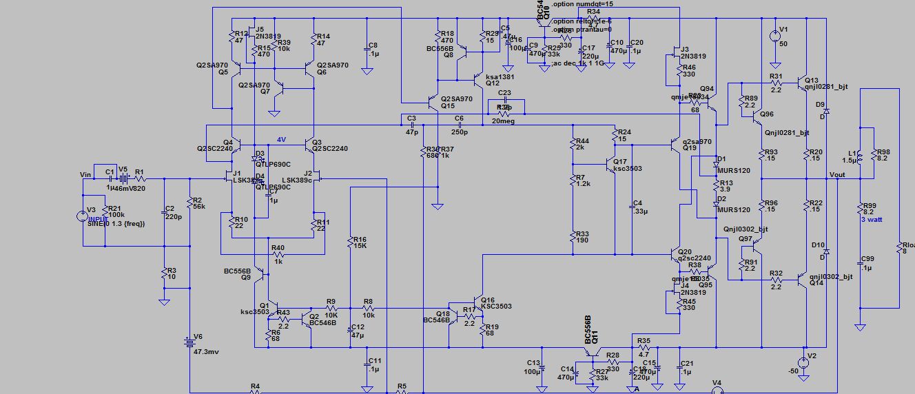

I tried to add a quick and (very) dirty 4 transistor error correction to the output stage of the VSSA to see what's happens.
Not so good than Dadod: 4ppm at 1Khz and 11ppm at 20K, but, look at the bandwidth and imagine the slew rate:
(Input and VAS unchanged).

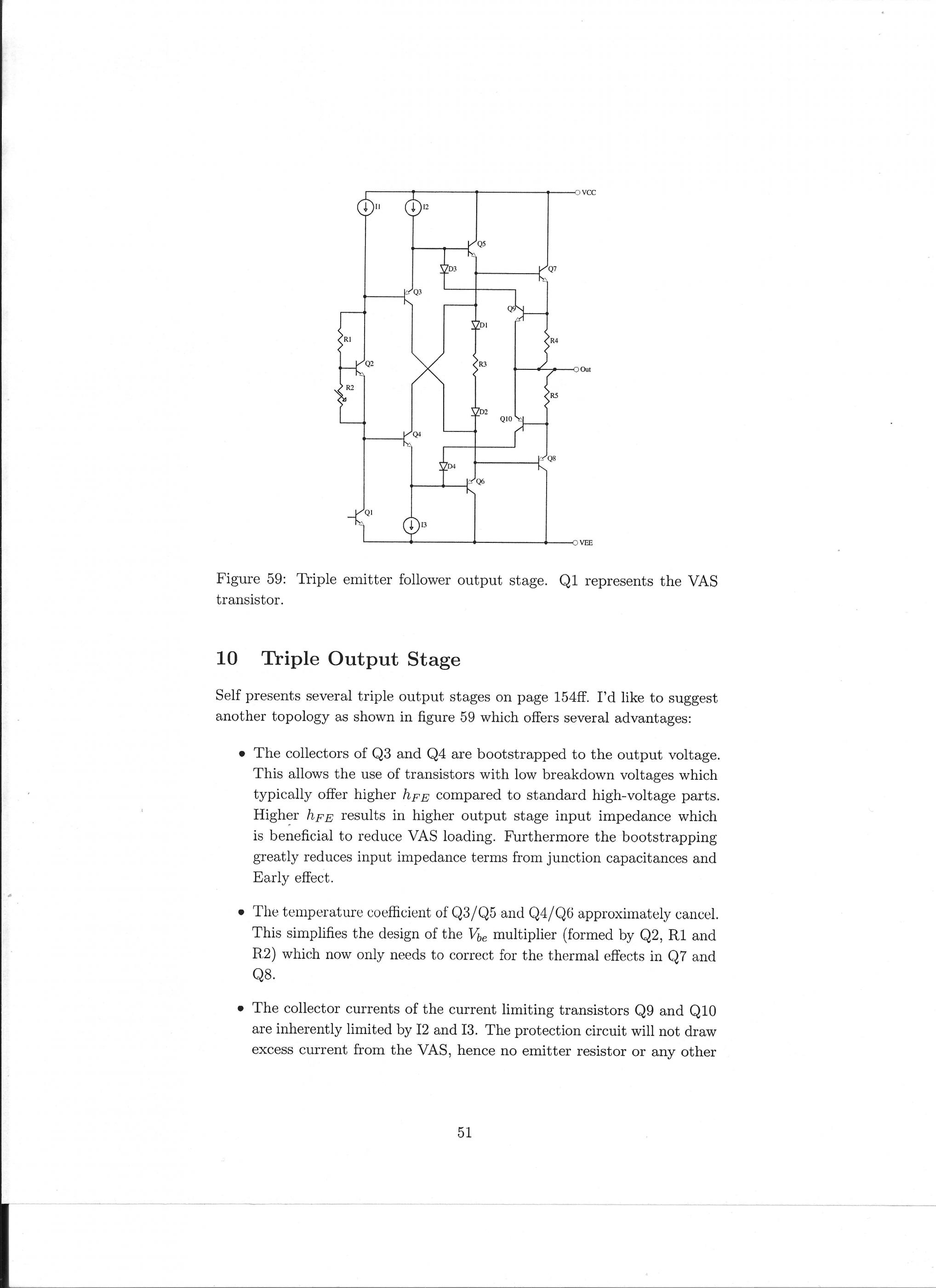

I would opt for the slew rate -- as we want to know what difference it makes... a few ppm one way or the other isnt as differentiating of designs -- maximize the differences.
Can you make it better than the very dirty circuit you used?
Have you read Samuel Groner's comments on D.Selfs book (comment dated Feb 24 2011)... specifically his Fig 59 triple emitter follower ops on his page 51..... [its a long comment ! ]

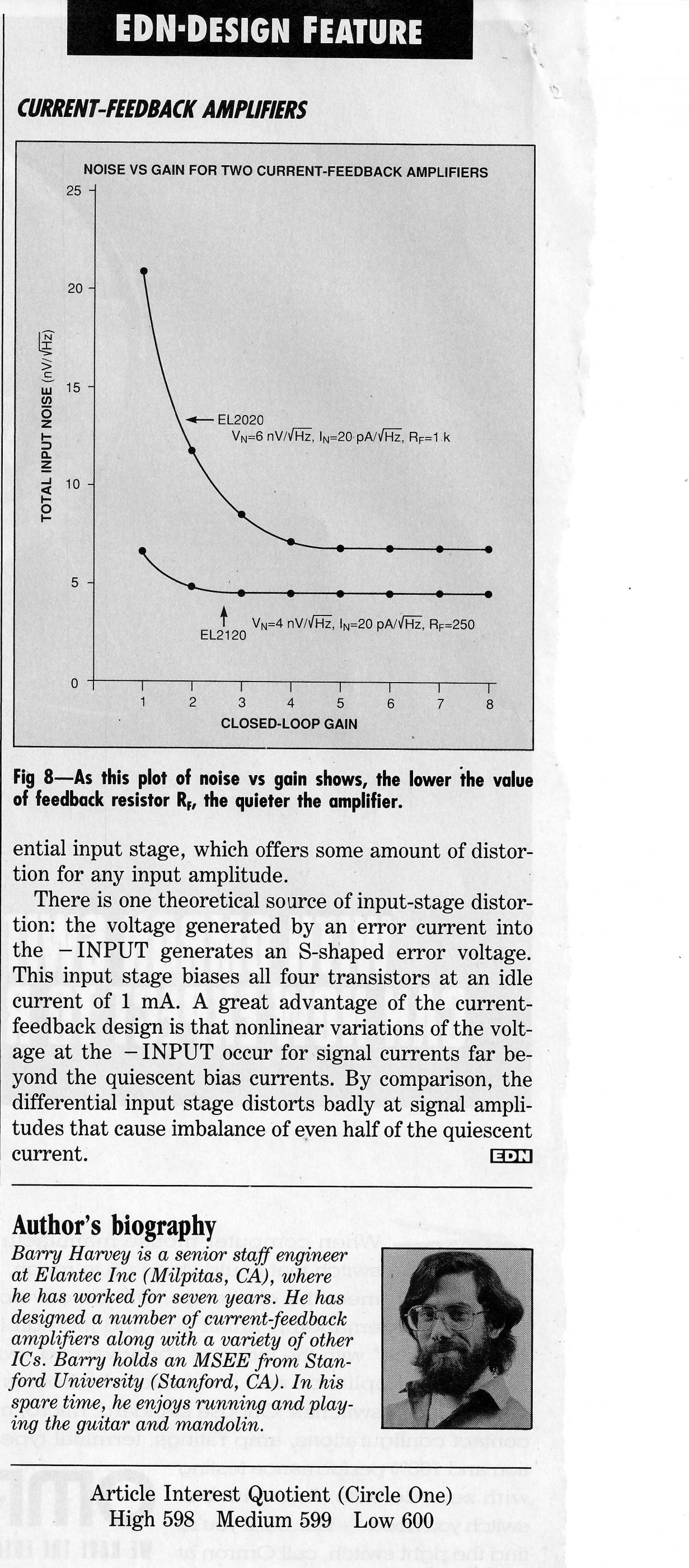

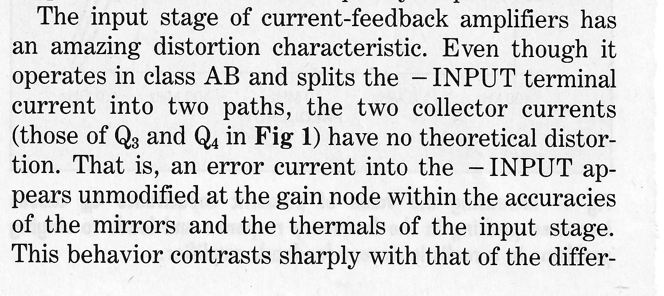

Each article or book about a subject reveils new insights and information. From Elantec designer (EDN march 18, 1993) is this --
As this EDN is not on the Internet... from by files... I'll try to post the 7 pages.
Thx-RNMarsh

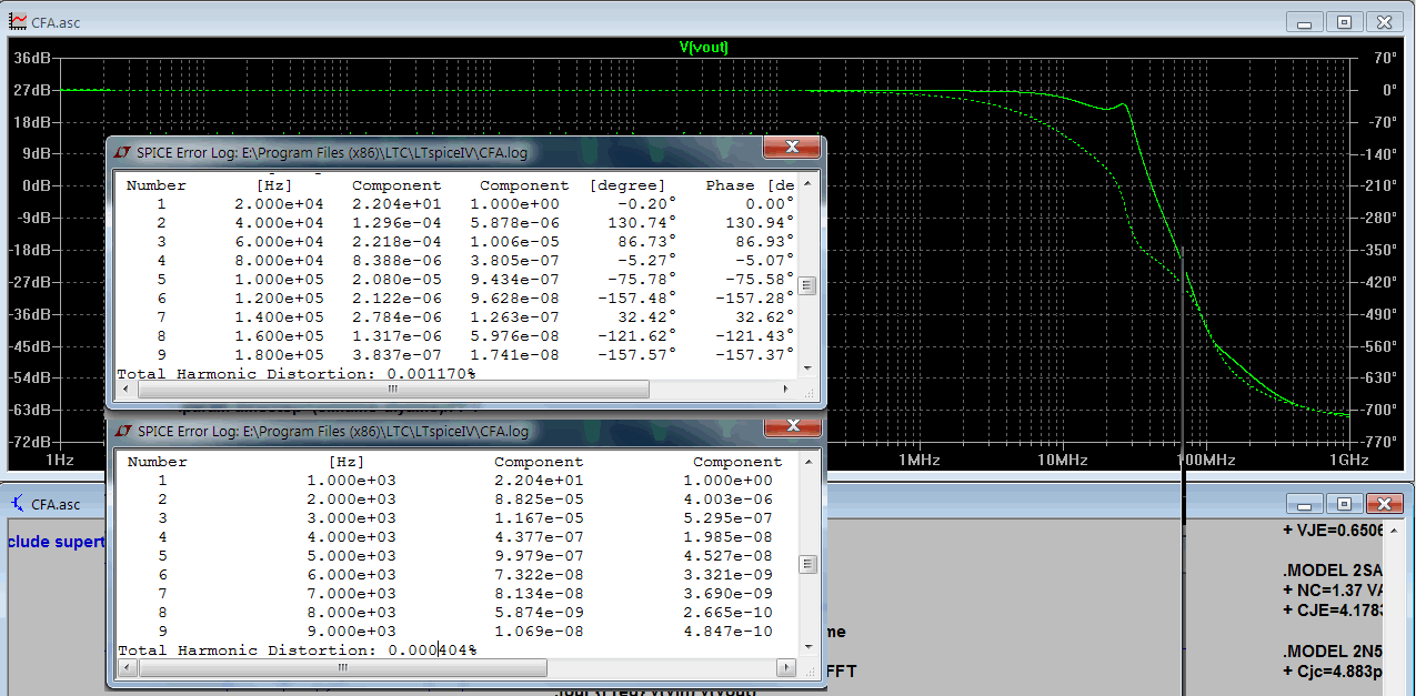

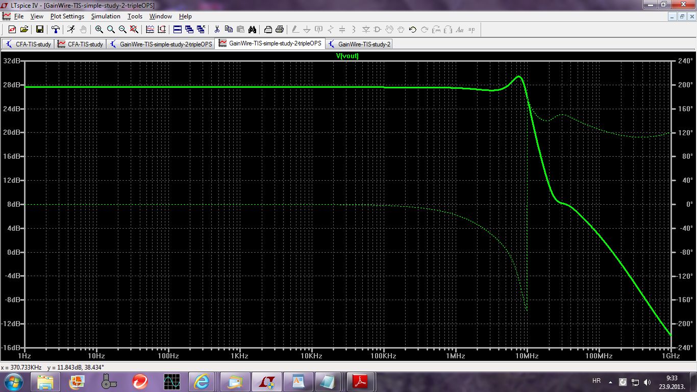

Hi Esperado,
From the Close Loop Gain it is not possible to imagine the slew rate, it is not directly correlated.
BR Damir

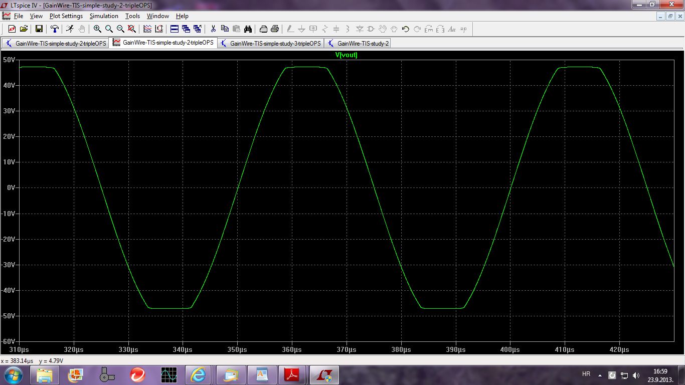

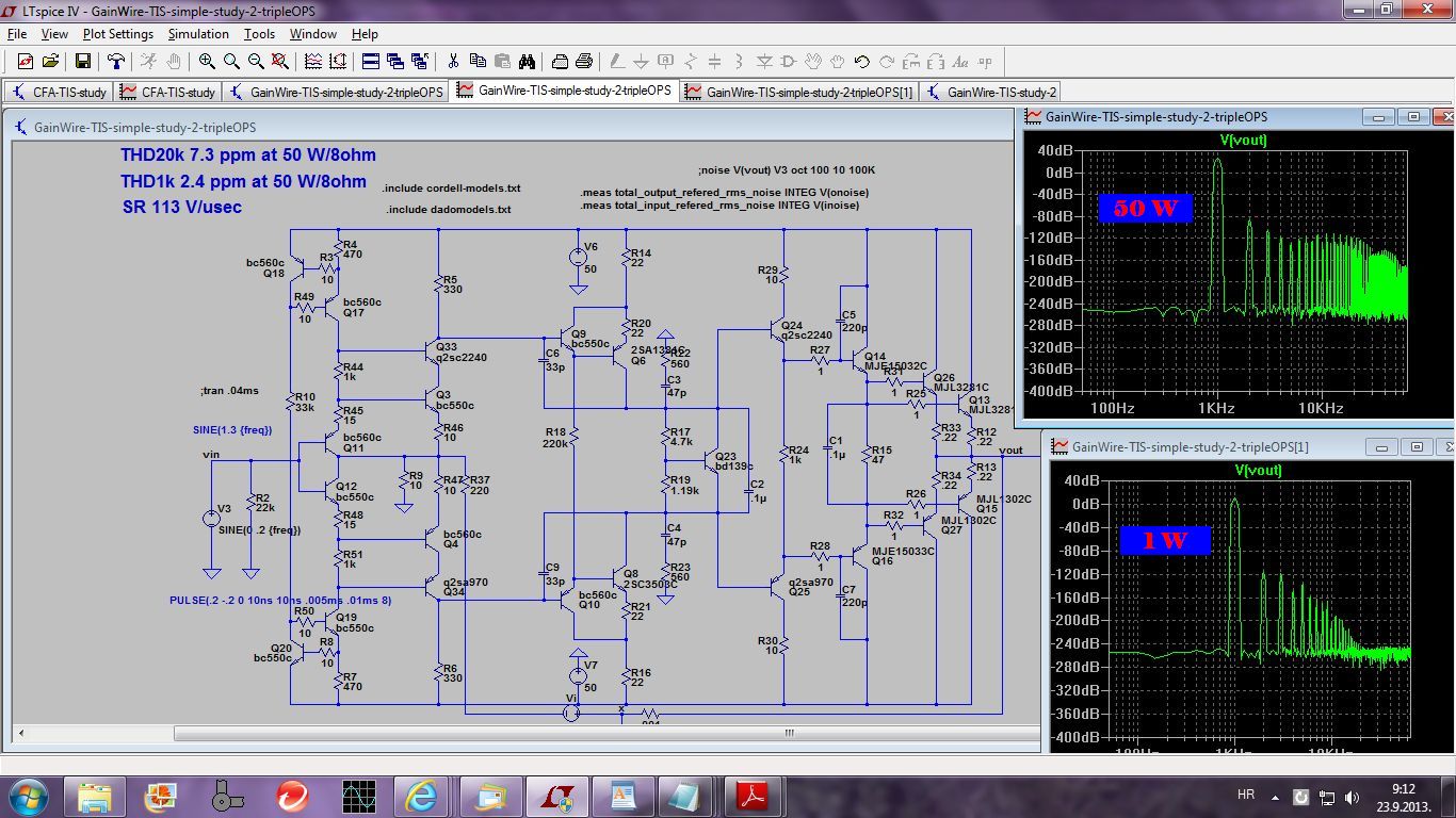

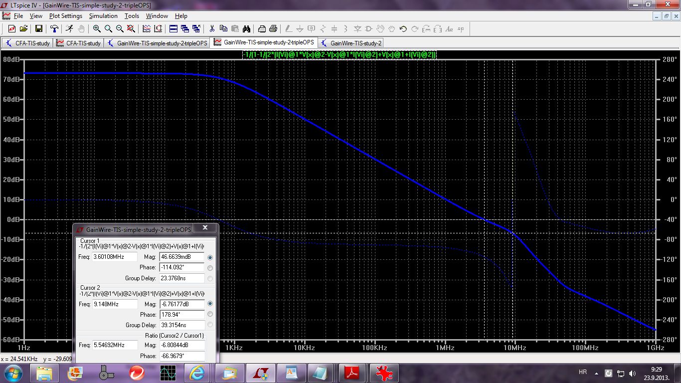

This is simplified version with very similar distortion.
It uses about 40dB of NFB at 20kHz, and I am trying it increase it but with no success until now.
BR Damir
Yes, of course. What i mean was slew rate can be better, can't be worse 🙂
Shame on me, but i don't read too much about electronic. And will never buy a book from Mister Self ;-).
I'll take that as a no. But, the all mighty, the great and powerful OZ (Internet) knows. Ask and you will find an answere (usually): Via the great OZ of the Internet - maybe find out in sim if this or one of similar variation would be better if adapted here. Especially at 50W or greater levels.

I simulated, some years ago, VFA amp using Groner suggested triple OPS. It simulated quite good, THD20k less the 1ppm at 70W/8ohm. With normal triple I've got similar result(it is my working TT amp) and thermal stabilizasion with Groner triple was a bit tricky, Vbe multiplier should work on only 1.4V and in simulation I could not get it stable enough.
Here is schematic.
BR Damir

BTW, the whole paper is a good read (as is everything else Samuel Groner
has on his website):
http://www.sg-acoustics.ch/analogue_audio/power_amplifiers/pdf/audio_power_amp_design_comments.pdf
Here is schematic.
BR Damir
That makes sense to me re thermal stability. lets see if we can make the full power output distortion lower and slew rate higher - all else being same.
Thx-RNMarsh
