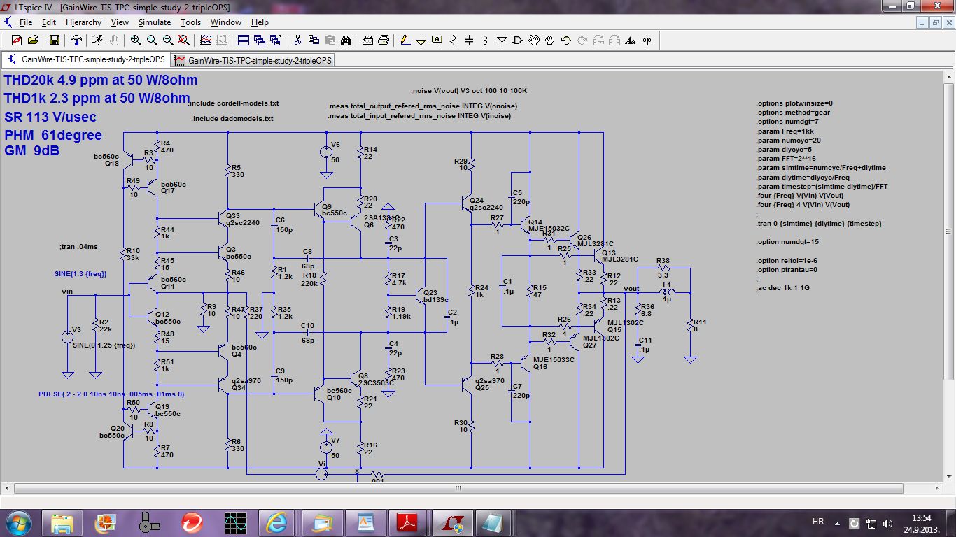

Damir, has gone completely over to the Dark Side and proposed the most complex CFA I've seen.
One more from the Dark Side .
This uses TPC and THD20k is down from 7.3ppm to 4.9 ppm, only 3.5dB down but everything counts on the Dark Side.
BR Damir
That's looking good damir. It's a lot simpler than your earlier designs and you are at <5 ppm.
You could drop the current sources and go for Zener regulation for the FE for further simplicy. I found zeners work extremely well, and they are actually not bad noise wise if you go above about 8 volts.

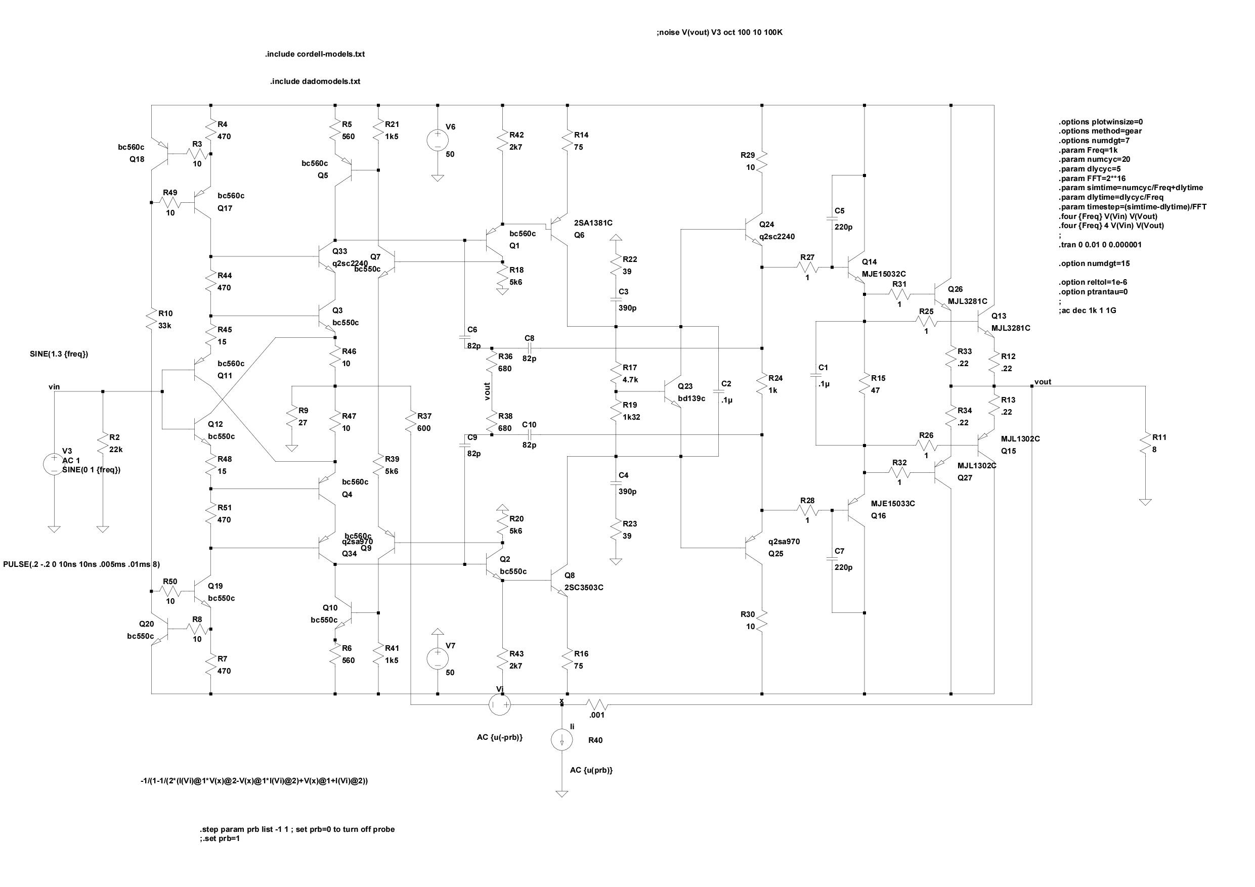

Thanks Bonsai,
I simulated with 12V zeners and got a bit higher distortion(increase from 5 to 6 ppm) and to get similar result as with CCS it needs to bootstrap the zeners(probably it needs parallel caps to zeners too) and it is not any more simpler. I kept the same condition on the cascode transistors of carse. I prefare CCS as small transistors are very cheap and DC compensation is simple by changing one side CCS currenz a bit.
Try your CFA with CCs and you could be pleasantly surprised with result.
BR Damir

Been playing about a little with Dadod's simple CFA and ended up deviating quite a bit. This is the result... Taken what I thought were the key parts of my monstrosity and put them into this.
Costs a few components and 4 transistors extra.
THD20 @ 50W / 8R = 0.000138%
THD1 @ 50W / 8R = 0.000001%
I think the PM / GM are ok. Slew rate is about 77V/uS, so not good.
(Prepared for complaints about complexity)
PS Dadod, your designs are always so well optimised.

Welcome to the Dark Side. Could you now post .asc file.
BR Damir
P.S. I suppose you increased LG?
BR Damir
"With our combined strength, we can end this destructive conflict, and bring order to the galaxy." - Darth Vader
Here is the .asc file. Would be good to get an experienced opinion. I think LG has increased. I'm still trying to figure out the tian probe properly.
Warning: Only had about 7 months experience in amp design so may have made mistakes.
Paul

You increased LG to 130dB at 100Hz and 60dB at 20kHz, in my simulation it is not stable. I think your TMC is not optimized.
