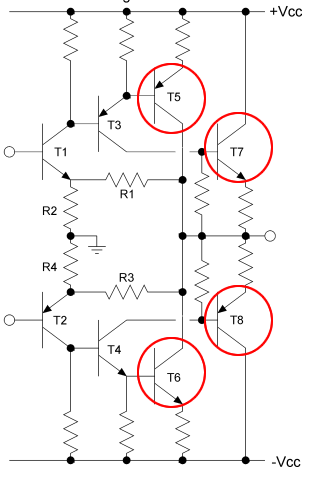

Who, from the dark side, tried the nice idea of Bryston's quad quasi complemetary for the output stage ?

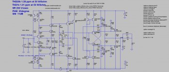

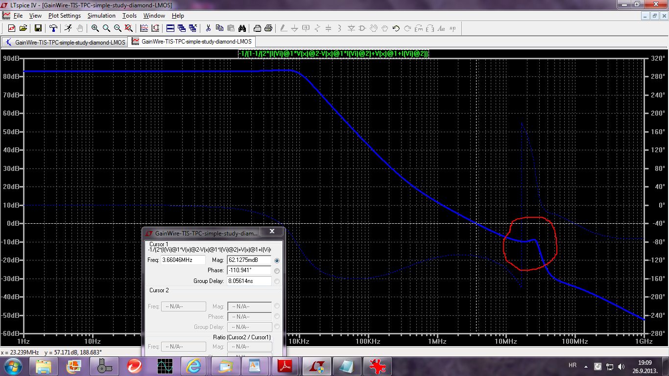

Nothing’s happening lately here. From the Dark Side another CFA amp this time with lateral MOSFET in the OPS, just to stir the pot. It uses TPC compensation but as Charry suggested a long time ago, instead to connect Miller cap to the VAS collector it’s connected to the OPS output. In this way THD20k goes down ten times. If used simple emitter follower drivers and distortion is twenty times worst.
I tried that with BJT triple but it’s to unstable, here with MOSFETs is much better, but there is one caveat. Look at Loop Gain picture, there is a peak at 25 MHz about, and it’s depend of the diamond predriver transistors used. Slower transistor lower peak and vice versa, and slower transistors lower LP and consequently increase distortion significantly. I simulated with BC5xx transistors here as it gives lowest distortion, but those transistors are with to low Vce.
Any suggestion how to remove that peak?
THD20k is 1.6 ppm at 50W/8ohm.
BR Damir
That's the reason of the comment of L.C. about diamonds. Tried to set a little cap in // with the feedback resistance ?
