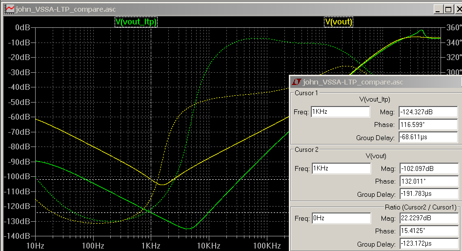

a PSRR result from my earlier entry in VSSA CFA vs same output Q, same bias, same added number of parts as Esperado' "fair" LTP comparison
but designed to take full advantage of LTP
minus rail PSRR of VSSA(yellow trace) vs TPC LTP (green)
any wanting to design for improved PSRR should look at the Sakinger paper I have been promoting for a decade now at diyAudio
Basically PSRR is a function of compensation reference topology and loop gain, NOT a inherent VFA/CFA difference
if you insist (low) "flat loop gain" is a design goal itself you're facing a handicap in the loop gain part of PSRR and really, really need to understand the rest of the Sakinger paper

I tried searching for the Sakinger paper - can you point me to it? The search function of this forum stinks.
We are not insisting on a flat top response - that's just a characteristic of CFA, and we have to deal with it, THD same way you have to in any engineering endeavor.
As already noted, the problem is solvable by augmenting the basic CFA with ripple eaters or AFEC, but it would be nice to dig into the fundamentals a bit more.

Cdom PSRR compensation is shown by Self, "Negative Supply-Rail Rejection" p290+ in the 5th ed of his amplifier book (and he's up to 11 in his numberd distortions)
and one of my favorite references:
“A General Relationship Between Amplifier Parameters, And Its Application to PSRR Improvement” E Sackinger, J Groette, W Guggenbuhl, IEEE Trans CAS vol 38, #10 10/83 pp 1171-1181
CiteSeerX — A General Relationship between Amplifier Parameters and its Application to PSRR Improvement - clik on the cached PDF icon
treats the problem, shows several options to improve PSRR
compensating for 2-pole TMC network can be done by connecting to cascode or duplicating the network and connecting to gnd and mirror or cascode

Can you post a link or the *.ASC?a PSRR result from my earlier entry in VSSA CFA vs same output Q, same bias, same added number of parts as Esperado' "fair" LTP comparison
Why are you showing only the -ve rail PSRR?
VSSA is 'symmetrical' so there should be little difference but your LTP might be very different.

minus rail is expected to be the worse for my LTP with the compensation connected there

I read the paper.... how would cascoding improve psrr without changing gain?
