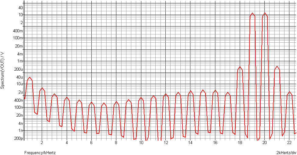

Theses are not correctly done, Dadod , it s what is at the left
of the fundamental frequencies that interest us , you should
set the simulation time to 10ms at least and the step to 100ns
and then zoom the 0+ Hz-25KHz zone in the graph.
For Manso s original schematic and with a linear x axys it looks like this :

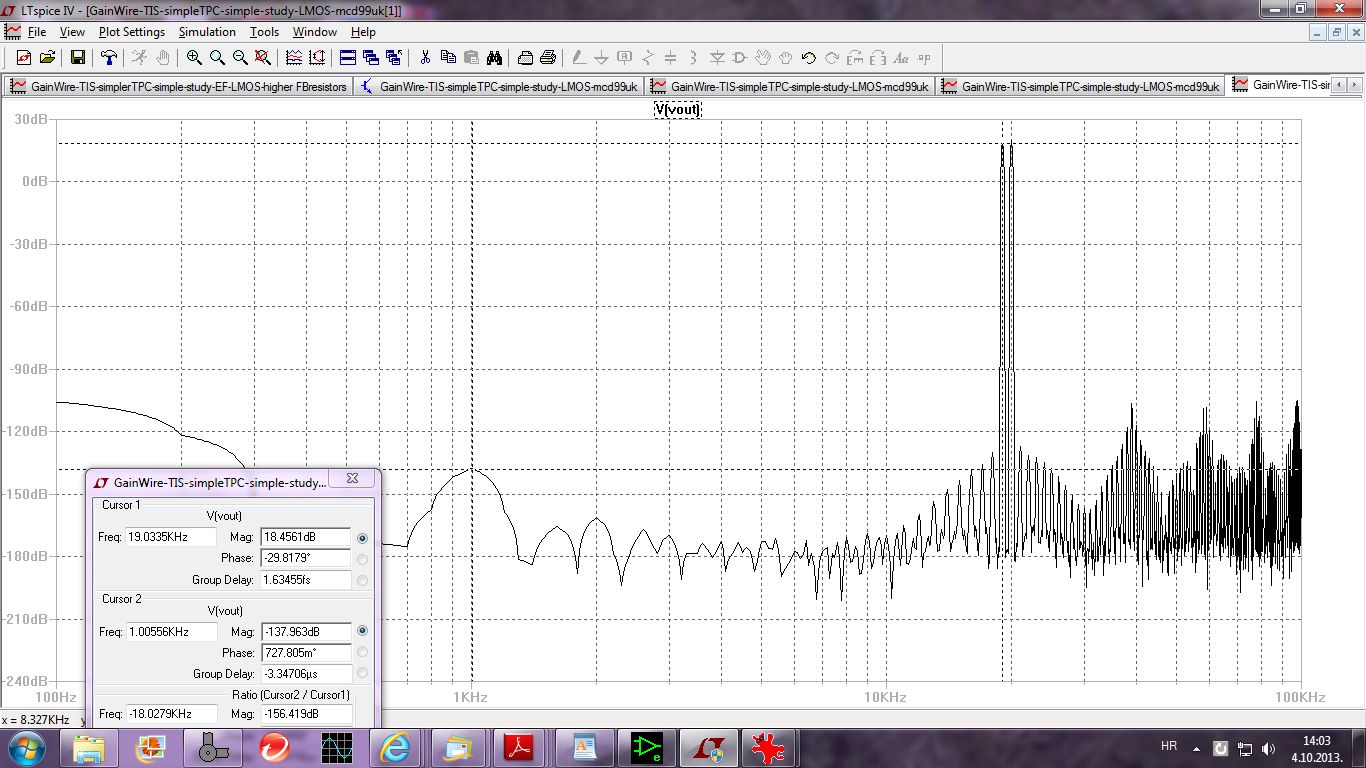

OK this is what I've got for high LG, and 1kHz is 157db below 19+20kHz signals.
