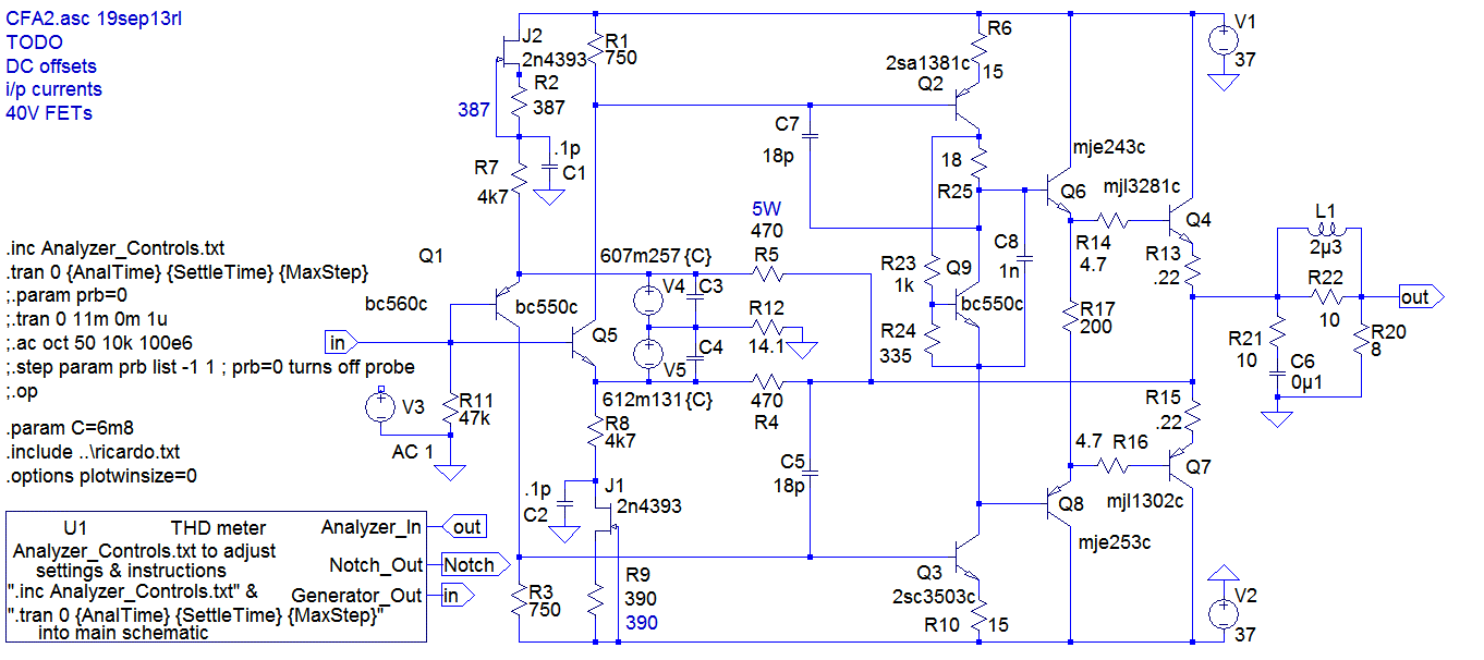

My usual caveat that I've never burnt solder on such exotic beasts unlike VFAs where I've considerable 'real life' experience to back up my pontificating.

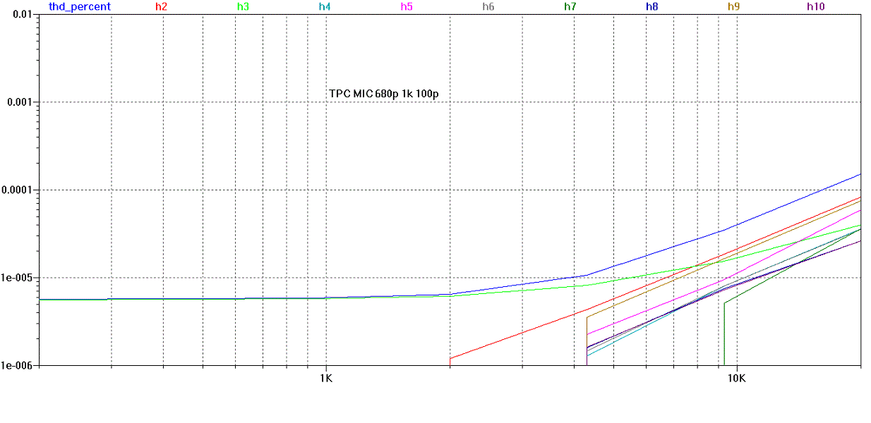

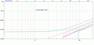

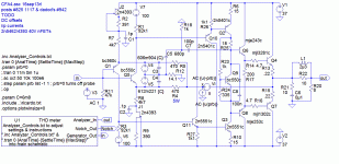

The starting point is the simple CFA in my #500 post.
The LG here (as with nearly all 'symmetrical' amps) is limited by R1/3 vs R6/R10. This suggests that VASs with less hfe but better Ccb would improve performance.
Doing this and some small tweaks gives the attached circuit.
It still uses the yucky compensation in #500 but in fact, cleverer stuff isn't better. The performance of this circuit is already close to the max that can be extracted from these devices.

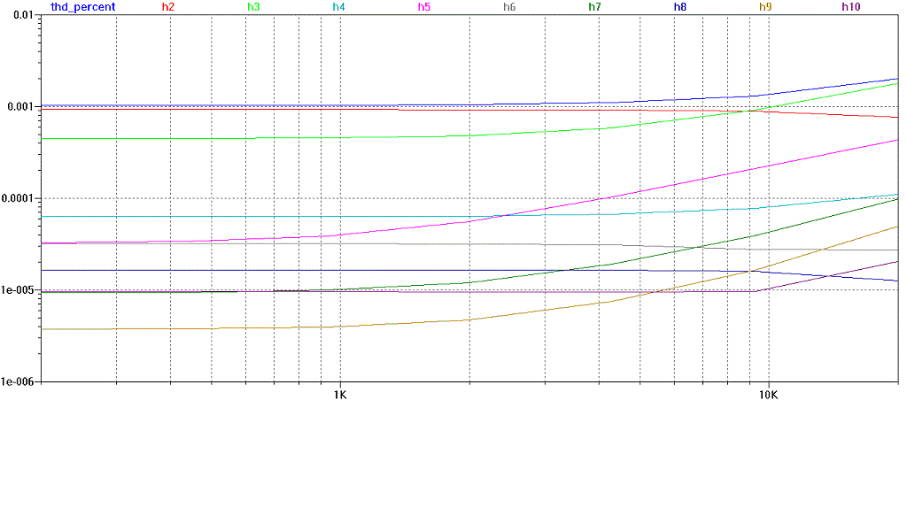

LF THD is @ 10ppm with 20kHz @ 20ppm but note higher order harmonics are some 20dB below 2nd & 3rd. This is due to the partial Cherry compensation via C5.
This is about the simplest possible CFA with 11 active devices.

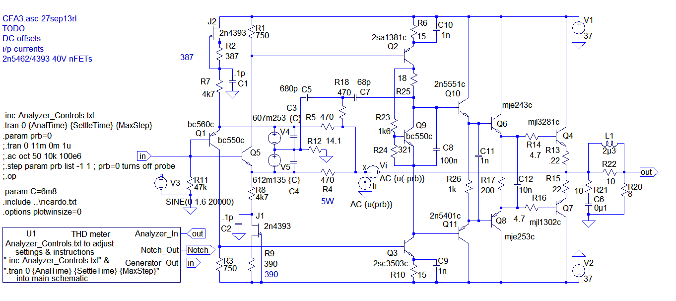

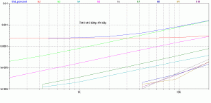

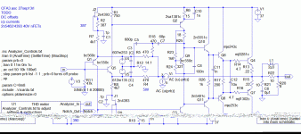

The other route is to use evil Locanthi triples which gets around the R1/3 vs R6/R10 limitation. Sure enough, LF THD is greatly reduced but HF THD isn't cos evil modulated Ccb isn't addressed.

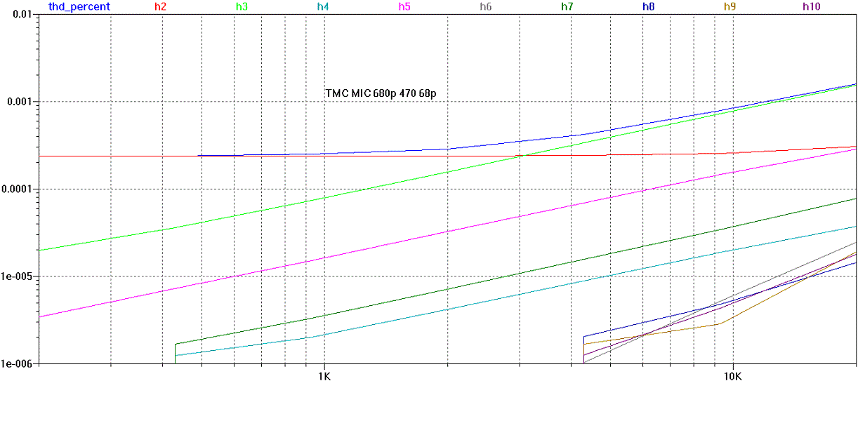

I've finally got some success using 'advanced' compensation (thanks to Damir and particularly Andrew) but in fact, there's not much difference compared to yucky Cherry+Miller on this circuit .. which suggests we are already wringing the best THD performance out of this circuit.
13 devices which makes it as complex as the simplest possibly VFA in my #502 post but better performance all round.

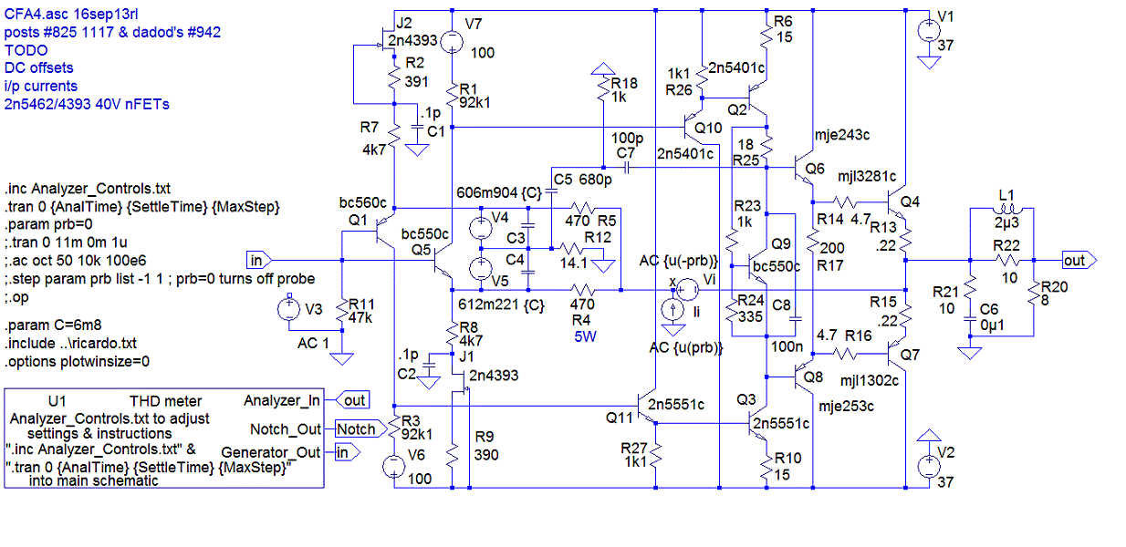

If we can somehow get around the R1/3 vs R6/10 stop gap in LG for the Enhanced VAS EF2 simple CFA, we have the possibility of SOA performance with very simple circuits.
We do this by feeding R1/3 from separate high voltage rails V6/7 and adjusting accordingly. This is less than 2ppm THD 20kHz 50W 8R and less than 0.1ppm below 4kHz.
It makes nonsense of the belief that CFAs are inherently limited in their THD performance. The THD limitation is almost certainly due to the 'symmetrical' topology used and probably a feature of VFA 'symmetrical' topologies too.
It has 13 devices, same as the simplest possible VFA eg my #502 design but nearly SOA performance. I've no doubt that a little more tweaking would get even 20kHz THD below 1ppm.
Alas, this particular circuit is definitely in the 'hand carved by virgins' category (though not from Unobtainium 🙂) It might be sensible if you are considering separate supplies for the VAS & IPS.
But R1/3 need tweaking for sensible VAS currents. I tend to use less VAS current than Bob Cordell, Bonsai or Dadod so they may be less concerned.
I offer it as an indication of where we need to go for better CFAs.

It would be nice to be able to solve 'R1/3 vs R6/10' with only an extra 2 devices and that would be my idea of 'improved CFA'. Need serious thought & work to do this elegantly.

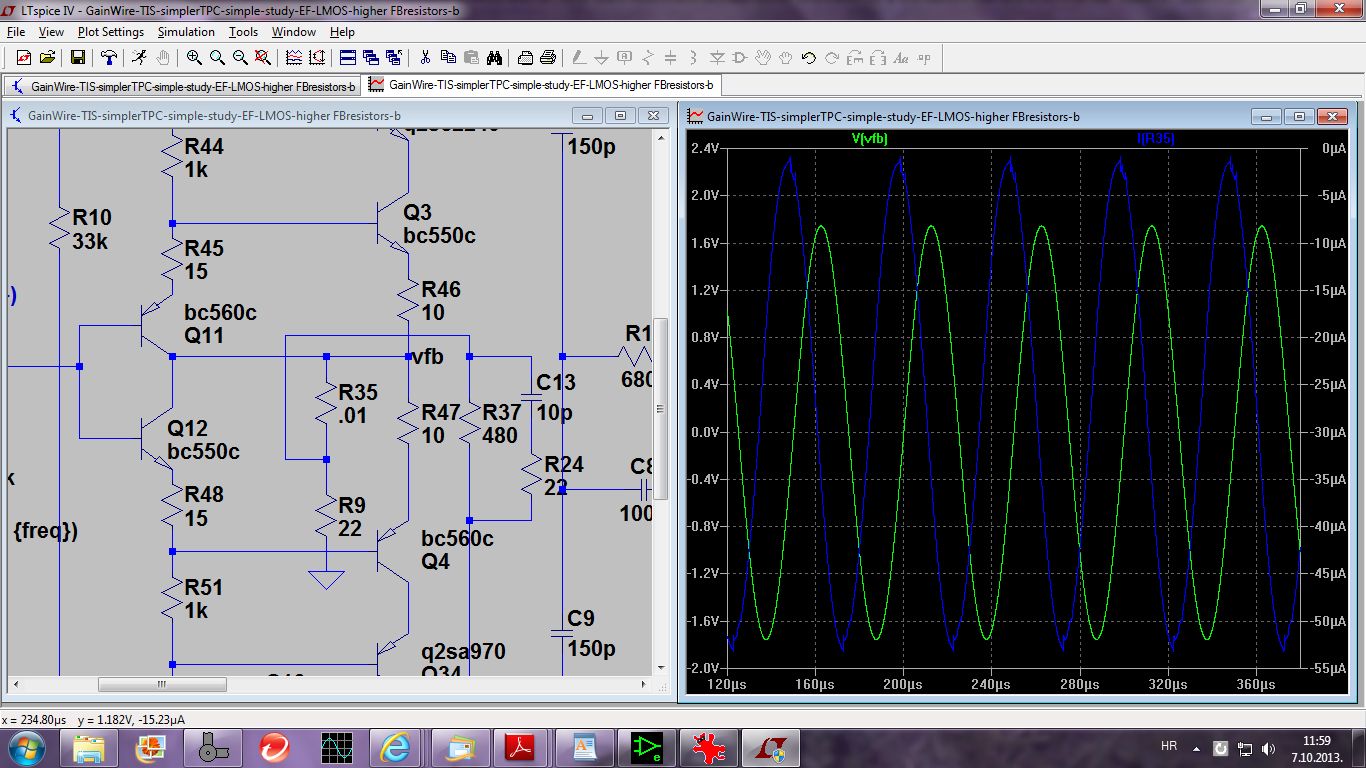

The importance of sizing the feedback resistor correctly in a CFA cannot be overemphasized. To keep the front end in class A, just make sure the peak feedback current is less than the IP stage level shifter standing current.
How you do that? I your sx amp the feedback resistors are 215 ohm total and let say at 40 Vp you will have 186 mA peak current trough R11(15 ohm).
Richard, that's cheating 😉 You need to consider distortion of the various blocks in isolation, not after you have applied TMC or TPC. You should easily be able to get a VFA or MA to lob levels on their own. After adding the OPS it goes up by 20 dB. All the small signal stages of course are fast and running in class A. It's that OPS that's the problem.
You can't do it like that dadod. Feed a square wave in on the input and then monitor the current output from the Diamond input stage.
OK I will try it, do I need to do that in isolation from feedback?
But first here something what bothers me, that difference between VFA and CFA. In my simulation everything looks very similar in both types just higher SR in CFA.
Here is simulation with voltage an current swing in the feeback node. For me it looks that voltage dominate.
