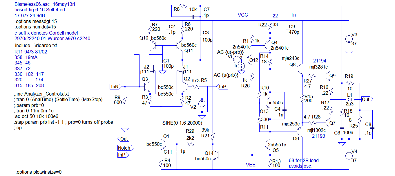

In simulation I change VSSA compensation like this. It give better 20kHz distortion and wider bandwidth. Is VSSA will stable with this compensation? Is value of the compensation's capacitors is right for real implementation?
I still learning how to use LTSPICE. If anyone have models for transistors that usually used in this forum (except Bob Cordell models), please sharing to me. You can send to my email: anistardi@gmail.com
Anistardi
...The Heretical HiZ champion to beat is in #499 of this thread...
OK. Please post the ASC of this amp.
Could you post a stripped down, version, ready to run a Tian probe?
Neither of the versions in posts #1 or #3 of your thread were wired correctly and I don't want to make any "little" alterations that could have unforeseen consequences.
So no THD analyser either.
I see Guru Zan dun trust beach bums .. especially from Queensland 🙂

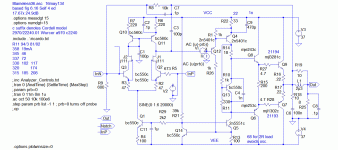

Here's the .ASC of the version of #499 which gives the results in #823.
I've left the THD Analyser in but to run the Tian probe, just delete it. Everything else is set up.
LG.plt is for Tian probes. Go 'Plot Settings' 'Open Plot Settings File' after the .AC run
Out.plt is to look at the output & residual of the THD meter. Go 'Plot Settings' 'Open Plot Settings File' while running the THD analysis
You need to change the Spice Directive to
.inc Analyzer_Controls.txt
.tran 0 {AnalTime} {SettleTime} {MaxStep}
.param prb=0
;.tran 0 11m 0m 1u
;.ac oct 50 10k 100e6
;.step param prb list -1 1 ; prb=0 turns off probe
;.op
THD.plt is to look at the individual harmonics. After the THD run, follow the instructions in Analyzer_Controls.txt and then Go 'Plot Settings' 'Open Plot Settings File'
__________________________
The models are Cordell's except for the J111 FETs from fas42. Details in ricardo.txt

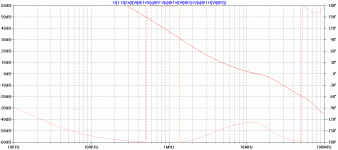

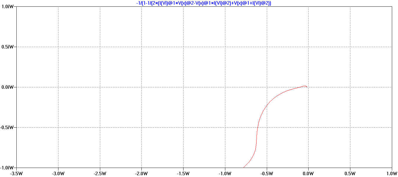

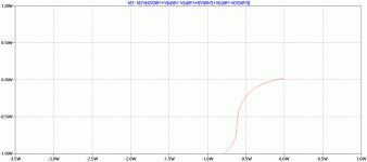

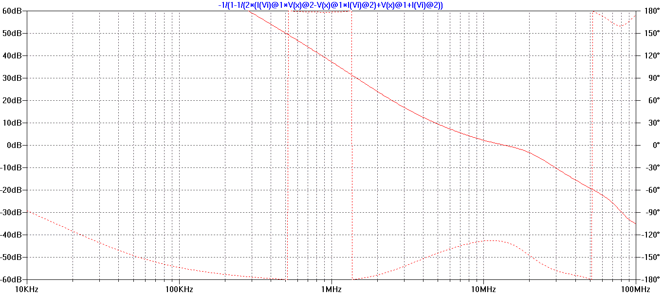

The Tian probe is set up for Loop Gain of the complete amplifier.
To look ONLY at the OPS + VAS + pure Cherry loop, move the Tian probe to the base of Q12 as in OutputLGcir.gif. You need to make a link between R9 and Q3 base to replace the Tian probe which you've moved.
The Tian probe analysis tie in with my Jurassic Loop Gain efforts using BIG inductors, breaking the loop and my own linear Circuit Analysis package.

Just had a look at your loop results.
Conditional (Nyquist) stability and about 14 MHz ULGF!
I don't think Andrew will be impressed.

If you are talking about normal loop gains (so 40-60dB at 20 kHz using advanced comp techniques, or 25 to 35 dB using MC) then you have to close your loop (ULGF) at 3 MHz - and this is the upper end on an EF2...
Ric's Output Inclusive Cherry has >100dB at 20 kHz around the output transistors!
So the ULGF around the OPS is 13 MHz.
About where I expected.
No wonder the THD is low😉
