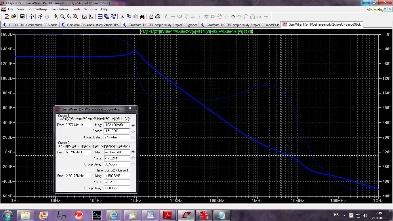

I made a small mistake in the first simulation of your modification, I did not notice that you changed RCs at the gain stage output(R22 C3 , R23 C4).

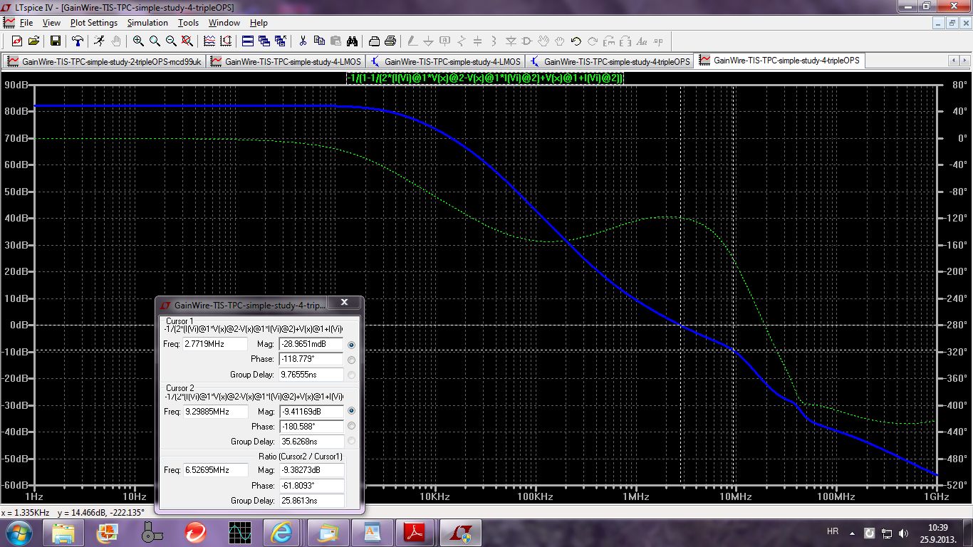

Here is a new loop gain simulation. I use Tian probe as in LTspice Loop Gain 2 example. As this is current feedback amp simple voltage probe is not good enough(as for VFA sim), it needs both voltage and current probe.
This sim looks better, no oscillation but still to low PHM(phase margin) and GM(gain margin). The TMC caps normally are not equal if to get better PHM, GM and lower distortion in the same time.
Here is my simulation, PHM is 29degree(180 minus 151) and GM is 4.66 dB.
I like how you increased LG, active load to increase the gain and enhanced VAS(TIS), very nice. I was trying on the similar way(with current mirrors) but did not succeeded yet.
I will try to optimize it(maybe better to use TPC) today to see if this distortion decrease is worth added complexity, not that small transistors are expensive.
BR Damir

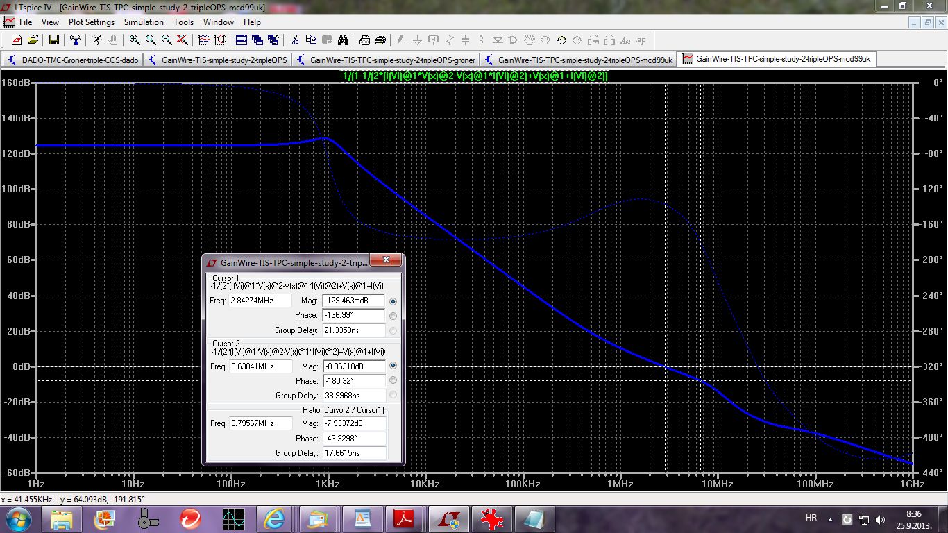

My hands are faster then my eyes. I started to simulate before you sent .asc file and in last simulation I forgot to change the feedback resistors values.
Here is new sim, better but still not so good, Higher feedback resistor values probably lower slew rate.
BR Damir

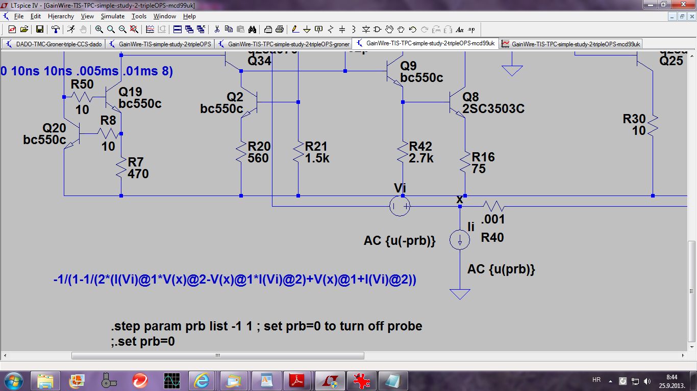

About Tian probe,
You can see on this picture that I have the text in the schematic.
-1/(1-1/(2*(I(Vi)@1*V(x)@2-V(x)@1*I(Vi)@2)+V(x)@1+I(Vi)@2))
and spice directive
.step param prb list -1 1 ; set prb=0 to turn off probe
;.set prb=0
When you run .ac, plot, let say vout then change it to
When you want to sim .tran then change spice directive to
;.step param prb list -1 1 ; set prb=0 to turn off probe
.set prb=0
BR Damir

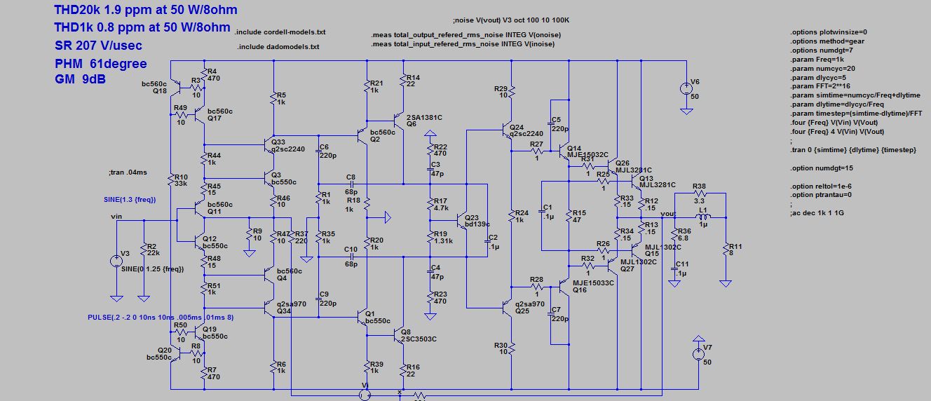

Thank you for looking at the circuit. Evidently, I'm not using the tian probe properly yet. Will have another try later. Going to follow your instructions to the letter.
The Enhanced VAS configuration wasn't my creation. It was lifted from Edmond's MCP amplifiers. Although in this the VAS was cascoded as well. It seemed a very elegant solution and I just wanted to highlight it in this thread before the enhanced VAS was rejected. The only thing I have noticed is that this configuration seems to require some loading on the output to counter some closed loop peaking.
TPC may work better than TMC and better values may improve things.
The problem I found with reducing the feedback resistors was a peaking in the closed loop response. Haven't found a good way of controlling this yet.
Paul
I don't know why I insisted to use Baxandall pairs as VAS(TIS).
Now I changed it to the simple enhanced VAS and results are much better.
Sorry mcd99uk, but it looks that all increase in complexity is not needed.
BR Damir
ps probably because it worked so well in the non GNFB GainWire preamp.

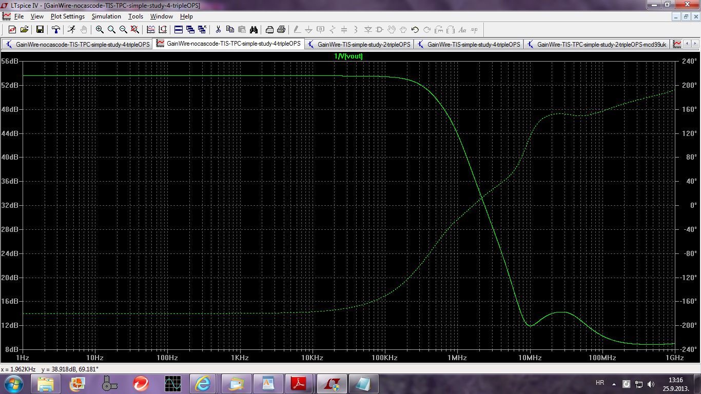

Christophe, you know we are of the same age, but I am trying to be jung in my hart and learn new things, you know, to delay alzheimer.
Regarding open loop gain, how you simulate it? Definitely it's not accurate enough to do it at VAS input or VAS output, OPS is the main constrain.

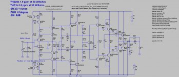

BR Damir
No need for the sorry.
Baxandalls are apparently good at rejecting current distortion from the OPS though. Wonder if in real life this would prove an advantage.
The only real difference between our circuits is that the extra complexity helps with defining the VAS current. The question is whether this VAS fighting issue worth the extra complexity?

Simpler, but I will not go for zener as I explained why not before.
