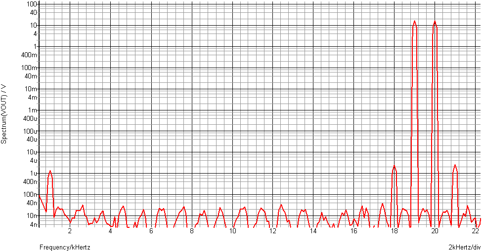

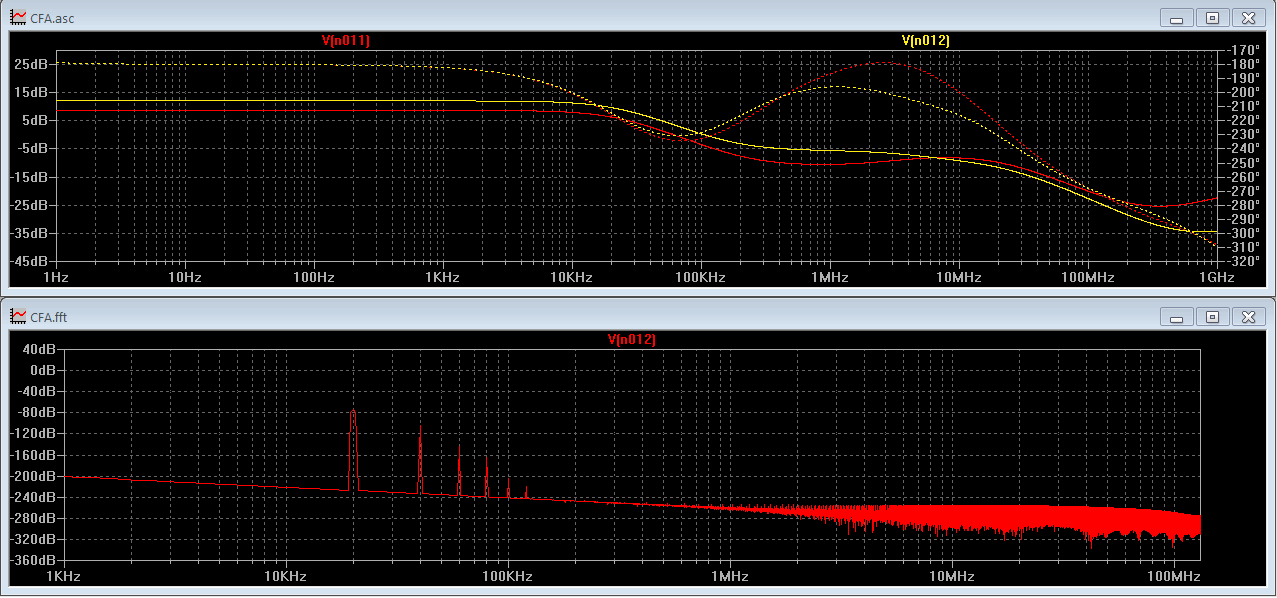

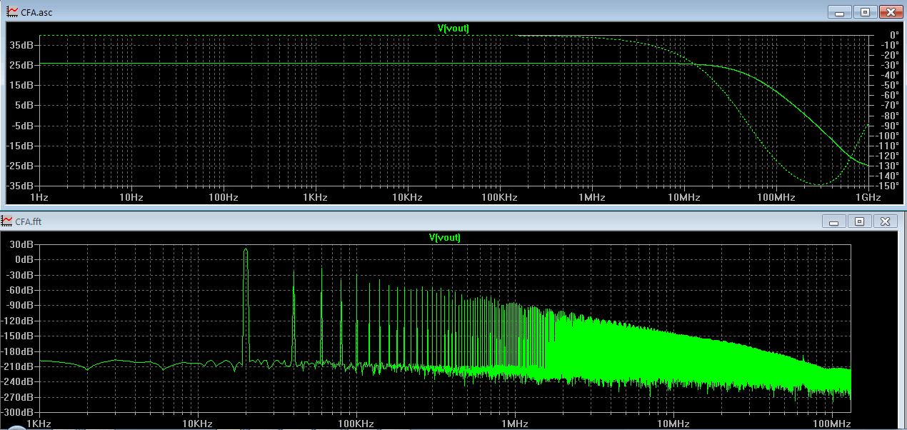

Just few thoughts...
Apart the input stage, i see nothing that really distinguish VFA vs CFA on a topological point of view, and believe all what we can improve VAS and Output stage sides can be applied to the the two topologies with the same benefits.
About input stage, "Lapalice" like, the difference is in the way feedback is subtracted from the signal. We could compare the two with a differential input stage CFA, and got the same PSSR, i presume.
Error correction, local or global, is just a way to apply more feedback without modifying the closed-loop gain. But whatever the ways, we will have to pay it cash with high frequencies distortions/ stability margin because the extra phases turns that come with. As well as we have to pay back DC servos (or lytic caps) with low frequencies distortions for the same reason.
An other approach of CFA error correction by PMA: http://www.diyaudio.com/forums/solid-state/40543-new-error-correction-amp-6.html
Notice: replace the AD844 by a VFA fast OPA, and we have... a VFA error-correction amp, and a bunch of acronyms ;-)

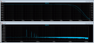

About a typical class AB output stage, 150ma with power mosfets (who want to use something else ?)
See attachment.
As expected, 20KHz harmonic distortion is ~1% near clipping, 0.05% at 1V and, as we can see, this part of the amp is far to be the limiting one, on a bandwidth point of view.
Then, a simple VAS, (in blue) without feedback:
Distortion is something around...84% at 20KHz
About ULGF aggressive 3MHz ??? I don't understand, it is what i personally require for a VFA *closed loop* before input filtering.
Hoping it helps.

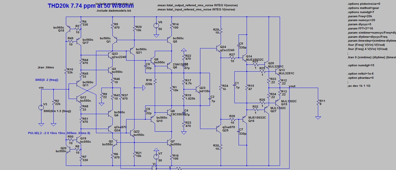

This is my best(up to now) CFA, with very benign hormonic distribution even at 20Khz.
THD20k is 7.74 ppm at 52W on 8 ohm load. Nex step, simplification.
BR Damir
