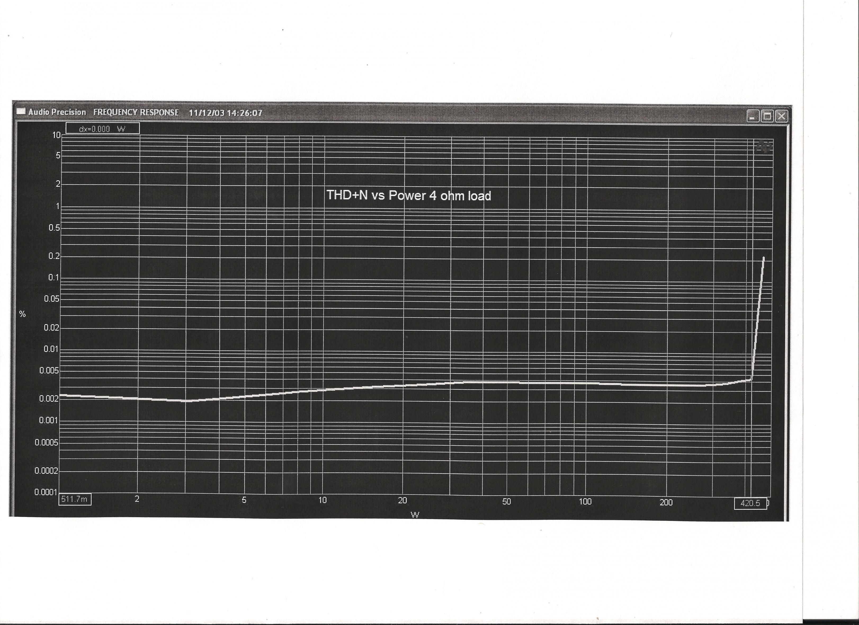

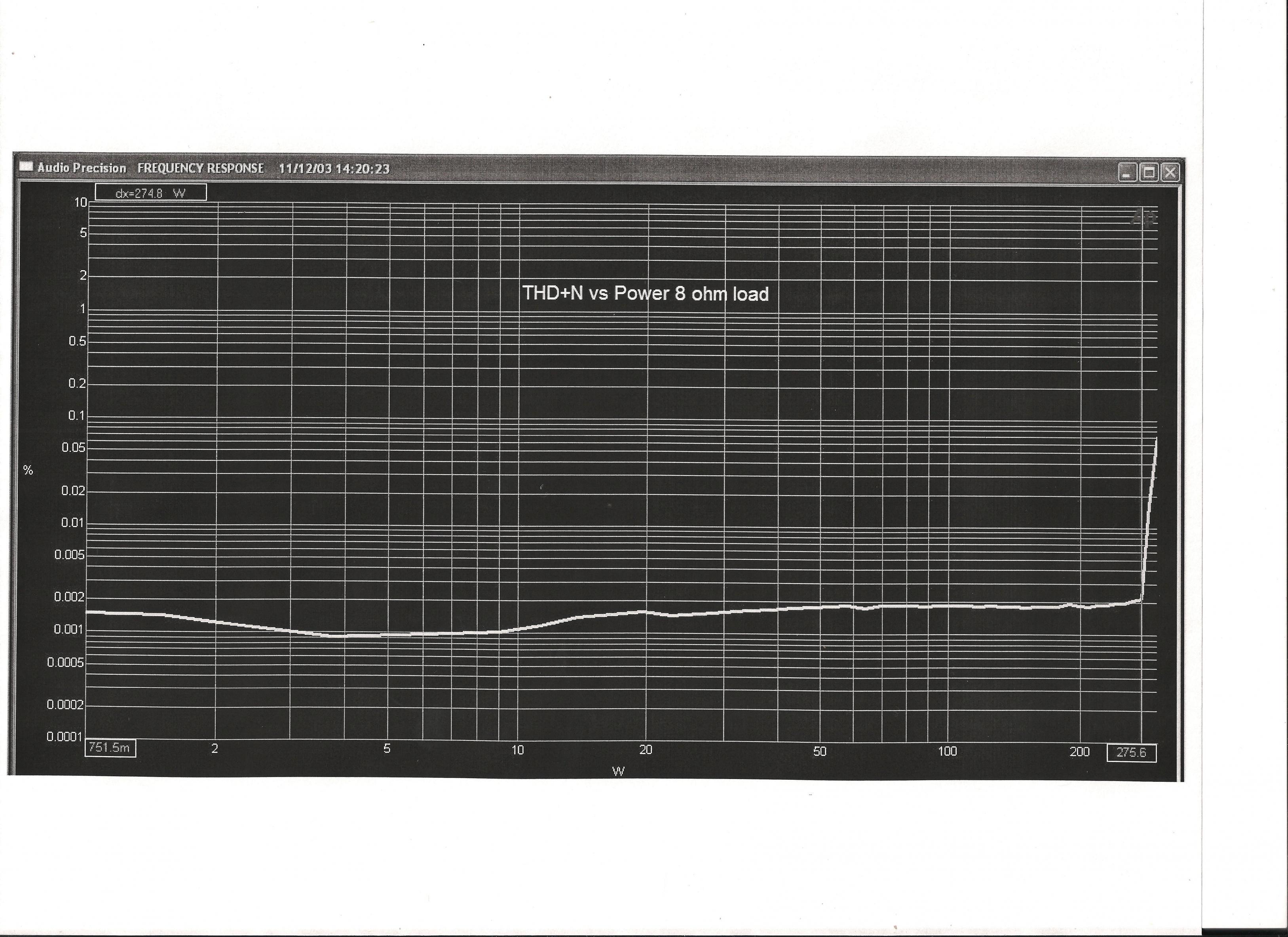

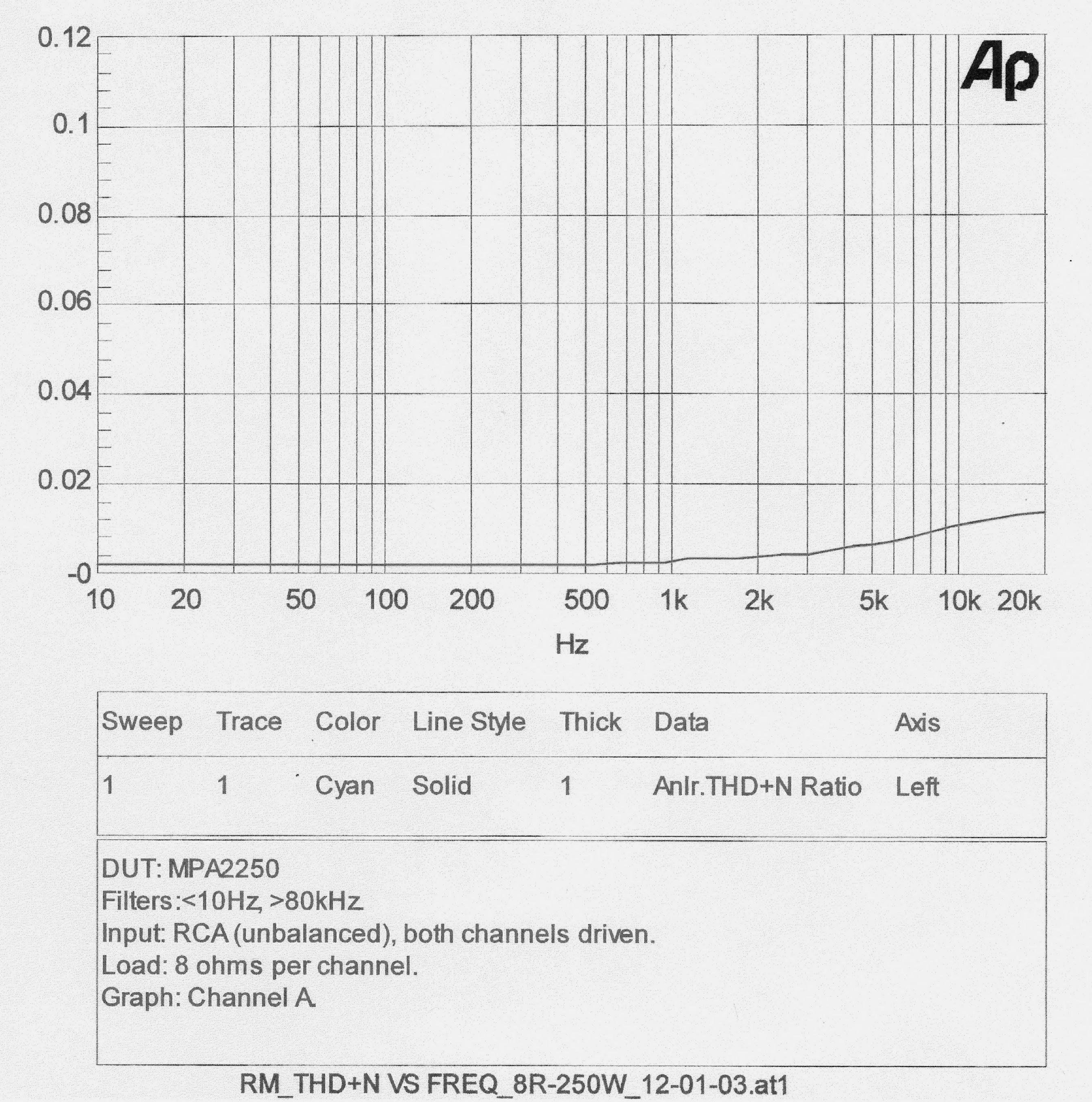

All THD+Noise. Production:
And at 1 dB below clipping -250W vs freq. Prototype:
If we stay on track and 'git er dun' as a Phase 1 progress, then we can see more data and refinements and even better results in Phase 2.
[ -- the shown is from data of 10 years ago design.]
THx-RNMarsh

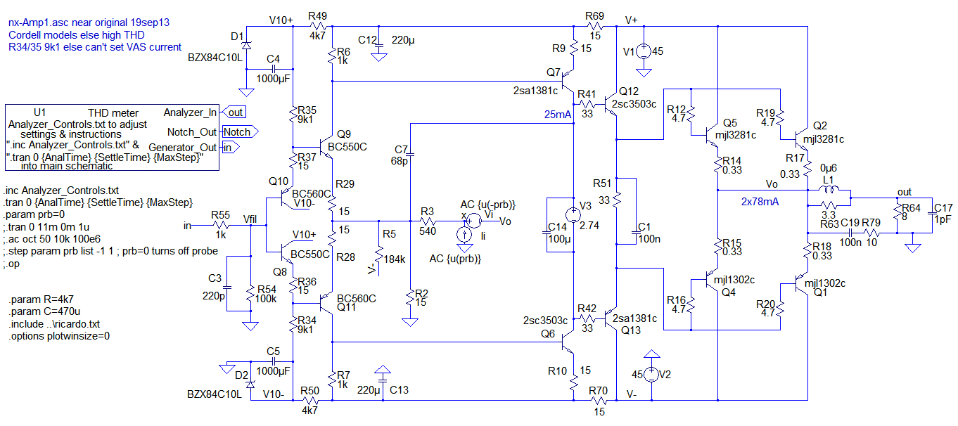

I've been doing sims of Bonsai's http://hifisonix.com/nx-amp/.
I like to have a starting point that is at least bears some resemblance to 'real life' ... in this case, Bonsai's measurements. It wasn't as straightforward as I expected. To get to my near 'real life' starting point, I had to
  • replace his modes with Bob Cordell's including using BC550/560C for the input to get similar THD
  • increase his R34/35 from 4k7 to 9k1. These set the IPS currents but the original value didn't allow his specified VAS 25mA current.
    (Bonsai is currently looking at reducing VAS current by increasing R30/31 emitter resistors ... but that would drop the loop gain even further.)
  • I've also reduced his rail voltages from 50V to 45V for reasons that will become obvious later

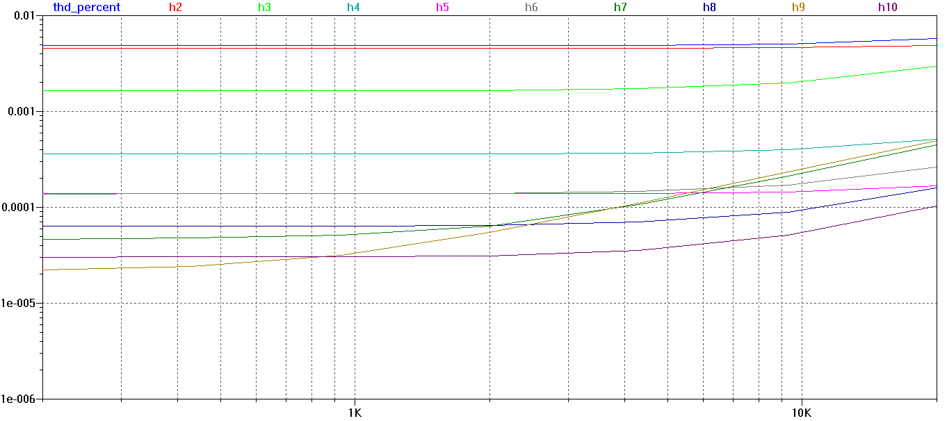

THD at 50W 8R

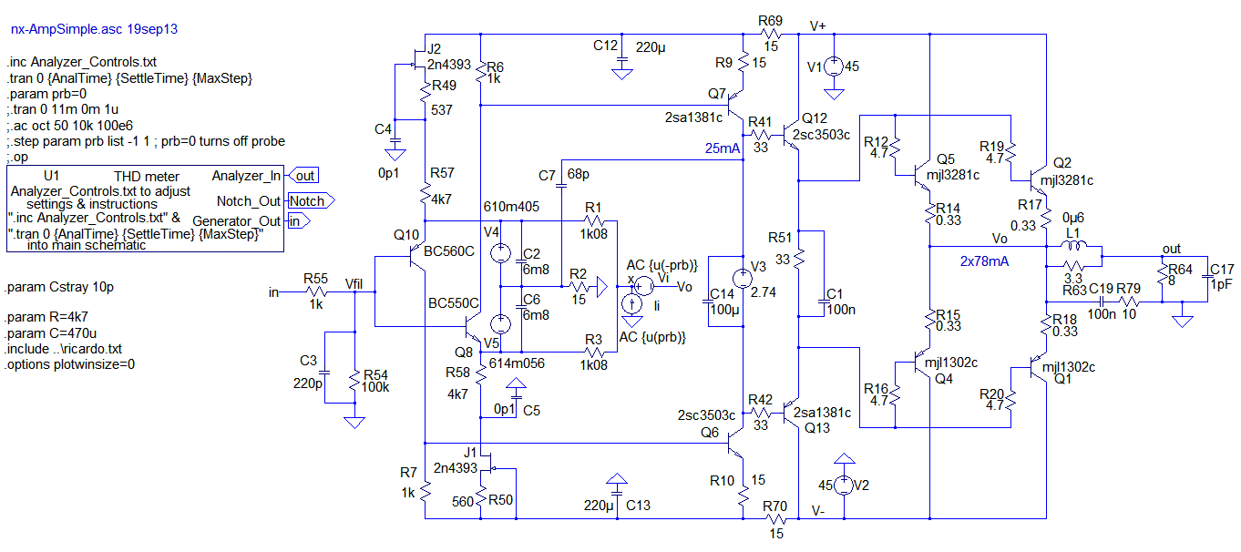

simple CFA input vs Diamond input
The evil reason for this work is cos I wanted to compare simple CFA input vs Diamond input :eek:
The conversion attempts to run each stage at about the same current. Compensation etc is unchanged.
THD has dropped 3dB all round. It's actually 2 less devices. I could have kept the Zener supply to the i/ps but I really want more PSR in these CFA inputs.

Richard, thanks for putting the sim up. Indeed, using the right models is critical, and especially so since the degeneration resistor values are low.
The alternative simple input stage you posted IMV has the clear disadvantage of two fat electrolytics and the IPS associated bias network - it's actually not simpler.
The advantage of the simple nx-Amp front end is that it is completely DC coupled - no caps and its extraordinarily stable once the initial offset has been dialed out. This kind of figures because the Vbe's all cancel, the collector currents are all equal and the Vce's are all equal.

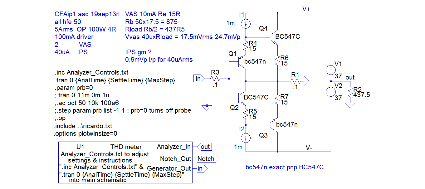

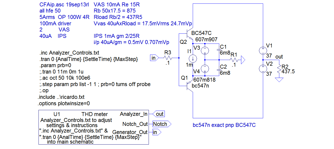

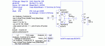

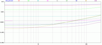

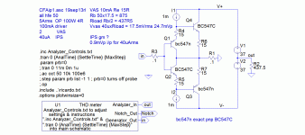

CFA input stages
Didn't really know what to expect and these results were certainly thought provoking. :eek:
Decided to go against my own exhortations and investigate these 2 input stages on their own. I also wanted to replicate some Jurassic 'real life' THD work I'd done with the simple CFA input though this was not power amps but a very low noise application. :)
Loadsa trial test circuits later, I ended up with the 2 attached. You are welcome to dream up your own. Note the estimated output required based on 100W 4R, all hfe 50 & VAS 10mA current. I haven't allowed for the i/p 'load' resistors (R6/7 in nx-Amp & nx-AmpSimple) which would probably double the load.
... loadsa sims later .. FINDINGS
  • Device matching is critical for Diamond. Tried all suitable devices including the LTspice ones, Gurus Wurcer & Cordell, most of those suggested in the Discrete Opamp Open Design thread
  • best match were Cordell's bc550/560C.
  • Both topologies have low THD which drops rapidly with level. Much better than LTP at similar currents
  • Neither are likely to contribute THD to a complete amp even at very modest FB levels
  • Diamond has a THD advantage over 'simple' but its unlikely to be achieved cos the matching required. I constructed an exact pnp complement to BC547C to check I wasn't doing something stupid
  • Diamond needs emitter resistors to have even a semblance of match
  • Diamond has a 3dB disadvantage in Gain. This fully explains the 3dB better distortion of nx-AmpSimple
CONCLUSION
  • In most CFAs, 'simple input' is likely to have a small advantage in THD cos extra Loop Gain
  • This may change if the rest of the amp's THD contribution drops by more than an order of magnitude :D
  • The 'flat THD profile' of CFA isn't inherent but probably cos the interface between i/p & VAS is via the i/p 'load' resistor (R6/7 in my nx-Amp models). ie its cos low Loop Gain at LF
  • The disadvantage of 'simple' is a couple of large evil electrolytics but these are operated under optimal low stress conditions and unlikely to introduce THD
  • From Bonsai's experience, Diamond doesn't have any DC offset advantage over 'simple'. Both need tweaking or a servo. LC's VSSA shows drift is not a problem
