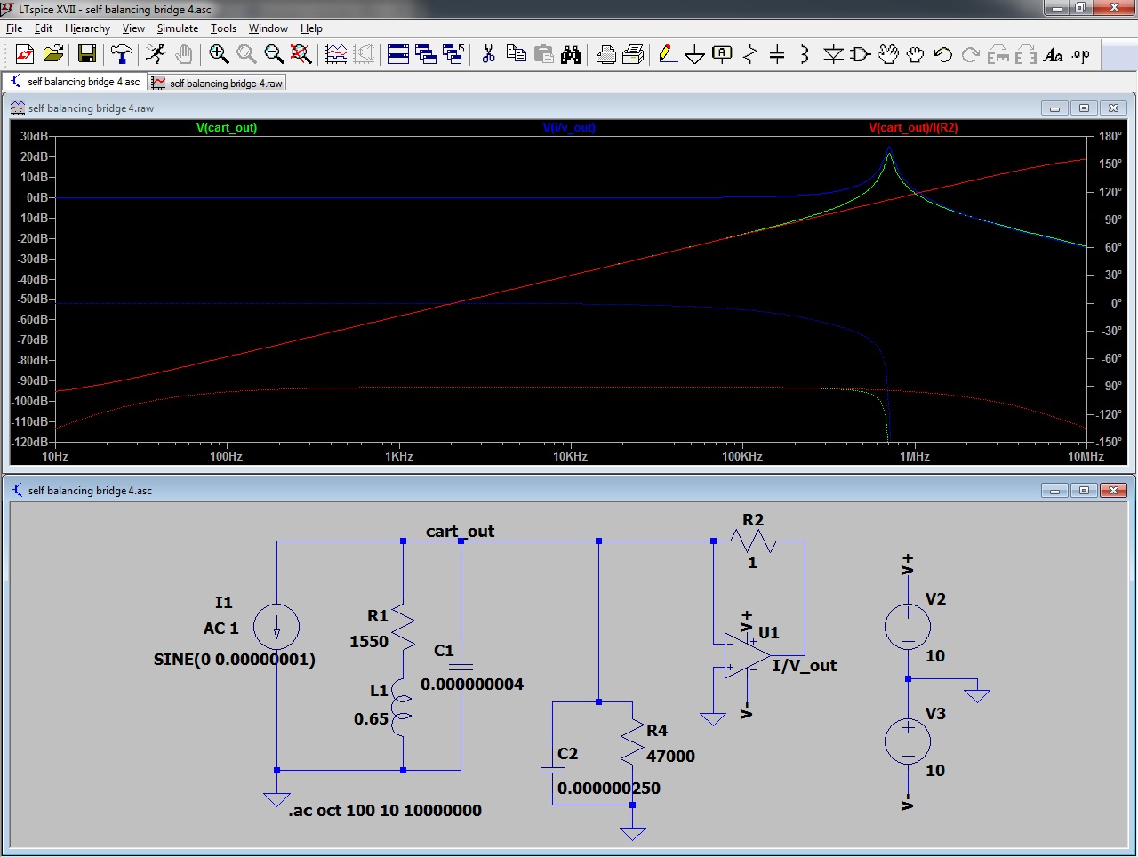

If you are going to put it in parallel shouldn't you drive it with a current source instead of a voltage source? A voltage source has no resistance, it is a short circuit.
Thank you Ray. I tried it on the sim. I don’t see dramatic changes. But how can I do it on the bench?
Up to now,
The signal generator I have used on the bench has an Ro of 50 Ohm.
The soundcard has an Ro of 150 Ohm.
The voltage source in the simulation has an R0 of 50 Ohm.
George

George,
Your circuit diagram with current source in / transimpedance out is correct but as you say difficult to realise.
The equivalent version is with voltage source in / voltage sense out with the Cart in series with the 47K/250pF, not with a transimpedance as in #455.
Hans
With voltage source plus transimpedance you measure the current through the Cart, but the 47K//250pF is playing no role because of the virtual gnd input of the transimpedance.
For measuring the impedance of the Cart only, that's O.k., but when you want to include the termination load in the equation, than you will need a voltage sensing amp.
Hans

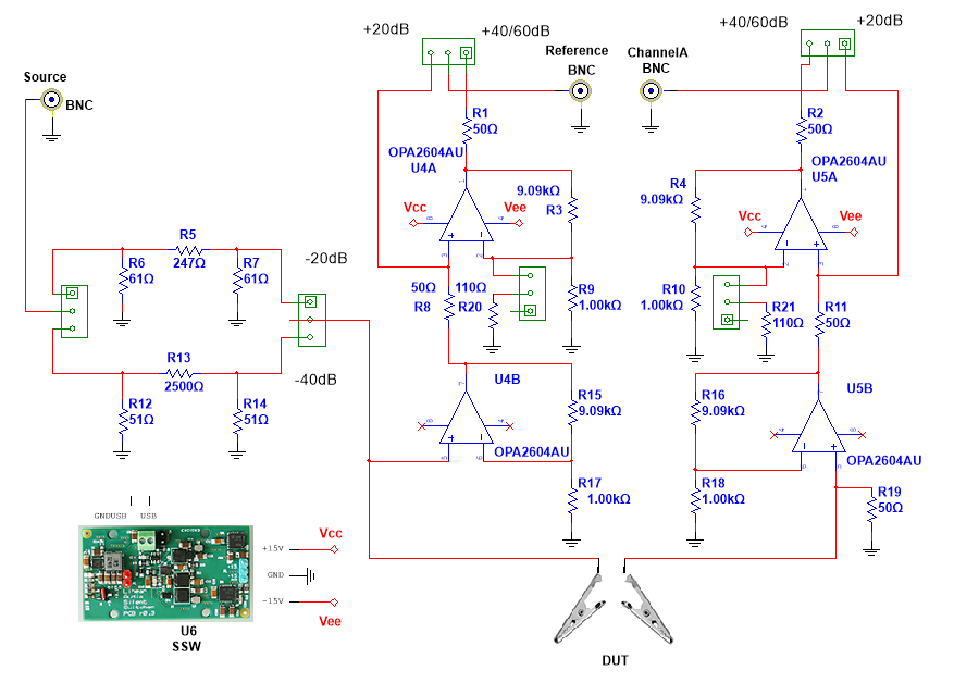

David,
I owe you an apology.
Because of switching signals in the computation in #451, I though your design was corrupting the phase, which I found was not the case as later shown in #457.
Further Simulation now showed that your design is perfectly able to calculate the inductance of the Cart's coil with very low voltages, deep down into the uV region.
I'm eagerly waiting to see your results.
Succes.
Hans

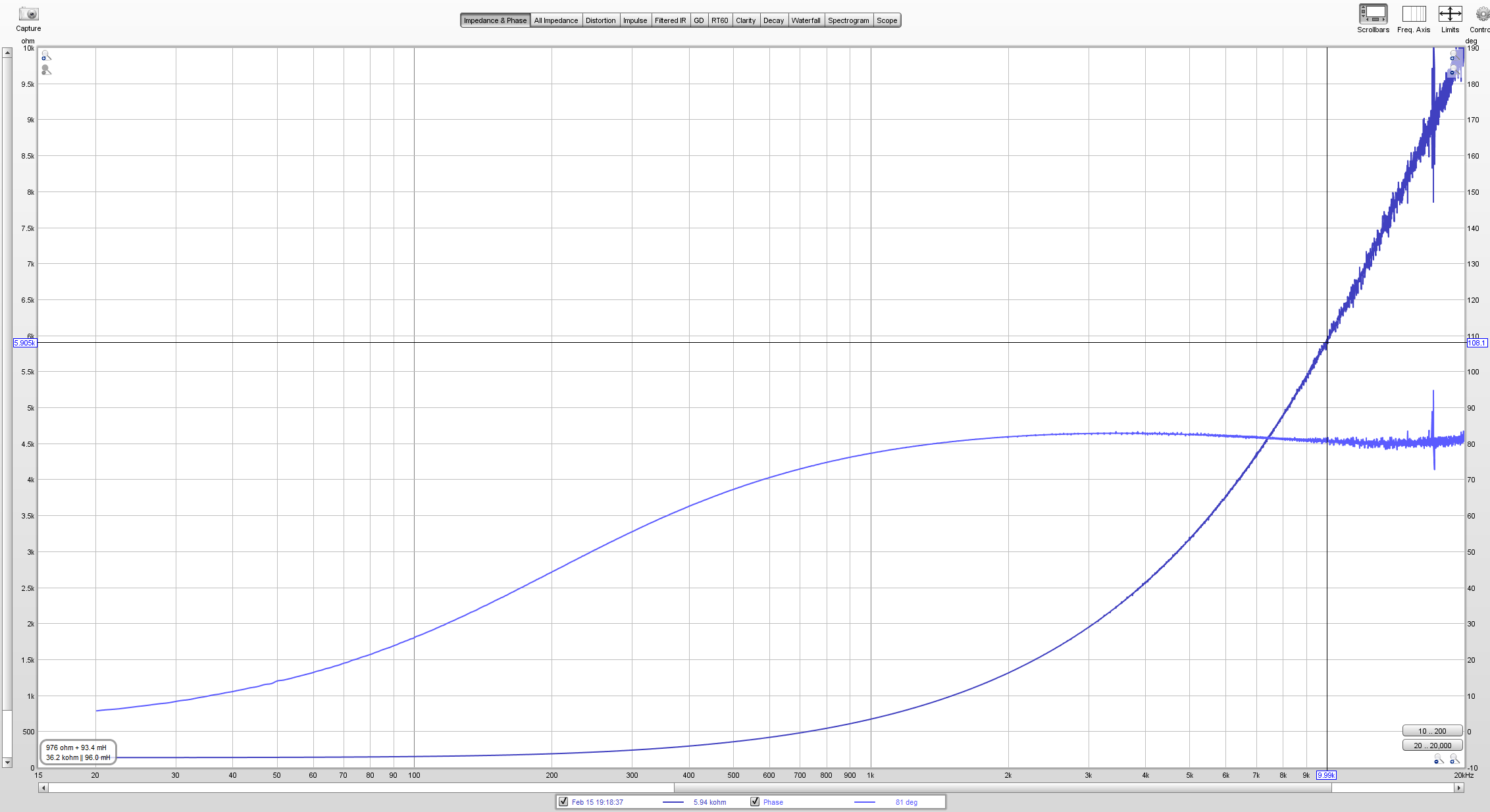

This is the G1042, impedance scaled by 1/5 to work around REW 10k max impedance in a graph - you put in false sense resistor value
This was made using an improved jig with reduced loading on the test sample.
Note phase now climbs to almost 90

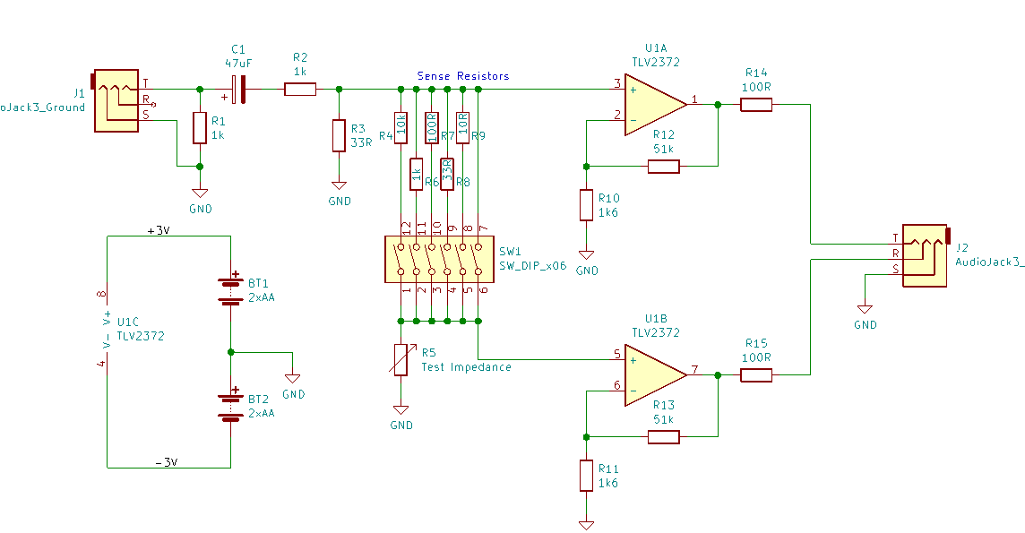

Dave,
Could you be so kind to tell the input level for making the recording in #470 and the filter BW (1/48 octave ?) that was used for measuring magnitude and phase.
Hans
The level at the REW impedance jig input, after input attenuation, was -40dBU. This drove the cartridge through a 5k1 sense resistor.
The bandwidth is unknown, REW does a slow frequency sweep, which in this case was 1M. There is some sort of averaging going on. Slower sweeps give better SNR.
SNR gets worse at high test impedances as the voltage across the sense resistor gets smaller and smaller.
A potential source of phase error is timing offset between Left and Right ADC inputs.
In my jig I found a small error appearing at 20kHz of a few degrees.
Hi Dave,
Do I understand you correct, -40dBA after the 1K/33 Ohm input attenuation ? This would then mean approx 6.6mV on the Cart at 3 Khz, right ?
Hans
Roughly yes:
DAC output is -10dBU
Input attenuation = 30 dB
So voltage at sense resistor = 10mV peak, 7mVrms
Voltage on cartridge = 5.8mVrms at 3kHz
