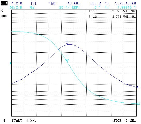

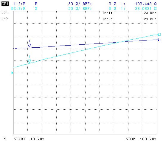

Instead of doing a series-through impedance measurement, what if you used a return loss bridge? The 3577 bridge only goes down to 100kHz, but the HP E5090A does DC to 2GHz.
I have the 5090 and an E5100A VNA (10kHz-180MHz), but I have no MM carts to test. I did a couple of quick tests on a MC; Self Fres of ~2.78MHz (drive level was -30dBm or 7mV).

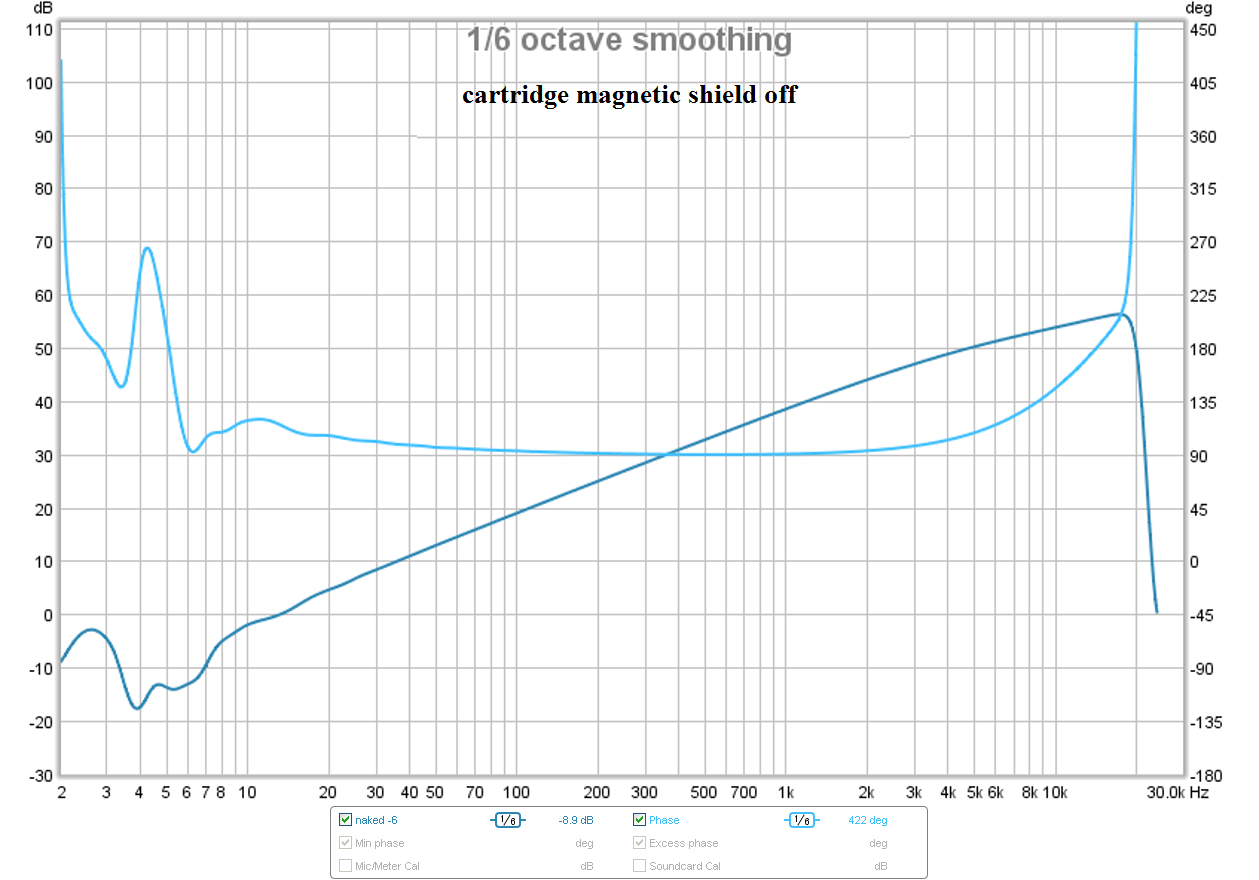

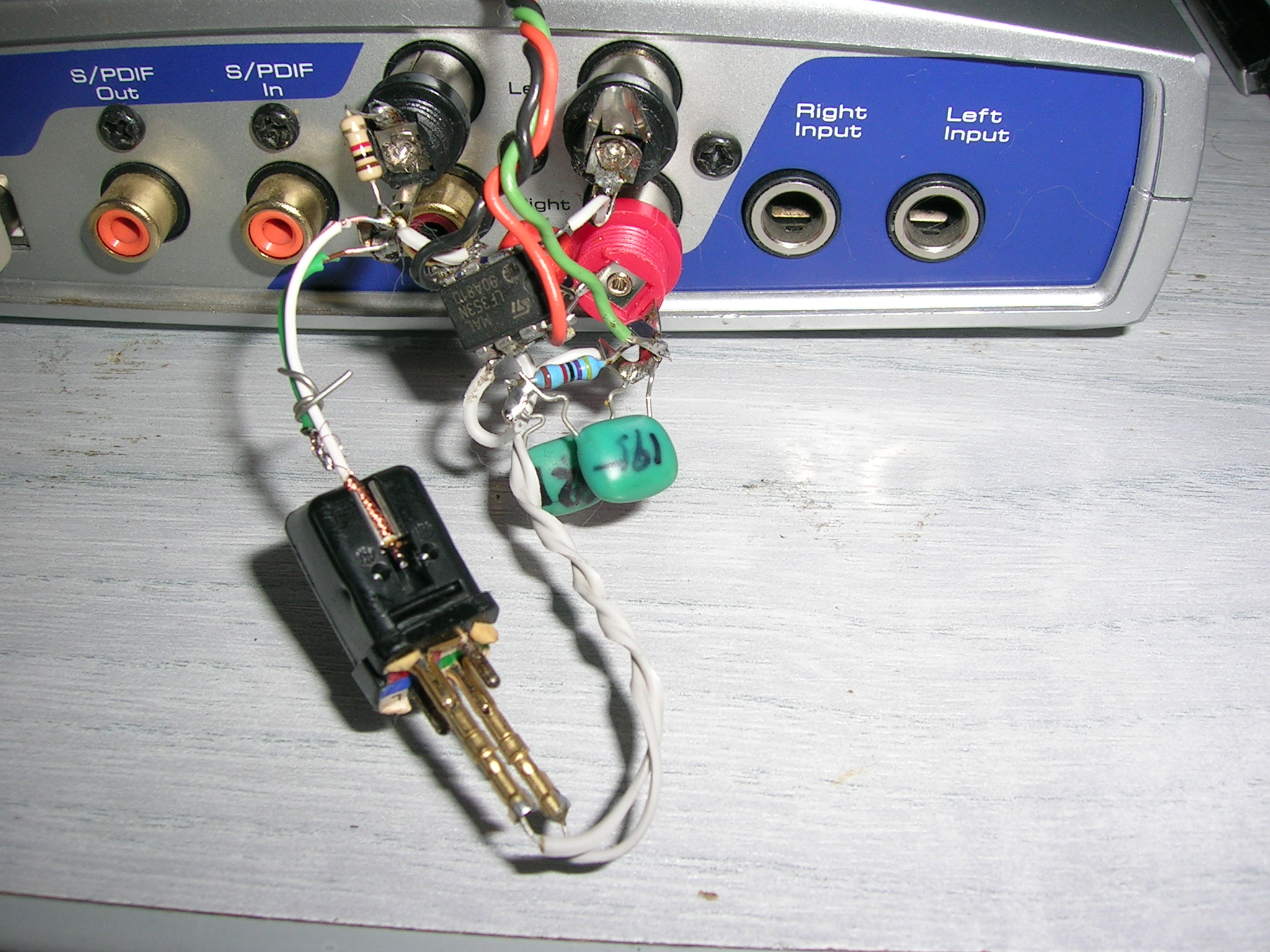

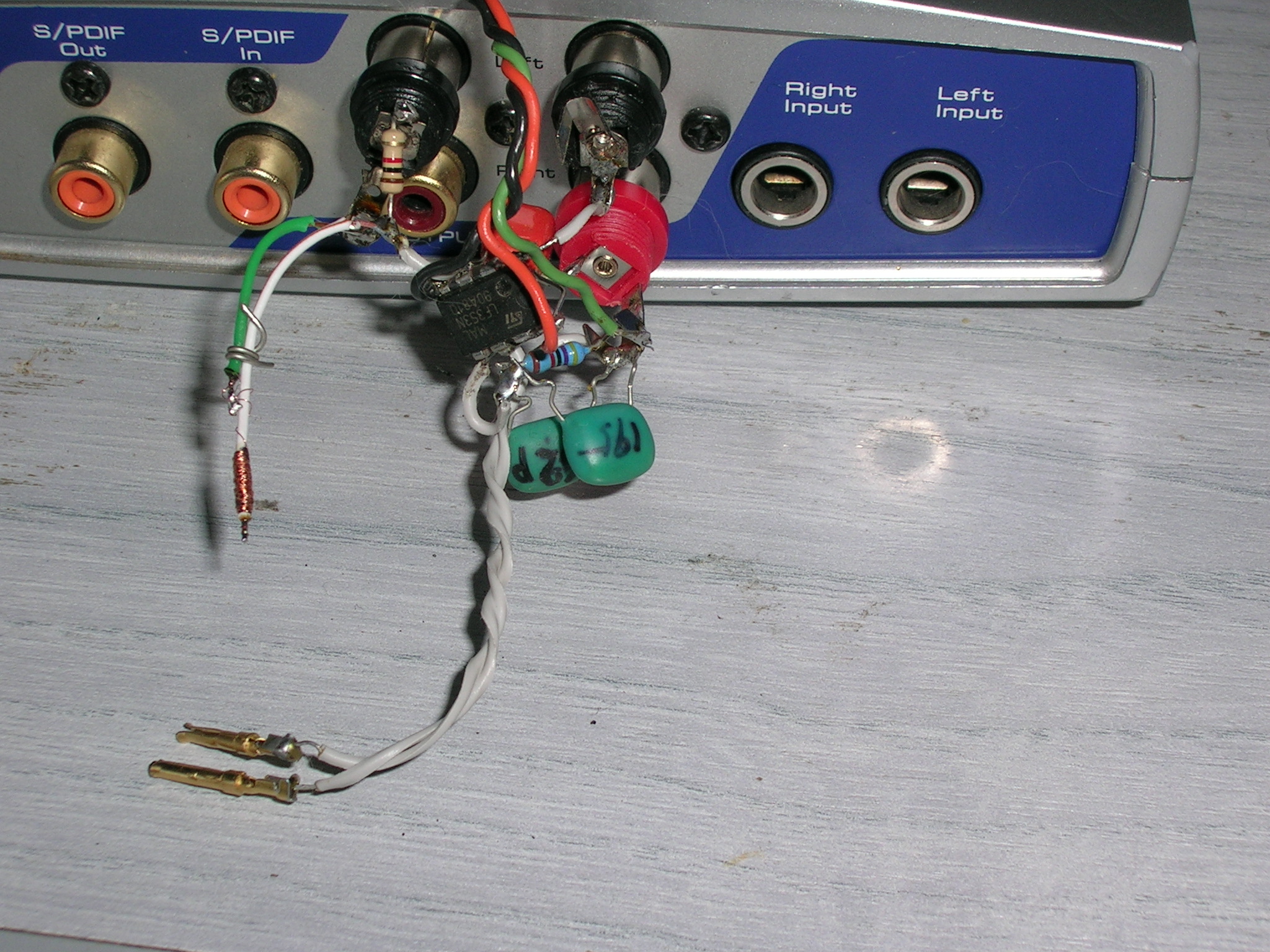

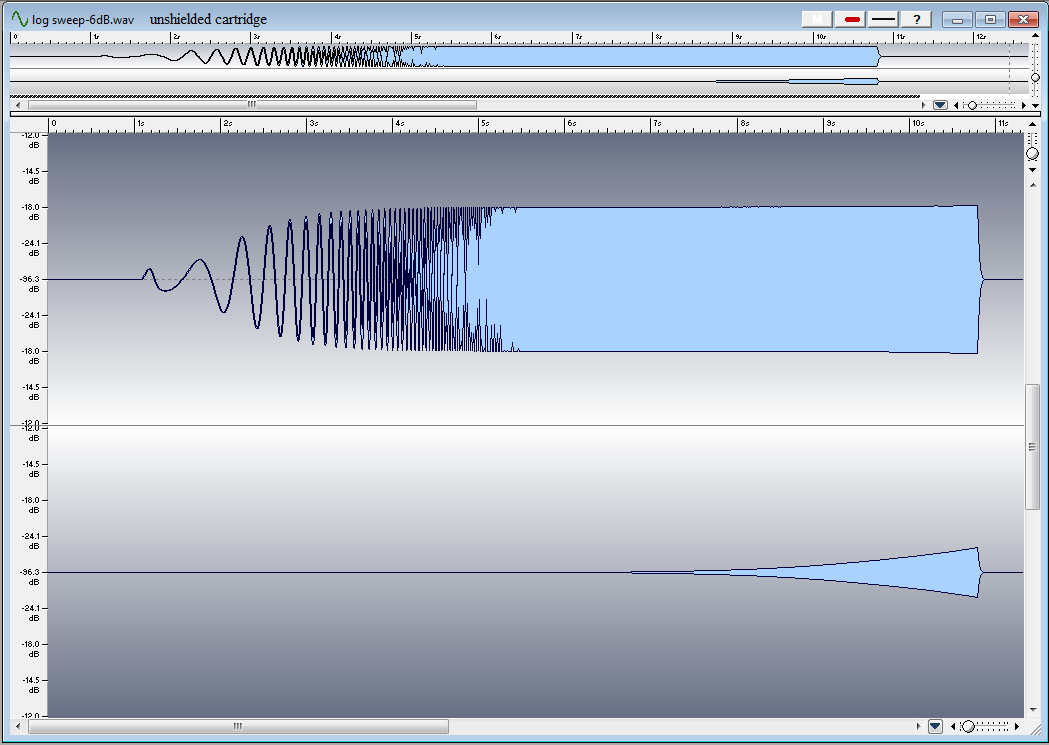

Cartridge dynamic behaviour
I had done some tests then, I can’t remember why I had not reported it (whenever I report here, I am forced to do some proper documentation of the work )
I haven’t tested this.I was hoping to prove that sensing the voltage on the unloaded coil gave the same relative amplitude of voltage out as when loaded with 47k||100pF.
?Everything seems to work as expected but now no noise or frequency response of the loading and the coil has -30dB of the current.
We are waiting for it.Time to try my 10M||1pF buffer in the headshell.

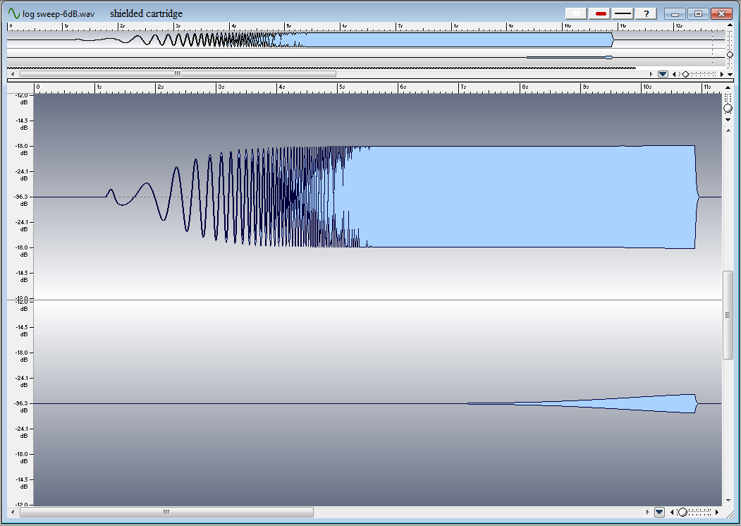

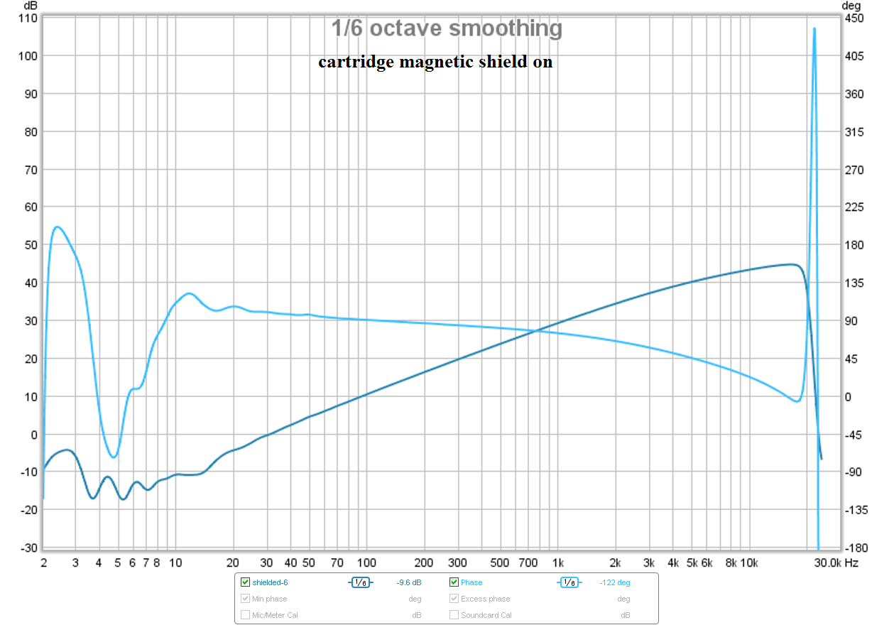

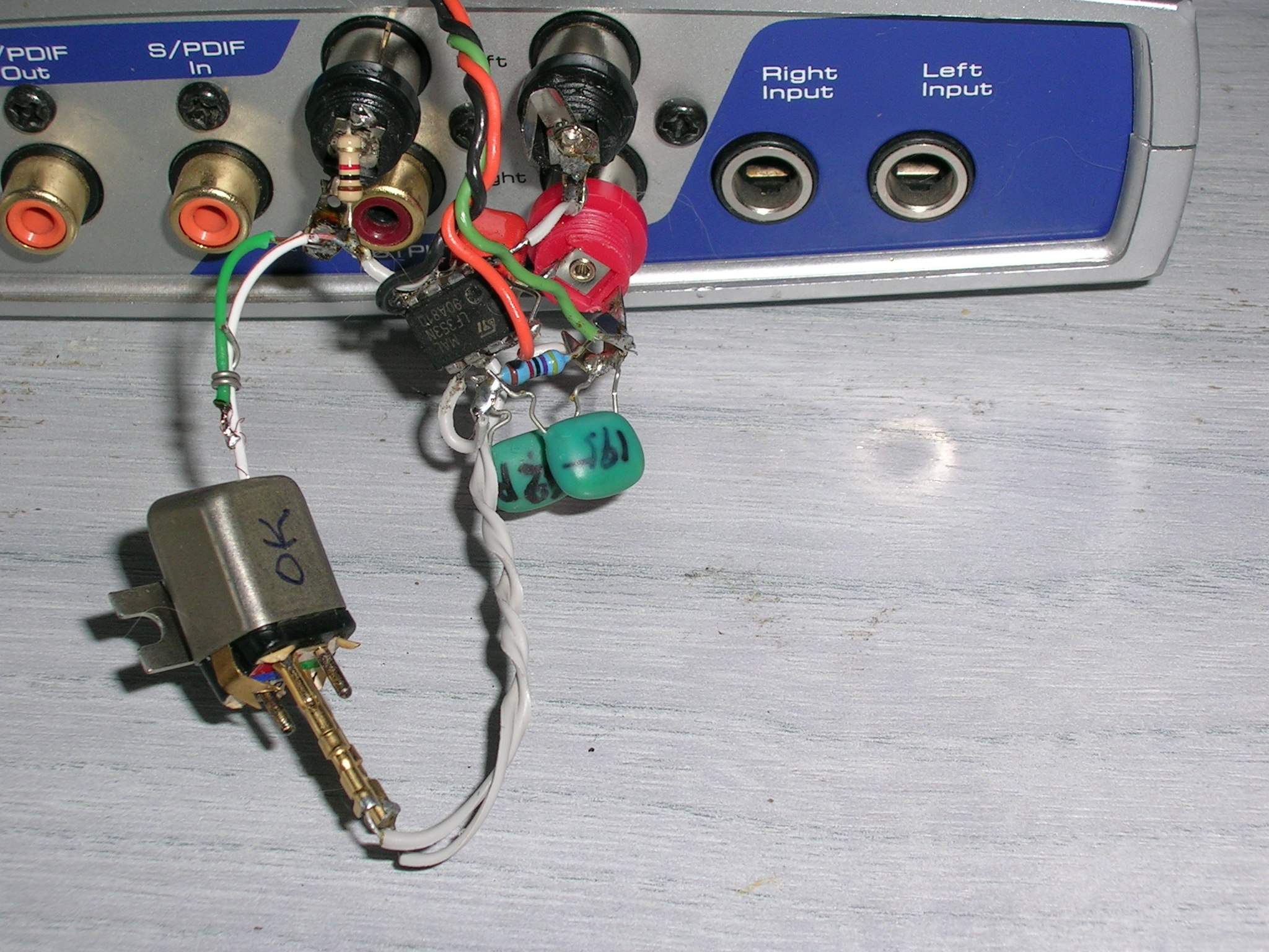

3 Schematics of actively buffered freq response measuring jig.PNG24.2 KB · Views: 151

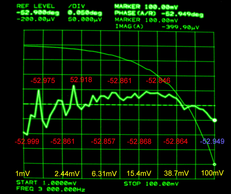

The HP 3577 uses a 8/12 bit successive approximation ADC and a pre-scaling VGA which takes two passes at each data point. the 10Hz bandwidth requires 370ms to settle, so each step is set for 2 seconds, and averages set to 32 and "A" Attenuator at 0dB. Press the trigger and go pour another cup of coffee.
Phase across the Caddock 5k resistor seems pretty much the same at 3kHz, around +1.01 degree.
So that you can see what we're dealing with -- a plot of phase vs generator level from 1mV to 100mV, courtesy of the 5K caddock and AT cart.

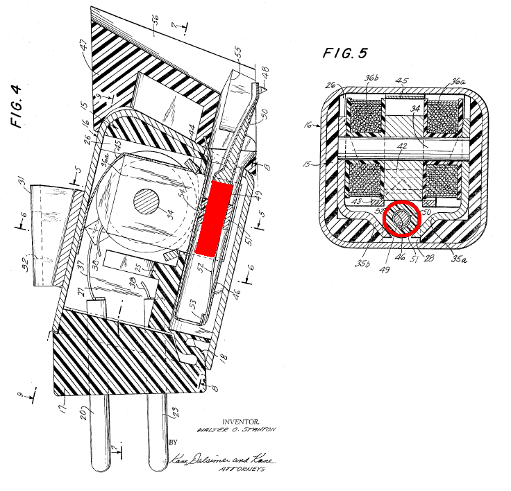

George, the open circuit voltage means there is no path for current in the coil, flux change will induce an open circuit voltage just as it will induce a closed circuit current and anything in between. I just wanted to prove to myself that nothing funny happens. So nothing changes same RIAA pre-amp just one with "infinte" input impedance and that means attached directly to the cart.
What Demian suggested is an actual electrical flux coupling, I don't think (which my sims indicate) that this mimics the flux ring (MI) or moving magnets (MM) wiggling on the cantilever i.e. no mechanical impedance elements.
it seems there would be several coupled systems to model for this. The stylys groove interaction, the cantilever stiffness and internal resonance, the compliance and resonance of the pivot, the interaction of the magnet and the fixed magnetic circuit or vice versa depending on which moves(which could be quite strong), and the magnetic to electrical conversion. What i proposed only looked at the last part.

Scott, in the sim did you get what I got from measurements (attachments 7,8 in post #425)?

Sorry for my ignorance, but what exactly are we seeing, I can't figure it out no matter how hard I try.
1) You refer to a 5 K attenuation resistor, but when I look at the marker in your image at 100mV it says Imag(A) -399,9 uV. This is at the low voltage end of the cart at input A ? in that case no 40dB dB attenuator has been used, and almost 50mV is over the cart, true ? Or did you already use an 40dB Amp before the A input ??
2) you planted a number of figures on the image in red and blue, seemingly the Phase (A/R), but how can it be so accurate. ? And 52 degrees seems quite suspect at 3Khz ? In your previous image in #385 it was over 85 degrees below 10Khz.
3) What do the two lines represent in the figure, the smooth one going from top left to bottom right and the wobbly line in the middle.
I suspect the wobbly line represents Imag(A), in that case it is still a voltage, with a scale of 50uV/div, correct ? And how does this translate into a 0.46mH inductance L.
Hans
