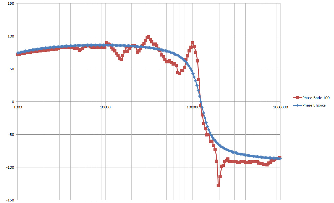

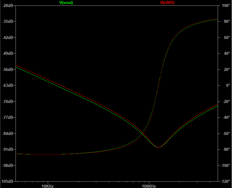

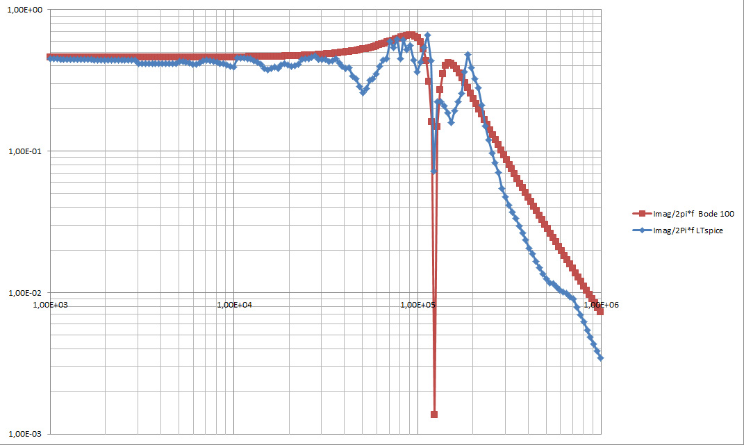

With the very noisy data recorded with the Bode 100 that I kindly received from Jack, see Cartridge dynamic behaviour, I have compared these data to my LTspice model: (0.46mH + 800 ohm) //800K//3.6pF.
The images below are showing both Phase and Inductance the same way as the HP3577A does.
Results are very comparable, telling that the LTspice model is quite close to the ATM540L.
Hans

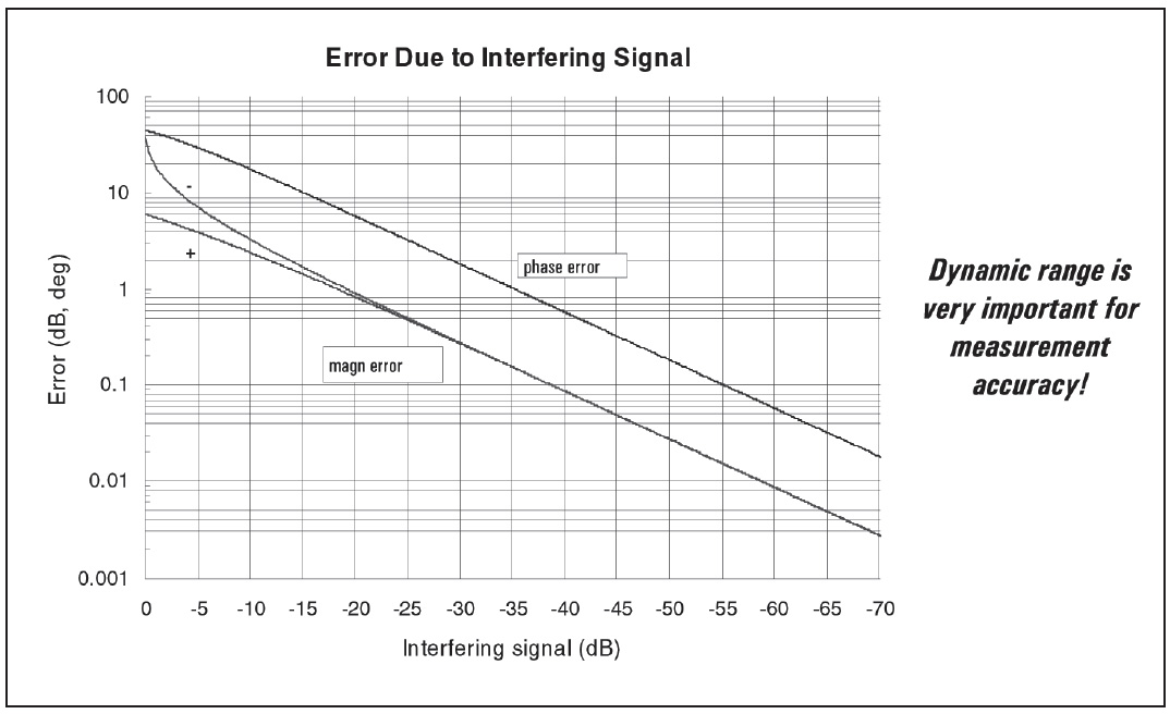

Hi LD,
According to the image below, with 47dB SNR, phase error will be below 1 degree and magnitude error below 0.1dB.
Hans

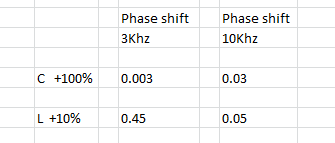

We need to look seriously at the sensitivity to model fit. Here is -10% on L and +10% on C. This would be buried in the noise that has been shown so far.
In the table below, one can see what 100% variation of the Cap and 10% variation in L does to the phase at 3kHz and at 10kHz.
But because phase is close to 90 degrees, a bit of noise on the phase doesn't hurt to calculate the imaginary from the complex modulus |Z|.
Maybe it would therefore be even better to measure at 10kHz instead of 3kHz, because at this frequency phase is closest to 90 degrees, giving probably the highest accuracy in calculating L.
Hans
