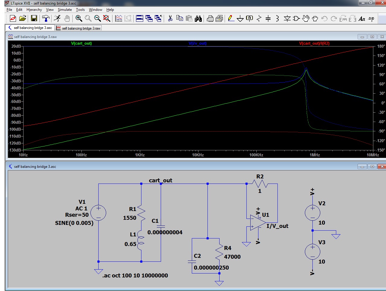

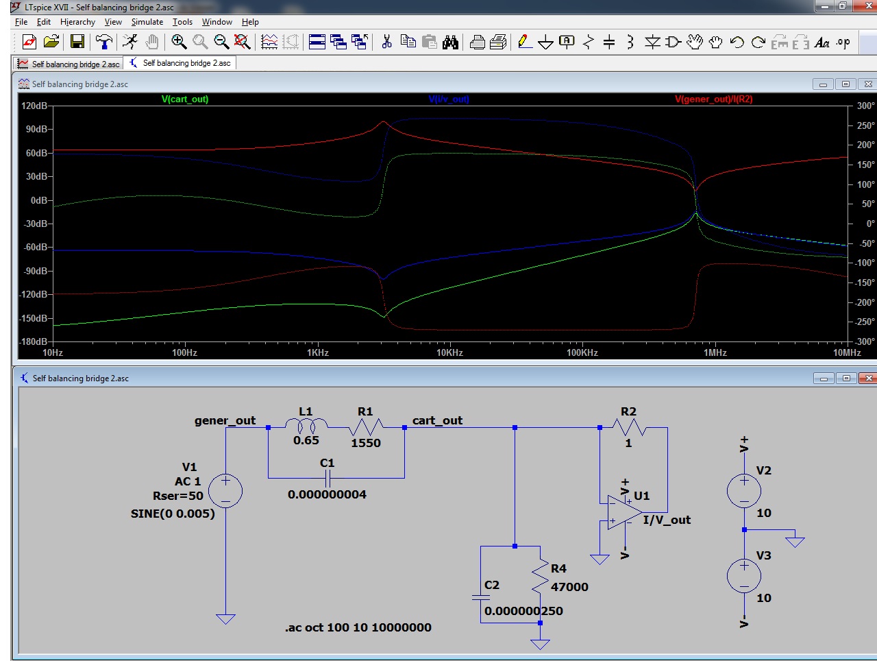

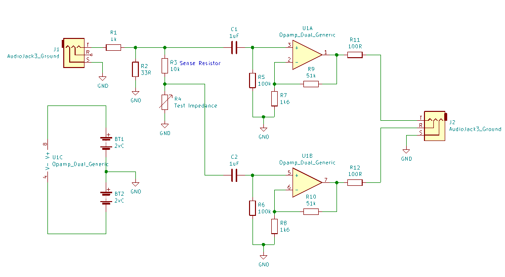

After some experiments with the REW impedance jig, which found that my soundcard was lower impedance than specced and had 10nF input capacitance,
I am assembling a revised jig as attached.
I am attenuating the souncard output by 30 dB and then amplifying the sense voltages by 30dB to get a usable SNR at mV levels.

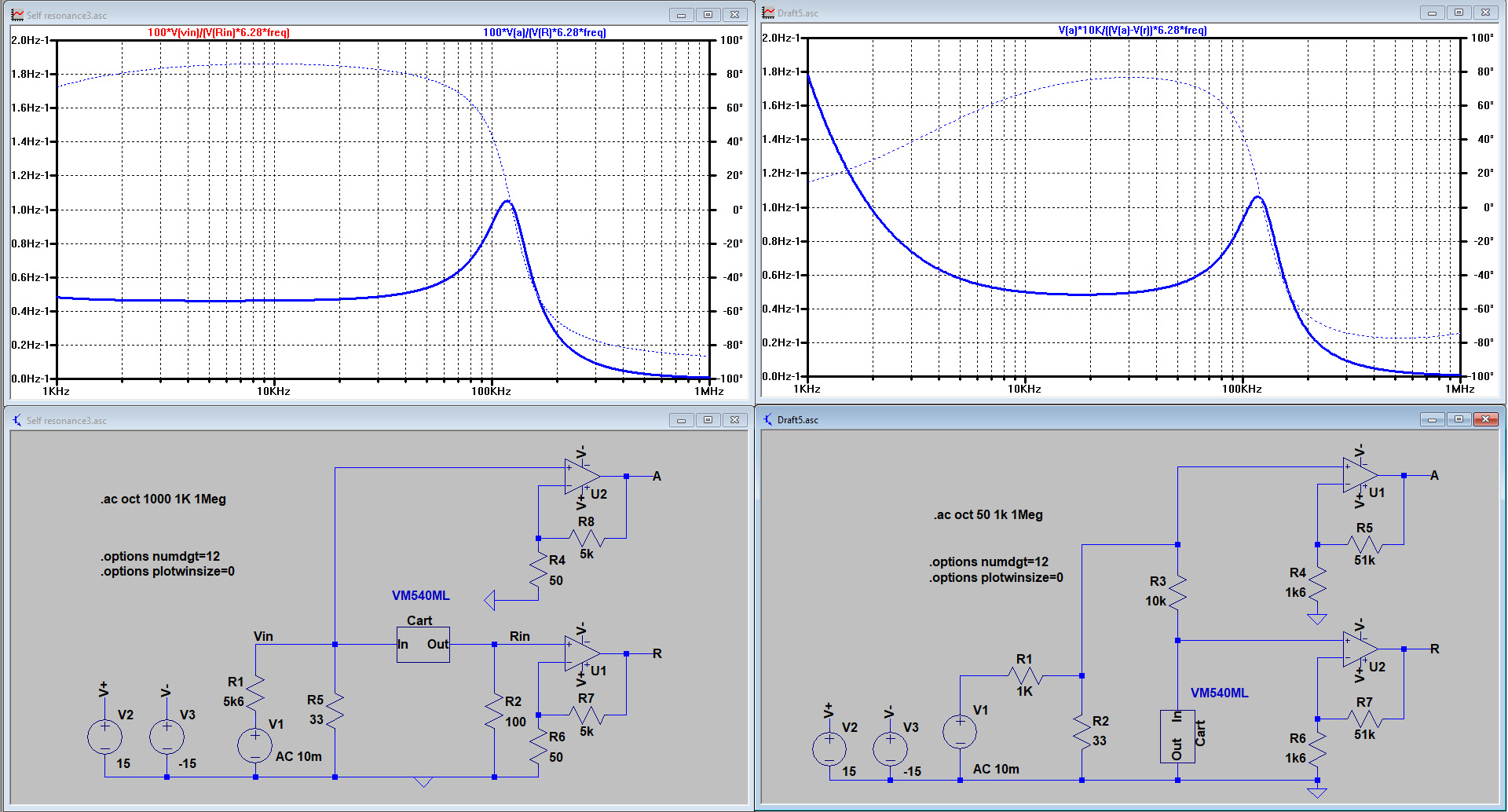

Hi David,
I made some calculations and rearranged your design a bit, enabling the lowest possible measuring limit over the Cart, in this case 58uV when using a 10Hz BP filter.
To make such a low uV measurement possible, 10Hz BP filters should be used in the digital domain to reduce the noise , thus increasing the S/N.
To make a measurement relatively accurate, a SNR of 35dB should be aimed for as a minimum.This will give a max phase error of 1 degree and a max magnitude error of 0,1dB.
A resistor in series with the Cart should be used that has very little effect on the phase error, too low and the signal will become weaker as needed, too high and the phase relation becomes highly inaccurate.
An optimum seems 100 Ohm, giving a phase error of 0,5 degrees at 3kHz, the preferred frequency to be used for measuring, yet producing only 1.4nV/rtHz or below 4.5nV noise for a 10Hz window.
Using an A/D convertor with a Sampling rate of 192Khz having an estimated noise at -100dB, will produce 0.1uV noise through a 10Hz BP filter.
The noise from the OPA at low output R should be a bit above this level, so I’ve set it at 1uV to be on the safe side.
A 5534A produces 3.5nV/rtHz, or 11nV in a 10Hz window.
Therefore to get the calculated 1uV at output R, the amp should have a Gain of 100. Noise from the 5534A added with the 100 Ohm termination resistor gives 1.2uV noise at the output of a 10Hz filter.
To get the 35dB SNR, signal at output R (see circuit diagram below) should now be ca 68uV@3kHz.
For the given Cart, the VM540ML, this translates into 58uV at the input of the Cart. With the shown voltage divider 5k6/33 a 10mVrms@3Khz must be used as input signal.
This 58uV@3Khz is also the voltage over the cart, thus being the low end limit of the measurement.
The complete circuit diagram is given below.
Since LTspice has a huge dynamic range, the calculation is made both before (in red) and after (in blue) the OPA’s as a prove that the result is identical and that the Phase errors introduced by the OPA’s are cancelled by using two identical amp’s.
At the same time when comparing the two, shows that the transfer of the original circuit diagram is not accurate in phase and magnitude, thus not suited to use for the envisaged purpose.
Hans

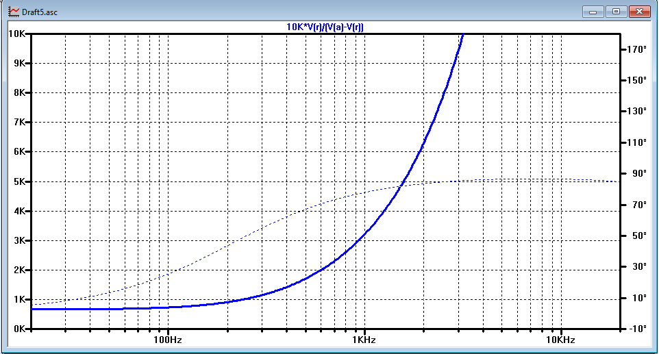

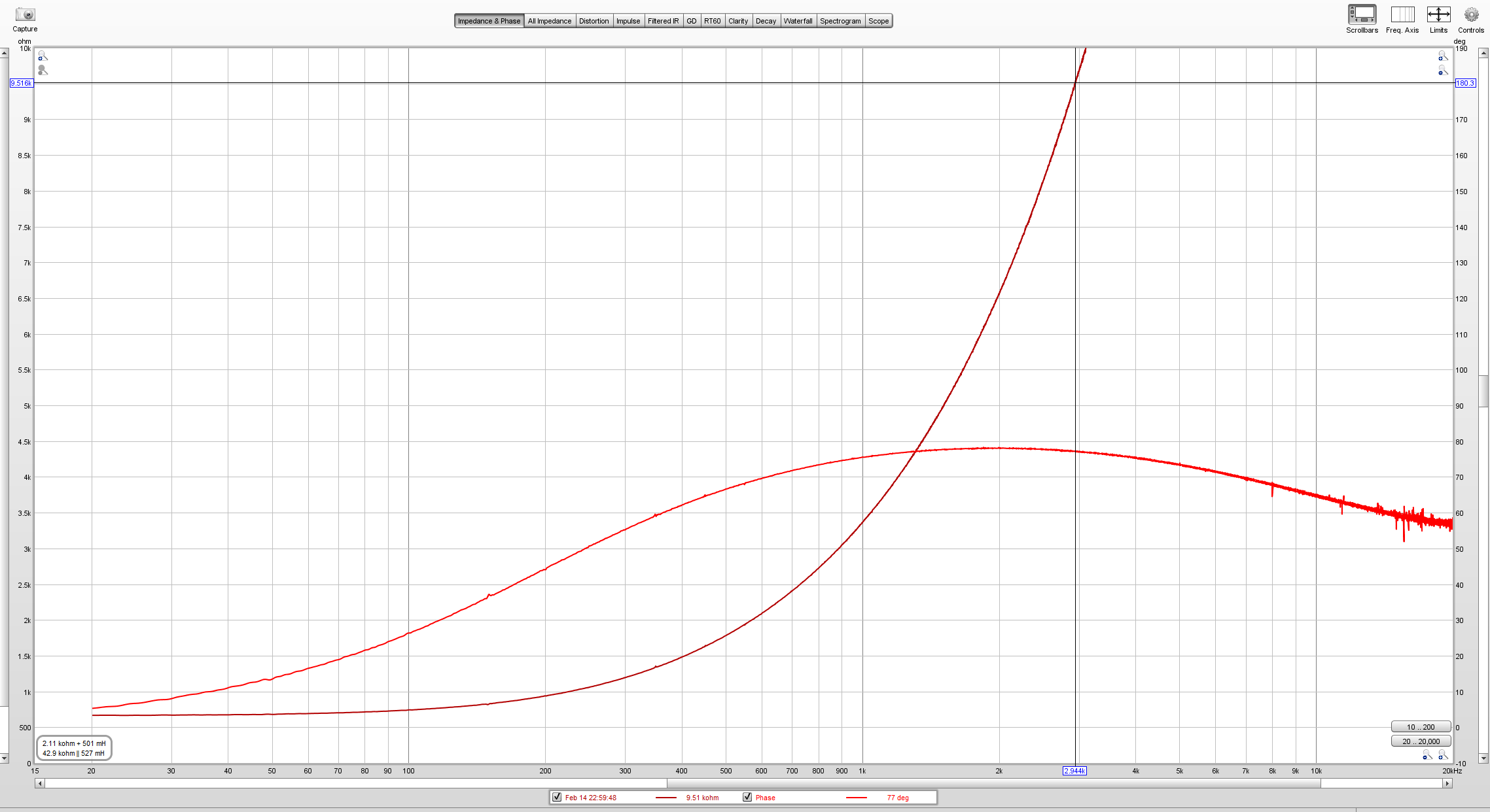

First measurements
REW has a feature that the sense resistor cannot exceed 10k and the graphed impedance cannot exceed 10k
The G1042 measures 660R +500mH at low frequencies.
Phase reaches 45 degrees at 200Hz
At 1kHz the resistance has increased to 850R
At 2KHz the resistance has increased to 1k4 and phase peaks at 77 degrees
Graph is unchanged over 50dB dynamic range

Hi David
Electrically, your cart is close to the AT110E.
Your impedance measurement is very close to what I have measured on the AT

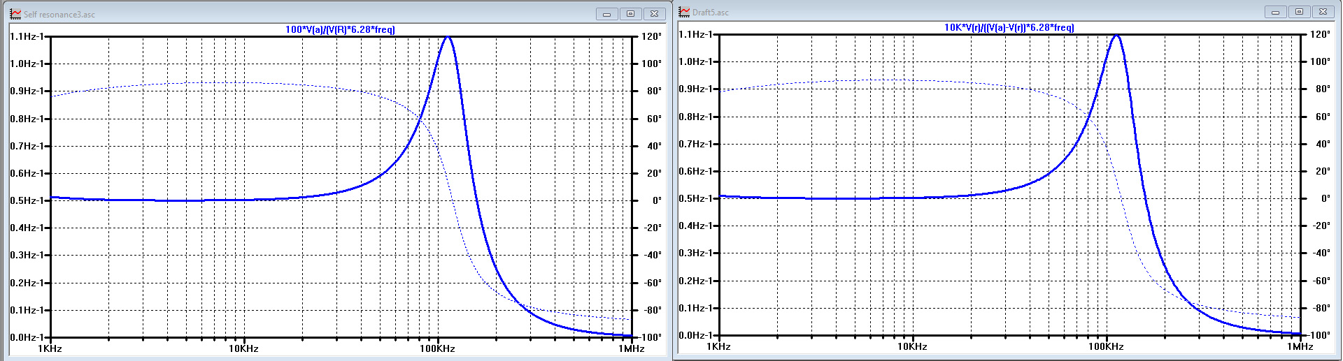

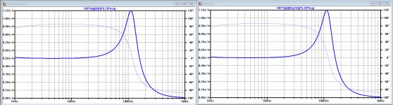

Sorry David,
I made a mistake in my display in #451.
Since you have the 10K resistor at the other side of the Cart, I switched V(a) for V(r) in your case, now both being exactly the same in phase and magnitude.
Here is the corrected version for the two designs.
But still completely valid is the noise calculation to go as deep as 58uV over the cart.
Hans
