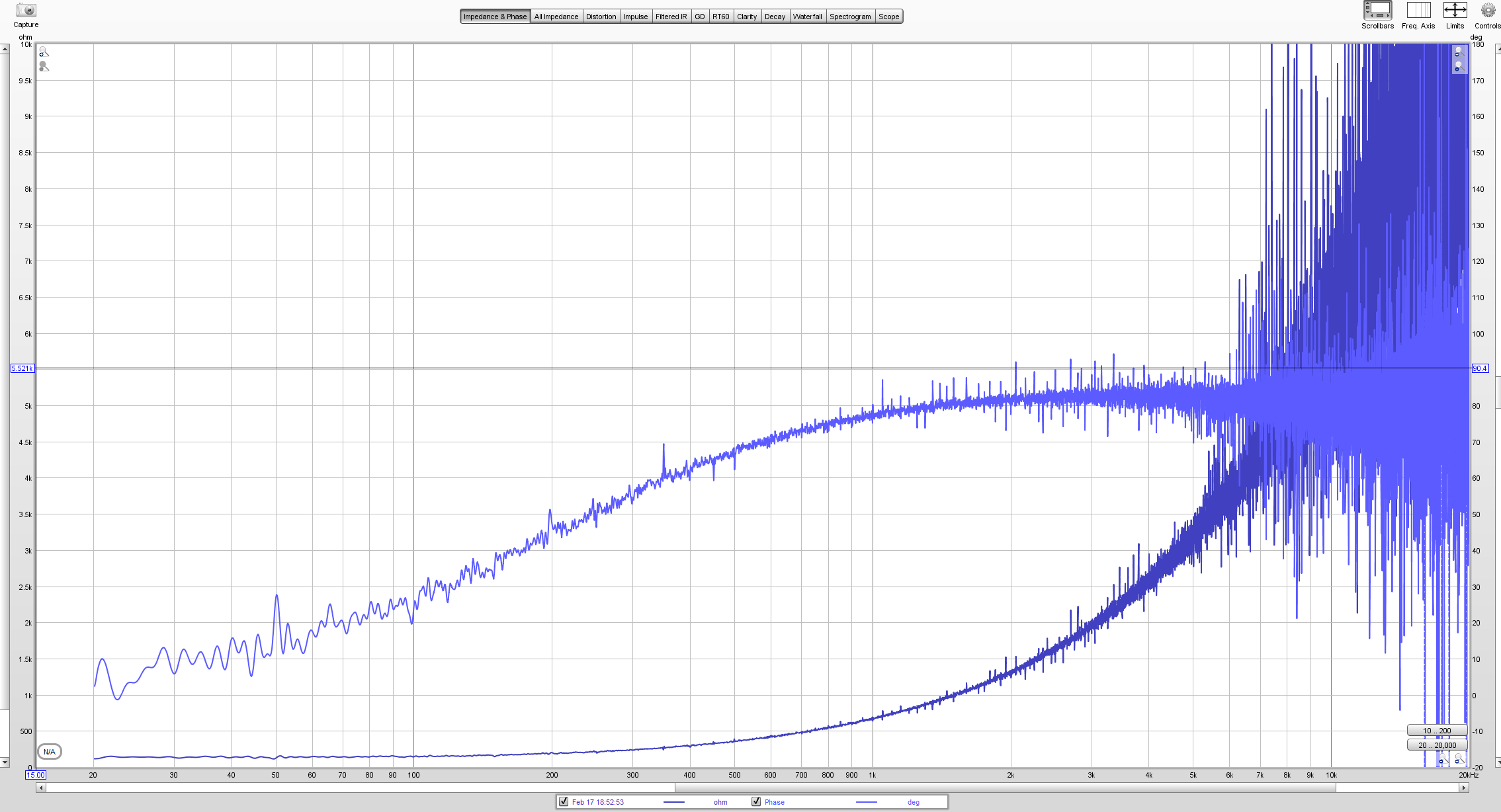

A -80dBU measurement.
Again impedance is scaled by 1/5, so the maximum value is really 50k
I used 2M samples, 4M gets an out of memory error on a 8GB PC
The TLV2372 is a noisy opamp, the only rail to rail I had to hand.

Hi David
Impedance is calculated as: Rsense*V(r)/(V(a)-V(r)).
V(a) and V(r) both being contaminated with noise of a certain percentage.
When V(a) and V(r) in the denominator are coming close, the error in the calculation of Z becomes bigger and bigger.
That's what I think that can be seen in your image.
The higher the frequency, the closer V(a) and V(r) become and the higher the noise in the calculation.
Say V(a) is 100 and V(r) is 95, both carrying +/-1% noise.
V(r)/(V(a)-V(r)) may now vary between 94/(101-94) and 96(99-96), or between 658 and 288. The original error of 1% has now become +/-39%.
The only remedy to keep the voltages apart, is to increase Rsense.
This won't increase the noise, because your Cmos amps will stay to be the dominant noise contributors.
So my question is to prove the theory and to get a more accurate measurement, could you repeat the measurement with Rsense 20K or even 50K.

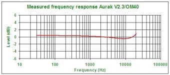

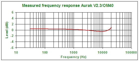

Except that we have measurements of the same generator with different phono stages, some with dip some without.
Moving magnet phase shift has some plots (with unknown test record accuracy) that seem to show dip then peak and yet I can show almost totally flat responses from similar generators.
For example attached from LD's own measurements. Ok maybe 0.5dB down at 10kHz which is a lot less than most other measurements show. Sigh. I think we are back to the accuracy of the test record being as large as the effect we are measuring...
Yes those guys ran the CBS LP's at 45rpm. The "same" means the same everything or it is a large collection of meta-data.
I generally trust the STR-112 results, they use no equalization on either end and the LP was not made with anything but highly technical users in mind. Accounting for a -2dB dip with electrical effects and a 45mH motor generates absurd numbers.
