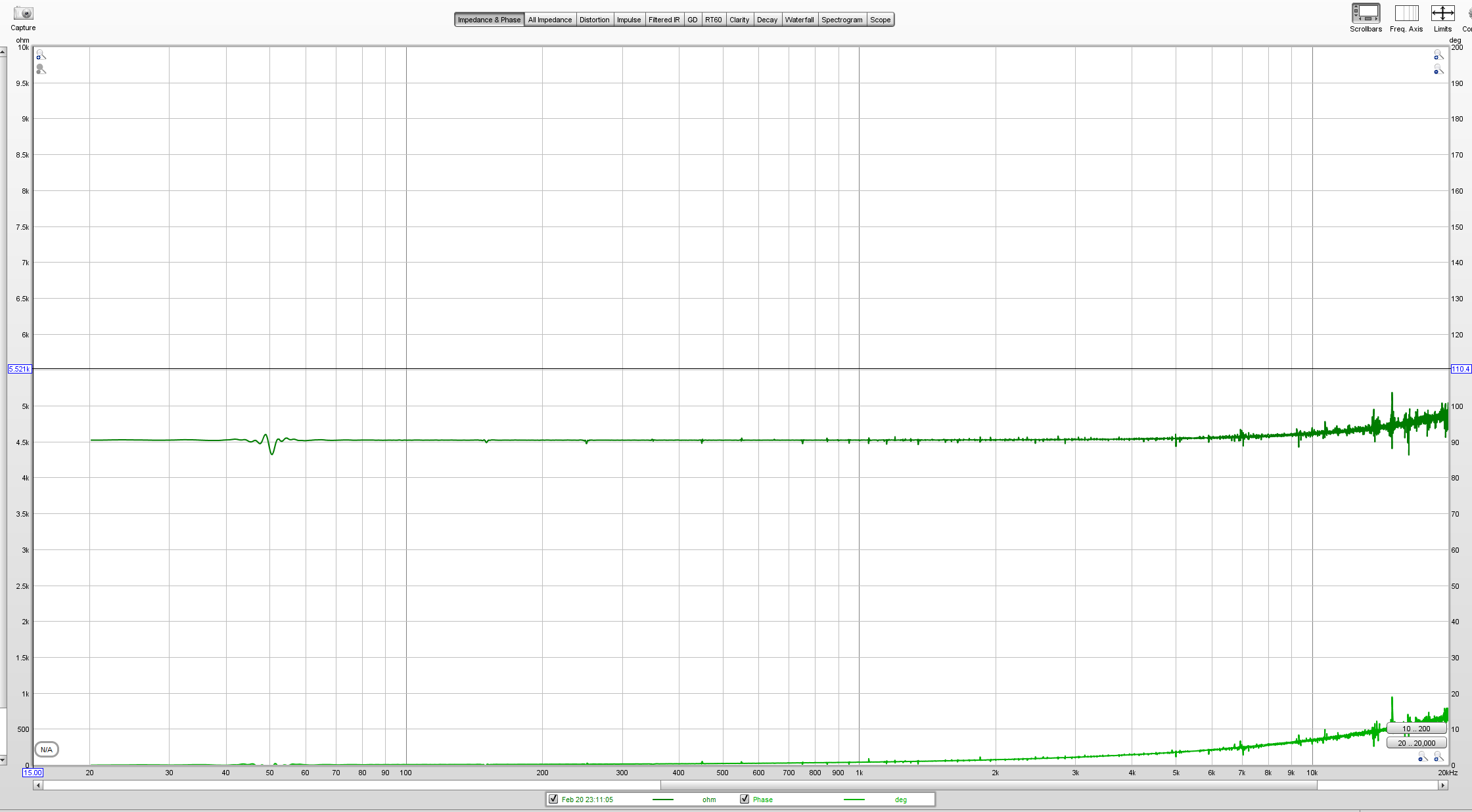

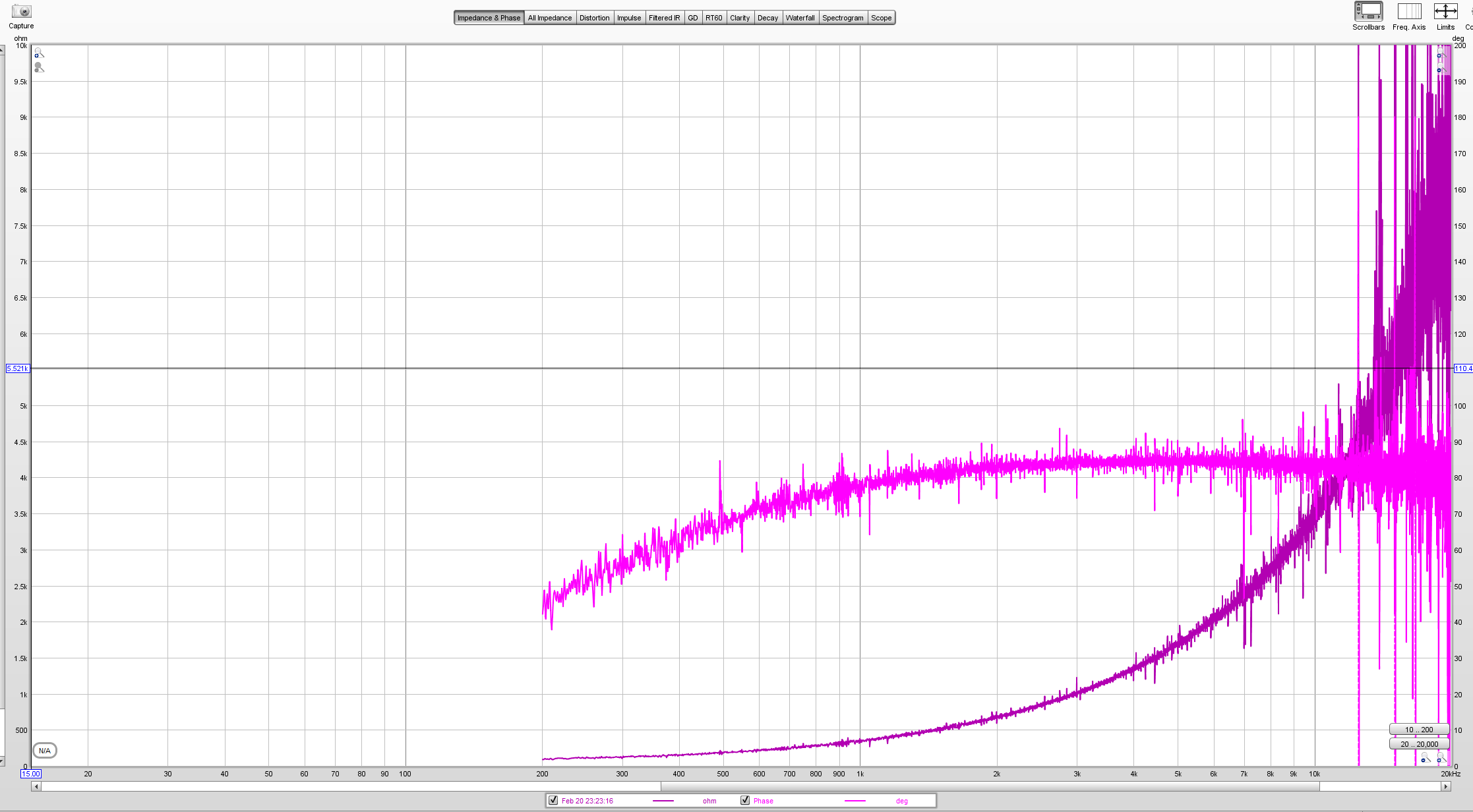

Thank you David,G1042
47k sense
2M sweep
8 sweeps
impedance scaled x 1/10
-80dBU
You mention -80dBu for this recording with 47K, meaning that you have now 14.9uV on the Cart.
And although the image is still noisy, it looks already better in the upper freq region than your previous recording with 5k1.
But to make the 47K and the 5k1 recordings 1:1 comparable, you should now apply -67dBu instead of -80dBu.
Hans

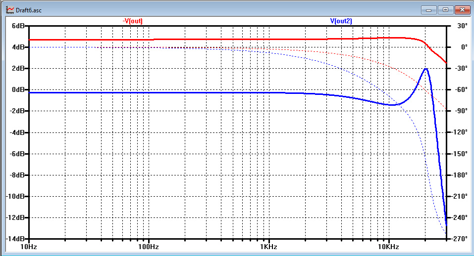

The mechanical resonance that Bill mentioned in Cartridge dynamic behaviour, seems to possibly explain the dip in the FR at ca 10kHz and the peak at 20kHz (van Maanen & van Raalte).IIRC Martin Colloms used ultra miniature accelerometers and measured tone arm resonances well down into the audio range. I have a Kistler miniature one, never tried it because I thought its presence would disturb things enough that it would only be a curiosity.
But because of the large lift of over 10dB to compensate for the mechanical resonance with an inverse resonance filter (for this specific Stanton Cart), this option was rejected.
Why is that, what's wrong with this approach, to be used in combination with using a lower value for the termination resistor at 75usec or even lower like a virtual gnd Aurak sort of input ?
Or is it simply too complex, what I can very well understand.
In the image below, I have simulated a cart with mechanical resonance in blue, terminated with 47K//200pF and the version terminated with virtual gnd and anti resonance filter in red.
Notice apart from the flattened FR, also the much better phase response.

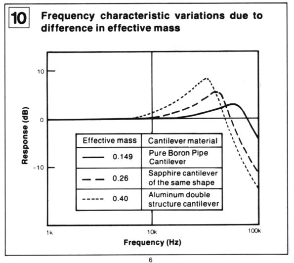

Attached is a graph from either Denon or panasonic (can't recall) where they suggest resonant peak from a standard al tube and average stylus to be well above 20kHz (hard to tell without putting a log graph scale over the top).
Hans

-80dBuV means 70 uVrms at the sense resistor, so varying voltage across the cartridge with frequency, just 1uV at low frequencies, rising to almost 70uV at 20 kHzYou mention -80dBu for this recording with 47K, meaning that you have now 14.9uV on the Cart.
I have just upgraded to REW 5.20 beta6 and now using the 64 bit version with external 64 bit JRE. This allows more memory, so I was able to go for slower sweeps and average 8 sweeps to improve SNR.
I really need shielding and a quieter soundcard.
The opamp is noisy too, TLV2372 is a poor 39 nV/√Hz

I was referring to 3Khz, the selected frequency for doing the measurements.-80dBuV means 70 uVrms at the sense resistor, so varying voltage across the cartridge with frequency, just 1uV at low frequencies, rising to almost 70uV at 20 kHz
Here you settled a new low record with only 15uV on the cart instead of the previous 66uV, a difference of 13dB and because of that noise-wise incomparable
A slight addition, 0dBu is the voltage to produce 1mW into 600 Ohm, representing a voltage of sqrt(0.6)=0.775 Volt.
In case you have the TLV2372 in a SOT23 package, you could replace it with a SM72501, also RRIO Cmos, with only 10nV/rthz.
Succes with upgrading your gear,
