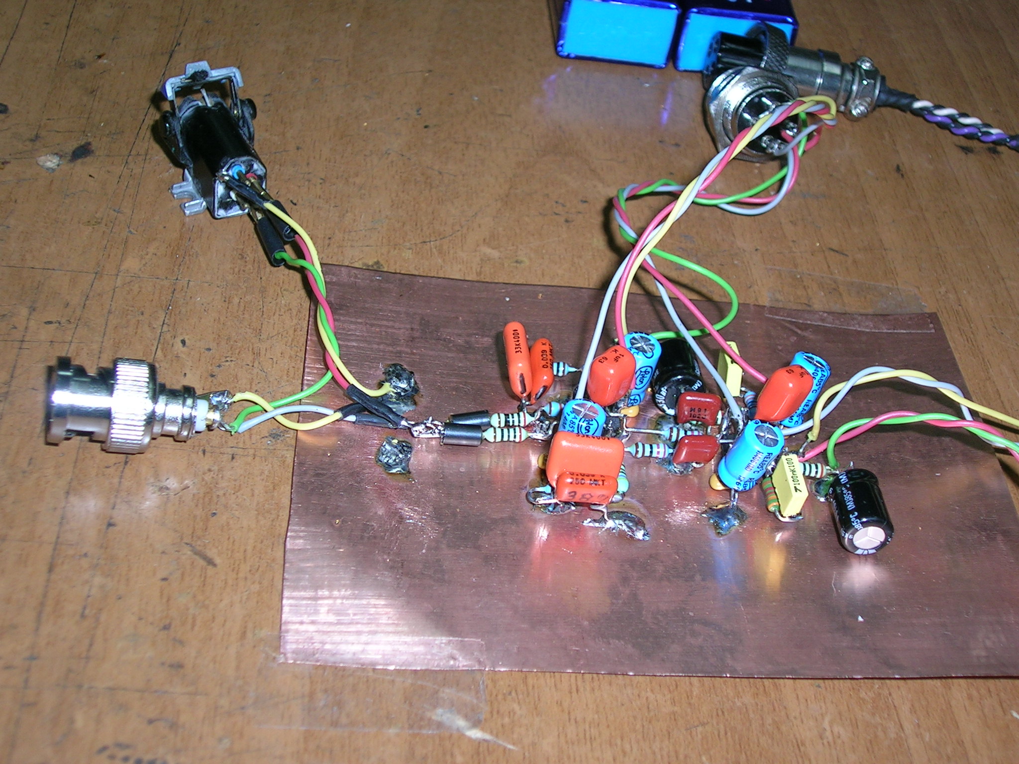

Yes the SE Aurak is by far the most straightforward. One note is that GBW of the first stage opamp matters - at least 13MHz IIRC, and so needs the usual care with layout and hf comp to see it stable. But nothing exotic or to worry about. I didn't do a PCB, mine is on vero so it can't be that tricky.
I also did a pentode version using EF184s which is cute if a tad noisy when not playing back, of course.

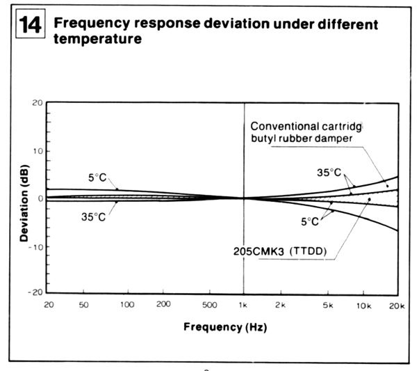

If I could repeat the frequency sweeps in the garage with all the equipment stabilized at 40F or so would that help separate mechanical from electrical effects? My personal experience is that anything that depends on the properties of rubber or elastomers changes with temperature more dramatically than any electrical parameters.
It's a good thought. Polymers and elastomers one might predict would show parametric changes over a few 10s of deg C, whereas metals such as cantilvers wouldn't.
If the resonance were spring-mass involving vinyl polymer one might expect variation, whereas if cantilever beam resonance not.

Attached graph from the Technics EPC205C Mk3 user manual

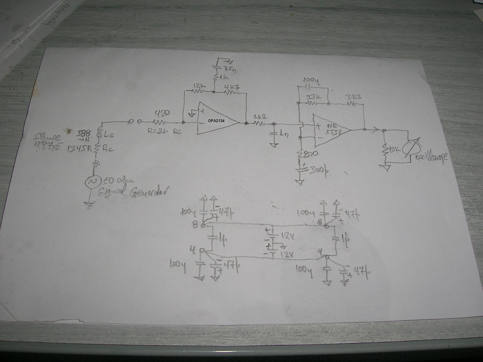

LD,
You probably mean the GBW of the second amp. The first one has its 0dB gain crossing already at 20kHz, but the second Amp goes on from there with 25dB gain until 700Khz when using a GBW of 13MHz.
A bit less GBW wouldn't hurt, but this second amp should definitely be faster as the first one.
Raising the gain of the first stage a bit, giving also a benefit in noise contribution and lowering the gain of the second stage accordingly would result in a more balanced GBW distribution between both amps IMO.
Hans

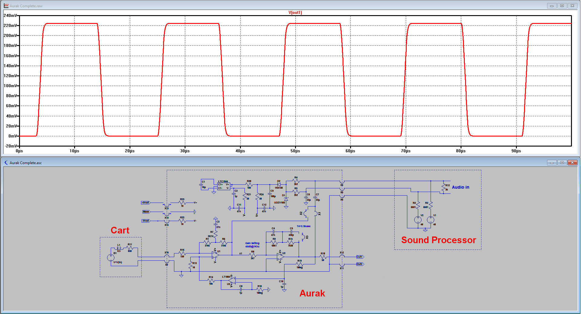

I worked out an idea for a universal Aurak, maybe this could be used for making a PCB.
This version can be used in combination with a sound processor, in that case also receiving it's power through the phantom XLR connection.
But it can also be used independently, in that case either needing +/- 9V from batteries or from a mains supply.
Because phantom only produces a positive supply, the negative supply is made on board with a simple low cost switched capacitor converter, operating at 50kHz, far away from audio, but still not producing the EMI interference from a buck converter.
And because of this converter, it is also possible to feed the circuit with a single positive supply. All options are open.
Aurak is composed by two stages. The first stage shifts the pole from cart plus resistor from 500usec to 75sec, being already T3 of the Riaa curve.
The second stage takes care of T1 and T2 resp, 3180usec and 318usec.
There is also a T4 at 3.18usec, that was inserted between the two stages with 2k2/1n5.
To improve SNR I have increased gain of the first stage by 20dB and transferred the 3.18usec filter to the second stage.
A strap can switch this option on and off.
Because the original Rf in the second stage (200 Ohm) is part of T2 and T3, I have rearranged the inputs, now with Rf as a direct input from the first stage.
The benefit is that this resistor in no longer part of T1 and T2 and can be changed when a different overall gain is needed, without having to recalculate the filter component.
Overall gain is set at 45dB@1Khz, a value that will do in most cases.
Speaking of SNR, now being 600nV from 20Hz to 20Khz, or the equivalent of 4,25nV/rtHz or a SNR of 78.4dBA with the cart connected.
Op amps used are the OPA1642, very fast low noise Fet duals that only consume ca. 2mA/amp low enough to be powered by the Phantom line.
Distortion is in the ppm range, and the reproduction of a square wave, from an anti riaa network is shown below, not too bad I think !
To keep the design as much DC coupled as possible, a servo was used keeping offset in the mV range.
When using a sound processor, it will be possible to choose between the output from the first stage and do the remaining time constants digitally, or take the second stage without the need of further processing.
Hope you like it, comments welcome.
Hans

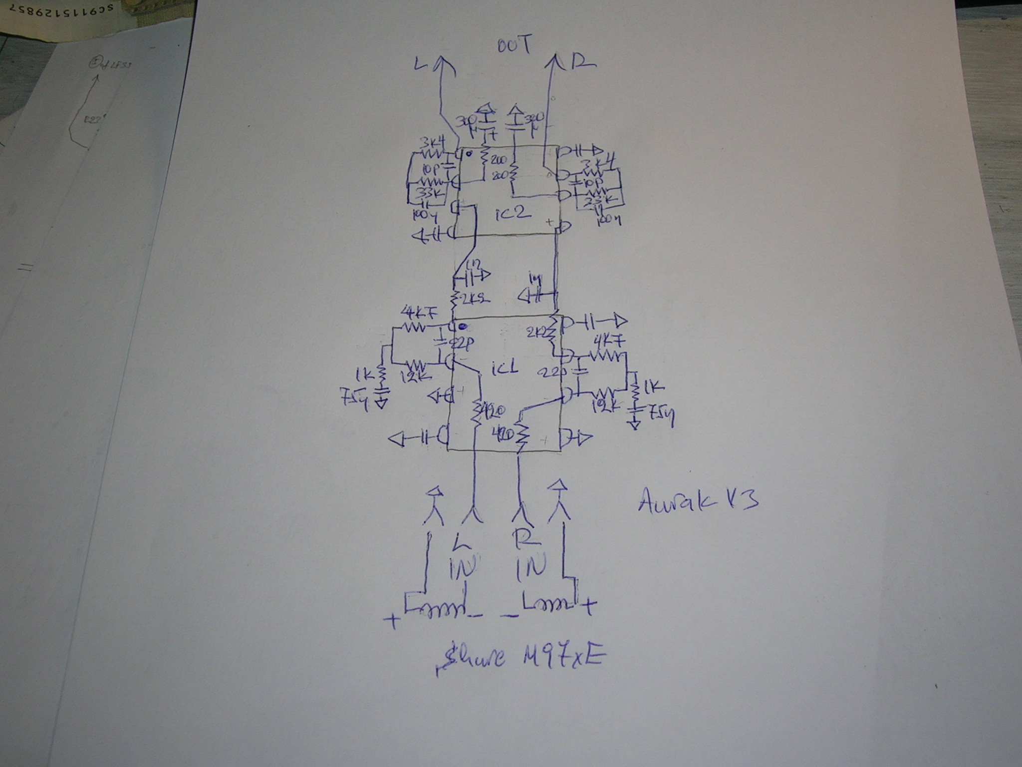

George,
This may have been a version where you needed a different math than R=2*Lc-Rc, could that be the case ?
In that case everthing gets different.
Hans
Yes It’s for the Shure M97xE and it’s R=3*L-Rc see second and third link I posted.
