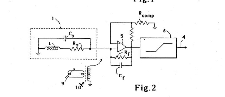

2. Is there any benefit in looking at the Meitner approach from his patent. I'm trying to find a cartridge that won't work with this but so far they all appear to be ok. Having a 50hz pole may not have any real advantage but feels right.
Magnetic pickup preamplifier

Point is however that I have no clue how accurate the Cart spec’s are, within 1%, within 10% or what. In a 47k/200pF situation this is a non issue, but the Aurak is extremely sensitive to little variations leading to relativy large deviations in the FR.
Meittner came with an interesting solution, also based on a transimpedance, but its overload margin is smaller, noise is worse and stability might become an issue with the positive feedback, so I see no benefits over the Aurak.
As presented the voltage noise of Rcomp and the current noise of Rf are always there so the SNR is always degraded at the expense of frequency response.
Hans: shame on the Meitner as it had things going for it. Ah well

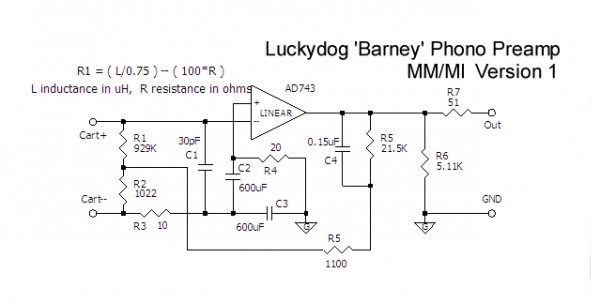

From your post, the part that needs correction is "One of the tools used for investigation has been the so called Aurak preamp that LD or Luckythedog brought forward. This a phono amp that goes one step further as replacing the 47k termination resistor by a much lower value of ca 10k creating a 75usec pole." In Aurak there is no ca. 10k series resistor creating the 75us pole - that topology is the Barney Oliver et al, definitely not Aurak.
I published a sketch once for an op-amp version of the Barney Oliver preamp, but never built it. It was called "The Barney".
LD

A picture is worth a thousand words. Let me dig out a couple of diagrams from the Bob Cordell Vinyltrak article that Jan kindly allowed me to share. I did start trying to write an article on general adventures in cartridge loading, but every time I thought I had it clear another piece of data came along that made me question everything.
This is what Bill had unearthed and posted in this forum(attachment). I have not saved the original post, I can not find it now, sorryI published a sketch once for an op-amp version of the Barney Oliver preamp, but never built it. It was called "The Barney".
