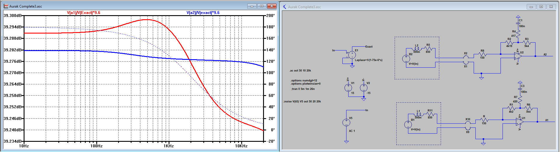

You had two points: A) 4k2 being more exact and B) a change in overall gain when giving the two resistors that were calculated in parallel different values.
A) because your of comment that 4K2 is exact and 4K19 is slightly off, I have made a sim containing 3 parallel versions.
1) the exact version with a Laplace function having a 75usec pole,
2) The version with 180nF/420/5K4/4k2
3) The version calculated by me with 180nF/417/5k4/4k19
In the image below you can see the deviation from the exact curve for version 2) and 3).
Deviation for 2) is within 0.06dB and 3) within 0.01dB.
So both are excellent and more than good enough, but your comment does not feel as quite correct.
B) About the change in gain when dividing into different values is correct, but this lies within 0.1dB, completely insignificant to my opinion for a phono preamp.
But I will add this remark as an erratum to my original posting .
So it would be helpful if you could remove your posting in the addendum, to prevent people from getting confused from what's right and what's wrong.
Hans

Hence my comment "close but not quite". As it's intended as a reference, might as well get it right I figure.
From your post, the part that needs correction is "One of the tools used for investigation has been the so called Aurak preamp that LD or Luckythedog brought forward. This a phono amp that goes one step further as replacing the 47k termination resistor by a much lower value of ca 10k creating a 75usec pole." In Aurak there is no ca. 10k series resistor creating the 75us pole - that topology is the Barney Oliver et al, definitely not Aurak.

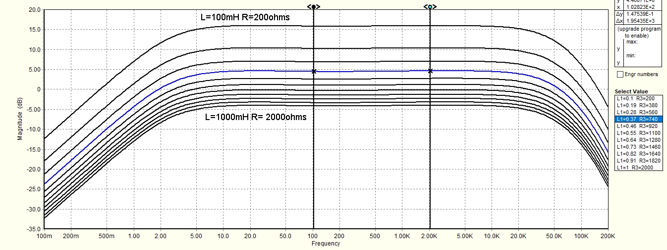

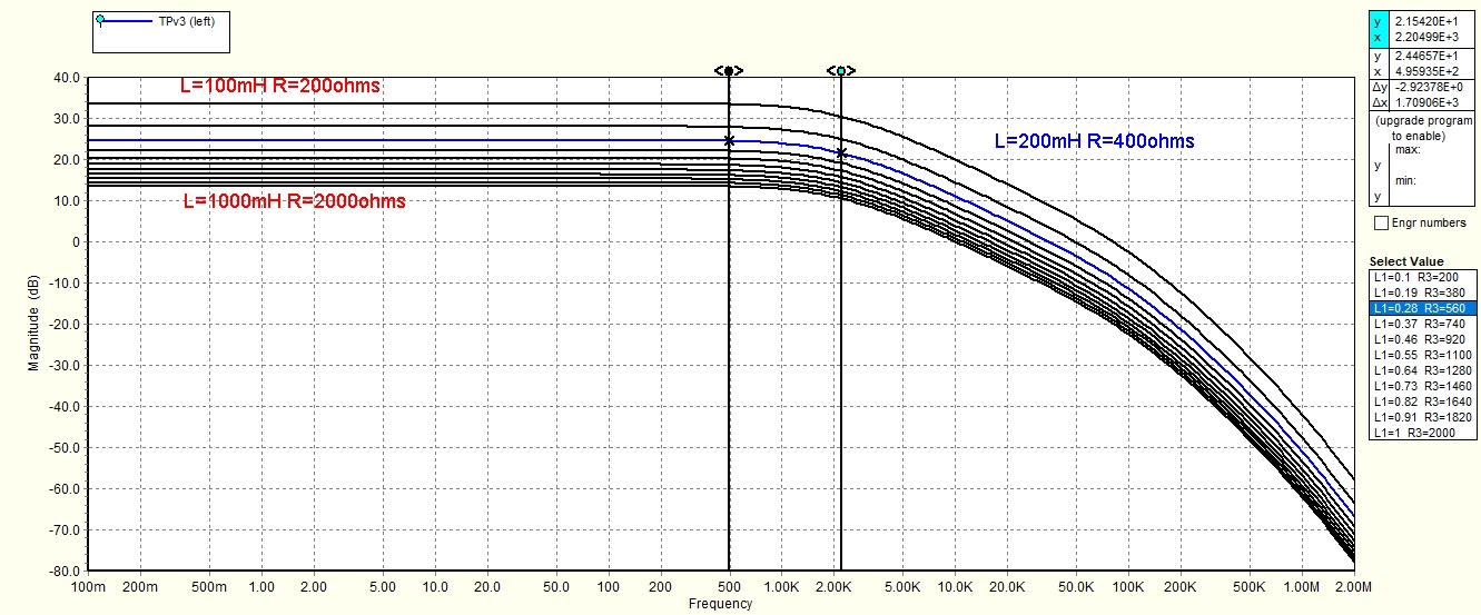

There's a trick: cartridge R can be arranged so that effect upon the natural LR time constant is compensated by tracking effect on the correcting shelving filter. See attached sims for L=100mH to L=1000mH and corresponding R=2L for both (a) the 1st stage only forming the 75uS time constant, and (b) the whole preamp. In this way, errors are very small over a wide range, such as a decade, of cartridge L. Given standard E values are used, it is remarkable really.I think LD's procedure was based around making a universal first stage that would fit most cartridges with only a small R to pad the internal series R. that way one shelving circuit gets close for all. The pole/zero mismatch of the simplified approach is a very small blip....
It's not a 'one size fits all' circuit, it accommodates cartridge L to null the natural pole. That's the spanky bit 😉
LD
Just for a reference point from a man with some odd cartridges on 3L-R calculations. My lowest added resistance is 27Ohms and my highest is 1290Ohms. It serves me right.
Of course the shape of the curves don't change because Tc the time constant from Cart plus added R stays at 500usec for all shown combinations.There's a trick: cartridge R can be arranged so that effect upon the natural LR time constant is compensated by tracking effect on the correcting shelving filter. See attached sims for L=100mH to L=1000mH and corresponding R=2L for both (a) the 1st stage only forming the 75uS time constant, and (b) the whole preamp. In this way, errors are very small over a wide range, such as a decade, of cartridge L. Given standard E values are used, it is remarkable really.
LD
But I wouldn't be happy when changing a 100mH for a 1000mH Cart, overall gain would drop by 20dB, apart from the SNR that will also drop quite a bit. 😀

I was referring to LD's image with coils from 0.1H to 1H where it could be seen in his posting that gain was dropping by 20dB when going from small to large inductance..
