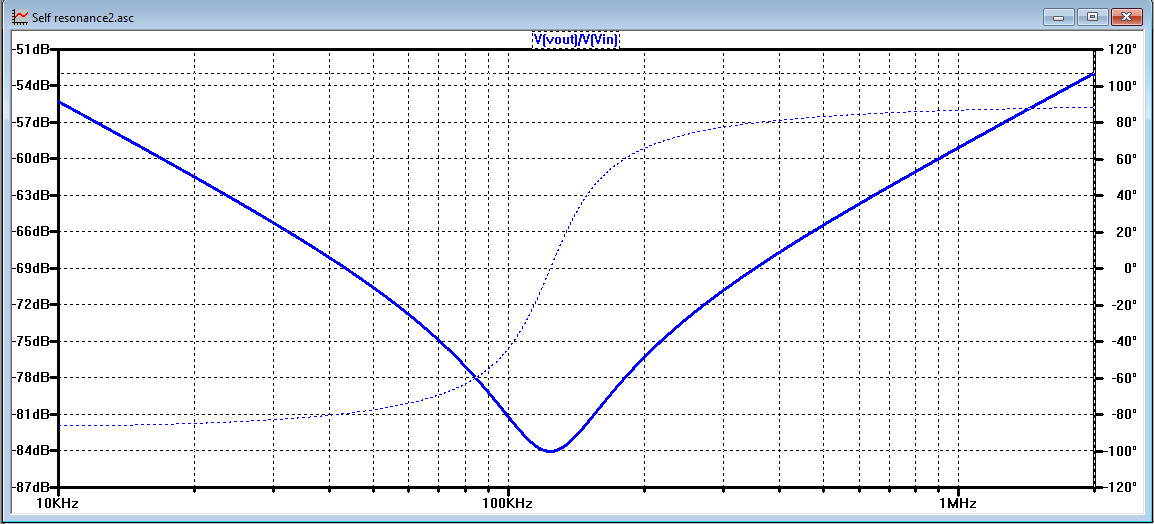

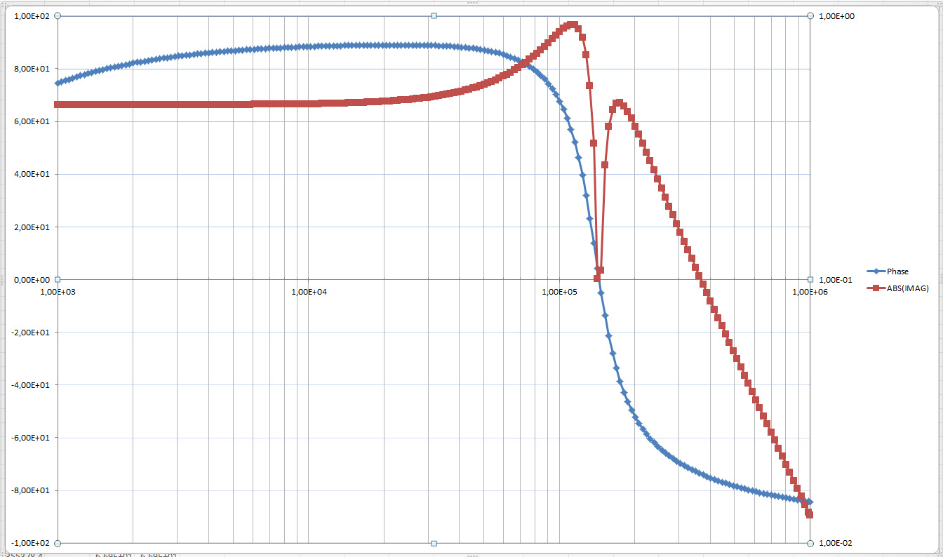

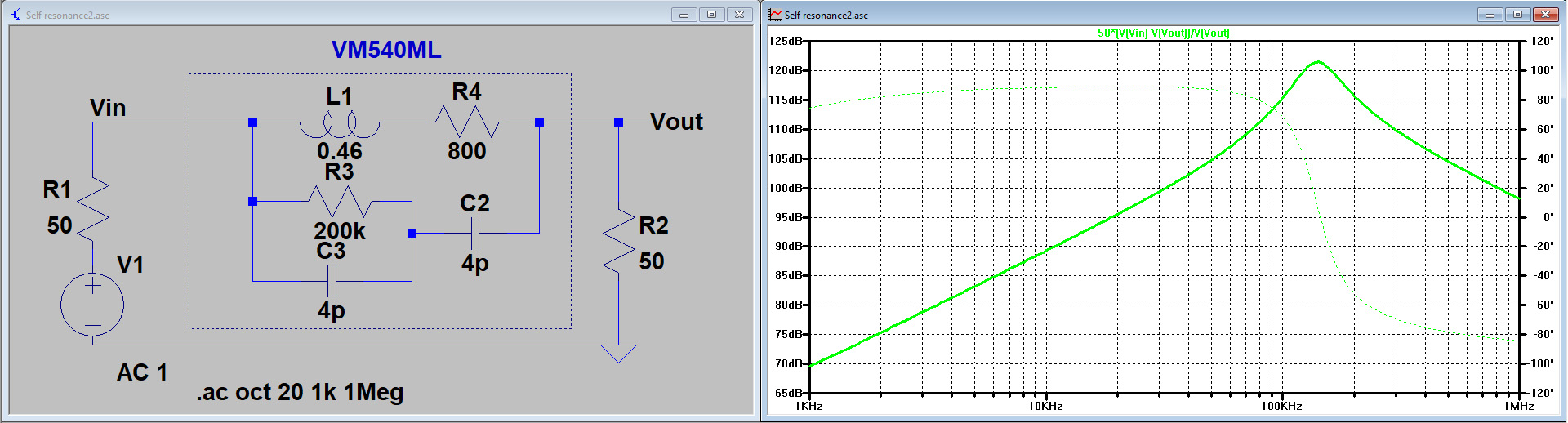

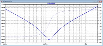

At last I've managed to reproducing Jackinnj's image.
First step was to reduce the Q significantly, while still keeping the phase going from +90 to -90degrees.
This was possible by splitting the Cap in two pieces and by adding a damping resistor.
See the LTspice model below and the sim |Z|=50*(Vin-Vout)/Vout.
From this I extracted Re and Im.
Treating the Imaginary values as being produced by a coil, I divided its absolute values by 2*Pi.
And voila, there it is, at the end quite a simple minimum phase model with just one SFR (self resonating frequency).
Hans

Well done, Hans. Although the system is minimum phase, phase plot and |Imag| don't match because that's not the system.
At small levels the challenge is to extract accurate phase info in this method. Also to know with confidence that |Imag| at 10kHz is inductive, which in this system it probably is.
Another method that might be easier at small signals is to examine |Real| at 10kHz. Thesis is that a loss mechanism would be involved in any apparent L reduction, which would show up in |Real|.
A philosophical thought: for a given flux change, does generator output follow |Imag|? I think it does.
LD
Probably my latest model comes closer to the system.
That's how it seems to be.
Could it be that you mean |Z| instead of |Real|?
Zcart=Rload*(Vin-Vout)/(Vout).
Up to 30Khz L calculated from |Z| by dividing it by 2Pi*Freq gives almost the same outcome as when calculated from the true Imaginary.
At 10Khz they are within 1% in my model.
So do I, but at 10Khz also |Z|.
Hans

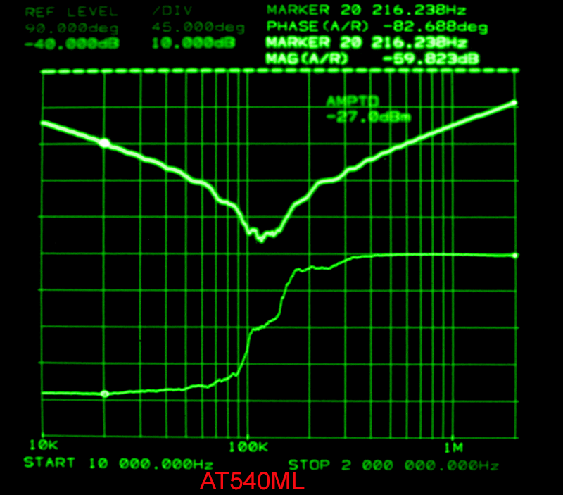

That was my original point, the network analyzer is measuring transmission loss the rest is maths. If you look at that, due to the loss because of the impedance levels, the signal at channel A is VERY small. At a ref level of -40dBm the signal level at A gets below -80dBm and the instrument specs don't support an accurate phase measurement at that level. The de-Qing in making the model fit probably lumps all loss mechanisms such as eddy current. If a proper sensitivity analysis was done using the specs of the instrument I would suspect that the extracted values have fairly wide error bars.
BTW your notation is confusing, |Imag|, is redundant unless mag is magnetic? In either case the magnitude alone is neither inductive nor capacitive you need the phase (imaginary part).

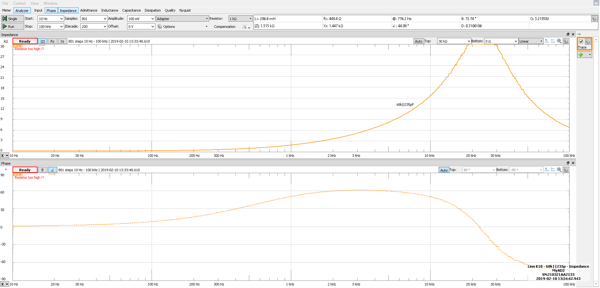

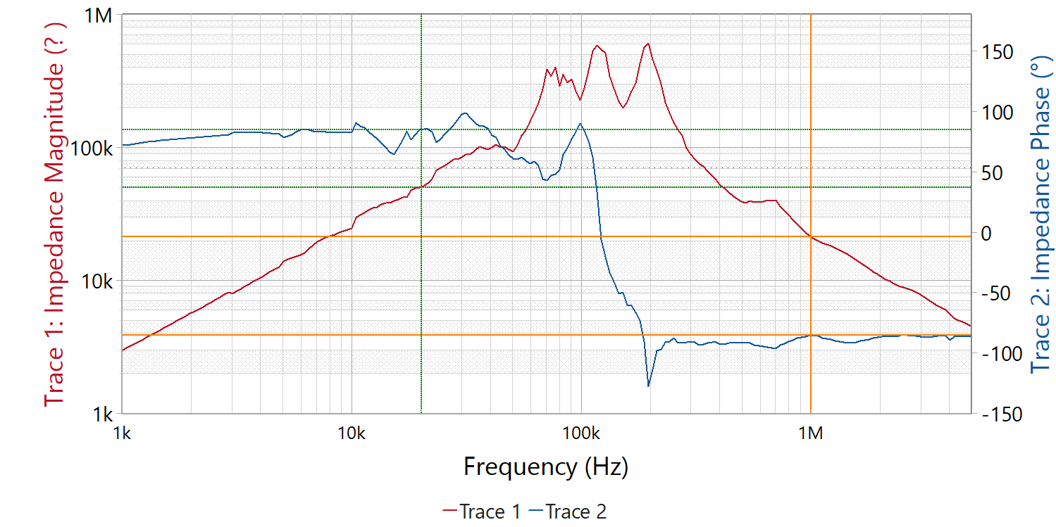

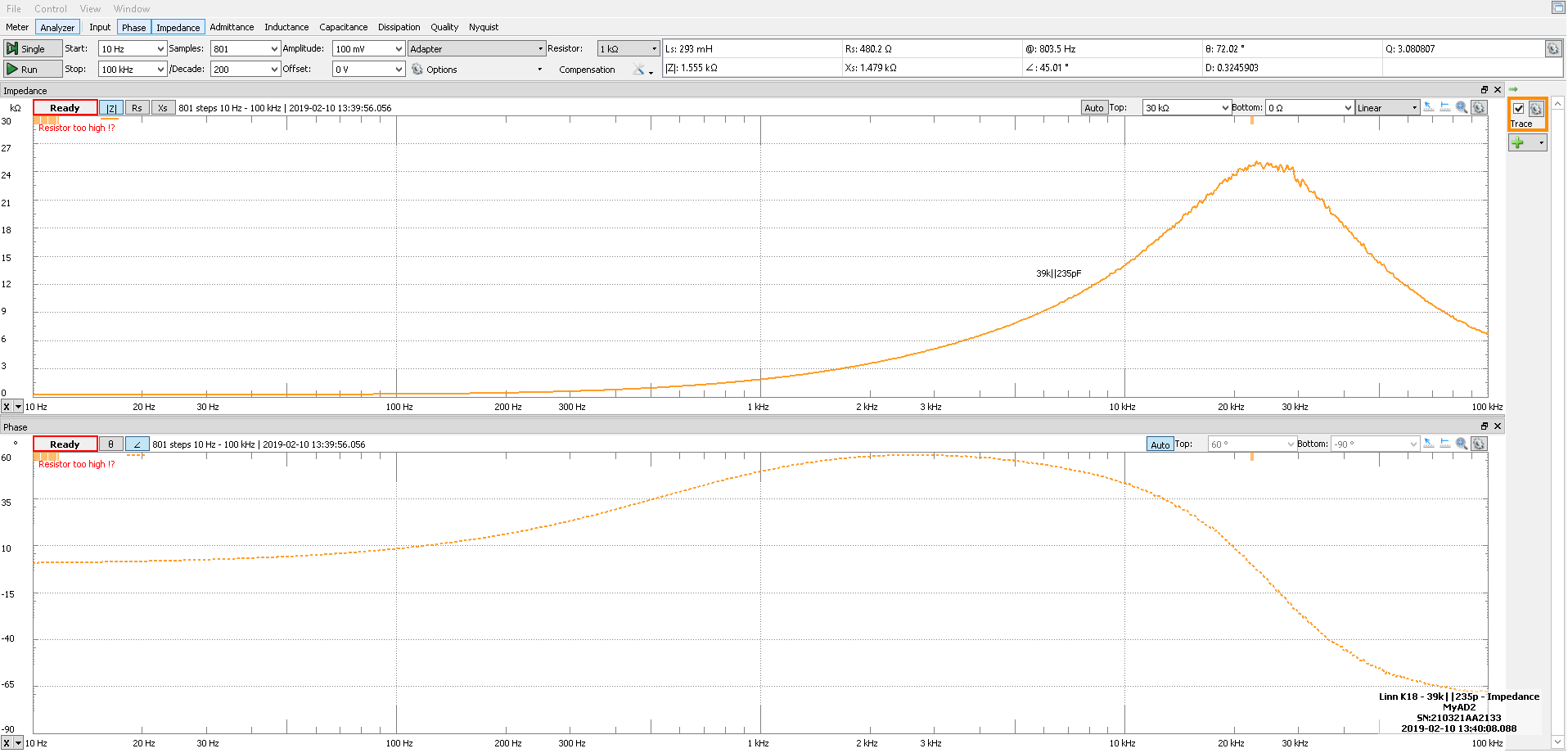

Is this helpful? Screenshot from HP3577, not Bode 100 -- -27dBm with 1Hz bandwidth, 16 averages and a long settling time, Z in of channels A and R 50R:
Thanks, those are the levels I expected. Since you averaged I assume the lumpy phase at resonance is part of the instrument residual? BTW the Bode 100 supports Python so you have available some powerful (free) model fitting tools.
Also on the Bode 100, left y-axis is magnitude of impedance, right y-axis phase. Anyone who wants can get the raw data (real and imaginary) by sending a PM. (I did a calibration before this run.)

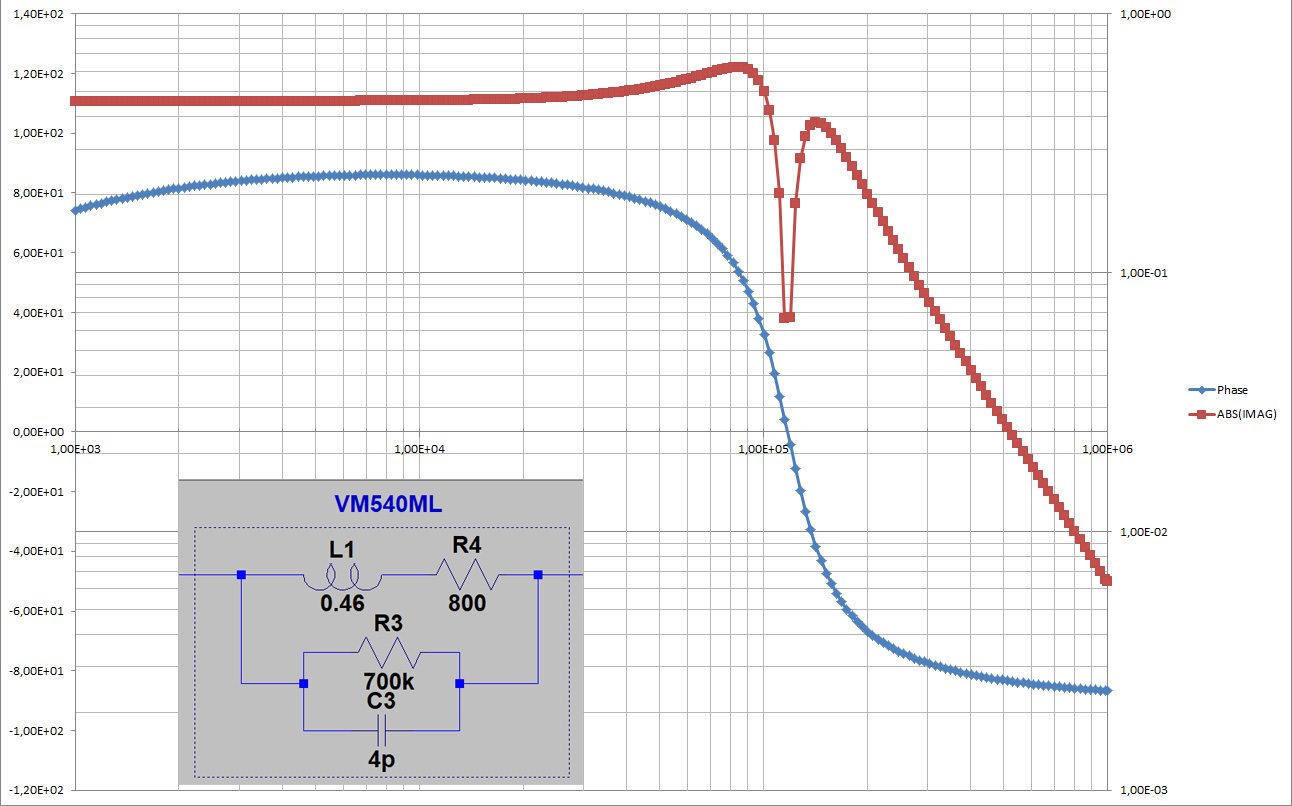

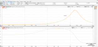

I projected my LTspice smooth images on your wobbly Analyzer A/R plot,thereby perfectly matching your phase and A/R figure and came to almost exactly the same results as before.
460mH+800 Ohm
3.6pF//800 Kohm
Hans

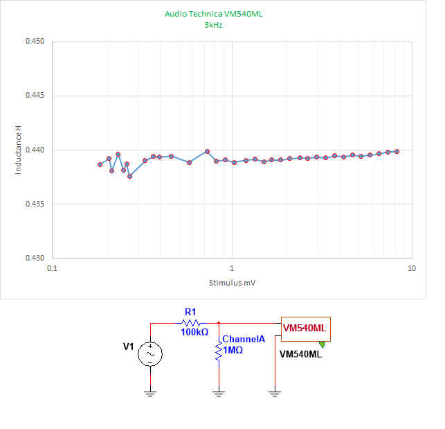

I tried placing a 100k resistor between the source and receiver, lowered the frequency to 3kHz so that the reactance of the parasitic capacitor was much higher and do an amplitude plot, setting the receiver input impedance to 1Meg -- even though the HP3577 is far better than the Bode100 at low signal levels, it's going to require some amplification.
Somewhere I have an HPIB to USB converter, but I'll get a hernia if I try to move the HP3577 -- it weighs as much as a 4th grader.
It's a work in progress, suggestions welcome.
Not sure the instrument copes with 1M on reference input and presumably 50R on the other...……..but this doesn't change the stimulus level across the coil much, it's still much bigger than the plots report.
By this argument, as to my post above, the ref input would need a separate 40dB 50R low noise amp as well. And it would need to be fairly well gain/delay matched to the 40dB amp on the main input.
LD
Jack,
May be I've got it wrong, but this could be the way to follow.
When you replace the 100K resistor by a 5K resistor, and go back to 50 Ohm input instead of 1Meg, you will have 40dB attenuation.
In case the HP producing -40dBM will give 22uV on the cart at 3Khz.
And when I understand your HP3577 correctly, it has -130dBm noise on its inputs when using a 10Hz BW, meaning 70nV noise on both inputs, adding up to 100nV uncorrelated noise.
With respect to the 22uV on the Cart, this 100nV resulting in a 47dB SNR, causing an insignifanct error on the measurement.
