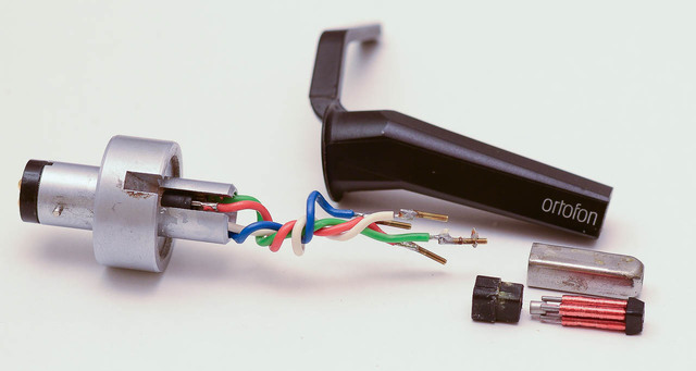

From earlier years through faint memory I remember ARRL handbook saying two to three times the coil diameter was a good distance between coil and ferromagnetic housing.
All Shure, Empire, Goldring, Pickering, Stanton cartridges I’ve seen have a ferromagnetic casing as shielding.
There is a separate metal tag through which that shielding casing is electrically connected to the “negative” side of one of the coils.
On the Stanton MK V I’ve opened, there is a second copper tag that electrically connects the shielding casing with the main magnetic pole structure.

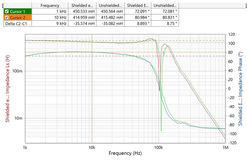

In my earlier measurements on Stanton MK V in this thread, you can see shielding casing does affect the impedance of coil and it’s frequency response (I was measuring the coil that was not connected electrically to the shielding).

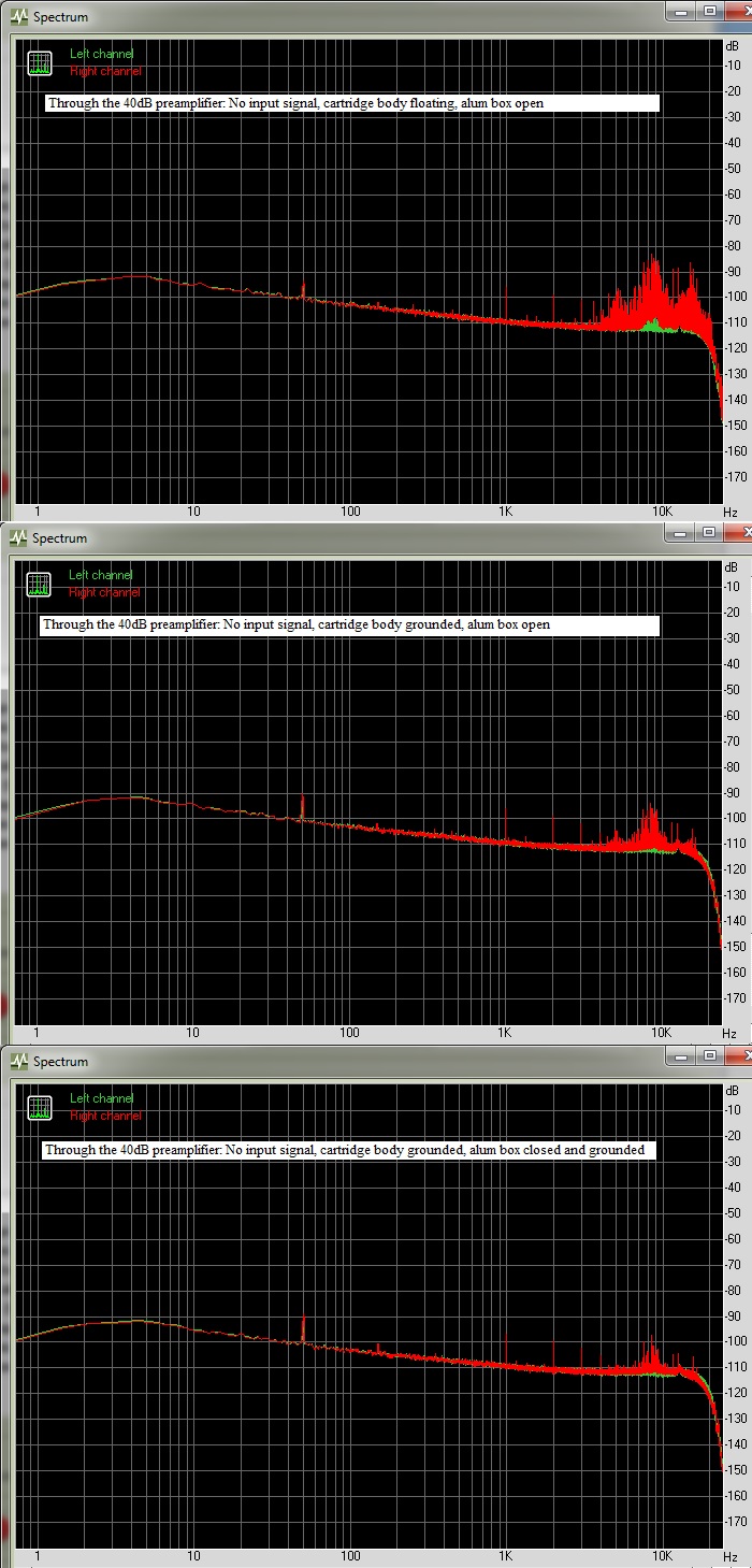

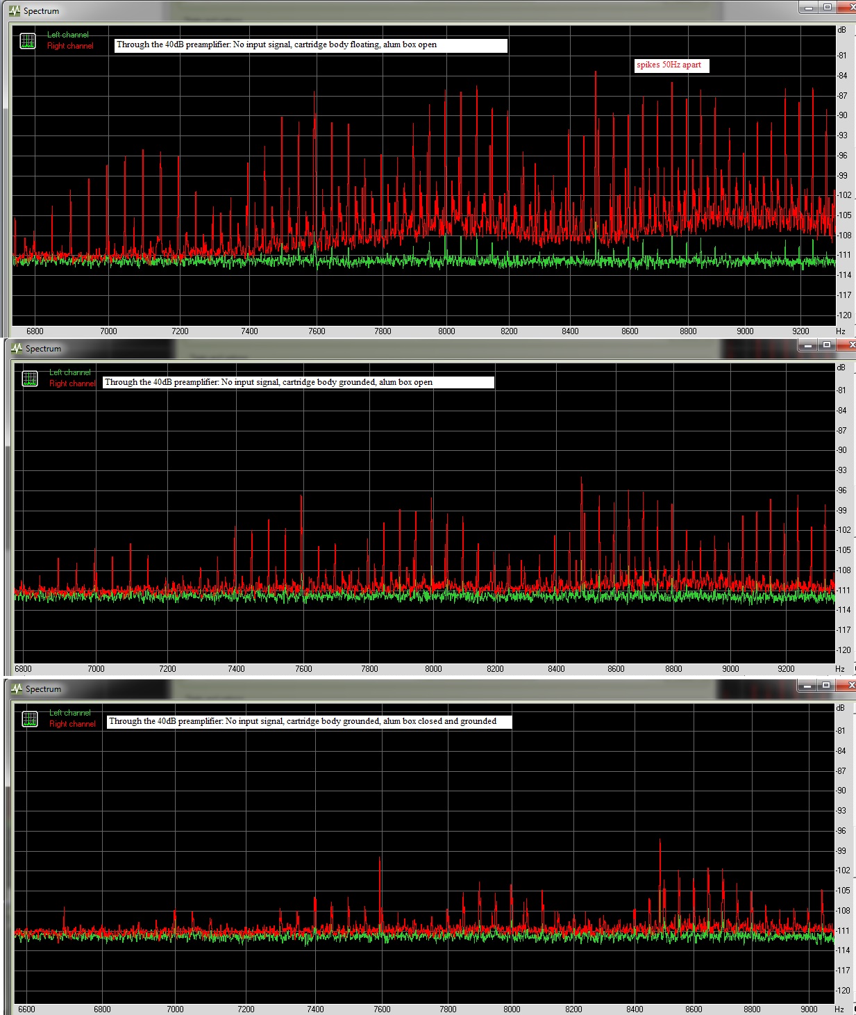

Now, what is to be shielded against?
In my case, see attachments (from preliminary tests, using the Pickering in the aluminum box as in the previous photo-post #330)

Grado are unshielded. Every other MM I have seen has a metal can around the generator. Some have mu metal between left and right coils. How this all changes the properties of the generator I don't know, but do have a sacrificial one so we can compare same generator with and without the can!
I'd assumed there was always a seam a la AT, and it was an electric field shield. But accept what you say, in which case no issue. Besides, the cookie tin being big ought to be far enough away to be loosely coupled, as davidsrb says.
Still doesn't seem too clever unless there's good cause. I thought that in 2 coil-per channel arrangements, coils are generally arranged to be humbucking. I also thought that the Grado arrangement, although 2 coil, isn't humbucking but mutual inductance reduces self inductance of the coils.

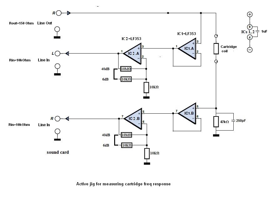

In your rig, one coil end is (relatively) high impedance 47k. So the measured noise could have an electric field cause, and the grounded cart shield should take care of it if the correct end of the coil (with the connection to shield) is connected to the low impedance end of the rig. After all, this is what happens in normal use.
If a shield is grounded, someone somewhere thinks there's an electric field issue to solve.

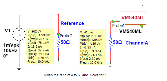

(I still don't understand why there is such difficulty understanding "series-through" impedance measurement".)
I don't think there is any difficulty...……….
In that example, rms difference between probes 1 and 2 is 0.71mV rms, and that is what appears across the coil as the excitation potential.
The 3577A can't put out less than about 0.8mV into 50R, and pretty much that is what appears across the coil as the smallest yer gonna get.

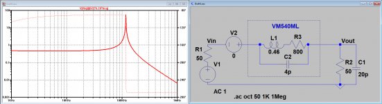

With all respect, what exactly do we see
Well, coil self resonance is certainly clear of the audioband. And there is a notable negative slope to inductance versus frequency. At whatever level this was made at.
That is probably real, IMO.

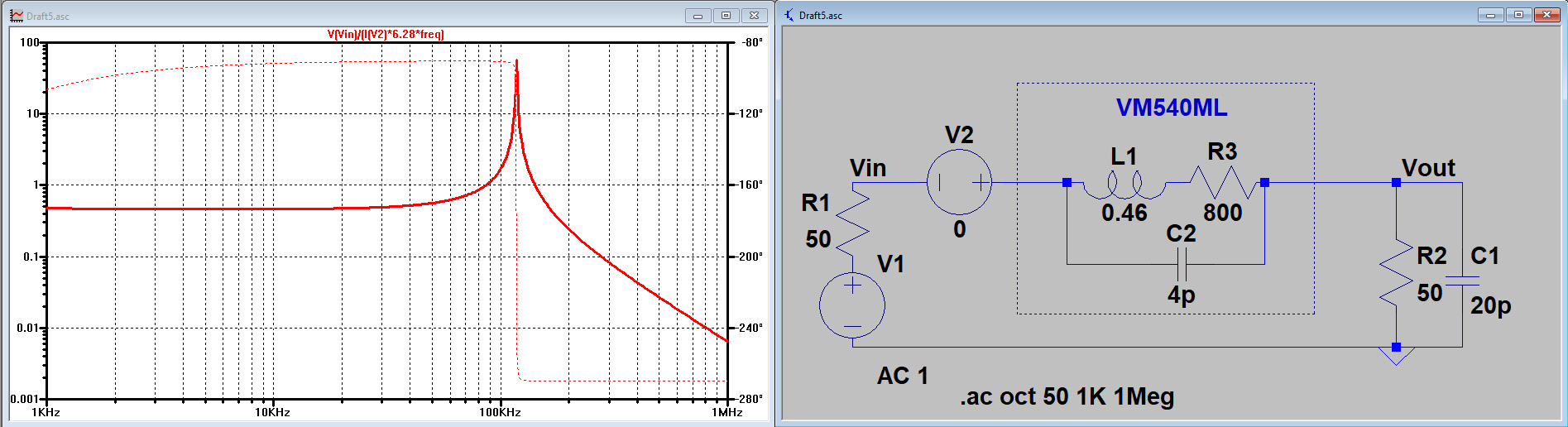

I think the 3577A rig could be made to produce low excitation voltage, simply by shunting the 50R impedance of the reference input with an appropriate resistor. That would form an attenuator OK for 10kHz. If the output is OK with the load, and the input can then fish the signal it needs out of the noise soup.
None at all, except I have a problem with calling it inductance rather than impedance. The Q is pretty high, with the number of points plotted the slope of the phase transition might be a better measure of the Q.
