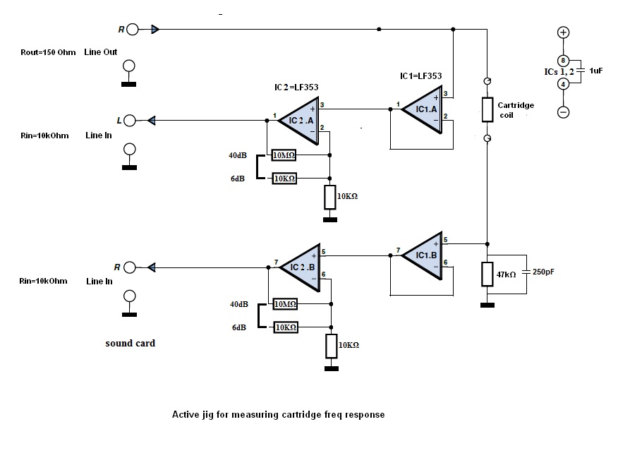

It was external 250pF||47k and the coil from an AT cartridge that I measured. If the inductance vanished at no signal the noise would vanish to the noise of the series resistance at no signal i.e. you would measure no SNR degradation with ultra-low noise bipolar op-amps until you played an LP. Come to think of it you would also observe gross noise modulation effects (I surmise).

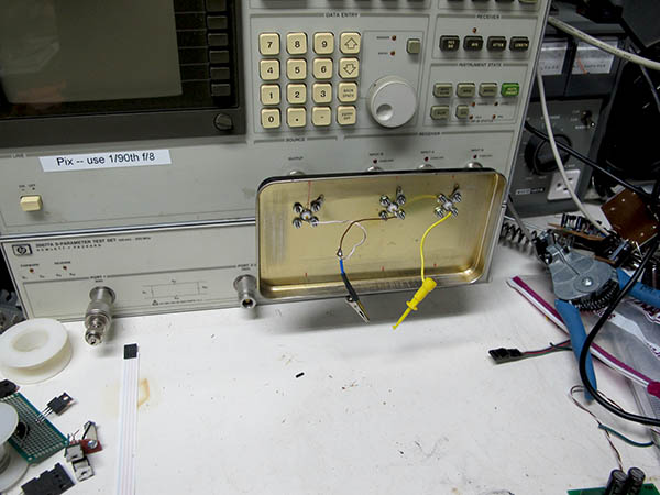

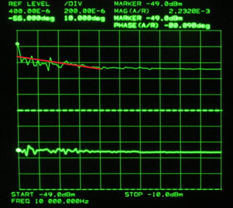

The lowest level of the HP3577a is -49dBm and I don't have a handy attenuator. This was a step-scan from -49dBm to -10dBm, 100 steps, with 1 Hz resolution and a pretty long scan time. The top is Channel A relative, the bottom is phase. Frequency was constant 10kHz.
I should build a little amp which would fit my measurement jig to get the results out of the weeds.

Though I am definitely going through a maths dark patch, isn't -49dBm about 0.8mV into 50R ? How did you get to 30uV without an attenuator?
LD

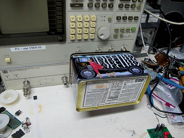

It's a series-through impedance jig, so the hind end is 50R.
The HP3577 is supposed to have a soft-key which performs the complex math, but I think it's only available when the S-parameter test set is engaged, and the low frequency is 100kHz.
The AP refuses to disclose phase below 2mV.
I'm sure I'm getting dumber by the day so please help me out here....
There's a voltage source with 50R output impedance in series with the cart coil that's in series with 50R to gnd. That means that, at 10kHz, the vast majority of the voltage source appears across the coil impedance ? So, for a -49dBm source at 10kHz into 50R tail end, that means about 1.6mV appears across the coil?

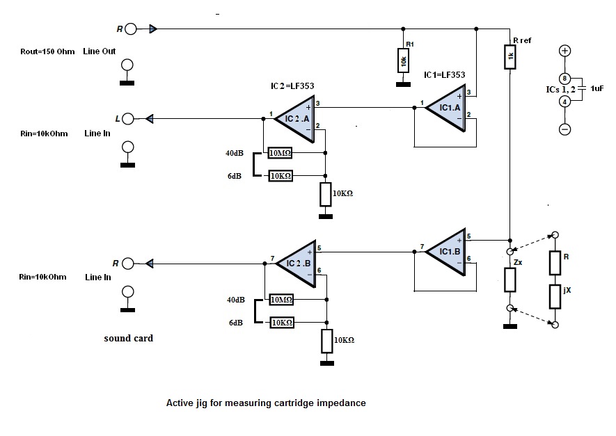

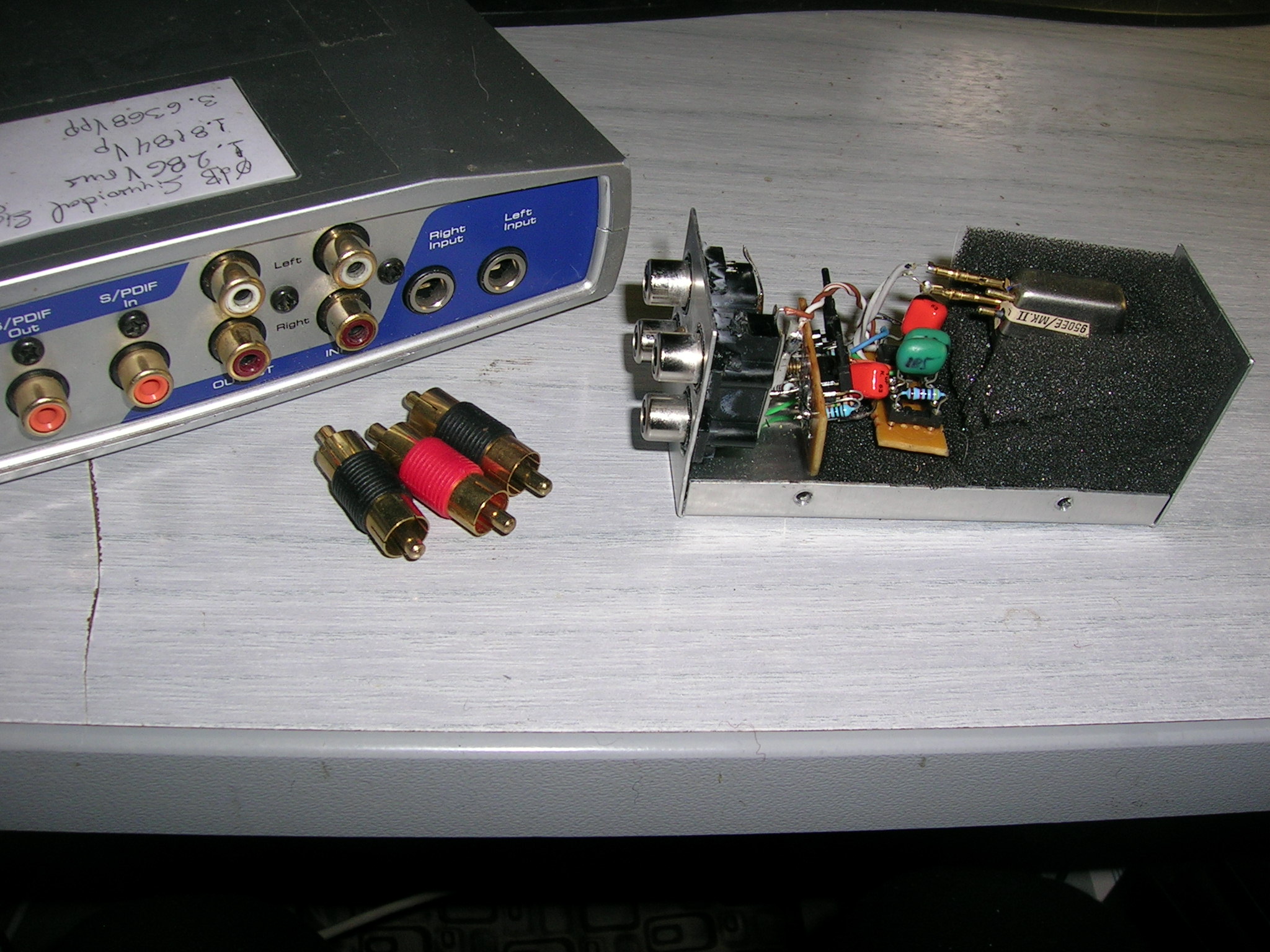

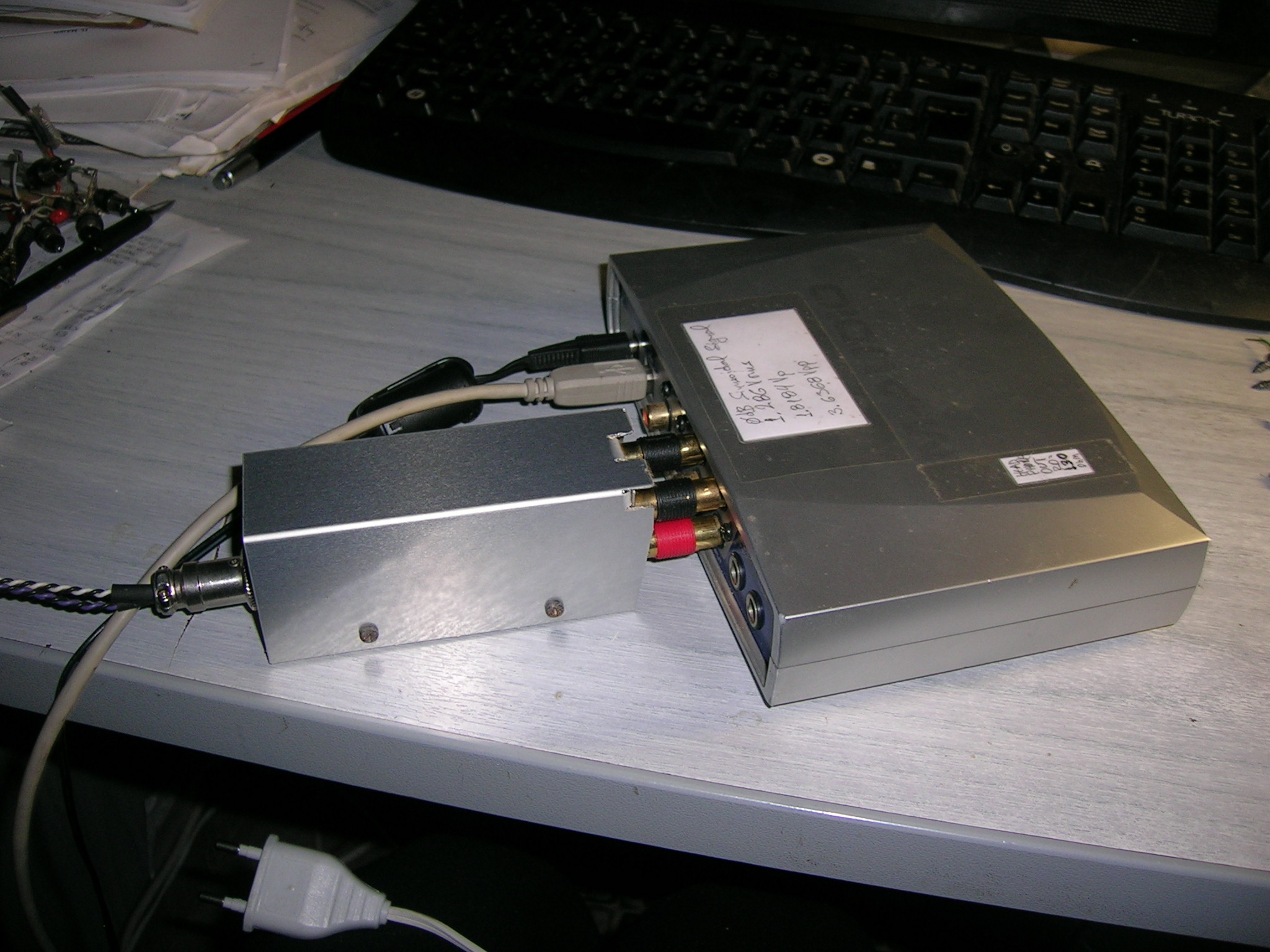

will mount an amplifier with switchable gain of 40 and 60dB,
Me too.
Currently jumper switchable btn 6dB and 40dB. I may do it as 20dB and 40dB.
George
res ipsit loquitor?
Actually, I was just being polite with false humility. More plainly: (a)What you have created in the shield is a shorted turn around the coil; (b) Excitation level applied to the coil is much larger than reported. The smallest level you've applied is 0.8mV not 30uV.
Lacking explanation otherwise, this alters results and interpretation thereof.
