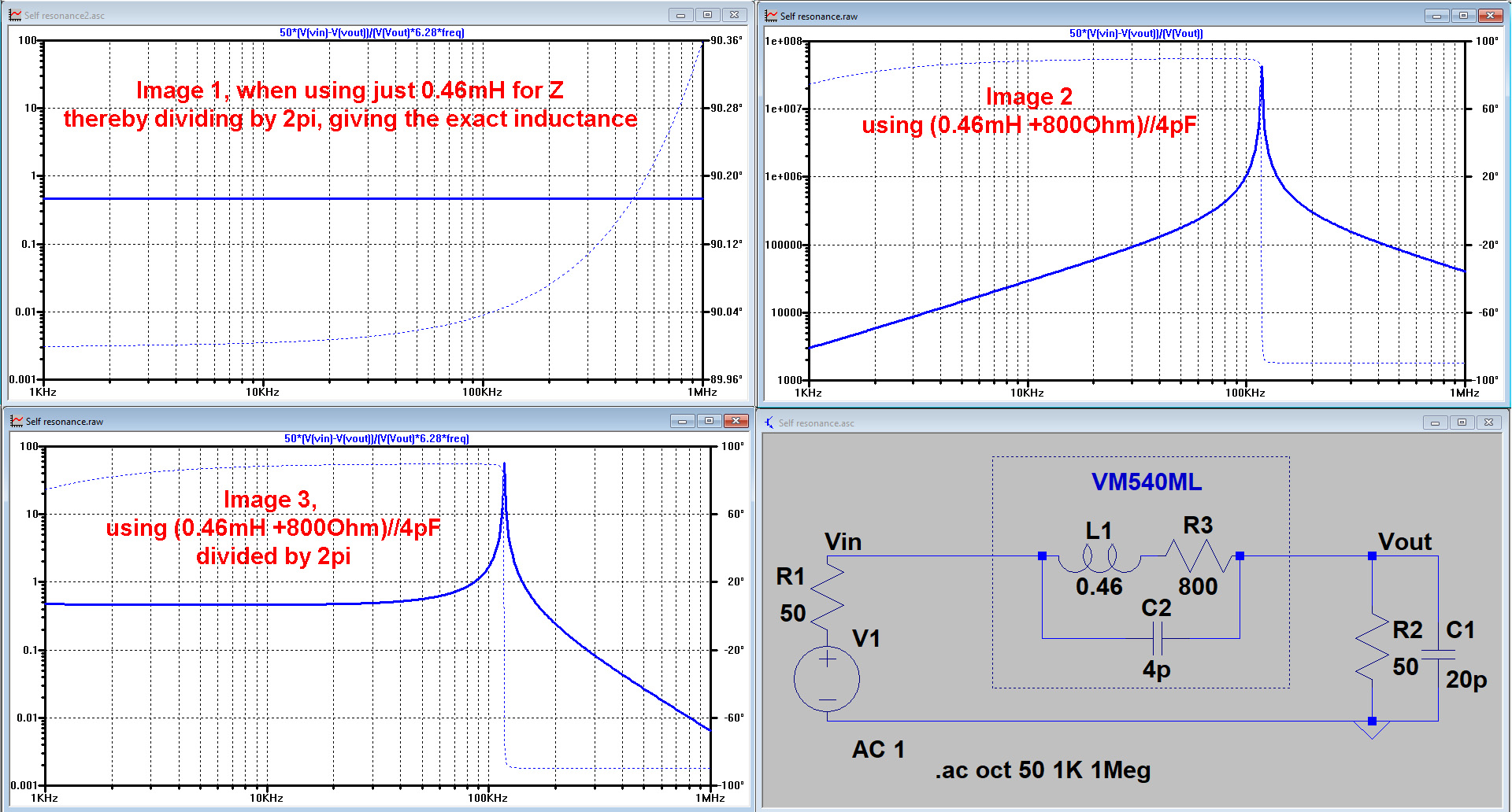

.It's A over R, R being a constant magnitude and zero phase we are left with A. I still don't get it either, an inductor has a 20dB per decade roll off of magnitude of impedance. So what is the math being done to extract the embedded inductance, what is the assumed model of the motor?
When giving the Cart the impedance Z, the following can be determined:
Vout=Vin*Rload/(Rload+Z) giving Z=Rload*(Vin-Vout)/Vout.
In fact Rload is not just a resistance, but the probe capacity has to be added, as I did in my model.
However the effect of this cap is small on the amplitude and only marginal effect on the phase as can be seen in image 1 when using just 460mH for Z.
R10 in your model plays no role when using the above algorithm since only Vin is used.
So we can say Z=50*(Vin-Vout)/Vout giving image 2 below.
In this image the peak is pointing upwards.

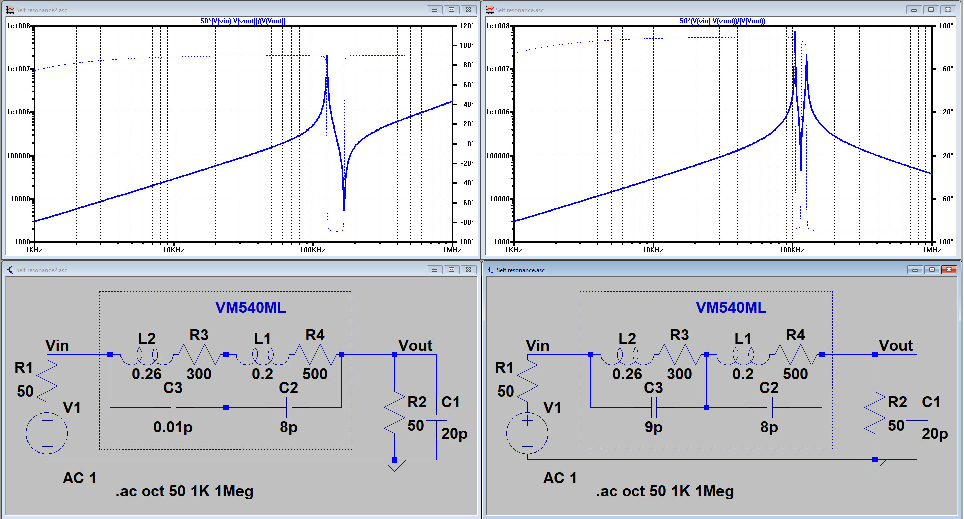

When playing with a split coil with different ratio's of par caps, I get either two peaks pointing upwards or one peak upwards an one downwards, so there is at least always one peak pointing upwards.
Jackinnj's image has only one peak, so we can exclude split poles with different ratios of caps.
Now diving the graph by 2pi as if the cart where a pure coil gives me image 3.
So roughly up to 30Khz, the image is identical to image 1, from thereon the par Cap is taking its part.
So to conclude, in no way can I reconstruct Jackinnj's image with the peak pointing downwards, so the question remains, what is he algorithm that has being used here.
Hans

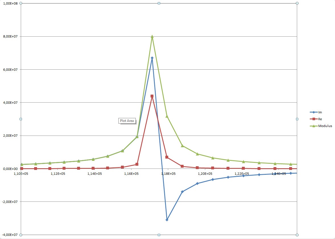

Having magnified the plot around fres, the image below now showing them all: Re, Im and the modulus part.Yes but at Fres impedance is all real. So if looking at imag part only it would dip.
LD
I looked in the above Sim images at the modulus of Z, but in the image below you see all three.
The imaginary does not have a dip but changes from pos to negative.
The image from Jackinnj is still impossible to reproduce.
Hans

Yes, if you have a few more points around the interesting bit, you'll see the real part increasing rapidly as the phase begins to transition. As imag flips it passes through zero, and if you plot |imag| it has a sharp dip.The imaginary does not have a dip but changes from pos to negative.
what is happening is that impedance not only is getting bigger, it is getting more 'real', the vector angle is nearing zero deg and makes it very sharply.
I agree with you, btw. I think this is why the dip in j's plots but it's not useful.

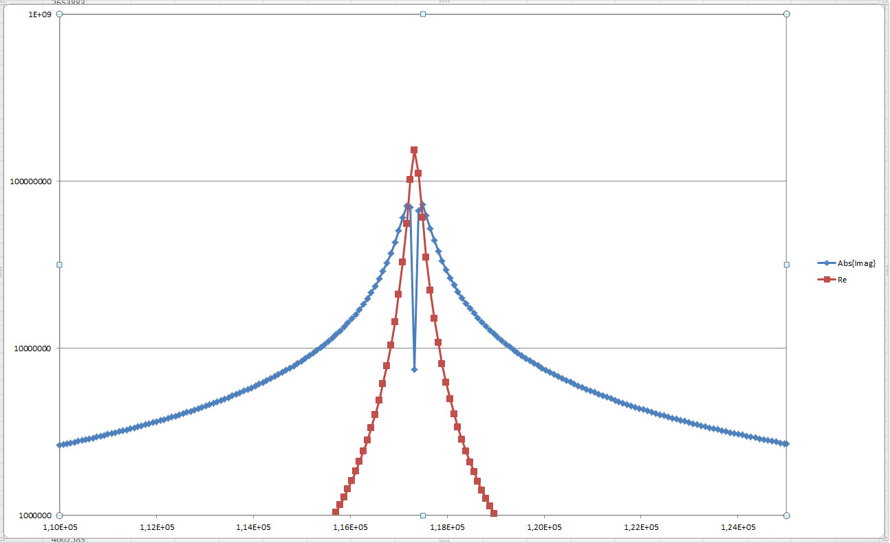

On a much finer grid, 1000 points/oct, I have now plotted the |Imag| and Re around Fres on a log scale.Yes, if you have a few more points around the interesting bit, you'll see the real part increasing rapidly as the phase begins to transition. As imag flips it passes through zero, and if you plot |imag| it has a sharp dip.
LD
Does this give new insights, I think so..
Hans

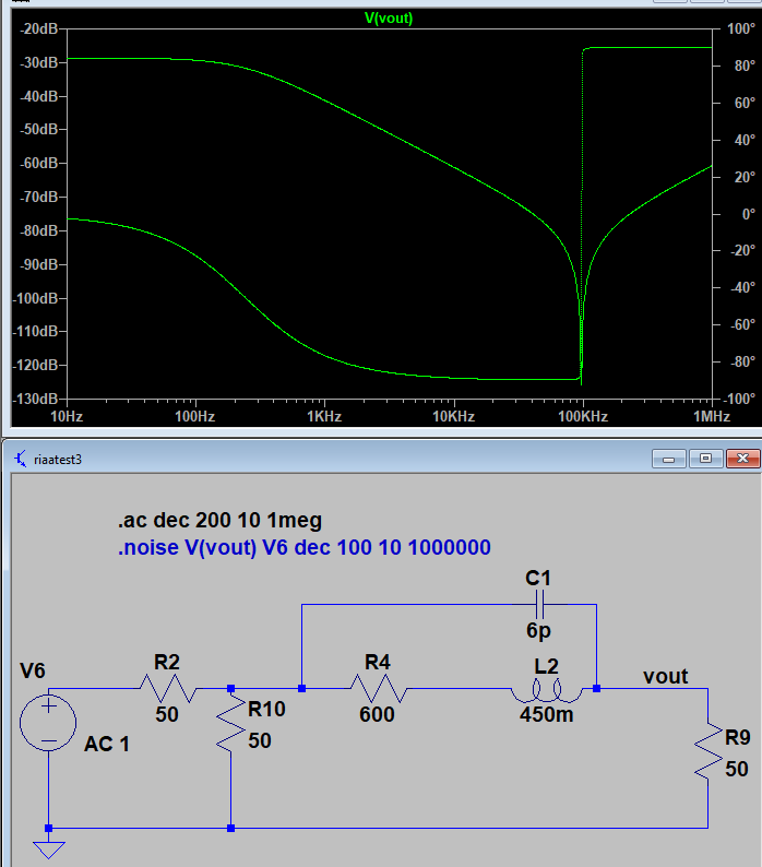

Yes, but on an S parameter box A/R is not impedance it's forward transmission and the parallel resonance gives a sharp dip. A/R = 50/(Z +50), you must be careful to keep all the math as complex algebra till the end and then take the magnitude and phase.
