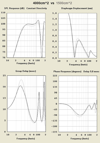

Maybe it's an idea to enlarge the mouth to 4000cm^2 (or as large as the total front of the cab). The little loss at low end in favour for a gain of 2dB overall is something I should consider. In max SPL there is even more to gain than 2dB because the excursion lowers also with a 4000cm^2 mouth. The excursion max transfers from 44Hz to 50Hz (remember Fs of the driver is 44Hz) and the group delay imporves slightly. All in all that means significant less stress for the driver.

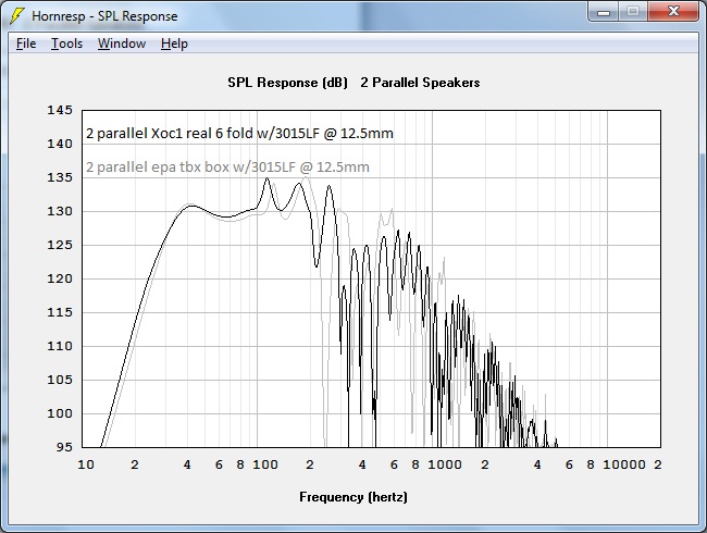

I might as well build epa's tbx box or Xoc1's 6 fold and load them w/3015LFs with an adapter ring until I have sufficient funds to purchase the proper 18" drivers. The 3015LF seems to model not so bad in either enclosure. Does the delay look a bit odd? What do you think?

I don't have your HR inputs to directly compare what I've been working with to your outcome. I did increase the mouth to 4000cm^2, but our traces are different (obviously).

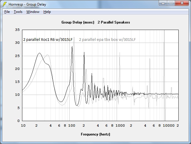

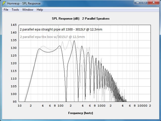

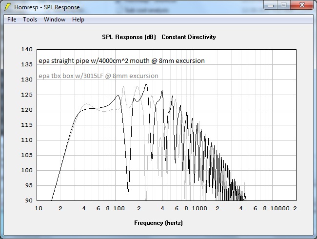

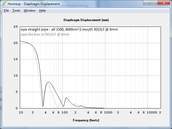

Here are comparisons of 'Erik's straight pipe mod w/3015LF' (5 posts back) and his 'tbx box loaded w/3015LF' both @ 8mm. I also compared the '3015LF-loaded tbx box' to the straight pipe (S1, 2, 3 & 4 = 1500; S5 = 4000cm^2) and used Erik's initial L/par settings for the straight pipe.
epa straight pipe 3015LF vs epa tbx box 3015LF @ 8mm.jpg89.6 KB · Views: 347
epa straight pipe 3015LF vs epa tbx box 3015LF @ 8mm _EXC.jpg69.9 KB · Views: 349
epa straight pipe 1500, 4000 3015LF vs epa tbx box 3015LF @ 8mm.jpg90.1 KB · Views: 342
epa straight pipe 1500, 4000 3015LF vs epa tbx box 3015LF @ 8mm_EXC.jpg72.6 KB · Views: 338
