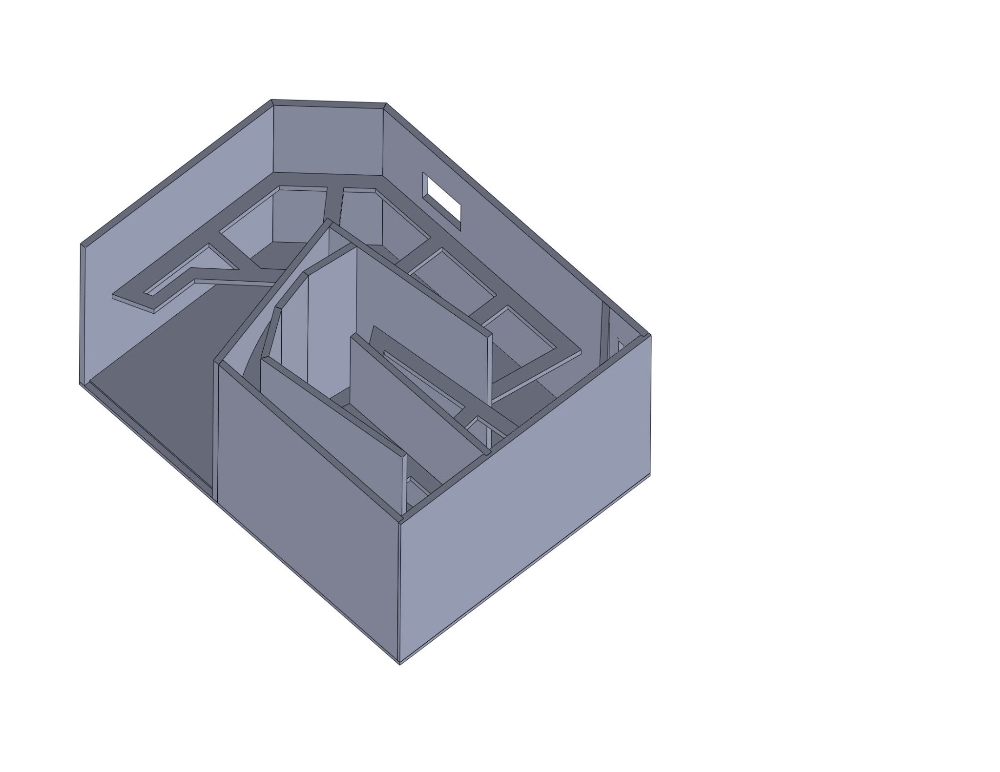

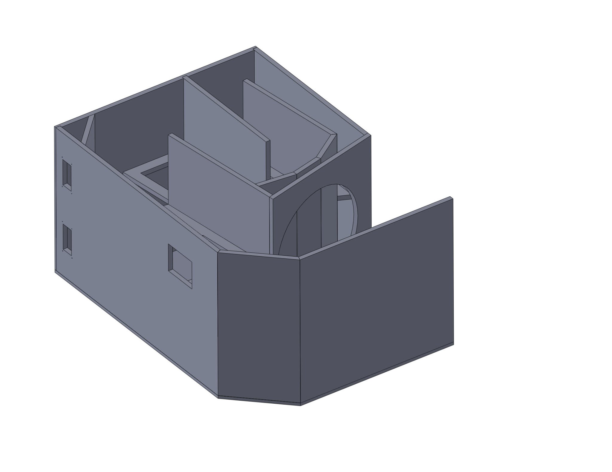

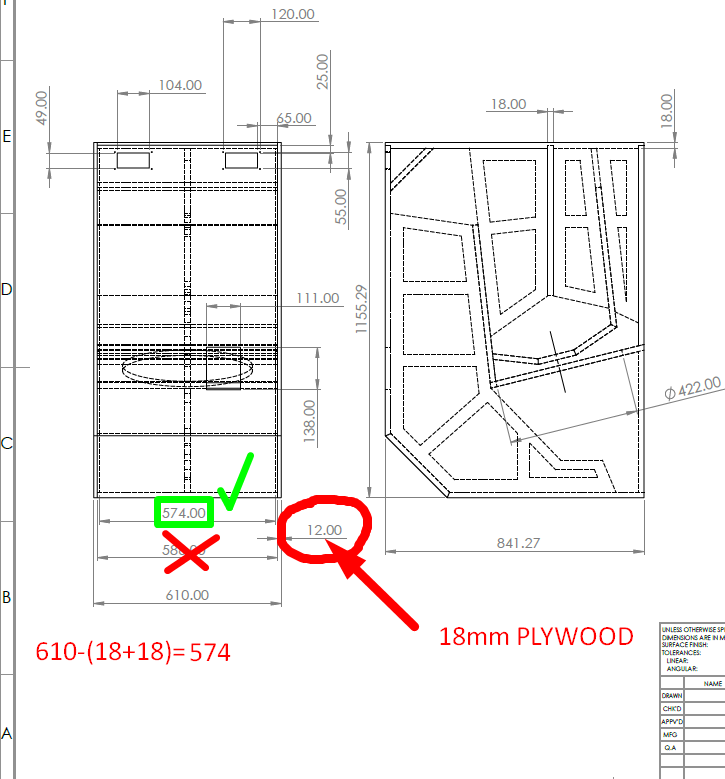

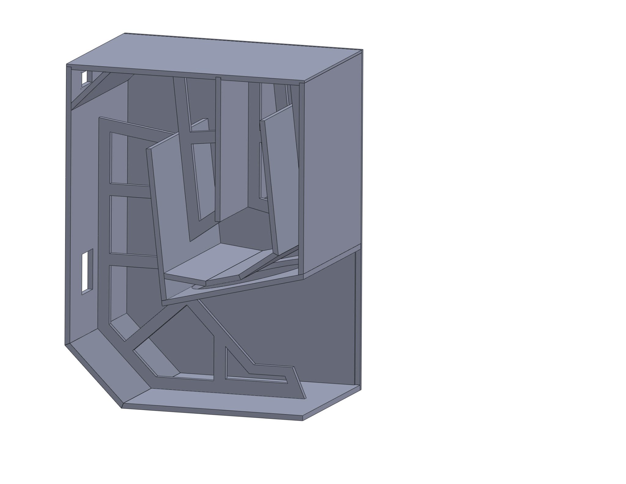

@maxolini as luck would have it I am working on creating some cut sheets now with a CAD guy from Ffiver. Will share here when complete and verified. In the meantime I wonder if you would cast an eye over this 3d model he has prepared for me based on the original plans? Epa said in post 773 the cab was 61cm wide external so I have based on that. I think this is right but grateful if you could take a quick look?
Indeed 610mm outside width (24 inches )
i looked at your posted PDF
and ply must be 18mm not 12mm

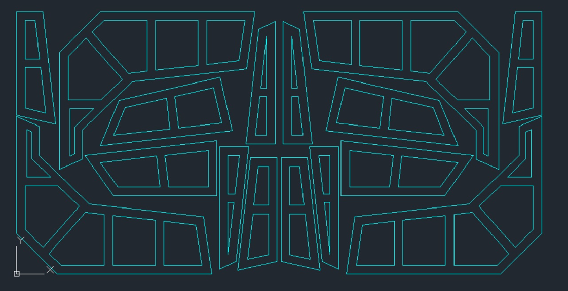

did the CAD guy draw the braces from the pic EPA uploaded ?
i uploaded both .stl files (bracing and internal layout )
if the CAD guy need em to save some time.
Sorry I can’t reply to your messages for some reason. Thanks for your speedy reply and for checking the drawing!
I thought the same but the 12mm measurement is to the corner which has a 6mm rebate to take the back panel. The dotted line is the inside face of the 18mm ply internally so it’s 574mm internal width.
Yes I have stl files for the bracing thanks. I’ve asked him to redo in cad with just bracing for the one cab I’m building. Il give him the nod to prepare the cut sheets. Thanks for you help. One step closer to saw dust! 😃

in case you need em... check the RAR file ( this forum wont let you upload DWG files )
inside are the DWG files of the FT30
one is the layout... the other is the bracing and a 3rd one that have a like a 3d projection, i cant know for sure as i cant see it
well in freecad.
just take a peek at those files
maybe the CAD guy can interpret the 3D view
