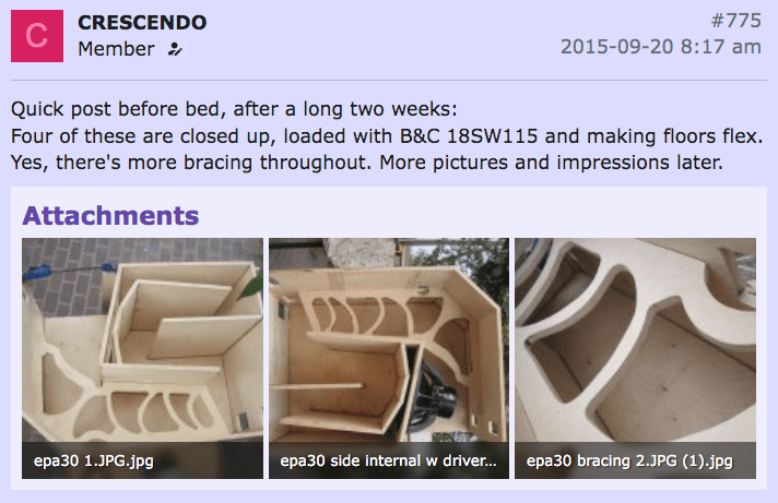

If we skip the cone correction wood, it still be playable?
Any design is "playable".
If you skip building the cabinet as Crescendo did, it won't have the same response as he posted.

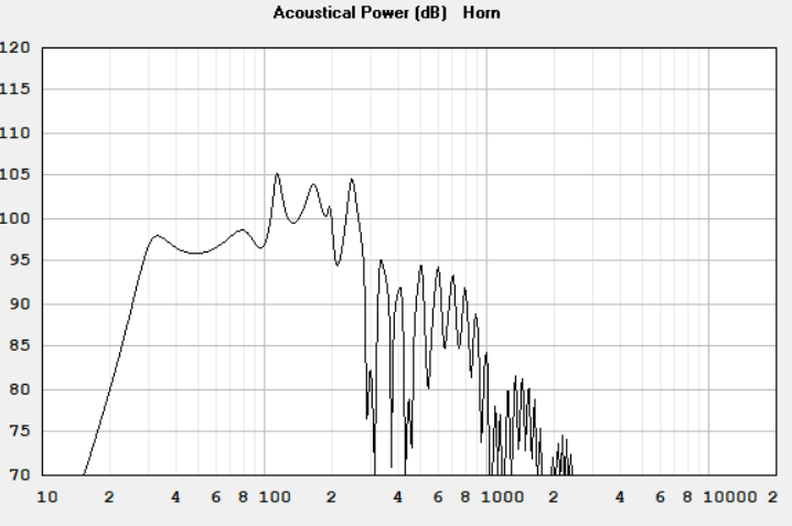

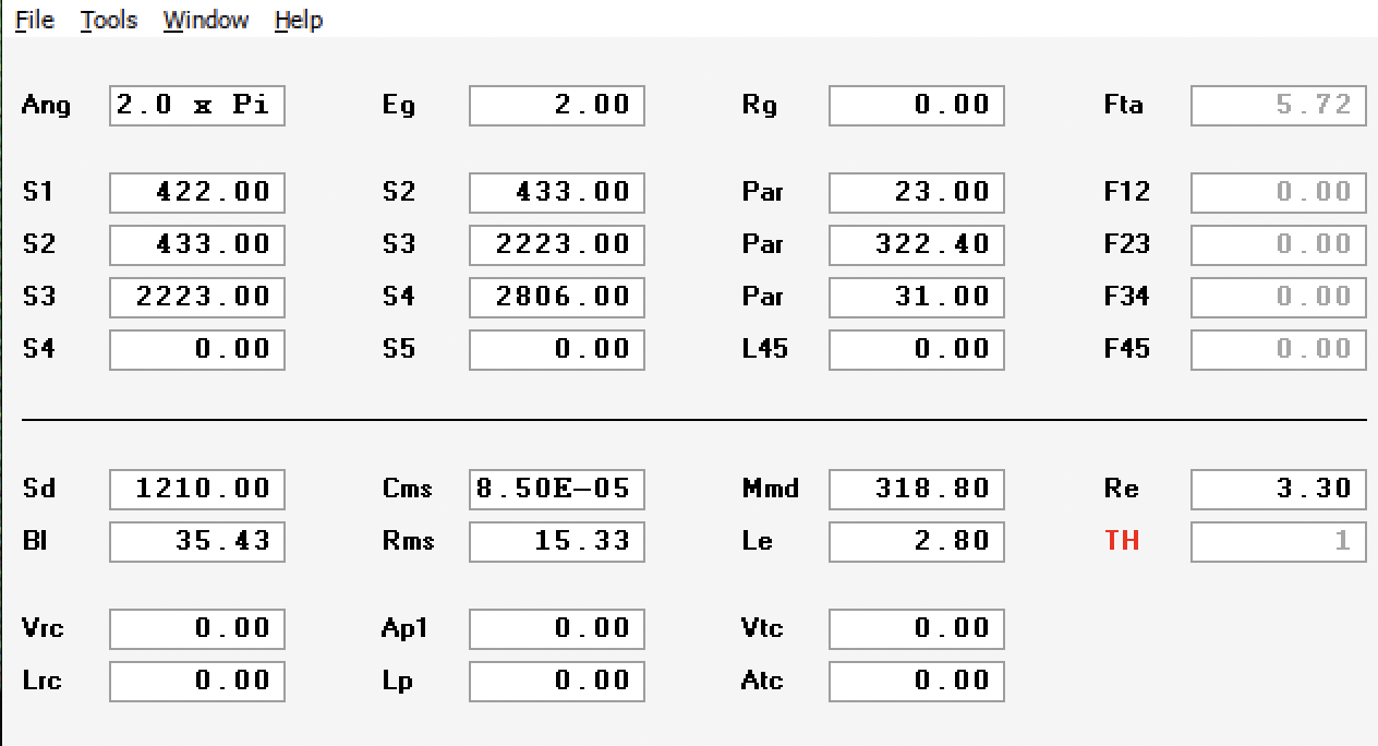

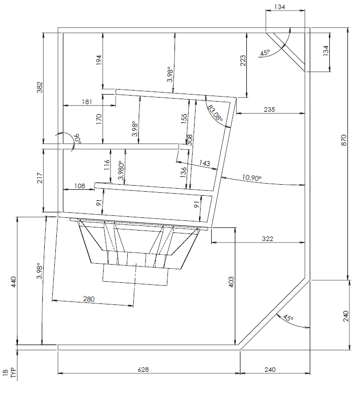

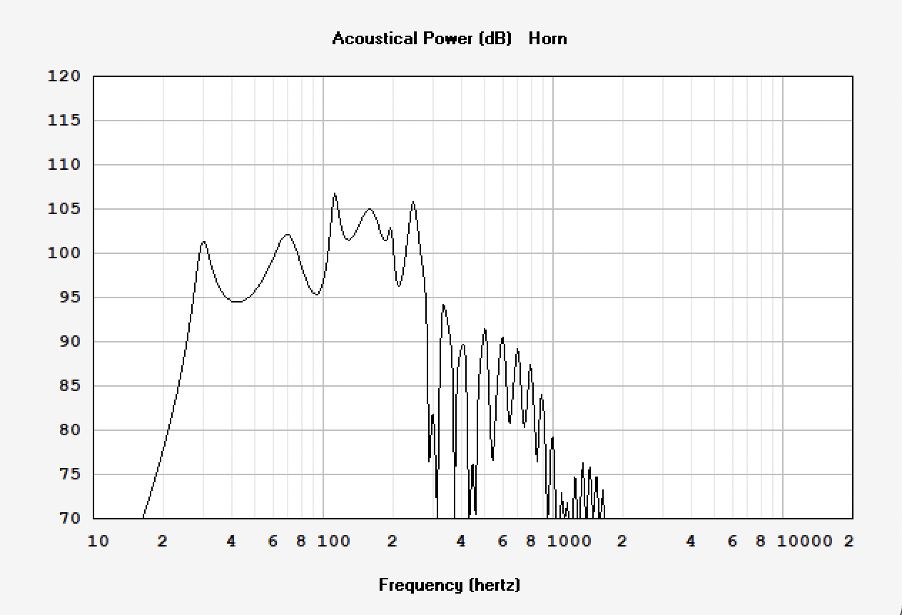

Could I get help calculating the response of this tapped horn using a B&C 18DS115? Does this look correct? It seems wildly uneven and unfortunately I already own two which I cannot replace. Thanks!
Reactions: stewin
OK, not quite sure if I understand since the specs in HR are different from the DS115, but with either specs I see nothing wrong other than its near 3:1 CR is pretty high for such a powerful output driver.
If wanting a more optimal alignment, its specs 'wants' a small ~46 Hz tapped pipe (TP) or horn (TH), which can in theory handle all 3400 W 'fast' transients.
Hmm, need to keep in mind that HR doesn't account for any acoustic damping, so in reality its actual response will be somewhat smoother plus a TP, TH is basically a two octave alignment, so you'll need to EQ/XO it above 80-100 Hz, which just leaves some EQing to suit the needs of the app, if any.
In short, had you simmed a typical BR-like flat response it would be severely over-damped (rolled off on both ends of the gain BW), so in the future 'shoot' for ~ +/- 3 dB with equal amplitude peaks.

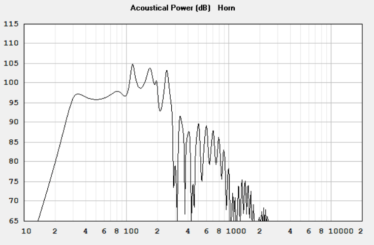

Has anyone also considered loading this design with any Precision Devices neo drivers? Specifically the PD1845-1n and the new PD1845-2n. I've done some very amateur hornresp (attached below) and I can't see any obvious issues although there is a considerable chance I've made an error somewhere.
If anyone can offer any input/help/advice it would be greatly appreciated.

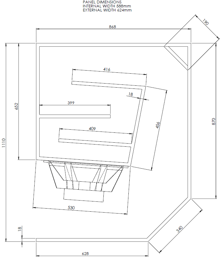

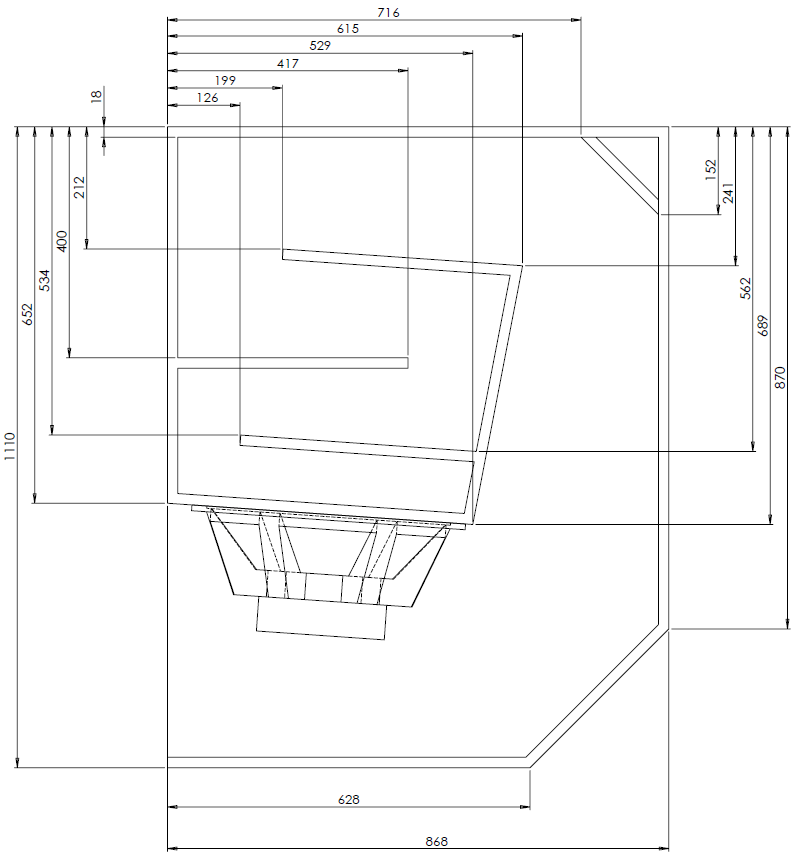

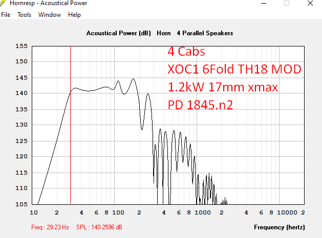

I have something that i collected in my stash of SUB plans
browsing trough all the FT30 thread
it was XOC1 who made something called the 6FOLD TH
basically it was his TH18 but moded to hit 30Hz and no cone correction
just plain folding AKA. the SS15
i can UL the plans if you like
he added a compression plate ( like the CV L36) cause he used the 18TBX100
but i guess you can remove it for the PD driver
and btw, the PD 1845.n2 sims great !
