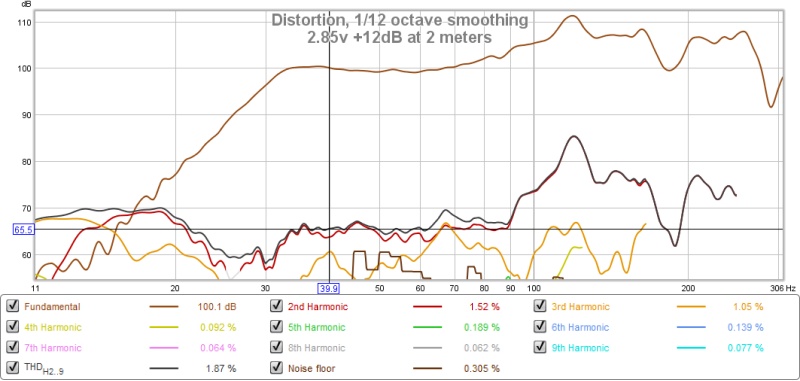

The highest I tested that day was 2.85v +12dB. Perhaps I can drive it harder this coming afternoon. Here's a distortion plot taken from 2 meters:

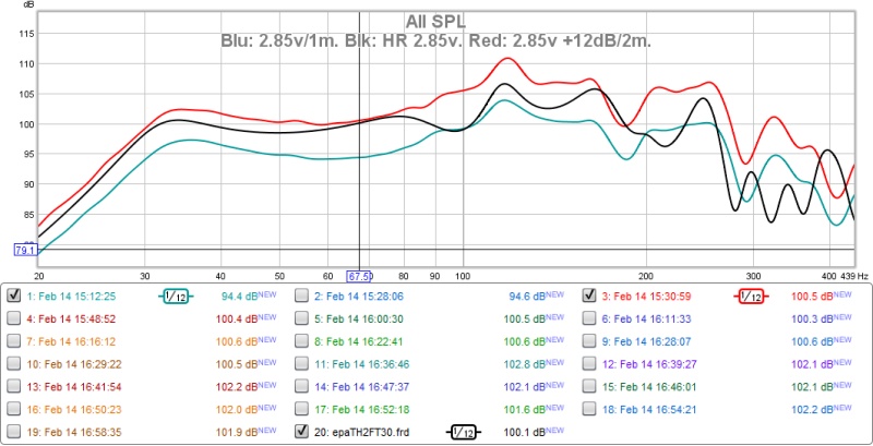

Here is a comparison with 2.85v 1m vs HR 2.85v vs 2.85v +12dB 2m.
Should I maybe consider purchasing a sound level calibrator? I calibrated SPL with slow, C-weighting in REW (to match the SPL meter settings), but the SPL meter also has a "Hi" and a "Low" setting, and REW does not.
if you double the le value from specs,it match even better(dip @100).
le rizes below 100 hz.
with the lossy le feature enabled ,the sim seems furter away from measured.
i wonder why its about 3 db less then predicted.

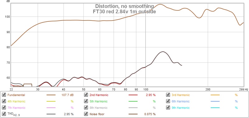

Concerning the distortion measurements, I think these can be used as a guide to determine the best HP filter to be used with the TH, or dynamic EQ if that's available via DSP. If you set the goal of setting the distortion below the lowest resonance frequency to be the same or less than the distortion within the passband, then you can use the REW measurements to assist with this. I do suggest using shorter sine sweeps when testing at higher power levels though. Oh, and I normally just look at the 2nd and 3rd harmonics. If the box is well-built (no flapping or unglued parts) and the driver is working well, the higher-order harmonics should be pretty low in level and not worth worrying about for a bass speaker that's going to be part of a full-range system. BTW, that rise in distortion just above 100 Hz is a bit ...curious. Was the bottom of the TH sitting flat on your driveway's surface, or do you have any pads installed below the TH? That last time I saw something like that, I found a pebble trapped between the bottom of the TH and where it was sitting on the driveway - it totally screwed up the distortion measurements.
Finally, if you only use the THs up to 115 Hz, limiting the sweep to 250 Hz and below would likely be less annoying to your neighbours 🙂

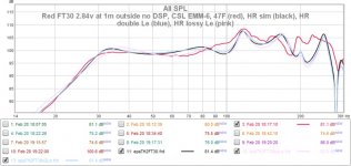

I've attached a 1m measurement at 2.84v (red) comparing it to the HR sim with published specs at 2.84v into 8 ohms (black), an HR sim with double+ Le (4mH) (blue) and an HR sim with lossy Le (pink).

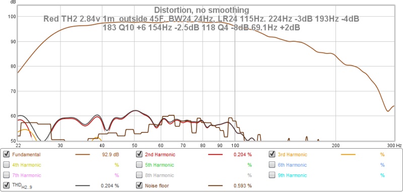

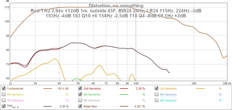

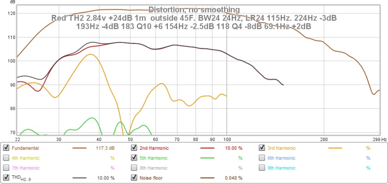

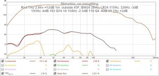

FT30 red distortion 2.84v +24dB 1m outside 45F. BW24 24Hz, LR24 115Hz. 224Hz -3dB 193Hz -4dB 18.jpg77.2 KB · Views: 164
FT30 red distortion 2.84v +12dB 1m outside 45F. BW24 24Hz, LR24 115Hz. 224Hz -3dB 193Hz -4dB 18.jpg73.2 KB · Views: 155
FT30 red distortion 2.84v 1m outside 45F. BW24 24Hz, LR24 115Hz. 224Hz -3dB 193Hz -4dB 183 Q10 .jpg72.9 KB · Views: 154

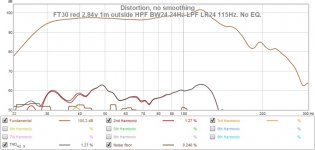

FT30 red distortion 2.84v 1m outside HPF BW24 24Hz LPF LR24 115Hz. No EQ..jpg66 KB · Views: 363

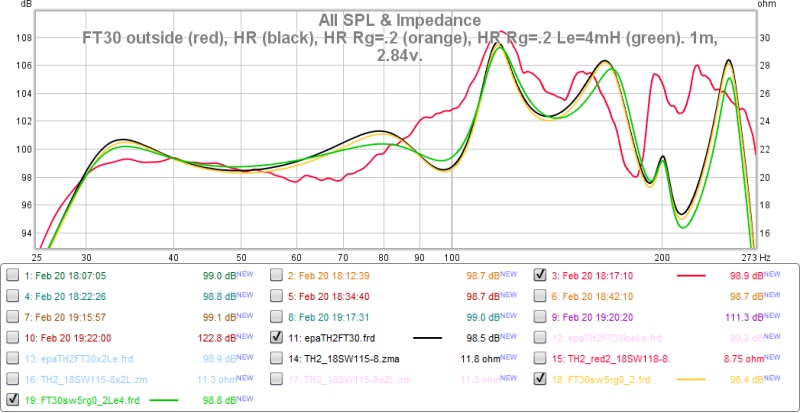

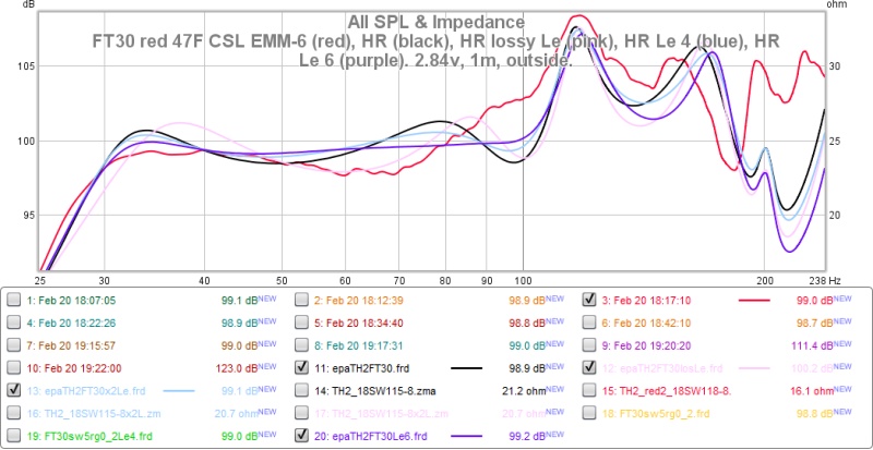

FT30 response outside (red), HR (black), HR Rg=.2 (orange), HR Rg=.2 Le=4mH (green). 1m, 2.84v..jpg106.1 KB · Views: 407
TH2 Red FT30 2.84v at 1m outside no DSP, 47F CSL EMM-6 (red), HR sim (black), HR double Le (blue.jpg86.4 KB · Views: 169
HR shows impedance minima at 30.51Hz. DATS shows impedance minima at 29.6-7ishHz.
So about a 3% difference. Not too bad at all.
The SPL graph shows a difference of about 1db around the lowest resonance frequency - easily explained by the fact that the Hornresp sim does not include the impact of box losses. That loss of efficiency in the passband between 60Hz and 70Hz is curious, and I've noticed something similar with my POC3 build, which interestingly enough from the front looks a lot like your FT30 (smallish mouth). I'm speculating that this may be due to the impact of the driver's motor sitting in the mouth - something that's not accounted for in the sim. This might also explain the slightly lower resonance frequency too. Logic says that the larger the driver, the larger any effect it will have, if the size of the mouth is kept constant. The POC3 was my second attempt at designing a TH - for my few subsequent attempts, I used Hornresp to set a mouth size that causes the response to vary only slightly if it was decreased by several percent, with the hope that would reduce the impact of the driver's motor on the response.
At higher frequencies your measured results are higher than predicted by the sim. Theoretically that should not be. However I suspect that due to the size of the front panel, perhaps we're seeing the impact of some directivity changes there? Again, something not taken into consideration in the Hornresp sim.

played wiht the hr sim en found the if you raise le to 5 or 6 mh it wil match even beter.(not saying that is the right way to do it)
can you print an overlay comparison with 5 or 6mh to measured?

Attached 🙂
I see that it's a bit closer up to 100Hz, but it gets further from measured after ~150Hz.
