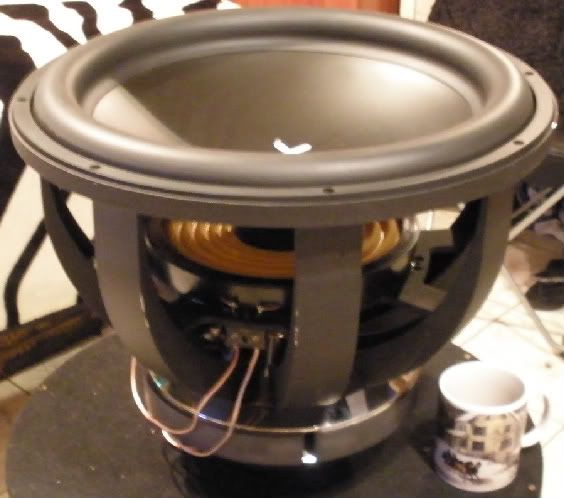

RE Audio XXX 18 D2. 15" deep, 80lb boat anchor. AKA the bass pump.

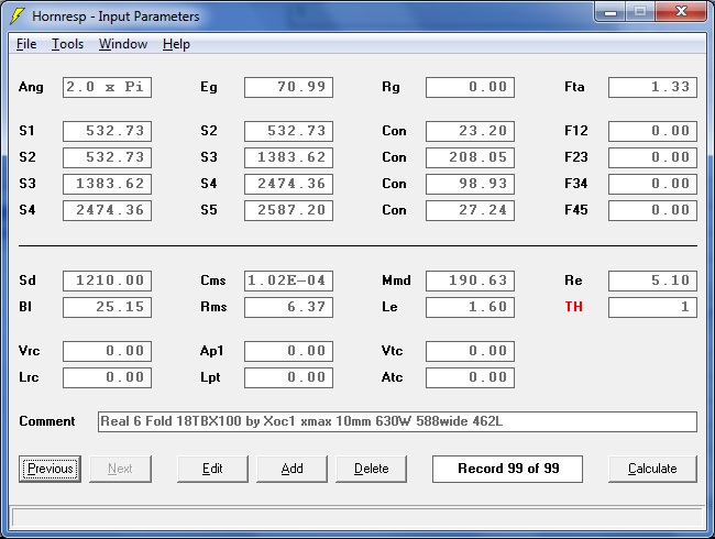

I have done a quick sim on the B&C 18TBX100
Initial 1w response looks promising
If Xmax is 9mm then x-max is reached at just above 56V (400W /8R)
(no allowance for compression!)
Comparisons on charts
2.8v Grey PD1850 Black B&C TBX
Theoretical Xmax limited outputs Grey PD1850 @80V - 11mm Black TBX100 @ 56V 9mm
Please download Hornresp and feel free to compare other drivers yourself!😀

To clarify the point I asked the best way to simulate this in the Hornresp thread. (Post 1500)
http://www.diyaudio.com/forums/subwoofers/119854-hornresp-150.html
General consensus is that the coil resistance should be added to Rg, and the coil inductance added to Le...
This does make a difference.
Screenshot shows sim in post 21 with 4uH 0.72R inductor in grey and 2.5uH 0.38R inductor in black.

The response of this design sims VERY close to Xoc1's 'Real 6 Fold' TH with the same driver. Yours requires more wood cuts and appears slightly more time consuming, but is slightly smaller.

i think this was about the discusion of putting a/wich coil in series of the bms driver.
the point xoc1 was making that by adding a coil you also add resitance,wich in turn does the opposite of what the higher le vallue does to the responce.
in the meantime ive learnt that for subs you can double the le vallue wich is measured @ 1khz
so adding a coil is almost always not needed.
