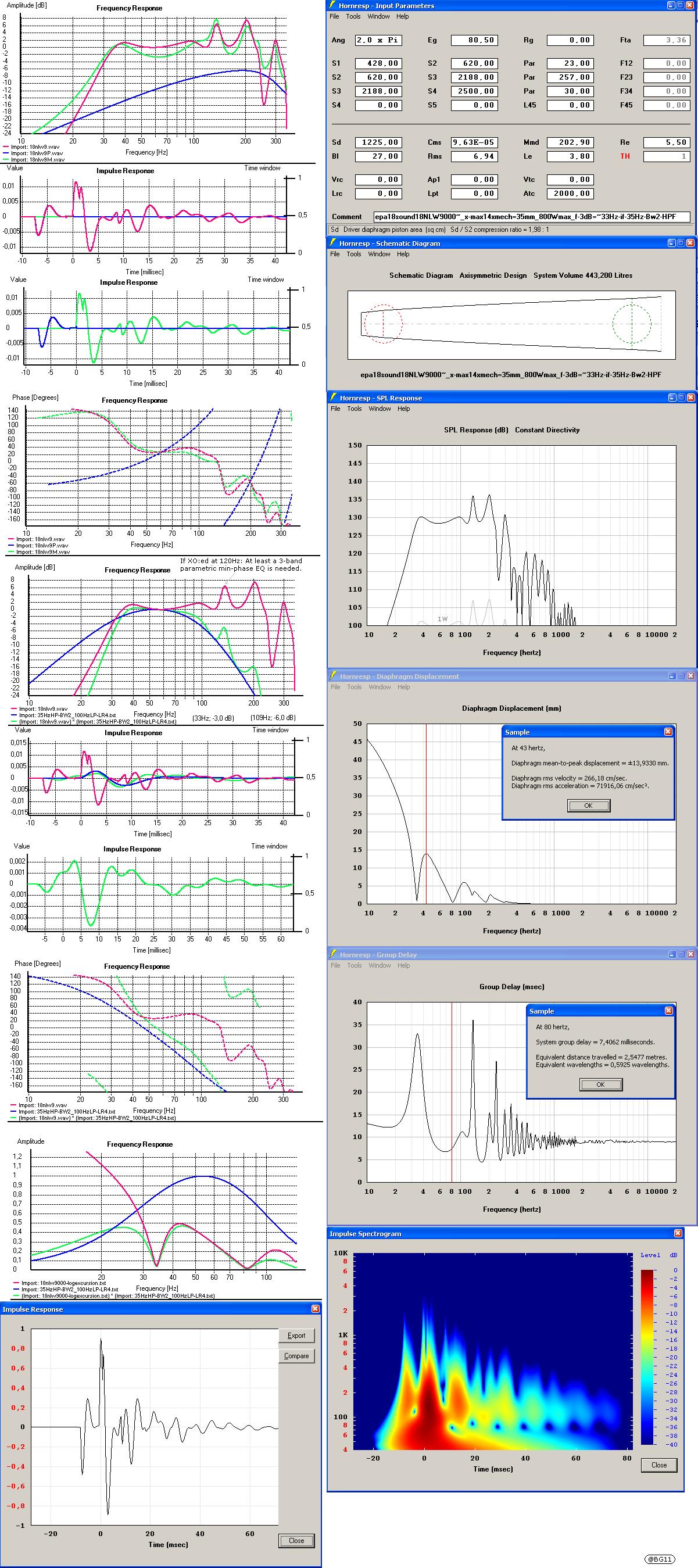

here is a mod of a model i posted earlier.
as djim sugested ,i put the magnet outside the chamber for better heat dissapetion.
the box is 570lts and is 1+ 2/3 of 4'x8'sheet ,so thats 60 kg (whitout bracing)
Interesting results Epa
Your design is based on (1/3wavelength) Fb of ???? (32Hz?)
While Xoc1-TH18 is based on a Fb of 3.045m = 37.6Hz
Your design has a significant increase in low end extension at cost of a relative high Group Delay at the highest excursion point and at costs of bandpass in the higher part of the frequencies.
The question is will it perform as your prediction...

wel the goal was ,low towards 30 hz with resenable output,and not to heavy.
the group delay is not so good ,needs to be crossed 80~90 hz.
i can't see a reason why it shoulden't work(mayby relative short path towards the mouth?)

i think it needs reflectors @ bottem front.
it needs some tweaking to get concistancy
the 18lw 2400 preforms equaly in this design.

?, See a simulation that reflects your HR input data:

Mission accomplished!wel the goal was ,low towards 30 hz with resenable output,and not to heavy.
Indeed, the 35Hz peak is a little high (+30ms) and thethe group delay is not so good ,needs to be crossed 80~90 hz.
peak at 150Hz, although very small band so that might be much better in reality (less high).
Indeed, if the driver is going to 'see' the path like a more traditional TH concept the sound will start to roll of 10Hz higher.i can't see a reason why it shoulden't work(mayby relative short path towards the mouth?)
