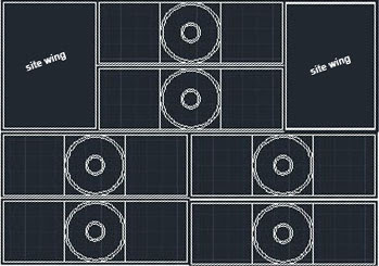

Looks good, epa. Some questions:
For the left design (47.25" x 33.5" x 17.71" - no, that's not too big), I know I can run a stack of 3 on each side, but would there be any problems with putting 2 stacks of 3 next to each other (since the panels will create a bit of distance between the mouths of each stack - the mouths wont be right next to each other)? I do remember you saying some good things about symmetrical cabinets, however. And I really like the looks of it.
From an output standpoint, would I be better off using the bottom right design (33.46" x 33.46" x 25.6")? Stacking 2x3, the mouths may be joined.
making a center stack you be better off right bottem.
making a stereo left and right stack you better of left .
if you have >3 amp channels (for the subs)you could use left one,in center stack, delaying the outside boxes gradual.(stack them vertical).
because you wil get some beam forming in the upper pasband when the aray is >4'wide
the mouth being 40 cm from the floor will create i tiny bit of down tilt wich is good .
and it all depends how the room shape is,in a narrow room some beamforming is a good thing.
and sometimes people like some"quiet(er)" spots in the room.
a narrow space between the boxes is not a problem.

So, if the left enclosure is "v1" (version 1) and bottom right is "v2" (version 2), then:
1. center stack is best w/v2 (post #484)
2. stereo stack is best w/v1 (post #484)
and
3. stacking 6 horizontally is great (post #488)
4. stack vertically for wide horizontal coverage; narrow for vert coverage (post #490)
5. stack horizontally for wide vert coverage; narrow for horiz coverage (post #490)
6. best = 6 vertical (post #490) (might contradict #3, unless you mean stacked vertically, but positioned horizontally - like you said at the bottim of post #490).
Hopefully, these images will clear things up (forgive the 2D program imperfections). THESE ARE NOT TO SCALE, for reference only :)
When I asked about stacking v1 - 3 wide, vertically (3x2):
or w/v2 (3x2):
When talking center stacks, were you referring to this (or more like the setup at the bottom of this post?)?
w/v2 (2x3):
What about splitting this up for stereo stacks?
I was worried about the drivers being too spaced apart here w/v1 (2x3):
This is the one #6 started to sound like. This is the one that will give wide horiz coverage, right? (I don't have enough amps to delay the outer cabs properly)
v1 (row of 6 vert)
v2 (row of 6 vert)
but, I think you were talking about and recommending this:
v1 (6 horiz stacked) (I can't get this one outta my head :smash: )
:smash:
and what about w/v2? (6 horiz stacked):
So many different configuration possibilities.... One could even split up the vertically positioned (row of 6 vert) v1 & v2 cabs into stereo stacks.
i admit its a bit confusing,but a picture says a 1000 words :)
its a bit strange looking but it works
this wil work also ,but...
this will work better.
you can easily split for stereo use.
this wil narrow the beam a bit in the horizontal plane in the upper band of the subs,say from 80 hz up.
the oposit ,the wider the aray ,the narower the horizontal beam,but you can physically delay the outer boxes by staircasing them or make an inverted arc with them.
same sitiuation as above,(i would try this upside down)
this is imo the best situation(if you choose this model)
this wil give excelent horizontal coverige(and looks great :D)
same as above(looks good 2.

I really like the stack of 6 high w/v1. It seems to be a great choice for installs or for shows that don't happen too regularly. I'd like to keep this option open for future possibilities. I can see v2 being a bit more portable/manageable. If you think I'd get very similar results w/either cab, I'd like to go v2 (bottom right). I hope I don't shoot myself in the foot with this decision.
