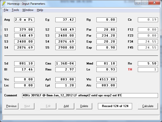

But I'll use your example with a grey area of 60cm x 40cm = 2400cm^2, the total front should be twice as big = 4800cm^2.
The depth of the cavity should be calculated by the diagonal of a circle with an 2400cm^2 = 55,27cm
55,27cm x 0.6 = 33,16cm

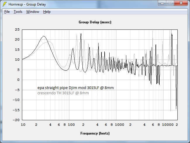

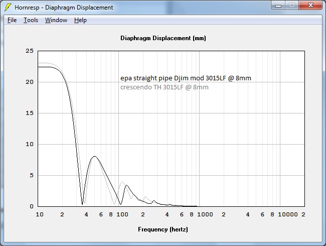

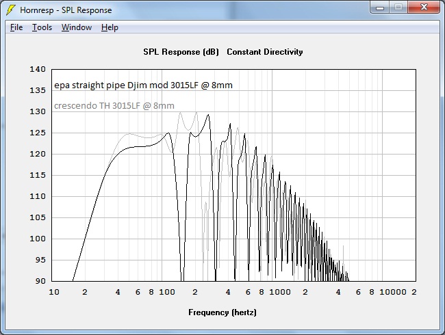

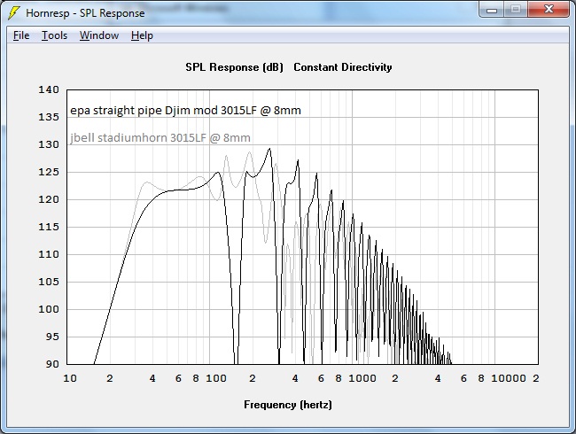

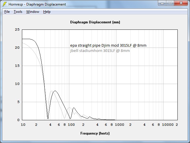

Played w/Hornresp a bit - veered from a straight pipe tho.
Is this worth it? Looks pretty good, considering the drivers' restrictions. Same LF, slightly bigger, higher sensitivity, better group delay(?), excursion peak approx same distance from Fs as Djim's mod. Sanity check, please (it's 5am here).

40Hz TH 3015LF ext lf attempt2, ext upper resp2, ext lf1.jpg98.5 KB · Views: 100
40Hz TH 3015LF ext lf attempt2, ext upper resp2, ext lf1_SPL.jpg90.2 KB · Views: 150
40Hz TH 3015LF ext lf attempt2, ext upper resp2, ext lf1_EXC.jpg70.3 KB · Views: 149
40Hz TH 3015LF ext lf attempt2, ext upper resp2, ext lf1_DEL.jpg87 KB · Views: 105

the "problem" is in your sim you cant eq down low.
but less steeper rol off is good
your sim is 60(80~90 in reality)ltrs bigger .

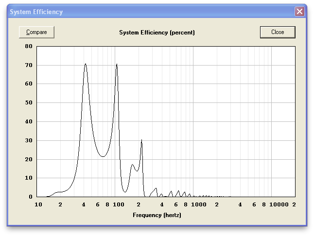

I also have been looking to your new suggestion of post #527. You seem to have forgotten to extend L45 so that the driver fits in the cab. By using minimal 20cm for L45 your 15”driver will fit.
If you look to what it does with the response of your TH you can see it becomes more ‘smiley’ 🙂 , though bumpier is actually a better word. When your model response becomes bumpier it will be less in reality but.... It comes with a counter reaction which doesn’t show up in HornResp. The higher these bumps in the response become, the bigger the differences in dynamic compression between the bumps and dips at maximum physical excursion. Top drivers with very stiff cones can deal with that but the 3015 will show significant compression figures in these dips. In my experience gentle roll-offs works always best and response stays closer to its predictions when the driver nears its physical max excursion.
You can use the "System Efficiency" function in HornResp, in tools, to improve your design. The higher the peaks the better the efficiency of your system. The higher the efficiency the better sensitivity figures your subs will have. Again, there is more to it. What happens when your driver gets to its maximum excursion, is that the peaks become smaller and dips lower. These ‘losses’ are dynamic compression. The more ridged the cone, the less losses. Also, the bigger the differences between the peaks and the dips, the higher the compression figures these dips will have…. Still following?
In your case the 38Hz is very important so make sure you will reach at least 5% efficiency here. Also look at the dip between the first and second peak. Try to make this dip as high as possible with minimum limit of 5%. The less difference between the efficiency peaks and the efficiency dips, the less dynamic compression differences between them. So very high efficiency peaks with very low dips is therefore a no go if you want the smoothest response at max excursion. I know, it's a lot and there is always more...

Looks like I'm using an old version of HR (28.00). No wonder I didn't see "System Efficiency". If I install the latest version (28.90) will it erase all of my records?
This is getting to be even more interesting. Thank you so much for helping me with direction. I know the language barrier can be difficult sometimes, but you're doin great and I know you mean well. So, again, thanks!
