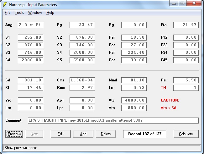

Going for a smaller opening in S4 or reducing the cavity, like usual TH's, will end in a pipe not a horn. Going complete FLH style and you'll end up with even bigger cabs and these cones are not up for that task.So somewhere down the line some concession needs to be made. The last cavity (extension section) can be made as an attachable unit to safe weight.
This will be the TH without the extension. S3 sits exactly where the opening starts. S5 (opening) is 40cm high and 62.5cm wide.
Everything is still transportable and he even can use them in singles for small gigs if needed. With 400Watts per cab he reaches physical Xmax (based on 3dB power compression). 3 cabs still have a max SPL output of 130dB. Low cut filter (at excursion dip) 34Hz - 24dB/oct.
The optional extension is still possible. The difference in SPL doesn't seem much improvement for all the extra's.
But to see the real value of such extension you have to look at the differences in efficiency and its relation to losses (power compression) that don't turn up in the SPL response.
The efficiency is >2 times higher at 38Hz... with the extension.

HornResp input for the extension;
Switch to TH1 driver placement, double click on TH.
