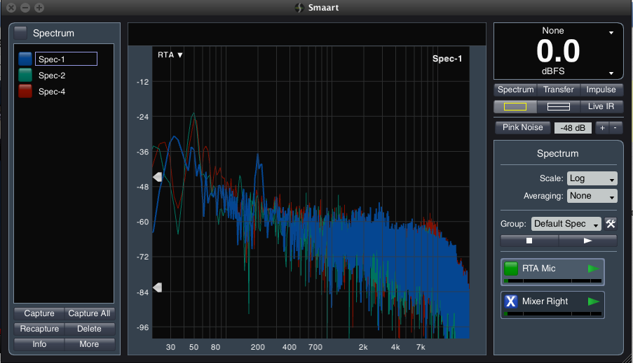

One of the main reasons I want extended bottom end (below 40Hz). Djim scanned a whole mix of mine and found it was centered around 38Hz, but this is the lowww end energy I have been trying to describe.
The bassline takes a walk to the left and I took 3 'captures' to show this; from blue to red to green. The signal was fed directly from my right ch. mixer out to my interface connected to my laptop via firewire:
Note: don't mind the 'x' on the 'Mixer Right' on the command strip. I was comparing readings before I did a screen capture

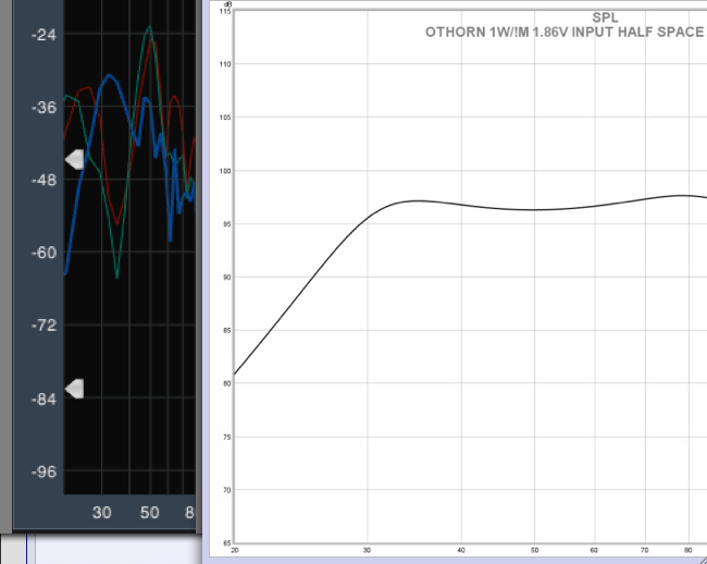

Looks like the fundamentals around 25 Hz are down about 10 dB from the first harmonics, Josh Ricci's Othhorn could reproduce that faithfully.
Most of the other TH PA subs you seem to be considering won't do much at all for the 25 Hz fundamental bass notes.

Hi Art,
"...the fundamentals around 25 Hz are down about 10 dB from the first harmonics, Josh Ricci's Othhorn could reproduce that faithfully."
The Othhorn is down about 10dB @ 25Hz, so even this very fine TH would require a 10dB boost to reproduce 25Hz content accurately. It may well have enough reserve in the excursion to do that as long as the incoming signal in that range is 10dB down from the rest of the music, but that'll take some investigating.
It may well take something like the Gjallerhorn (which will get close to 20Hz).
Hi Oliver,
I don’t agree from a PA point of view. I know you like to design flat, but going down flat to 25Hz lowers the overall efficiency. That means raising the average power by 3dB in the area where you need most. It will raise the all power compression figures which you want to prevent in PA.
-10dB is still audible and with the crest factor available, you can partly make it up. Therefore it wouldn’t surprise me if Josh deliberately chose the 29Hz point as -3dB point in order to keep the best balance for PA between volume, efficiency, power compression and still be able the reach the lowest but rare notes.
