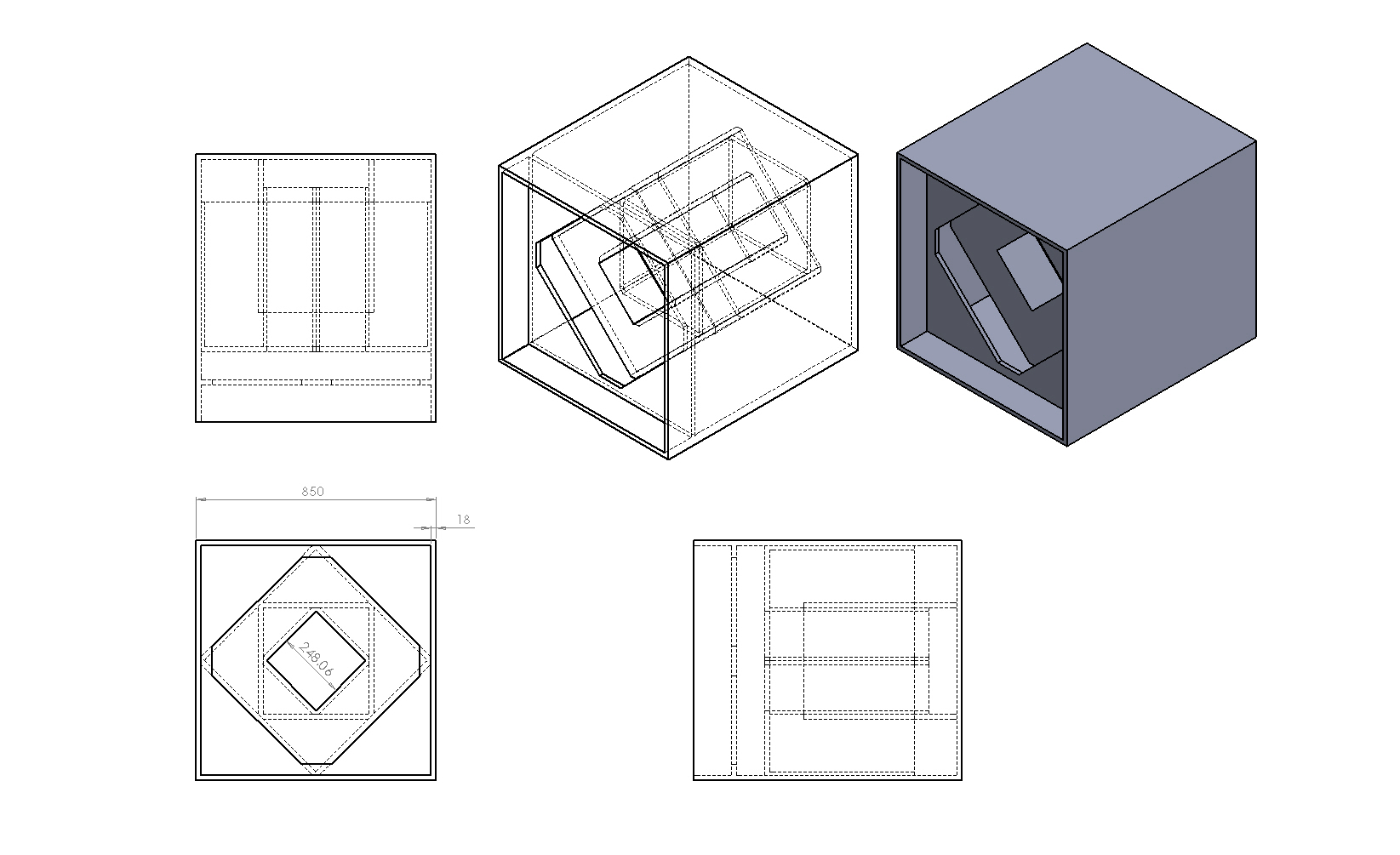

did some more testing today with the symetric model.
note ,it was all done in to little time.(no pics yet)
first we want to get a inpedance measurement.
i found it was verry hard to get a good curve with the speaker in the box.
with the speaker out the box we get a nice smooth curve.
no sure how to get smooth curve measuring in the box.
but the measurements show the first peak has a lower amplitude then the sim,next lowest dip was about the same as the sim,the middle peak was also about the same as the sim ,then the high peak was about 6-7hz higher.
then we put a signal on the beyma g400 , it didnt preform that well to be honest.
after that we put a 18sound 18lw1400 in it,it was much better ,considering the box wasnt moddeled for it.
then for comparison we put a eaw sb 850 next to it,feeding the same signal.
amp was a qsc pl 1.8 ,28 hz hpf 48db/oct
the th horn(8ohm) out preformed the sb 850 double 18(4ohm) a bit on the low end.
they are aprox the same volume.
i think the symetric moddel is good enough to explore some more.
next testing after 2 weeks again.
grtz erik
All of the peaks should be a little lower than the sim suggests. If they're a LOT lower, that suggests that the joints in the box, or between the driver and the baffle it's mounted to, aren't airtight.

Looking at that box again, I'd be tempted to add another panel between the panel right behind the driver to the rear of the enclosure, which would bisect the horn and add additional bracing right where it's likely needed.
tnx brianLooking at that box again, I'd be tempted to add another panel between the panel right behind the driver to the rear of the enclosure, which would bisect the horn and add additional bracing right where it's likely needed.
that was already in the planning for the next test.
also some extra bracing is to be added then.
and for securety ,i put some stuff on the joints.
speaker has some foam on it so that wil be ok.

Hi Eric,
Very nice indeed, Eric.
Such construction will give the optimum spread of the forces over the total cone surface, at both sides of the cone
You can extend the front to make it into one big mouth for maximum acoustic coupling when you stack them.
i had that in mind ,when i came up with this.Hi Eric,
Such construction will give the optimum spread of the forces over the total cone surface, at both sides of the cone![]()
there are some things to think about.
path lenght is different (horizontal and vertical) vs path lengt diagonal.
20 to 25%.
this box is a bit to big(560 ltr)compared to the sim(355 ltr)
you could make varius shapes of mouths ,or just leave the whole front of, who knows😀You can extend the front to make it into one big mouth for maximum acoustic coupling when you stack them.

Hi Eric,
Instead of making tunnels in the length, going towards the back, you could make tunnels in the width (see picture). Maybe that gives you more control over each section in path....
Edit: To prevent confusing, the grey areas are open areas.
Hi Eric,
intresting option.
this wil be the next model im going to draw,when i feel like cad-ing again.
btw you have the same pathlengt differences (horizontal vs diagonal),as in my moddel,wich may or may not be a good thing.
but easyer to bild i think.
left horizontal/vertical path lenth vs right diagonal path lengt in my model.
Hi Epa,
I see your problem. The diagonal and the horizontal/vertical lines together are forming the system. So use the average of both by calculating it with CAD. Just remember that HornResp and TH's work by responding to the Volume per location. They don't 'see' shapes.
The trick for such construction is you have to work with perfect square shapes.
Start with the driver panel (panel A) that is as big as the driver and build out from that point.
Panels A, B, 1, 2, 3 (and the red front panel) are all perfectly square.
The difficulty is to brace the middle section since the two internal panels are hovering.
The best construction can be made from corner to corner (see View Front, B).
I left out the front (red) panel in the front view.
So if you look through the driver cut-out you look at a cross-bracing.
The bracing from the middle section/box to the outside box should be braced in the centre of each panel.
But since such construction needs very accurate cutting but you can simplify the layout by going symmetric (all panels have 90 degree cuts and are parallel positioned).

another nice one xco1.
dont know if the volumes are close but it looks like it could be done that way,+ its much easyer construction.
@ jim been modeling a bit ,and came up with this.
the problem is the last part of the middle section (red)this area expands to rapidly.
ofcourse you could go from conical to paralel there
hi martin
the more i look at you design ,the more i like it.
its a super strong construction.
id like to put it in akabak,i know how to make a extra section ,but i dont know how to put those corners in.
Hi Eric,
If you work fully rectangular like Martin’s concept drawing of post#636 it is indeed more easy to build. If you build TH’s from 6 rectangular sections it will work up to at least its full wavelength.
For instance each straight rectangular section can have a maximum length of :
Minimum upper limit...............Maximum length per expanding section
140Hz .................................. 41cm
120Hz ...................................48cm
100Hz ...................................57cm
80Hz......................................72cm
It's not that they don't work above the upper limit but they wont follow the prediction any longer.
The extra volume in your drawing will not be a huge problem as long you use corner correction.
