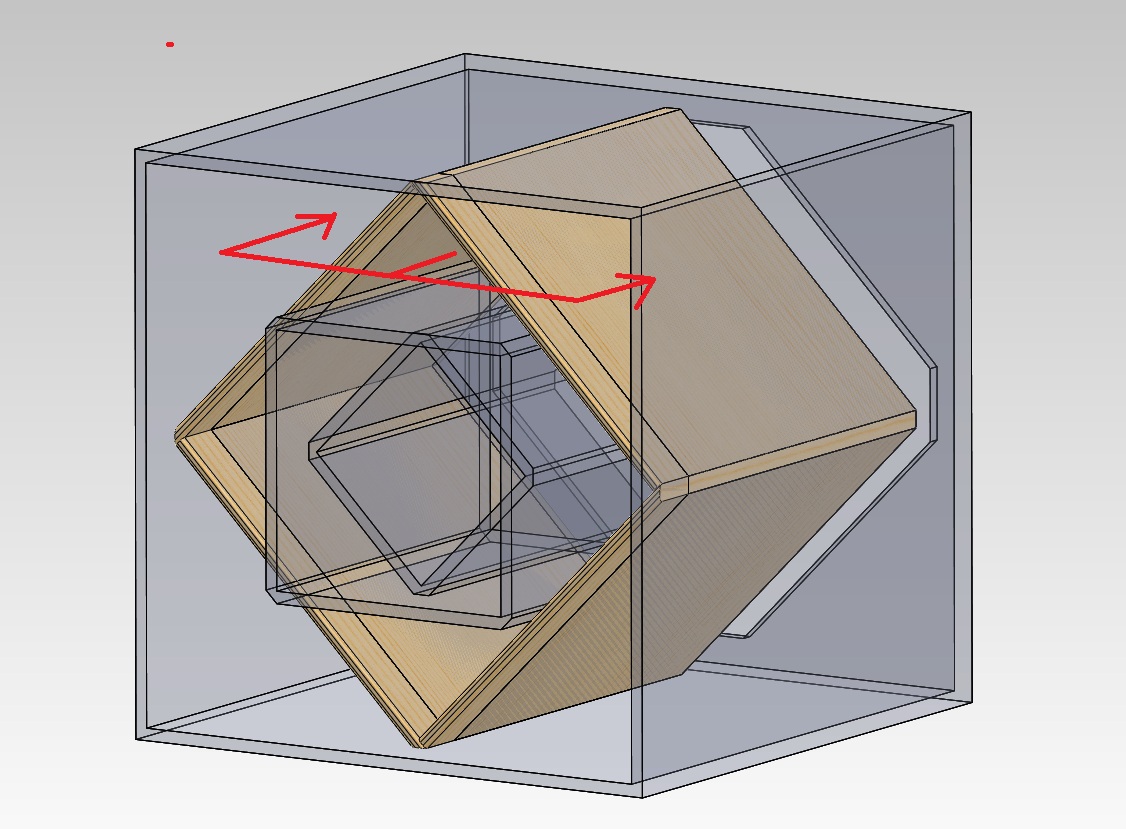

Corner Thought Process No 1
Concider this end condition. The panel is extended right to the back for half its width. This gives a single defined path for the horn. The size of the cutout can be adjusted, and should give an area for the corner turn that is equal to or bigger than the area of the previous section.

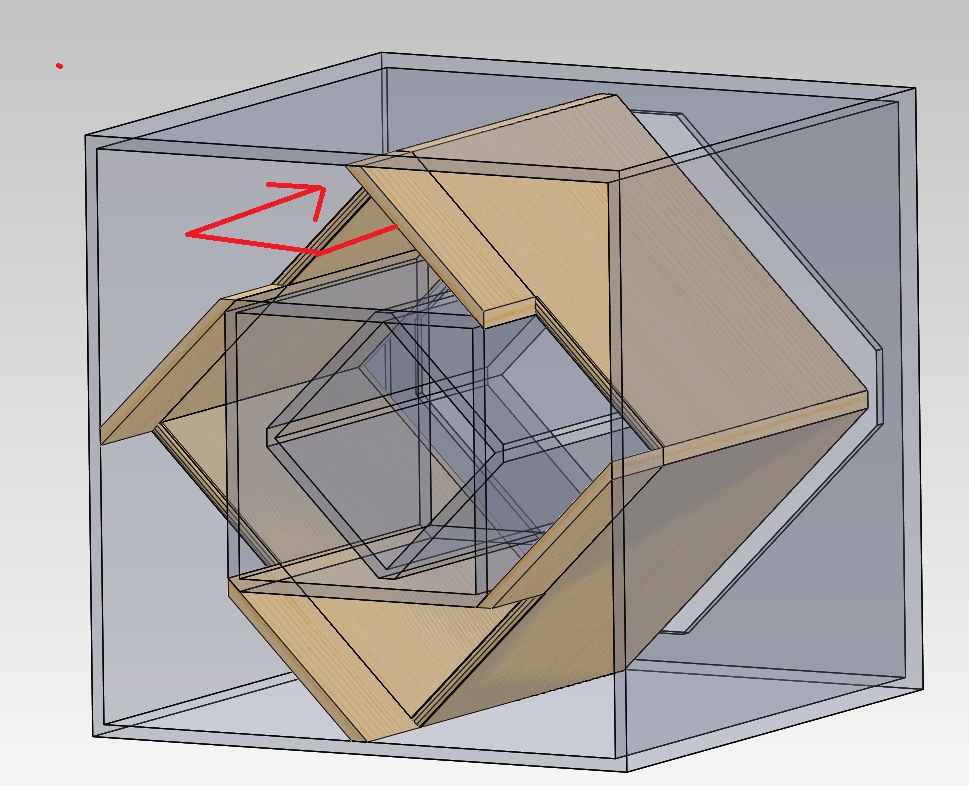

Corner Thought Process No 2
Now concider this end condition.
The internal panel is kept short of the back panel over its entire width. The path for the horn is split both ways.
The area of the turn can be adjusted as before but as it is twice as wide it can be half the height.
The advantage - as I see it is that this allows for a longer internal path length.:)

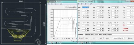

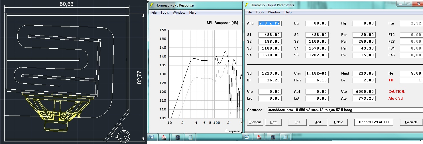

hi kctess5
its "the standart fold"(there are manny like that)
this design is a 400 ltr cab designed for the bms 18 850v2.
wich driver are you planning to use?
i can sym it to see if it works in this design.
ive got the file on this one somewhere,i can give details .
edit/for outside i would bump the f3 closer to 40 ,adjust the design a bit.
