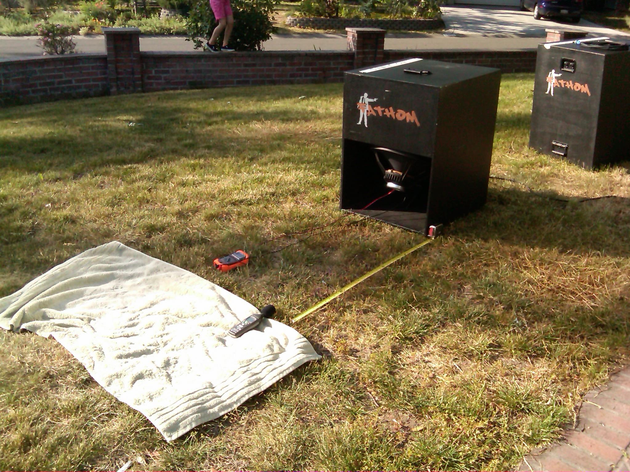

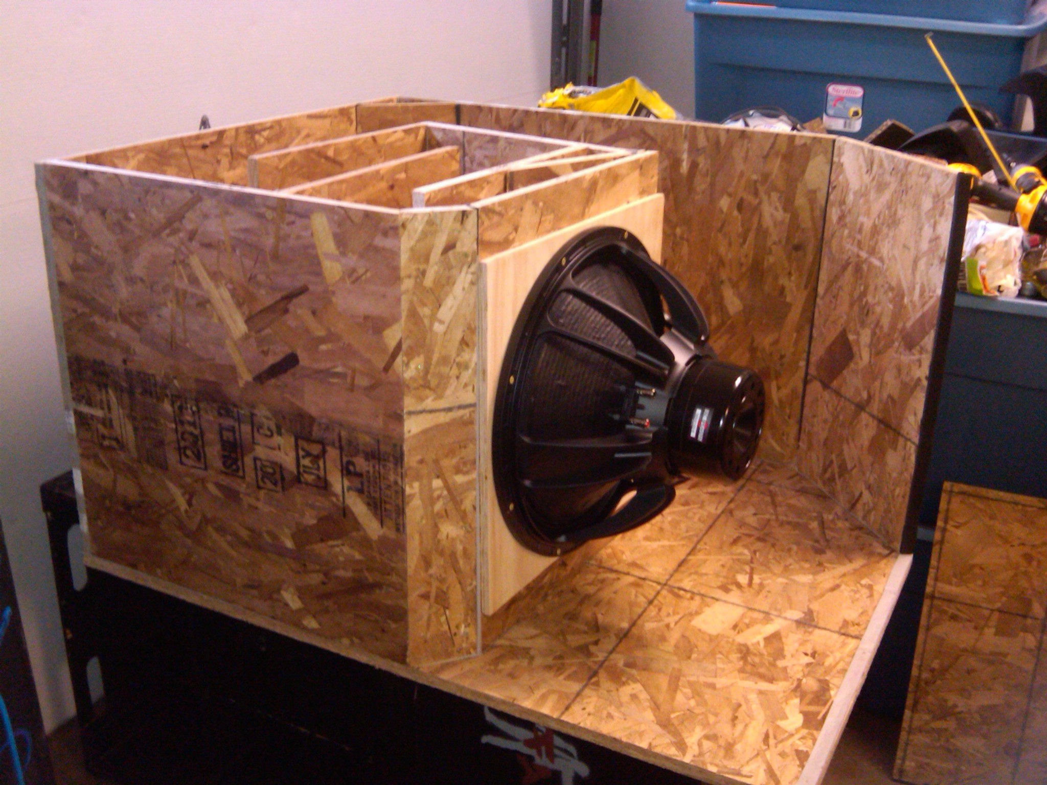

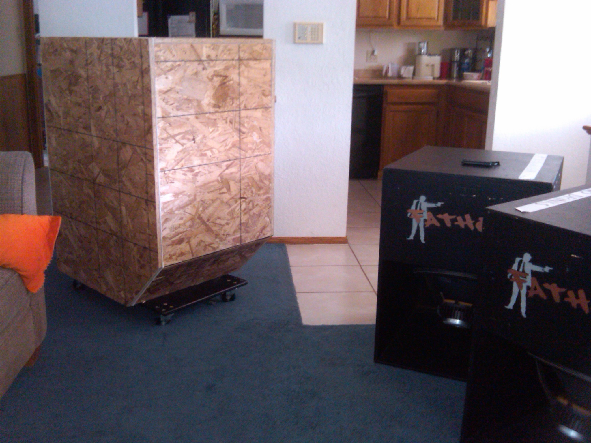

Did some tests of the 'Real 6 Fold' test box today:
Enclosure: "18in 30Hz - Real 6 Fold TH" aka "6 Fold" aka "Real 6 Fold" aka "R6F"
Test Box version: 3/4" OSB (subfloor) ply. Unbraced. Spacer for driver is 1/2" aurauco (had some extra laying around). Curved driver baffle entrance that is now being implemented in the Xoc1 TH-18 was used in this enclosure.
Designer: Xoc1
Driver: B&C 18SW100
Amp: QSC PLX3402
Volt-Ohm Meter: Blue-Point MT574
SPL Meter: American Recorder Technologies SPL-8810

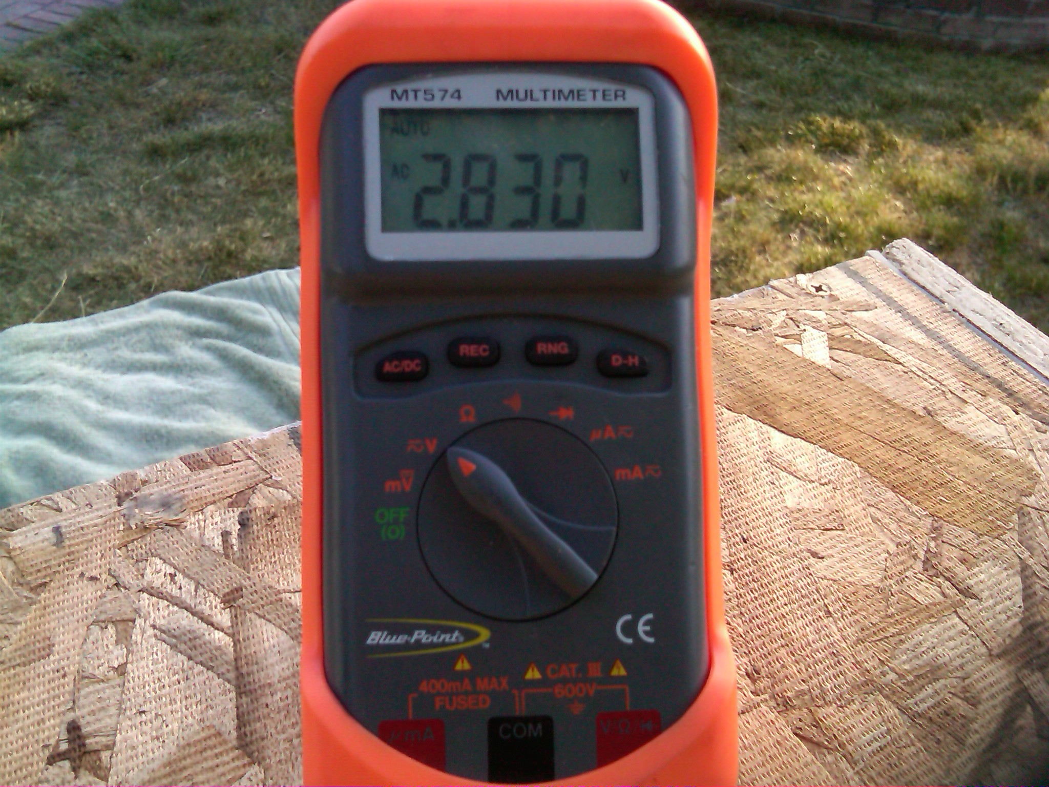

*Settings:
-Weighting: C
-Time weighting: Fast
-Sound level: Hi = 60-130dB

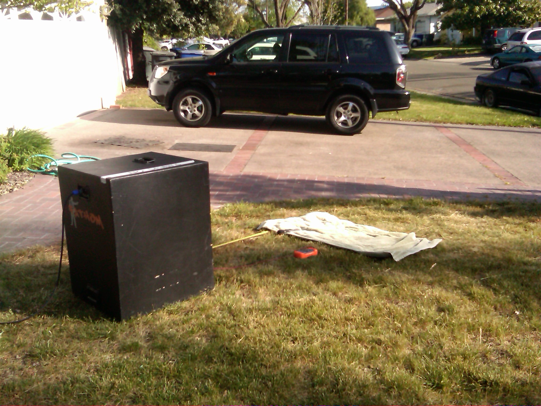

Conditions: ground plane, outdoors, over grass
The following measurements were done at 1W/1M (3.3 feet or 3'4"). The driver tested is published as 8 ohms from the manufacturer. Amplifier voltage of 2.83v was measured at the driver's terminals.

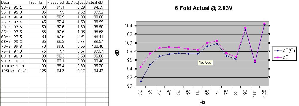

*Please remember, C-weighting has NOT been accounted for/factored in and the appropriate amount of dB need to be added to these measurements to compensate. I only have an image of the graph/curve without exact numbers to calculate with.
30Hz: 91.1
35Hz: 95.0
40Hz: 96.9
45Hz: 97.4
50Hz: 97.6
55Hz: 97.5
60Hz: 97.5
65Hz: 99.2
70Hz: 99.8
75Hz: 97.0
80Hz: 96.3
90Hz: 103.1
100Hz: 95.4
125Hz: 104.3
I do not have 85Hz, 95Hz or 105-120Hz tones as you may have already guessed.

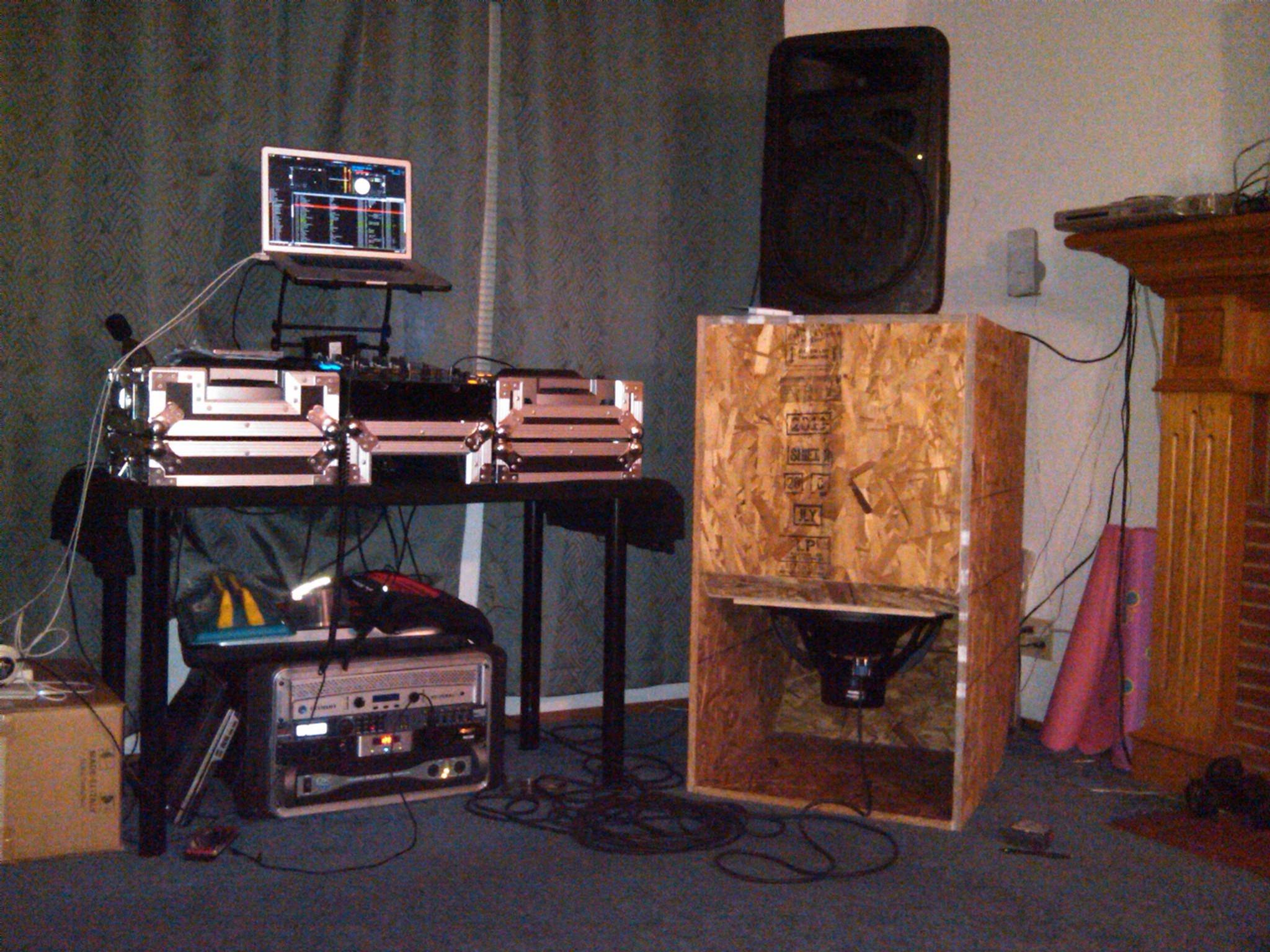

I played a single track for program material and turned it up. The meter read 122dB just as the amp limit light illuminated. Not bad for a flexing box that jumps forward 1/2" at a time as the kick drum pushes on. I highly dislike this OSB stuff - splits, cracks, strips (even with deck screws (better luck w/impact driver)). Both vinyl and rubber gasket tape/weatherstripping was used in place of glue for this test box.
The driver is not broken in yet, but it gives a nice, full-bodied sound and feel. I am playing with the idea of building the TH-18 for more SPL at events/shows (or the extended version to save 100L internal over this 6 Fold while maintaining the 30-35Hz response).

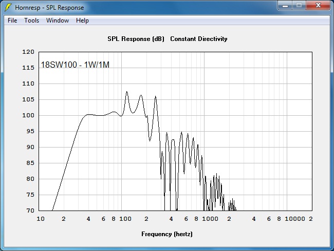

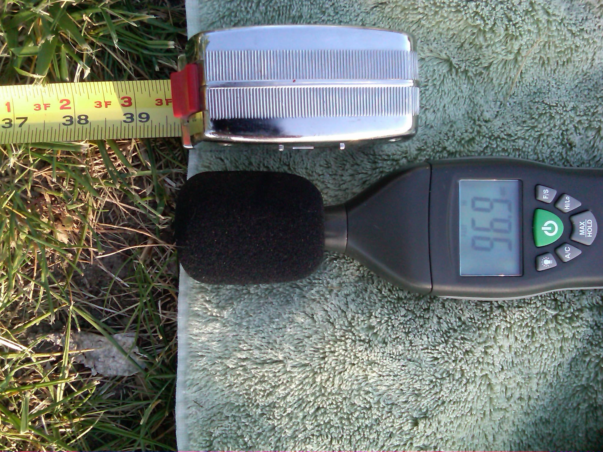

Below I've attached a photo of the drive voltage used, SPL reading at 40Hz, measurement conditions (SS15s shown), the HR 1w response plot and a few photos for size comparison.

I should look into REW. I have Smaart, but: haven't learned proper calibration procedure yet, didn't have time to learn today and a friend generously loaned me the SPL meter.
I've built some test boxes from OSB - boxes that were so good(flex and vibration free) folks want to buy them, even unfinished. You have to do it right, glue and fine gauge brads or possibly staples. Why screw up your test box by not actually gluing the thing together solid is a waste of time - forget the frufru foam gasket sillyness and put it together like you mean it. 😉
Sexy OSB box bronze medal for U though man
If it weren't a test box, I would've PL Premium'd it like my other solid boxes. This was meant to be put together in a way I could change panels if needed - as this is a prototype build. There are parts of this enclosure that haven't been proven. We all agreed I should build it with removable parts in the case I should need to make an adjustment prior the final draft.
However, as time went on in the build, I did wish I had glued it. Just because of the fact that I could have sold it to someone if I didn't particularly like it. But that led my thinking on to wishing I used higher grade ply, in case I sold it. Then bracing...then handles.... So, maybe it's good I didn't get carried away and kept it as we originally planned.
At least now I'll have templates for the good baltic birch

Did a quick spreadsheet for the dB(C) compensation.
Apologies for my naff spreadsheet skills!

Looks great, Martin! Thank you.

WHOLE EEE SHHHHYT this cab provides a ton of low end.
We 'tested' it for a few minutes with a bit of low material at our regular venue. I was pleasantly surprised ......that I wasn't let down. This cab on one channel of my PLX3402 (1000W less than would be used had it been it's debut) filled the entire bottom floor of the bar/club just as much as our 2 BFM T48, 2 SS15 and the 2 house QSC active 18" - with even more bottom. "As (you guys) were talking, your voices fluttered" my colleague said after our quick check.
We didn't feel a ton of that chest compressing feel with the little material we tried. Not sure if it's due to the lack of cone make up in this cab or if it's purely lack of SPL at those frequencies that the cone make up won't recover. This left us with the urge to give the TH-18 a try. Can't say for sure that it's optimized to the fullest for the 18SW100. Our hopes is that we won't miss the couple Hz at the very bottom. I tried to mimmic the lack of super low response by cutting out some 30Hz by a few dB while testing the 6 Fold and the difference wasn't enough to really justify not trying the TH-18. A wicked system would be a 3-way setup with the 6 Fold and some SS15s for that chest smack. *Thinking* Are my hopes to high, thinking I might possibly achieve both with the TH-18?
Note: While we definitely have tracks that contain 30Hz content, they are usually mellower tracks that probably won't get played out too much. AND when DJing, tracks frequently get pitched/sped up which will raise the low content's frequency also.
I would still like to try this cone make up in the 6 Fold and test it to provide some more info so we can keep learning. Should this also be implemented in the TH-18? Feel free to post that answer in the other thread 🙂
