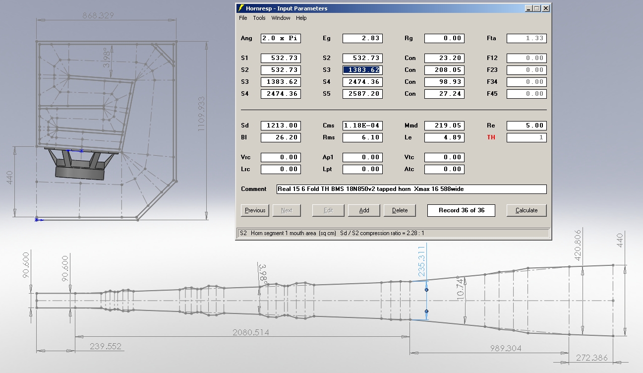

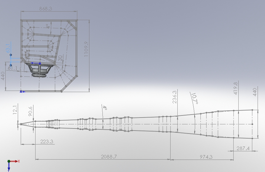

I've attached the original 6 Fold sketche; the 2nd sketch with the addition of the S1 angle piece; the cab dims of each; and the baffle cut-out I'm currently using. Big thanks goes out to Martin for these beautiful sketches.

How low? Let me check...brb...
It just took 25Hz at 700W just at clip light (clip limiter on) with no HPF, no excursion noise. I got some excursion noise at 20Hz and 16Hz at the 3rd signal light (4th light is clip/limit light). Sorry, don't have volt meter set up. Maybe tomorrow?
Just remembered I'm only using a 1/2" spacer - I may have been hearing the edge of the cone or surround hit the baffle..??

You can blame Martin for that 😉 jk. Maybe it should be called the '6 Section TH' ;P
btw i only count 5 folds😀
I first posted this basic design and called it the 6 fold in November 2010.
Nearly 18 months later. Hundreds of posts. Thousands of views and now you notice there are only 5 folds and 6 sections.🙄
Regards
Martin

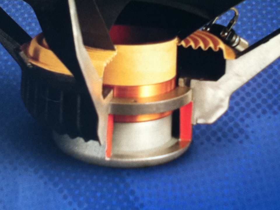

Eminence uses a 3/4" long VC in the 3015LF and the published gap height is .365" so the claimed x-max is theoretical or 10% distortion blah blah blah.

Now as it is they have been taken in by the specmanship, the gap is taller than the exposed coil fellas:
