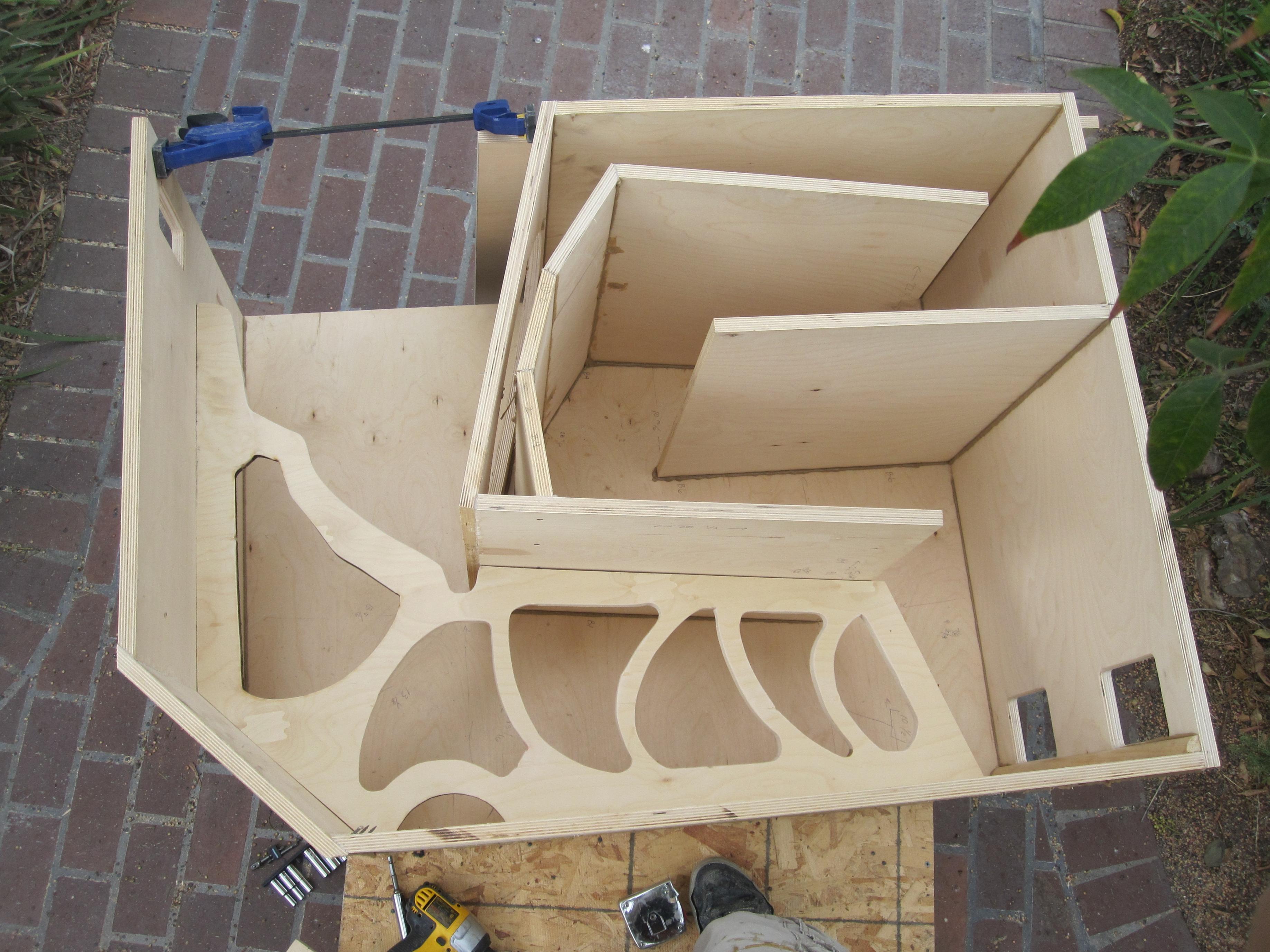

2. Anyone up to getting a symmetrical fold going for this 5Fold? If not, I'll move forward with the current plan. I'm purchasing multiple sheets of 3/4" birch ply on Monday (5'x5' for $40, or 4'x8' for $67). I need to complete 4 cabs by the end of the month. I'd love to learn how, but this might not be a one-day process for my first time. If it's not, there's another design I have in mind I could study for and practice folding (will be another thread).
From what I have used DATS worked just fine doing impedance sweeps. I know others said it can be finicky at times though.
I would wait to hear from EP or others for the fold. Since trying to finish a few designs myself I am starting to understand how to fold now. BUT I wouldnt want anyone folding my designs and then becoming upset it was perfect.

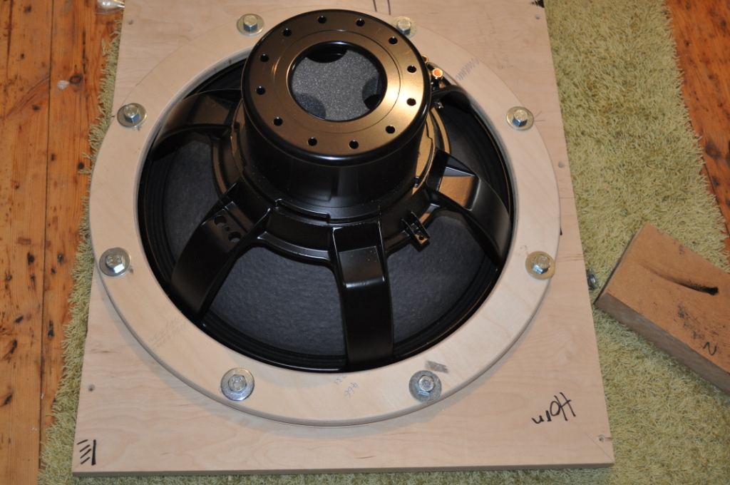

first of i modded the design for a cone correction.cressendo got al the details, drawing and cnc files
the 9000 wil be a fraction louder where it counts ,it also moddels smoother.
i d go for the 9000
the rcf 18x451 is also a verry good option.
i d go for the 9000

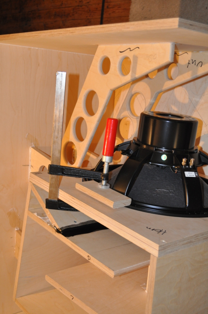

btw,this is the bracing for 4 subs ,1 sheet 122x244
61 cm wide external

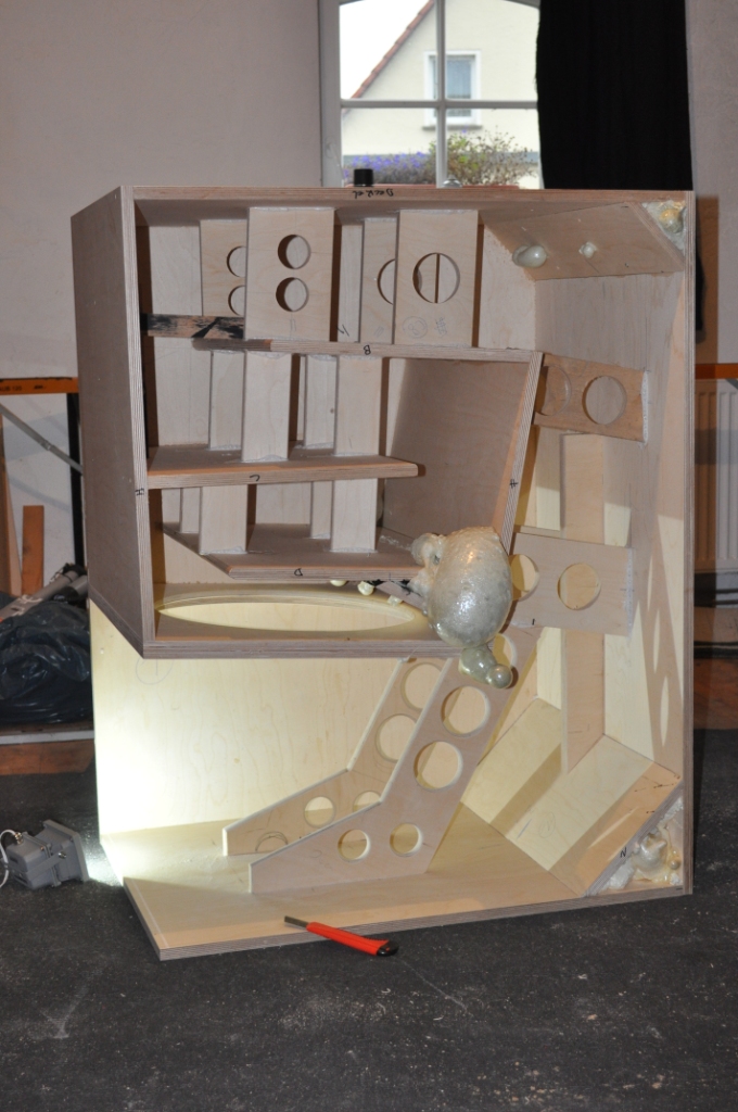

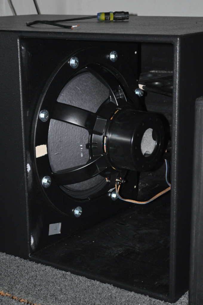

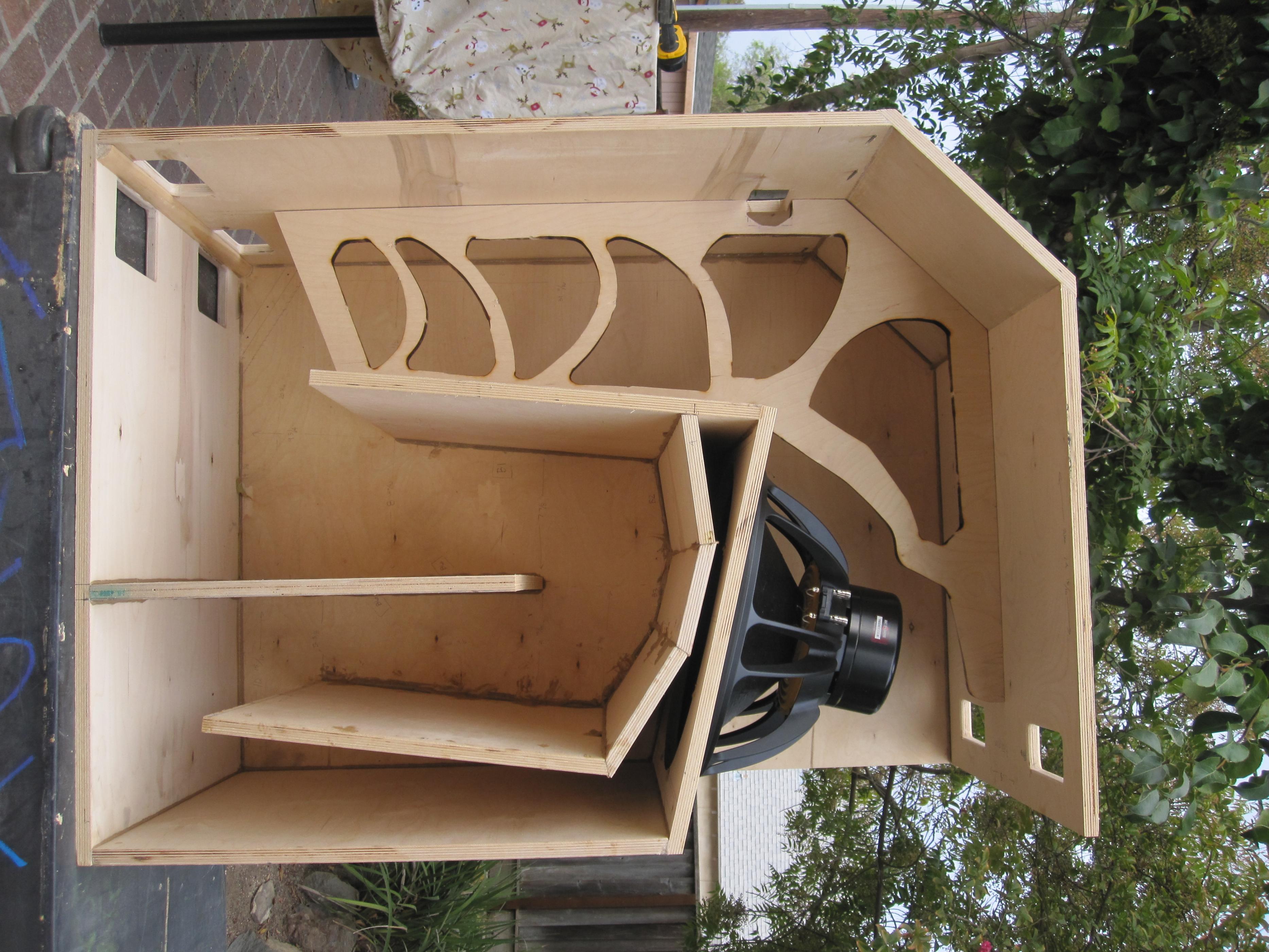

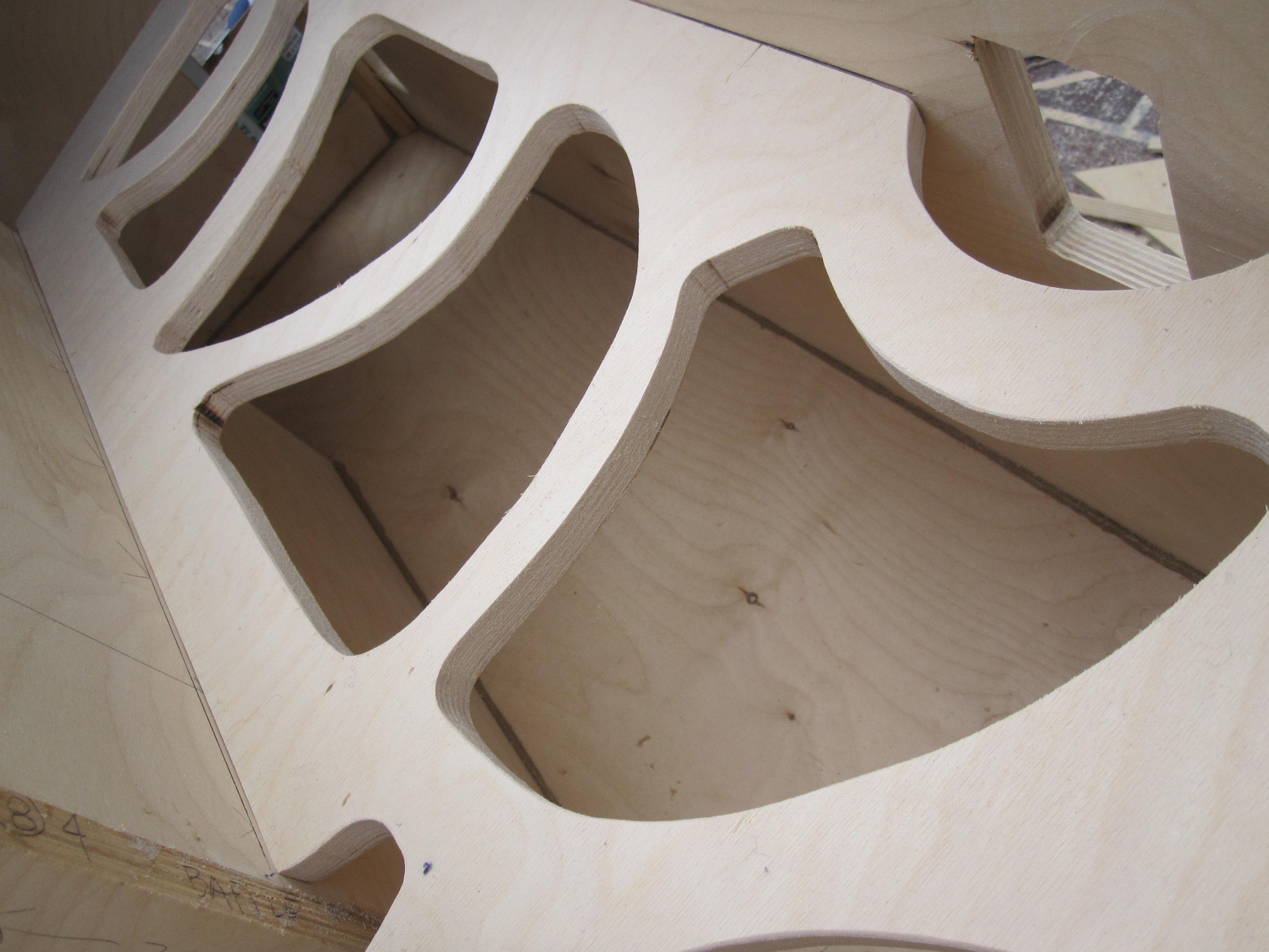

Quick post before bed, after a long two weeks:
Four of these are closed up, loaded with B&C 18SW115 and making floors flex. Yes, there's more bracing throughout. More pictures and impressions later.

did it
did it build it didn`t regret it!
hugs to Xoc1 with helping !
thank you forum !
